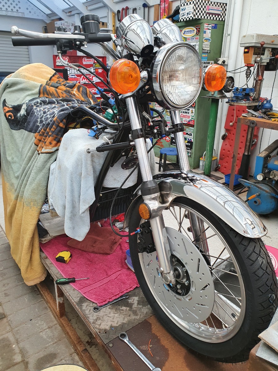

I had to plug the front of the wiring loom into the headlight so that I could start arranging the loom in the frame and begin plugging everything in where it needs to be plugged in. The added complexity for me (apart from a disinterest in doing wiring ) is the retrofitting of indicators, horn and starter motor.
Anyway the headlight is on and the bike suddenly kinda starts looking like a bike again.

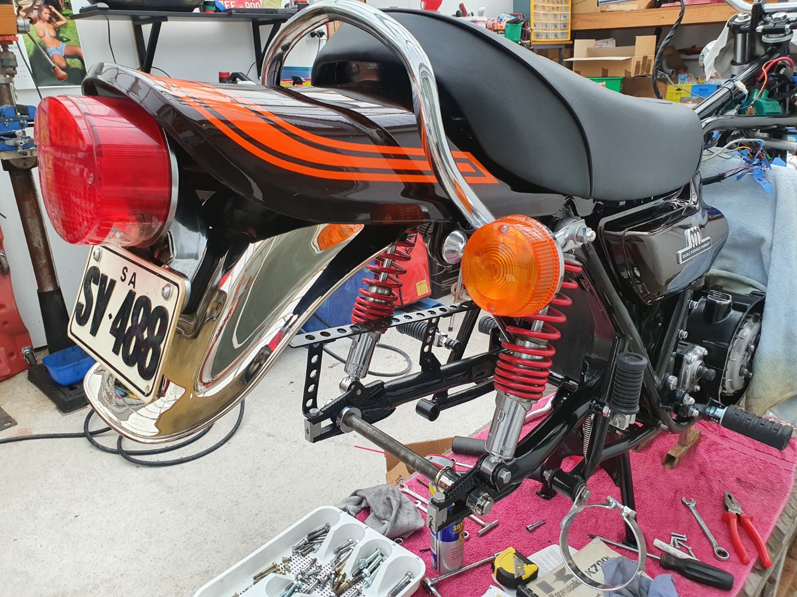

After contemplating the wonderful world of wiring its time to bolt stuff back on.
I attached the rear taillight onto the rear mudguard, cleaned up bushes and bolts and fitted the guard and hooked up the wiring.
New sidecover rubbers go on the frame.
I might as well take the opportunity to drop the tail, sidecovers and seat in position for a photo op - before removing them and putting them safely away.

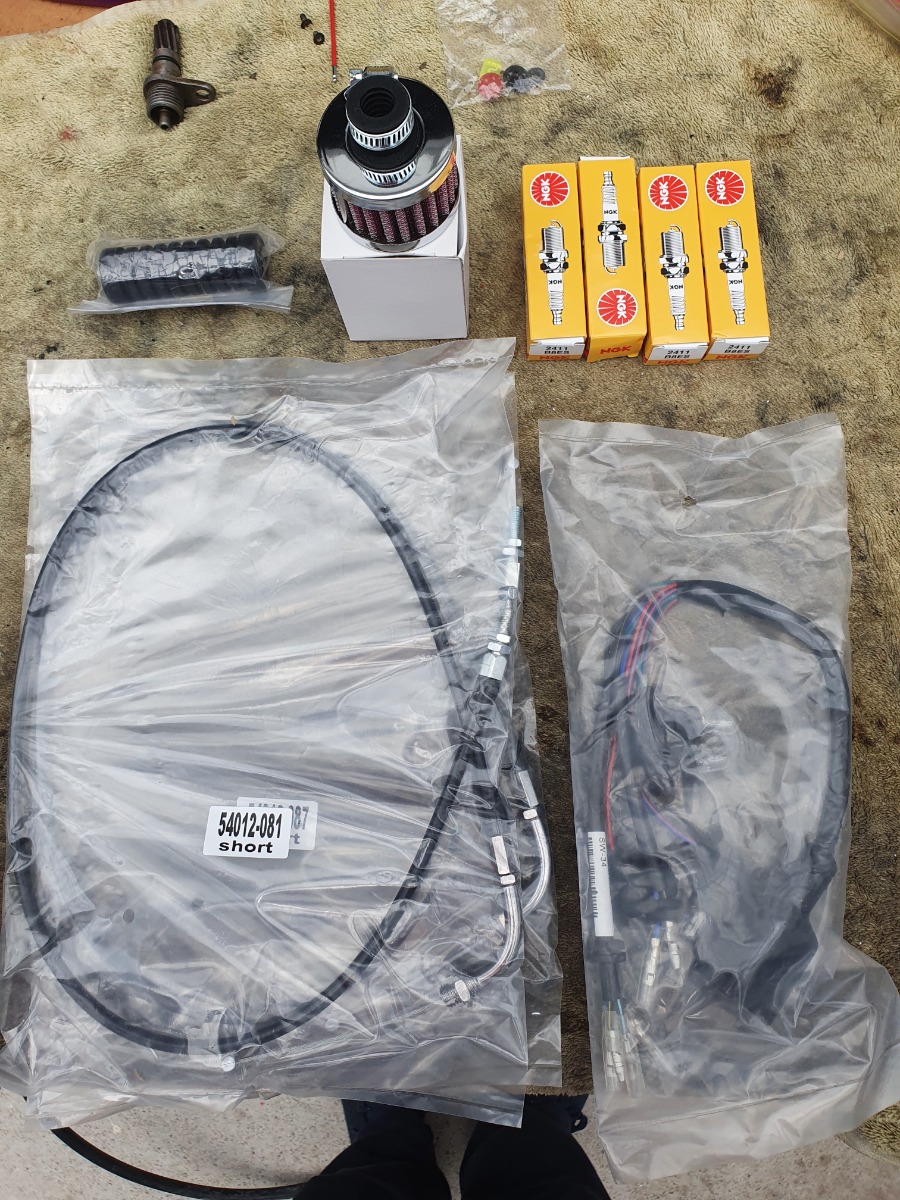

Got a box of bits from Z1 Spares, a new instrument light loom, set of plugs, short throttle cables, kickstart rubber and a crankcase breather.
Hopefully this is the last purchase for the bike, apart from any unforeseen circumstances - of which I am quite sure will happen !

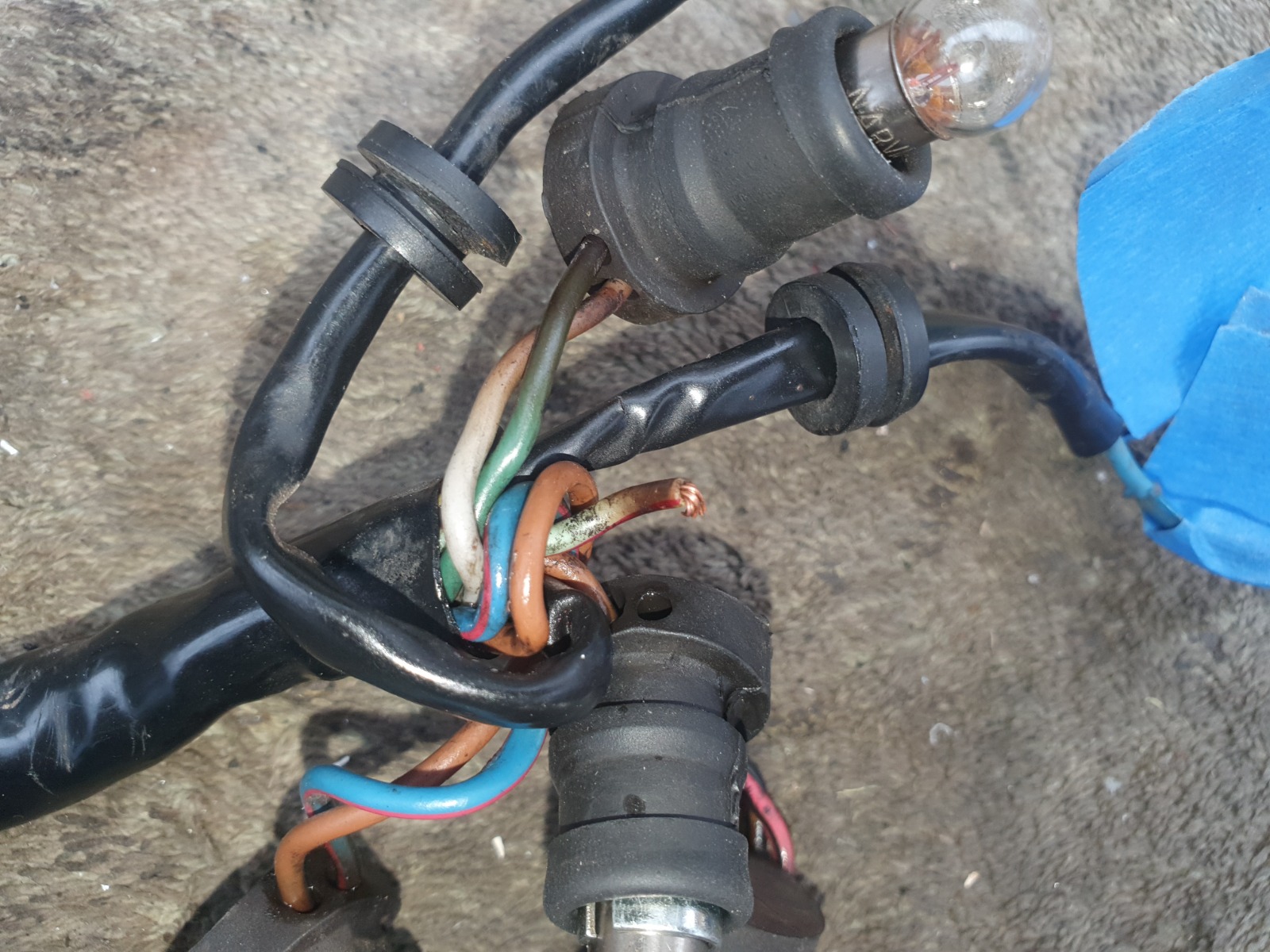

So I install the new light loom, switch on ignition and yes I have a neutral light. But wait - there is now no oil light
So I check the 3 other lights, all working. Switch the high beam bulb around and now there is an oil light. Looks like one of the new bulbs that came with the loom is dodgy.
Still no horn, despite filing off the powdercoat on handlebar surface of the upper clamps - maybe I need to get rid of the coating on the main triple tree clamp too?
Is there a good cheap and cheerful way to run an earth off the button?
