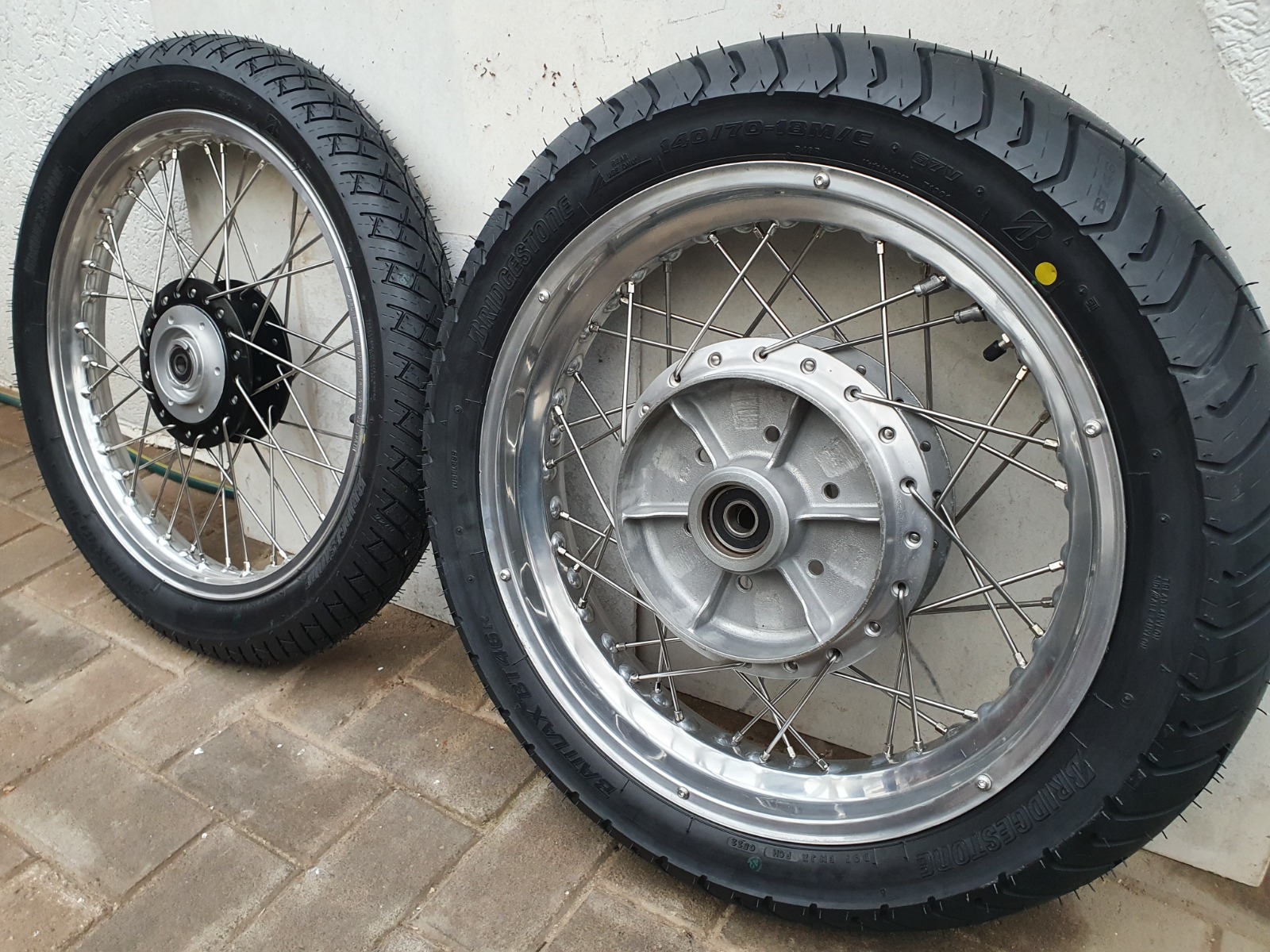

The wheels are back, having been re-spoked with stainless spokes, and fittingly the old battlax gets some Bridgestone Battlax tyres (BT46)

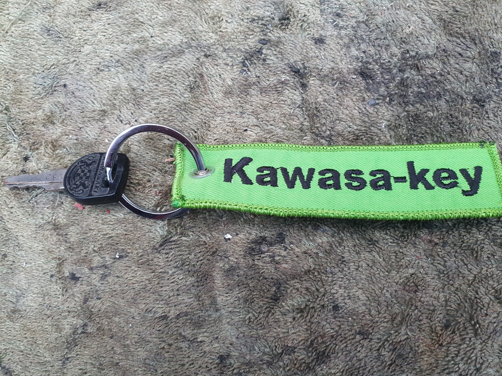

Is that rear rim a Takasago? The key flag may have come from a KLR. I had one with mine.
