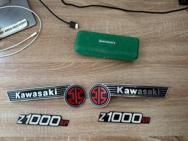

Next came the decals !!!!!!!!!! firstly I want to give a huge shout out to member "HowardHB" who did a fantastic job of CAD modelling my design and writing the print files (idea shamelessly plagiarised from Stereordinary and Docrot) but with a Wookie twist. Also thanks go to a work colleague's husband who printed them at his workplace. The plan was to heat and bend them to the shape of the tank which went well with no issues, then to have them chromed and overpaint the colours. This was the first hurdle, the only company that came back to me with a quote for chroming nearly knocked me off my chair !!!! £270 +VAT plus shipping (that's about $400) "oh and by the way, this is a decorative finish not intended to be used outside. It "may be OK" if you clearcoat with 2k, we can do that for an additional charge". Well as you can imagine that was never going to fly with a cheap Wookie (even if they guaranteed it would last forever) And so the trial of endurance began with painting the decals
1. Painted with textured finish black base - tried to mask the areas that are black for the chrome spray. After about 6 hours I decided that the clear tape that I had just wasn't going to work
2. Spayed the whole decals with "chrome paint" then attempted to overpaint the colours (tried car touch up paint and Humbrol modellers enamels - both dissolved the chrome and mixed into metallic black and red !!!!!!
3. After washing all the paint off again in thinners I repainted the chrome then applied 2k clear to act as a barrier to the colours - The clear dissolved the chrome and turned it a "dull grey"
4. And so to the most recent attempt - painted all the colours, applied clearcoat and allowed to cure. Spent another 6 hours masking with some different tape then applied the chrome. I have gone back to it today as I couldn't remove the tape last night as the chrome was too soft. This is the best so far (pics below) however there has been some bleeding under the tape and some adhesive from the tape left behind (this would normally come off with some panel wipe but I don't dare go near them at the moment with that !!!! I have now brought them inside for a few days in the hope that when fully cured I will be able to "touch up" the black and white (I have emailed the manufacturer of the chrome paint for some guidance) And I guess that's that until after the holidays. I couldn't resist hanging the bodywork on the get an idea of what it will be like when finished. This has really been uplifting as I start to feel like it will get finished in a few months ready for the spring

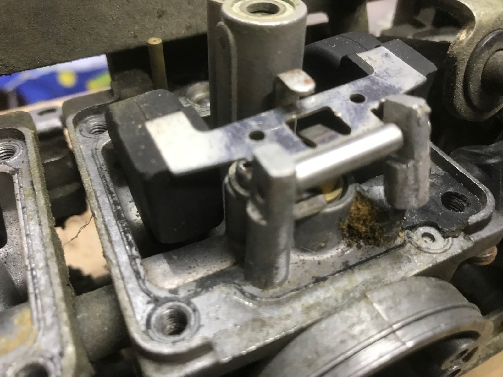

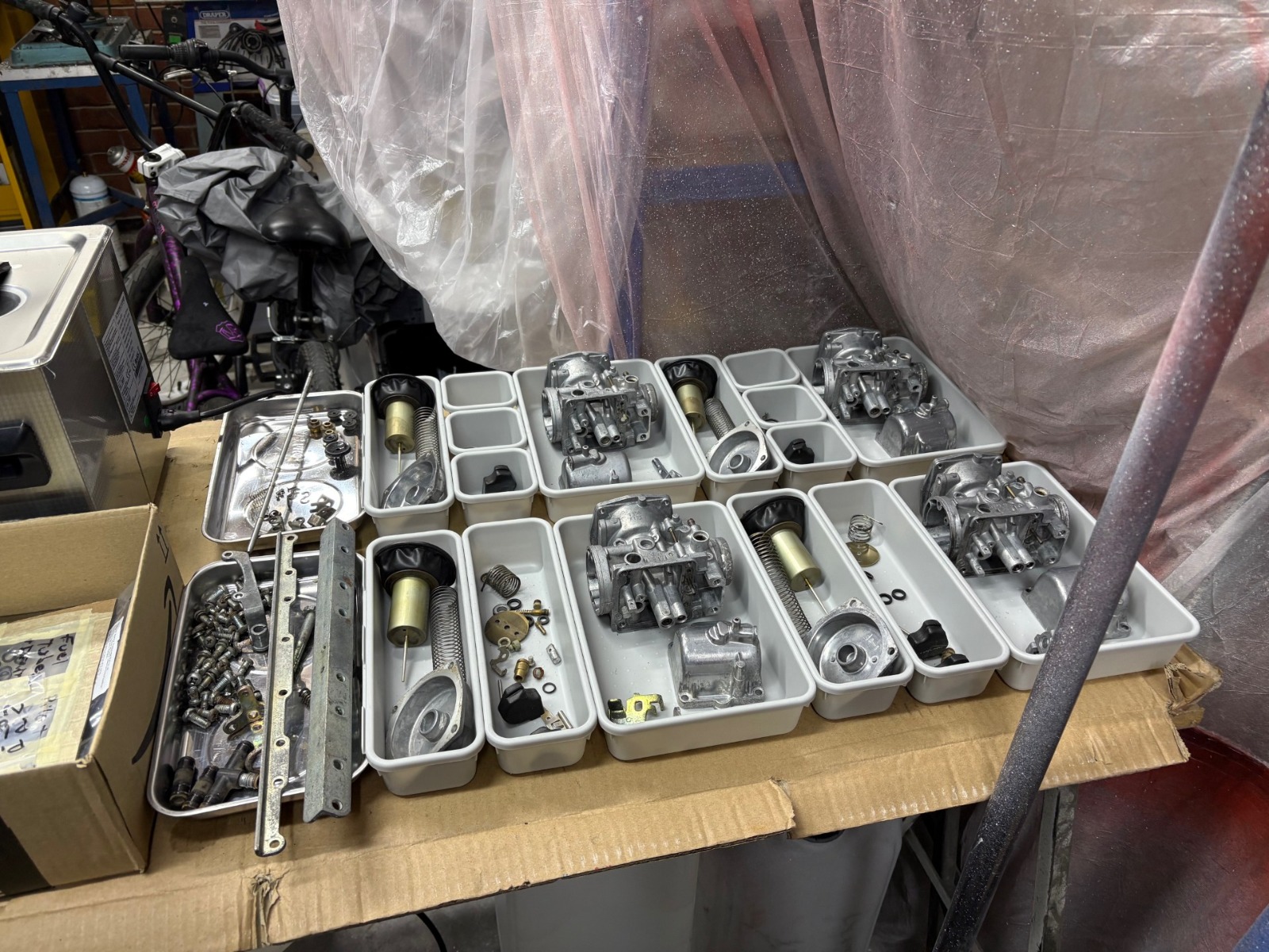

I've decided to take a little break from the decals as they are "driving me nuts" also it was too cold here to do fine detail work (1 degree today) so I have made a start on the carbs. This project really is "the gift that keeps giving" !!! disassembly was quite straightforward until I pulled the float bowl on #3 and found a broken float tower
and also I had to drill one of the butterfly screws out of #4 throttle flap (no amount of heat and lube would free it so I'm guessing somebody was over enthusiastic when they "staked" it. I think I can repair the tower but hopefully when Carlos gets back to Spain from the US at the weekend he will have a #2 or #3 body and a #4 throttle shaft that are serviceable in the scrap set of carbs from his Ltd project. In the meantime there is plenty of cleaning, plating and polishing to keep me out of trouble

BS carb bodies are aluminum. VM's are zinc, sometimes denoted "pot metal".
There is a guy in the US that laser welds broken float posts, so it is doable. Not cheap, though. I'd be looking for a new carb body for this one.

BTW, the photo showing the broken post, also shows the tang on the float angled down sharply. This indicates a problem. Maybe the person did that because the post was jacked?
Angling the tang down a little is okay, but just a little. If you get high fuel level when setup this way, something else is wrong.

Guy, with regards to the badges, have you thought of maybe having them enamelled, by a badge company maybe?
- Posts: 6878
- Thanks: 4330
Re: And finally, Wookie's 82 begins !
02 Jan 2026 02:29Thanks buddy, the issue with enamelling is (as I understand it) it involves heat to "flow" the enamel. These are 3D printed in a plastic that starts to melt at 60 Degree's, the biggest issue has been the chrome paint that "doesn't play well with others". However having spoken to the manufacturer it appears that "full cure" takes 1 to 2 weeks (not the 24hrs it says on the can) I have found that leaving it for a week on the window sill above a radiator has made it much more forgiving to work with. It would have been much easier to do if they were "plastic chromed" but the price I was quoted was ridiculous, still I think we are getting there nowGuy, with regards to the badges, have you thought of maybe having them enamelled, by a badge company maybe?

Ah yes, that would be a problem being plastic
. I'd assumed they were metal. Hopefully leaving them for a few weeks will allow the silver to cure sufficiently.
There is, of course, cold enamelling which is basically resin with a pigment.
