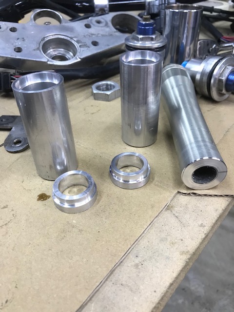

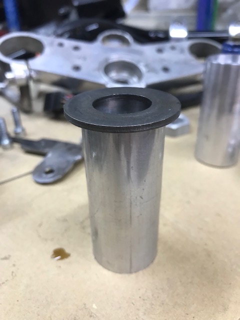

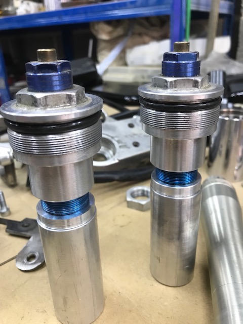

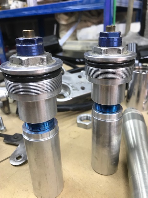

Now the bodywork is about done (just need to trim the Zephyr front fender to fit correctly) I have started working through a few smaller jobs that I need to wrap up prior to strip down for polishing,painting,powder coating etc. I had noticed that the "pre-load" adjusters on the front fork would only adjust through the first half of their travel. I pulled the top of the forks and found that I had made a "schoolboy error" when designing the extensions !! In the stock ZX forks there is a thick washer on top of the spring which the adjuster engages with, I had refitted these on top of the extension tubes. The problem was when the adjuster was wound down the washers hit the top of the "joining sleeves" between the original tubes and the extensions
To resolve this I have cut a rebate in the pre-load extensions and made a "top hat" bush for the adjuster to engage with. Fortunately I was able to harvest the materials required from the scrap ZX9R steering stem I had left over so at least it didn't cost anything to resolve

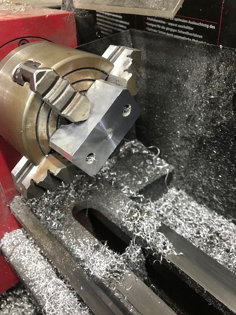

Now the nosecone is in it's final resting place I wanted to lower the handlebars a little to gain some clearance around the clutch master cylinder. In the absence of a mill the 4-jaw on my little lathe did a great job of trimming the bar risers - now on to the hand controls
