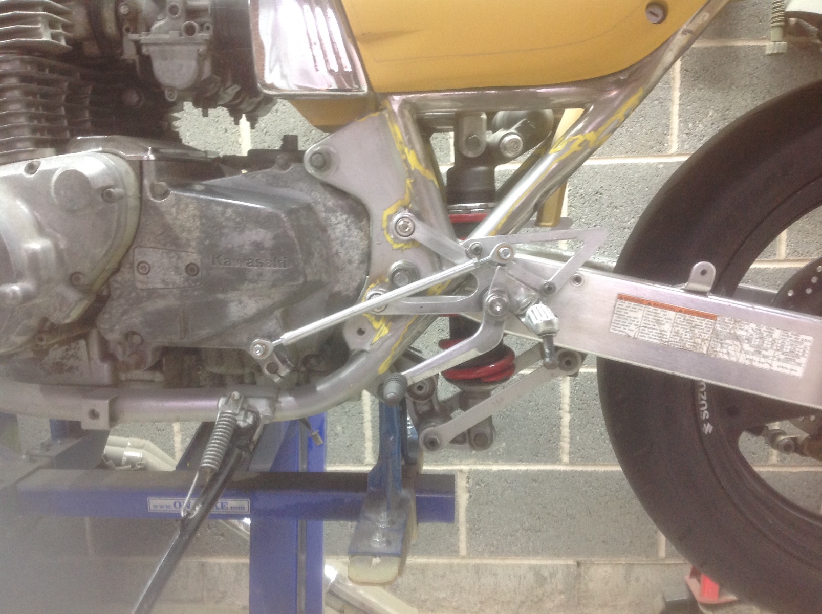

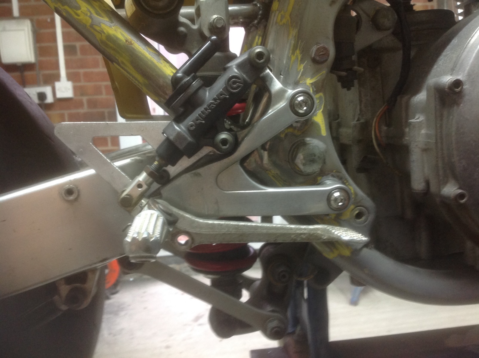

So I have been finishing up the foot controls this weekend, sorted the gearshift (I was going to buy a GPZ part but when I looked at it, it appears it's just a pice of flat steel welded to the end of a normal lever so that's what I did) needed a few bushings and spacers to get it working correctly (on the Yamaha they came from the shift rod runs behind the lever and frame spar) I just couldn't live with those ugly heal guards so I "bit the bullet" and made alternatives which I like a lot more (I could have just junked them but they are there for a reason) I just need to make a couple of spacers for the brake pedal and master cyl

Wookie - those new heel guards look much better, they match the shape of the pedal brackets. Nice work.

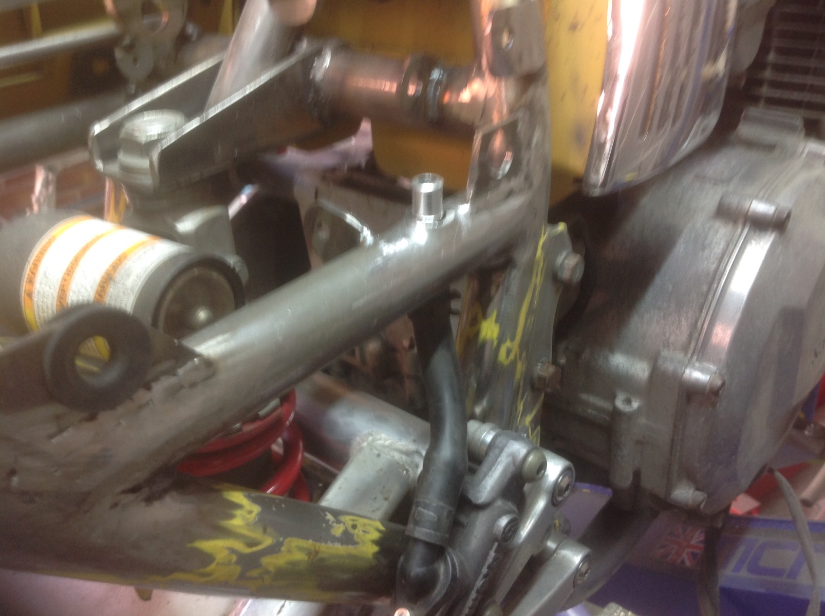

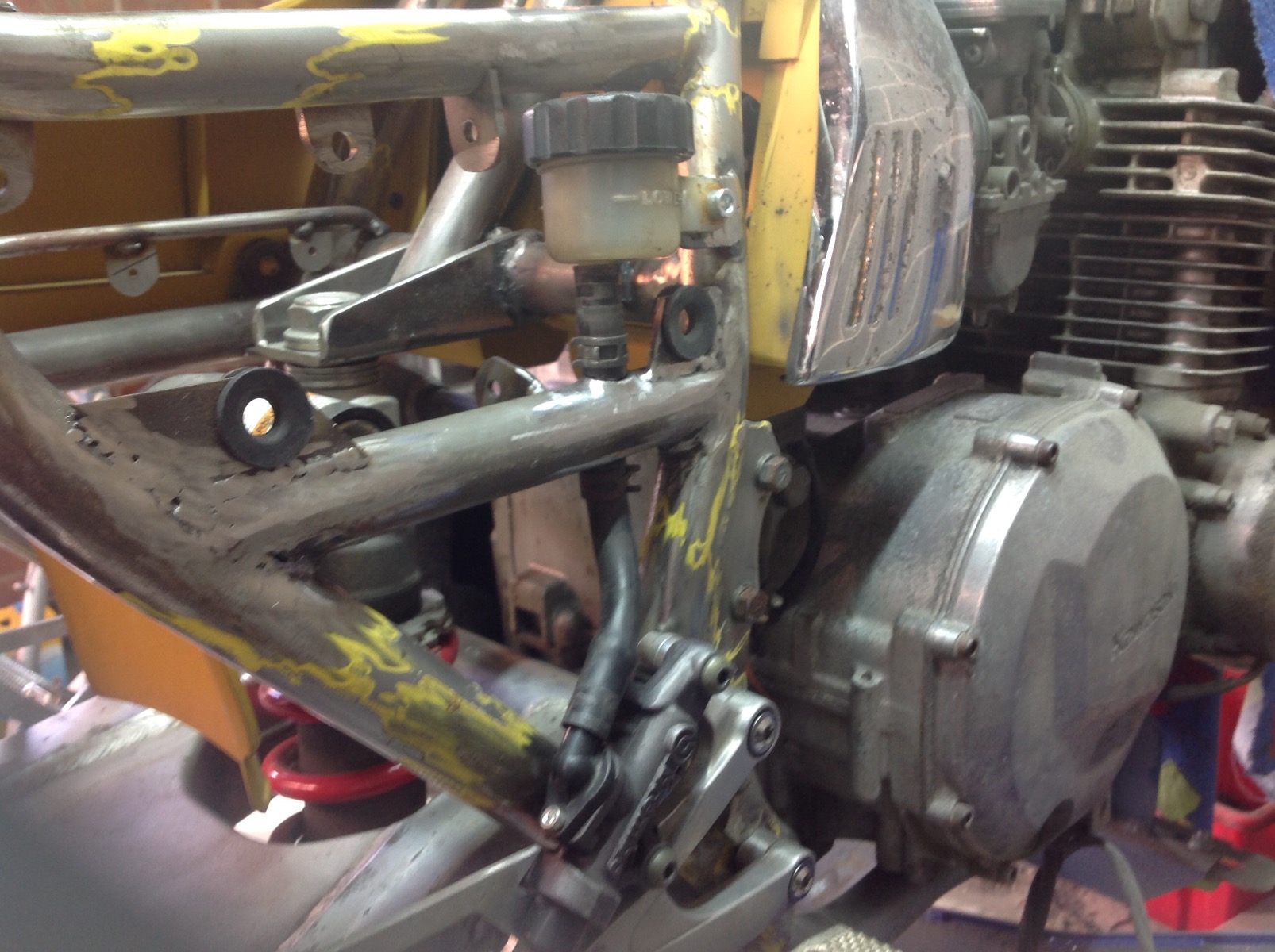

Have wrapped up the foot controls today, spacers for the brake pedal and rear reservoir. This has tucked in nicely behind the sidepanel but I had to go through the brace with the hose. I have welded a steel tube through to maintain strength and made an ally joining piece for the hose. Now onto the exhaust
