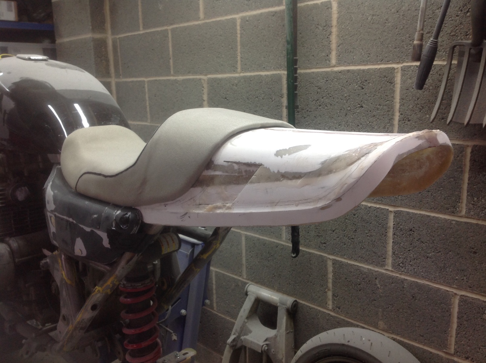

25 Sep 2022 02:44Am working on the side panels currently, will update laterDid you make any progress on your days off, or did the daily driver eat up all your free time?

It will get rear interesting real quick when they are done and the seat has a skin on it.

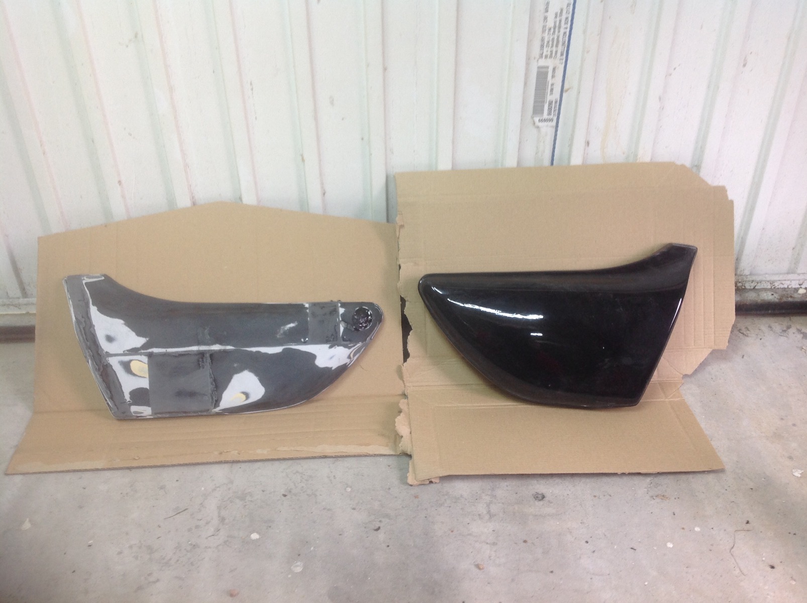

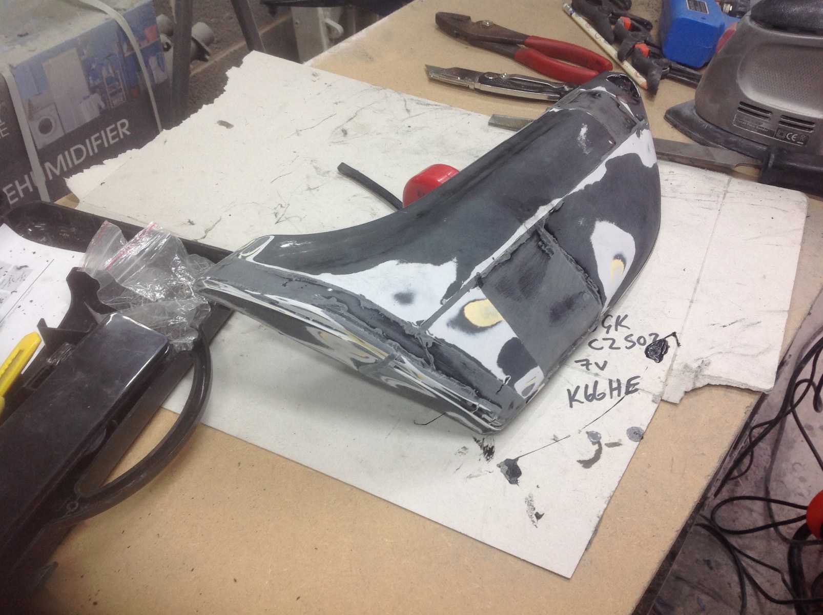

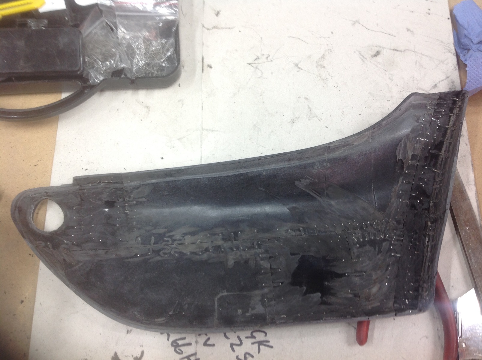

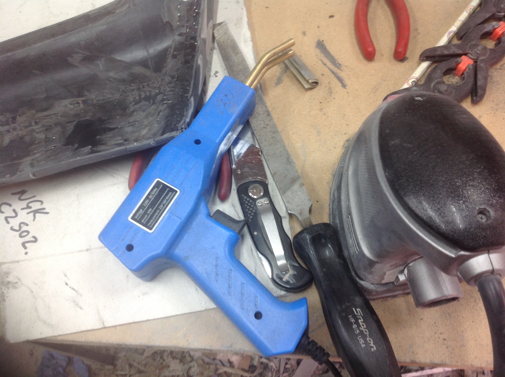

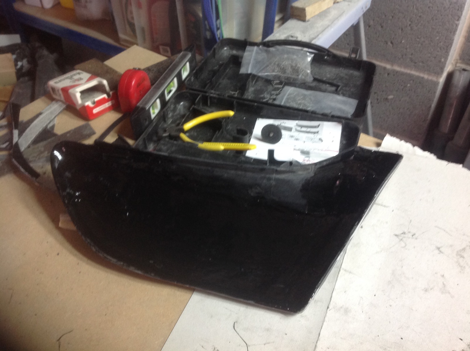

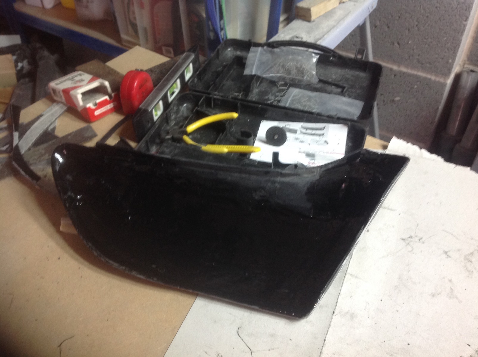

And so to the fruit of today's labours
I have finished re-shaping the left side panel so it now fits properly in it's new home and is pulled in a little tighter to narrow the old girl around the waist ( every little helps when you have short legs) I basically cut into three main parts and then added or removed material where necc so it still looks like a KZ panel just a little different (15mm longer at the front, 35mm longer at the back and 25mm shallower in the depth) I have included a before and after comparison with the right side. If you don't have one of these "hot rivet" guns you should get one, even before it was glued it was solid with just the rivets (with plastics getting harder to come by most would be repairable using this method)
I have then painted over all the joints from the back with "gloop" ( scraps of ABS plastic disolved in acetone to make a paste) the acetone eats into the surface of the plastic to make a permanent bond ( it's like adding another layer of plastic) just needs a light skim of bondo and some mounts now

- kzstreetfighter71

Re: And finally, Wookie's 82 begins !
25 Sep 2022 10:40
The definition of a Frankenstein bike.
- Posts: 6662
- Thanks: 4205
25 Sep 2022 11:16Is that a good thingThe definition of a Frankenstein bike.
The following user(s) said Thank You: kzstreetfighter71
- kzstreetfighter71
- Atlantic West Coast
- Posts: 821
- Thanks: 208
25 Sep 2022 12:23Hell ya it is, creating something new from the old is the way to go.

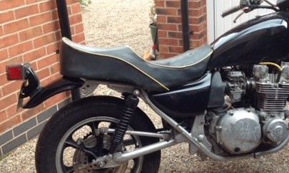

Extremely nice work. We need pics of them of the bike!

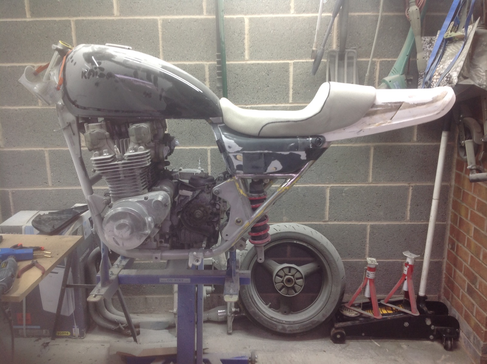

- Posts: 6662
- Thanks: 4205
26 Sep 2022 10:15Thanks Doc, attached as requested. It's certainly on a journey and there isn't much "Ltd" left nowExtremely nice work. We need pics of them of the bike!

- kzstreetfighter71
- Posts: 821
- Thanks: 208
26 Sep 2022 10:37 - 26 Sep 2022 10:37
They nearly have a Z1 look to them, nice one.
