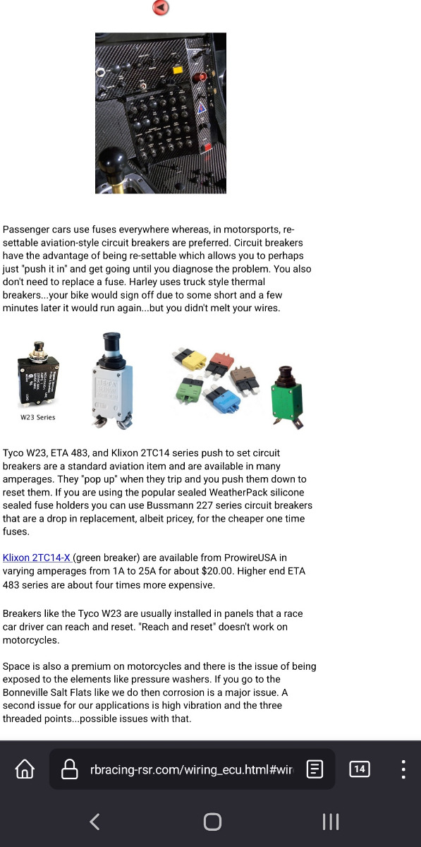

Anybody have a line on a push button breaker board aircraft style.....maybe 6 circuits?
- F64
- 81-KZ440D2
- Posts: 1233
- Thanks: 450
Re: prostrett 2.0
04 Apr 2022 10:09
You will need to possibly make your own board, but here are the breakers.
www.prowireusa.com/c-7-circuit-breakers.html

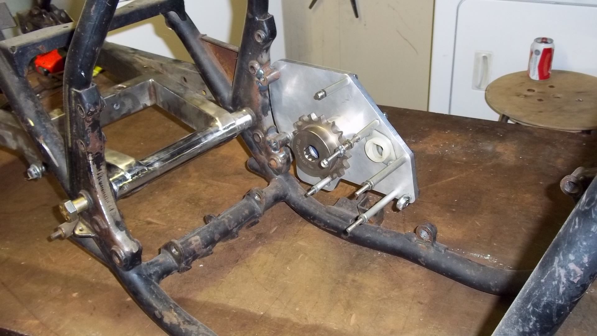

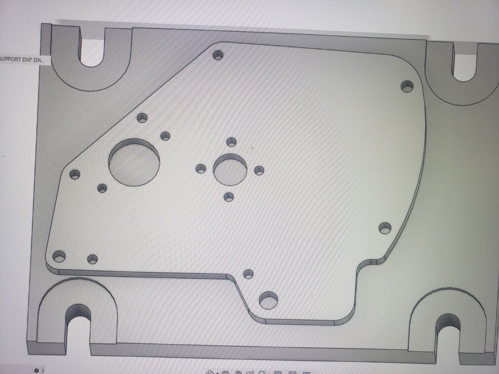

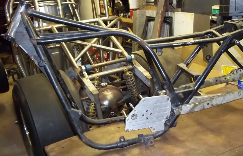

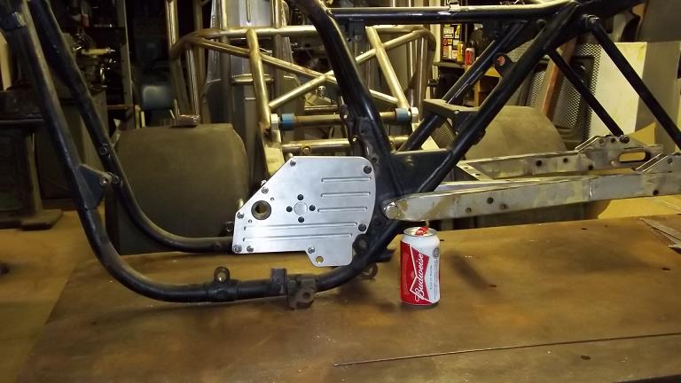

Irishwill, longtime no see! well. that's different and new school! quality of course!
I was one of the lucky ones to buy 2 of your $100 offset sprocket plates from 11-12 years ago!
Any chance you look under the bench and find another??
Or did you save the program file for the CNC machine?
I sure would like another one of these plates!
Thanks, Marty in Buffalo, NY
- irishwill
- Posts: 597
- Thanks: 6
Re: prostrett 2.0
04 Apr 2022 19:25 - 04 Apr 2022 19:29Pretty sure this is it.
need to check price of Aluminum.....but ya .....I can do it.....not back home till june tho...
