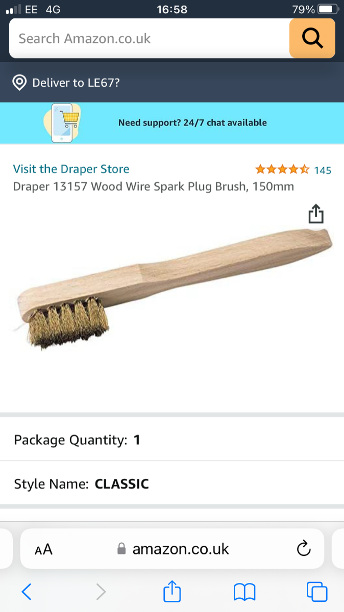

I was able to clean up one set of fouled plugs with just a wire bristle brush, but I have no idea if they are clean enough. I may try the propane torch just to see what happens.

A regular wire brush can leave deposits that cause the plugs to short - there are brass wire brushes specifically for this
Re: Restoring Zephanie
11 May 2022 11:30
I have only used the brush on the earth strap, base ring. Heat only on the porcelain
