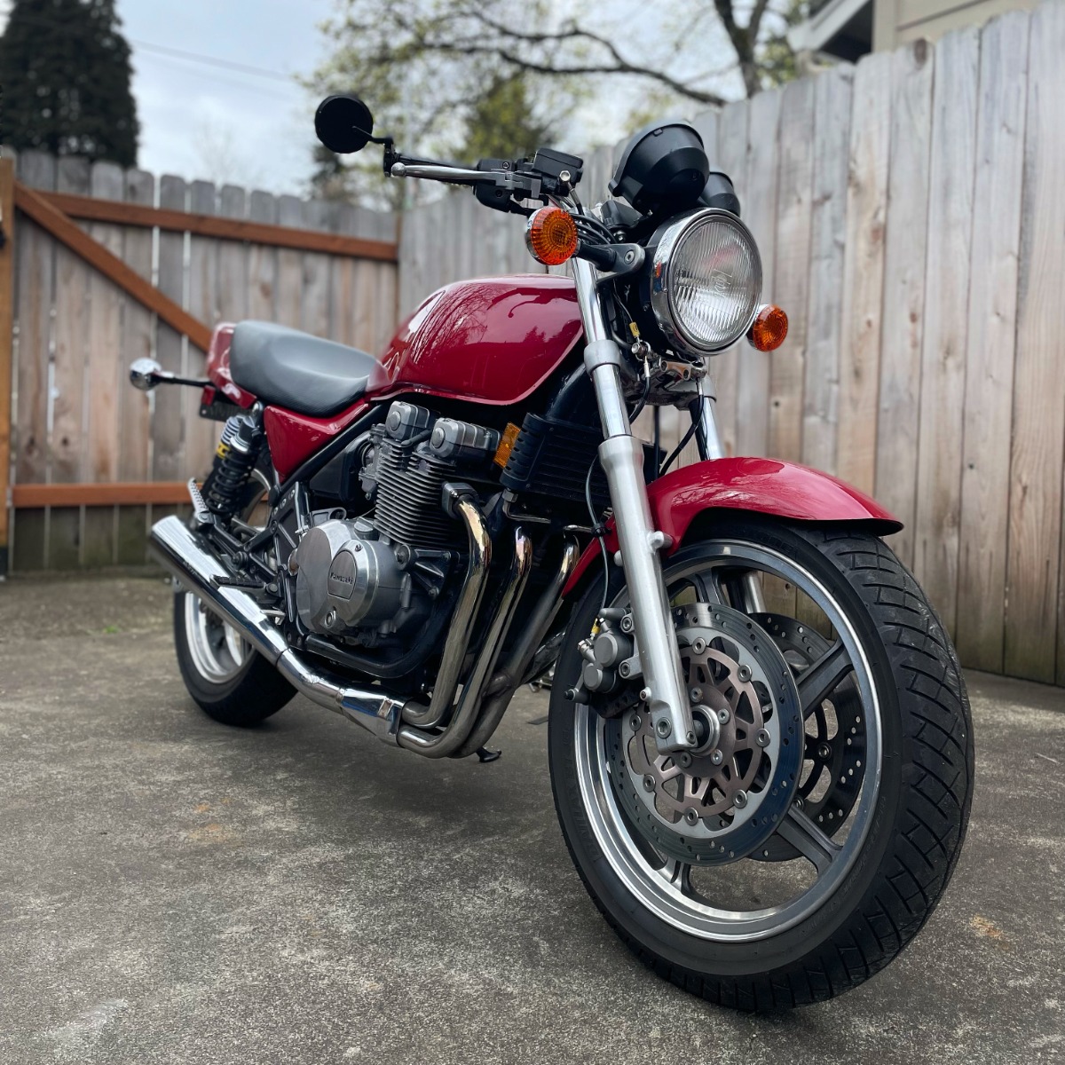

Happy Monday everyone! Here's a picture of my bike from this morning.
So where it's at right now...
- I still need to lean out the fuel/air mixture, for hopefully better mileage, and longer spark plug life.
- The front brake feels like it may still need to be bled a little bit more. I like to use two-fingers on my clutch and front brake levers, and I'm having to pull the front brake in all the way to my knuckles before it really starts to bite aggressively. If that's the way it's supposed to be, I guess I just need to get used to using my rear brake a little bit more.
- New rear tire. The one that's on there is five years old.

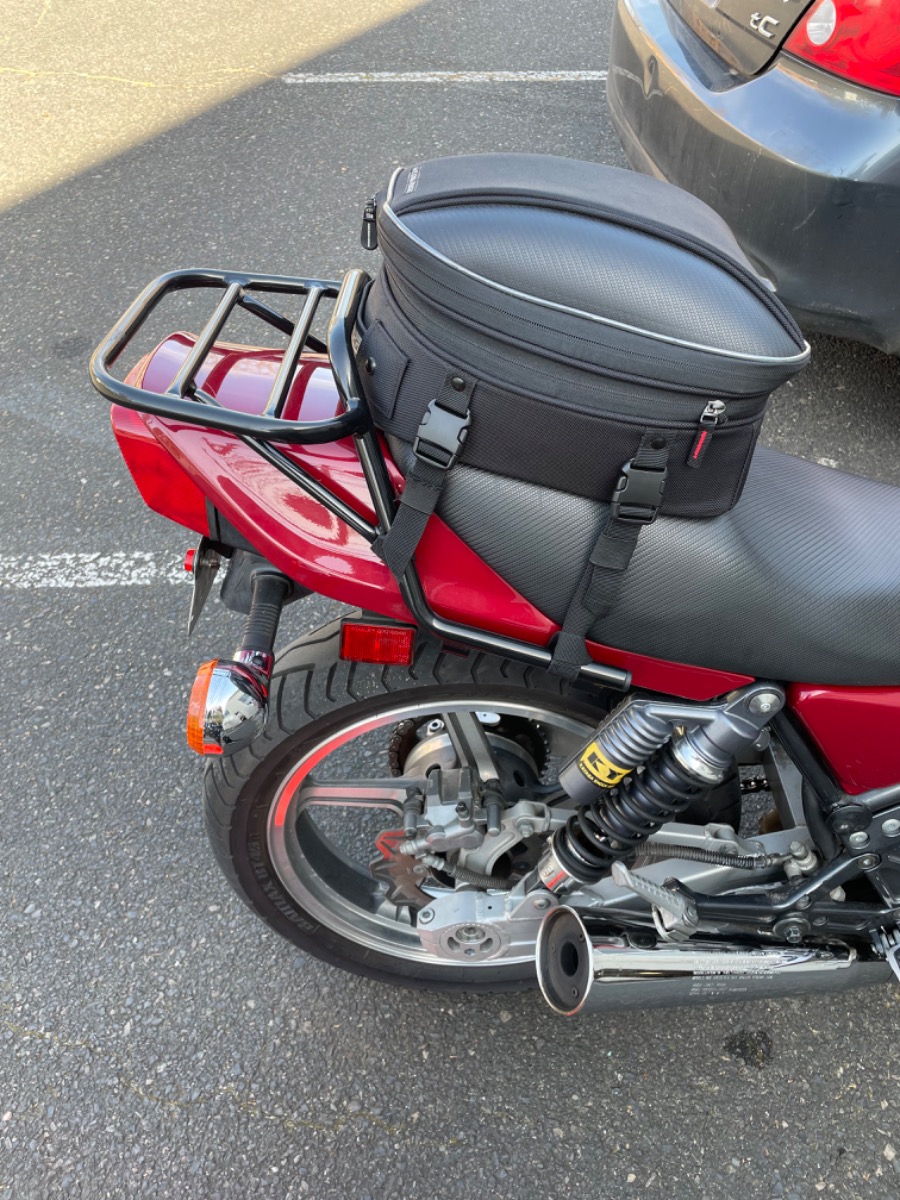

- Install the rear rack. I lost the luggage hooks in the accident, and I have a nice rack from Renntec that just needs to be bolted on.

- Posts: 6794
- Thanks: 4282
Re: Restoring Zephanie
28 Mar 2022 13:22
Bike is looking good, if you are happy with it do your mods in stages. Ref your brakes, it sometimes helps to clear stubborn air bubbles if you let nature take it's course (gravity bleeding) open both front nipples with pipes into a jar and leave for an hour or two (keep an eye on the fluid level so it doesn't drop too low and introduce more air in the system)
