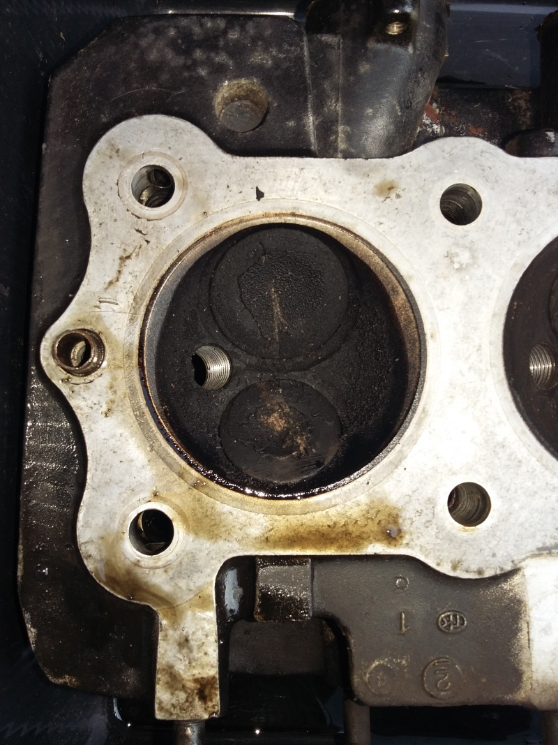

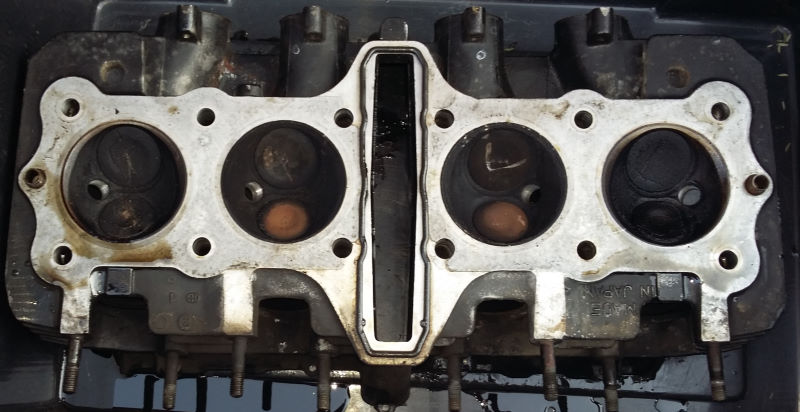

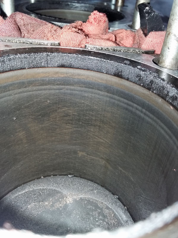

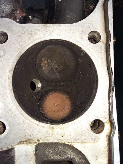

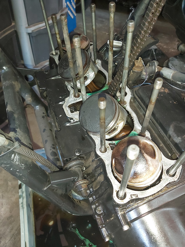

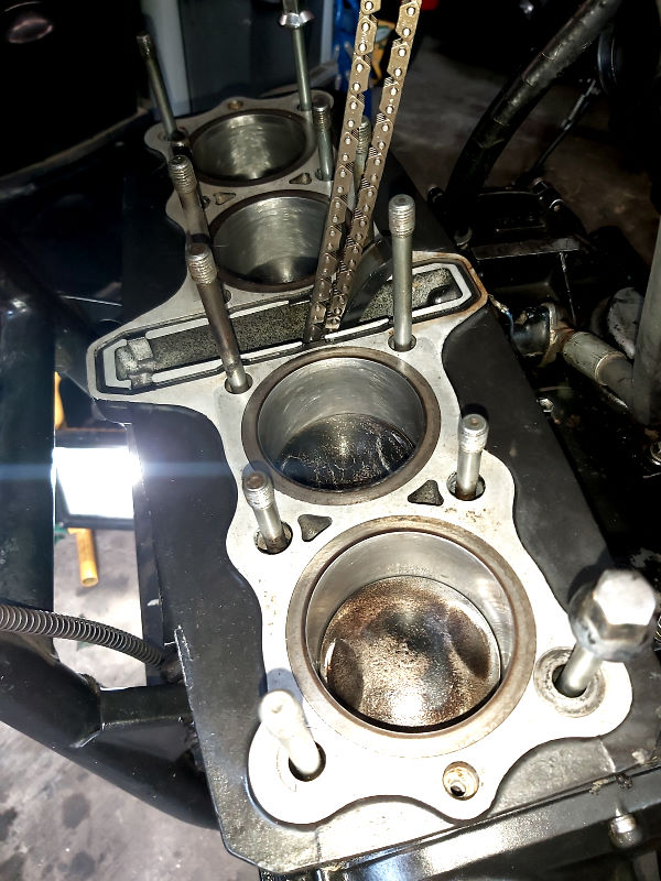

Cylinders 1 and 4 combustion chambers exhibited the same oily appearance, definately something amiss...
Cylinders 2 and 3 were somewhat less "oily" but still showed a lot of carbon build-up.
So, jugs off...Yesssss! I see pistons, in pretty good condition, skirts in fine shape...

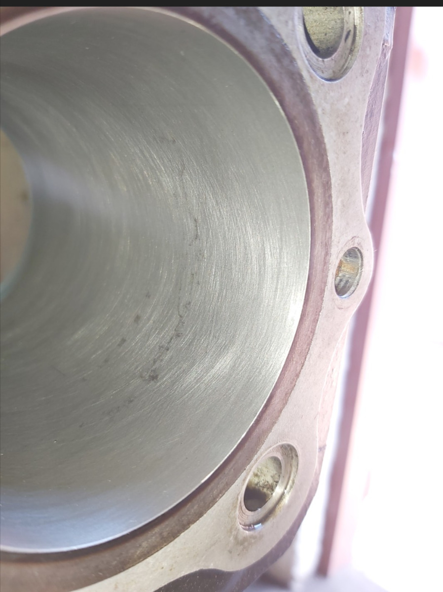

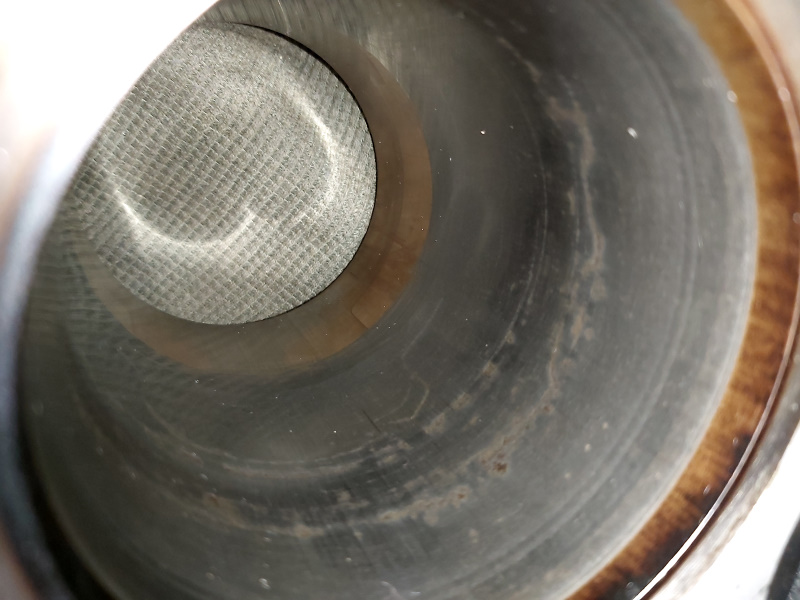

Cylinder 1 bore showed definate signs of moisture / condensation having been in there, maybe not for long, but marks left by the oil rings were clearly evident.
I have seen this before, specifically on the left hand side, as a result of the side-stand "lean angle" and the machine having been left un-attended for extended periods.
The marks were quite superficial: I could hardly feel them with my finger-nail so I was fairly confident that they would "hone out".
Cylinders 2, 3 and 4 looked ok, some "previous" honing marks still visible, leaving me to wonder what the previous owner had done....

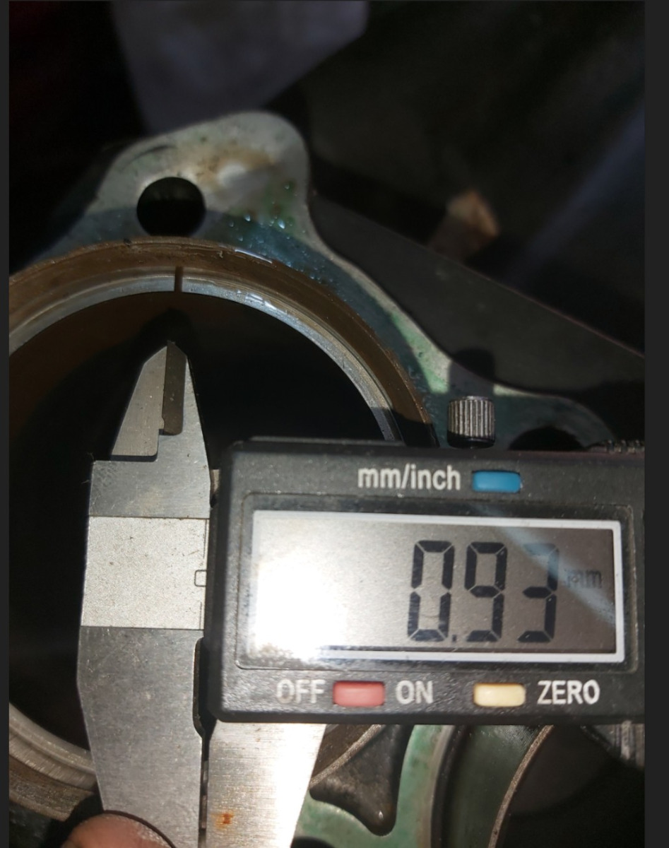

I removed the top compression ring from each piston and inserted them into the bottom of their correcponding bores...
Here is No. 1, looking from the top...
That ring gap is HUGE...
Now lets measure the ring gap at the top: 0.93mm
No wonder compression was way down. The service limit is 0.7mm !
Bore guage measurements proved no appreciable ovality, and arround 0.02mm difference in bore diameter top to bottom, so that's good right?

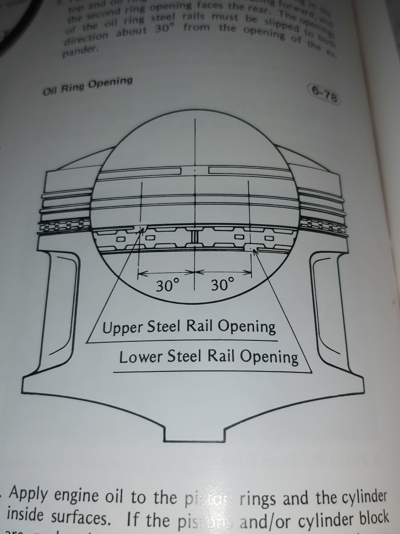

I have the Kawasaki "bible" for the KZ1100, in paper form, which is always nice to "thumb" through!
It shows some pretty specific instructions on how to place the ring gaps...

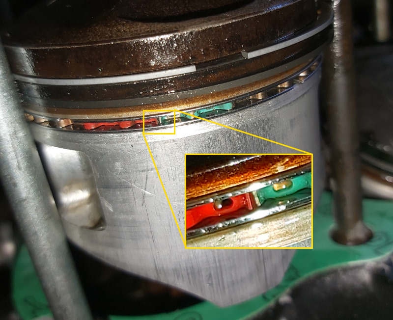

The rings that I ordered (Ebay seller GeorgeFix) are from the Nippon Ring Company in Japan, and are the exact items required.
A very handy feature these rings have is the oil expander ring ends are clearly marked in red and green paint, so that you can be absolutely sure that the "ends" propperly "butt" together and do not "over-lapp", as can easilly happen if not paying specific attention to this during installation.
I fit the rings to each piston, paying very carefull attention to their orientation and position, and slowly "squeezed them into their grooves.

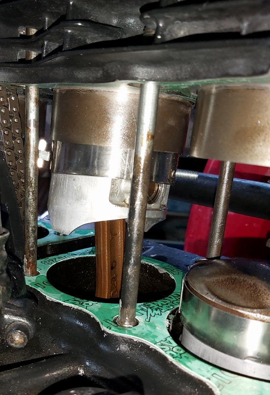

I slowly rotated the crank so that cyl. 2 and 3 were at T.D.C. , ready for the barrel.
I lubed the bores with fresh engine oil, then fed the cam-chain up through the centre and tied it up to the frame with some wire...
Slowly, very slowly, I lowered the barrel onto the two pistons...
Looking good so far...
Pre-entry...
(see, the top "rounded lip" of the hose clamp has been removed)
With the slightest of tapping, with my hand on the barrel, pistons 2 and 3 slid in perfectly, with ring squeezers sliding down each piston skirt.
I then removed the two squeezers....
Now, the tricky part... slowly rotate the crank while assisting the barrel, and pre-entering pistons 1 and 4 until all four pistons lined up horizontally, mid-stroke.
Note to self: DON'T FORGET THE REAR CAM CHAIN GUIDE ... which has to be inserted up the centre of the barrel BEFORE rotating the crank.
AND, don't forget the NEW BASE GASKET!
(I missed this step initially and had to start over, once that was sorted )
I was very pleased that pistons 1 and 4 slid in just as easilly, with light tapping on the barrel.
I removed the last two squeezers and slid the barrel all the way down onto the base gasket.
Pre-entry...

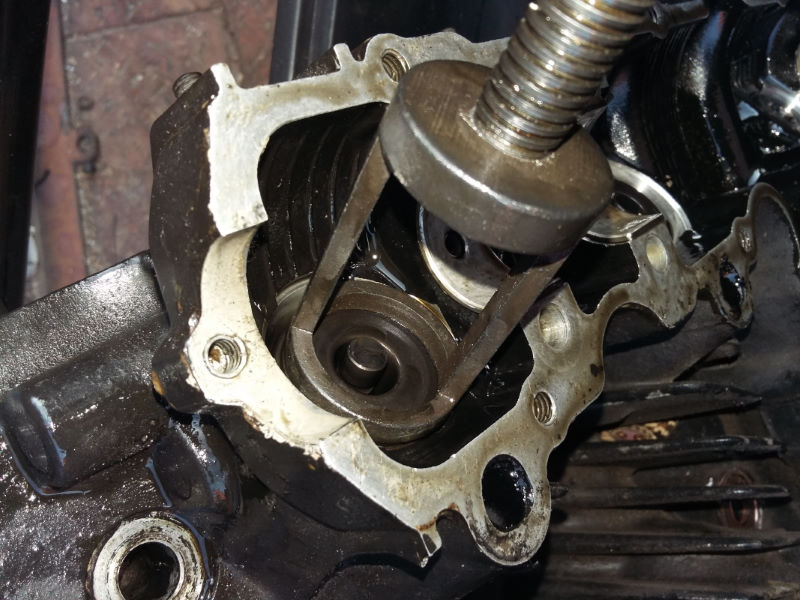

So, that being done, I set about re-freshing the cylinder-head.

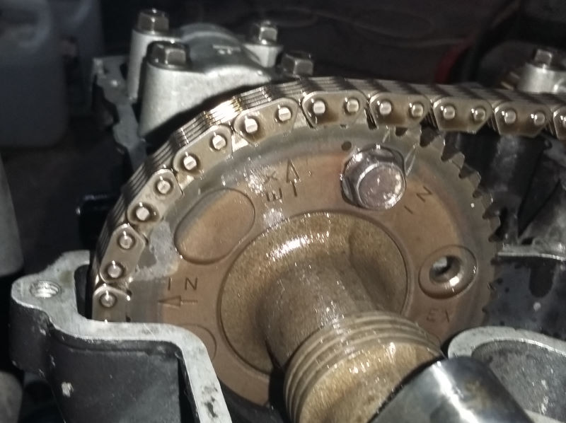

A while back, when I discovered that the cam timing was one tooth off, I had measured and tabulated the valve clearances.
All were in spec, and mostly to the "upper" end of the tollereance.
After clearly marking each valve, I disassembled them, keeping all the components for each cylider in it's own container.
Valve spring comresser in action....

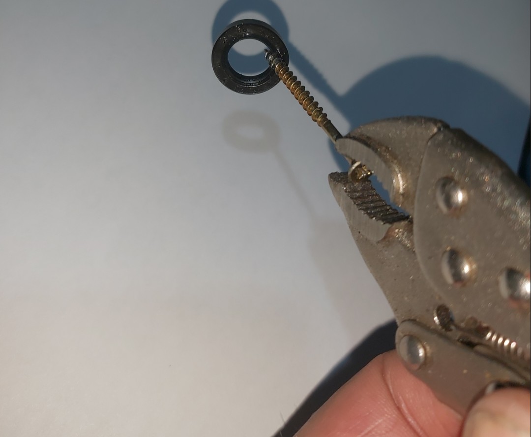

I removed all the old valve-stem seals, which were pretty hard and brittle.
I wish I had a proper tool to do this job... I ended up using an old wire-stripper, which kinda worked ok.
I inspected each valve in its valve guide, checking for side to side play... all good.
The valve seats were all in very good shape, giving credence to the statement by the shop owner (whom worked on the engine just before I bought the bike) that clearances were set and the seats were lapped but, stem seals were not replaced... Who does that ???
I then fit the new stem seals that came in the gasket kit that I bought from WeBike Japan.
Ok, so I reassembled the valves and springs, eager to get this baby together!!!

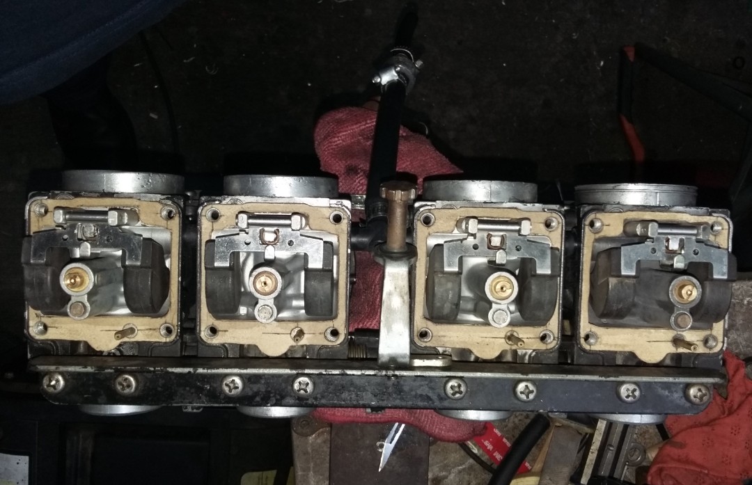

I had given the carbs a proper clean, new (home made) gaskets, new fuel needles and seats, and set the float levels...
(this is no trivial task, taking 7 or 8 attempts to get the levels set acceptably)
Also, I sand blasted and spray painted the diaphragm covers and float bowls with 2K satin black.
I had ordered new carb boots, and some pattern carb clamps from WeBike, so those went on too.

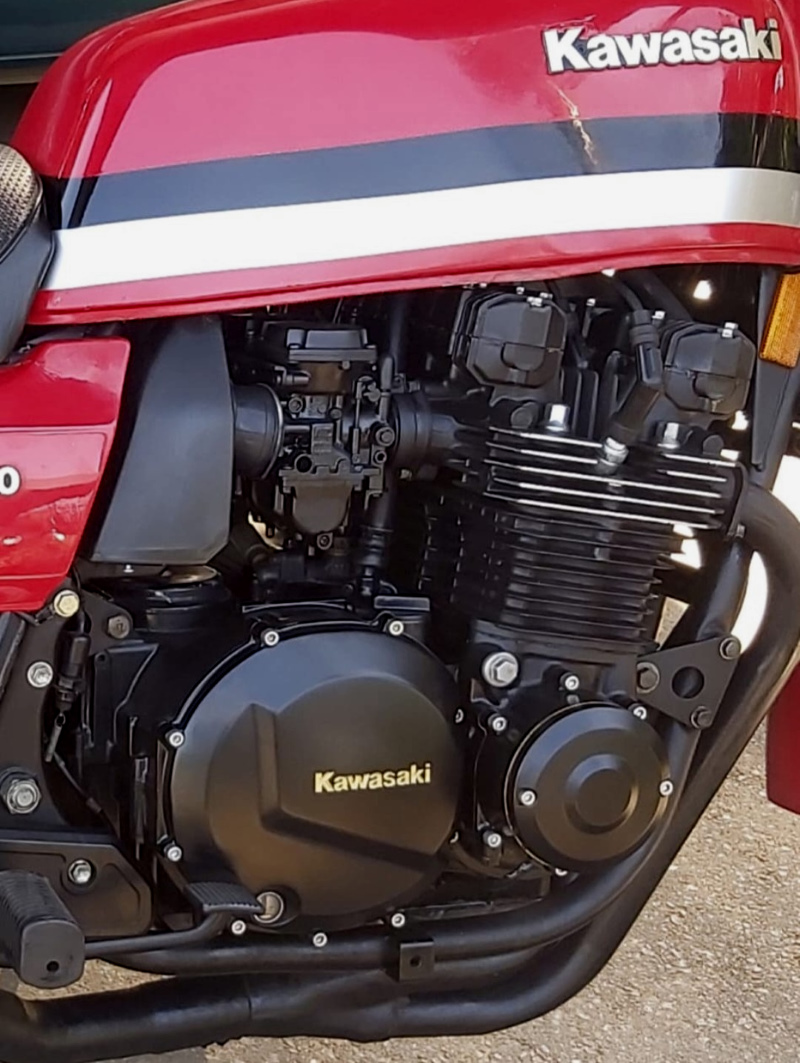

Time to test my work...
Choke on, Ignition on, I held my breath and hit the starter button.
To my absolute surprise, after 2 seconds of cranking, she fired right up.

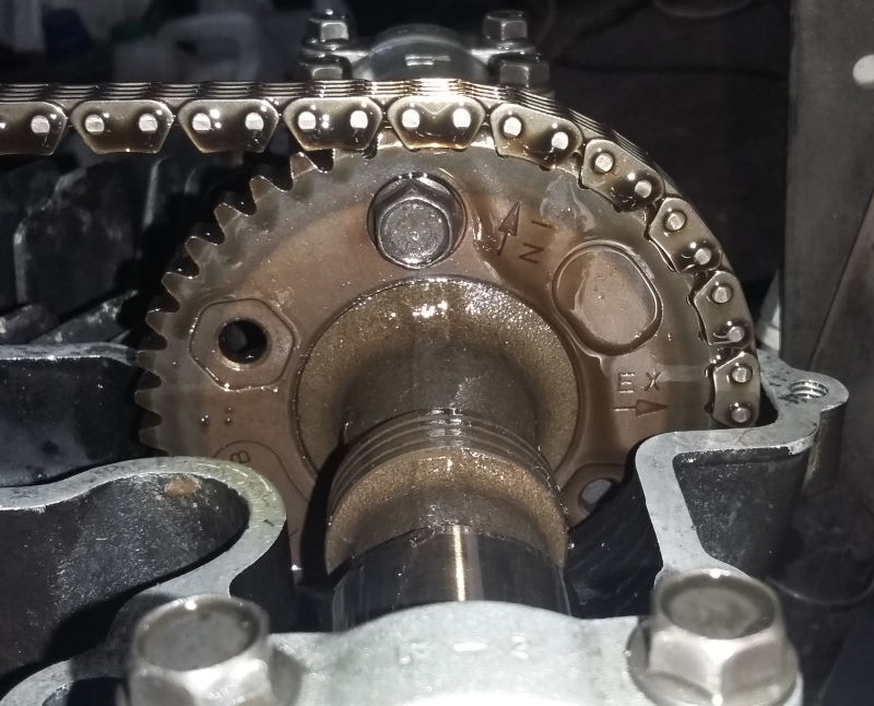

I bolted the head on- being sure to use the correct torque and tightening pattern, as indicated in the manual.
I was very careful to correctly time the cams...don't want egg on my face...
I rechecked valve clearances, and all were in spec. as before.

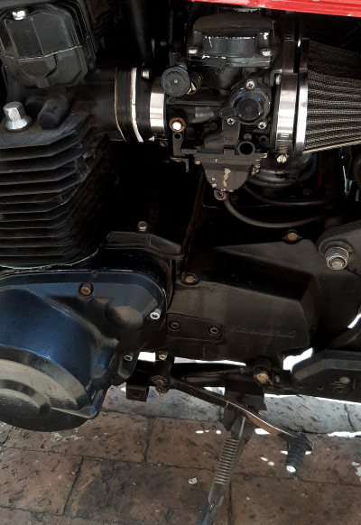

Once the carbs were mounted, I fit the exhaust and tank and plumbed in a new inline fuel filter.

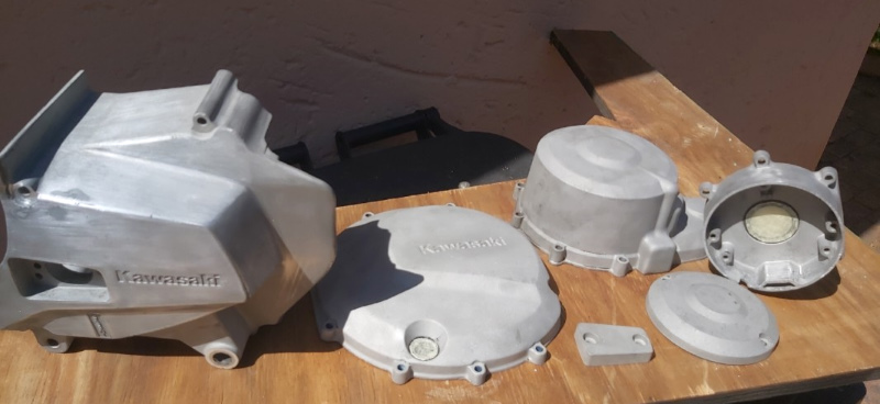

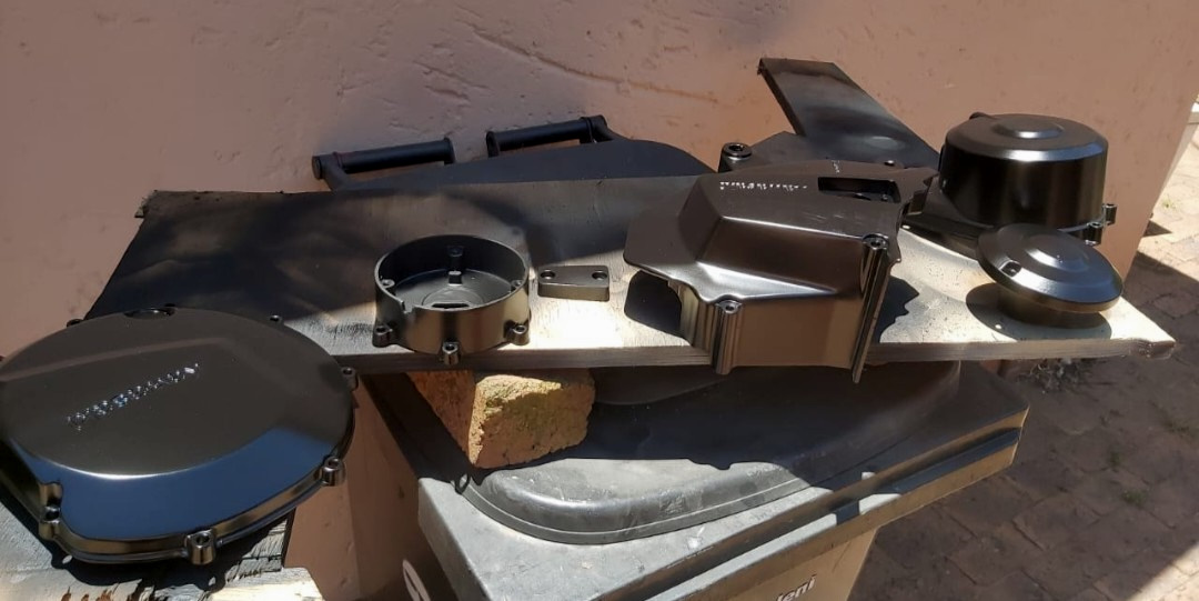

On my to-do list was to paint the engine covers satin black, and repair some cracks and "rash"...I have access to a sand-blast cabinet at work, so that made light work of removing the old paint.

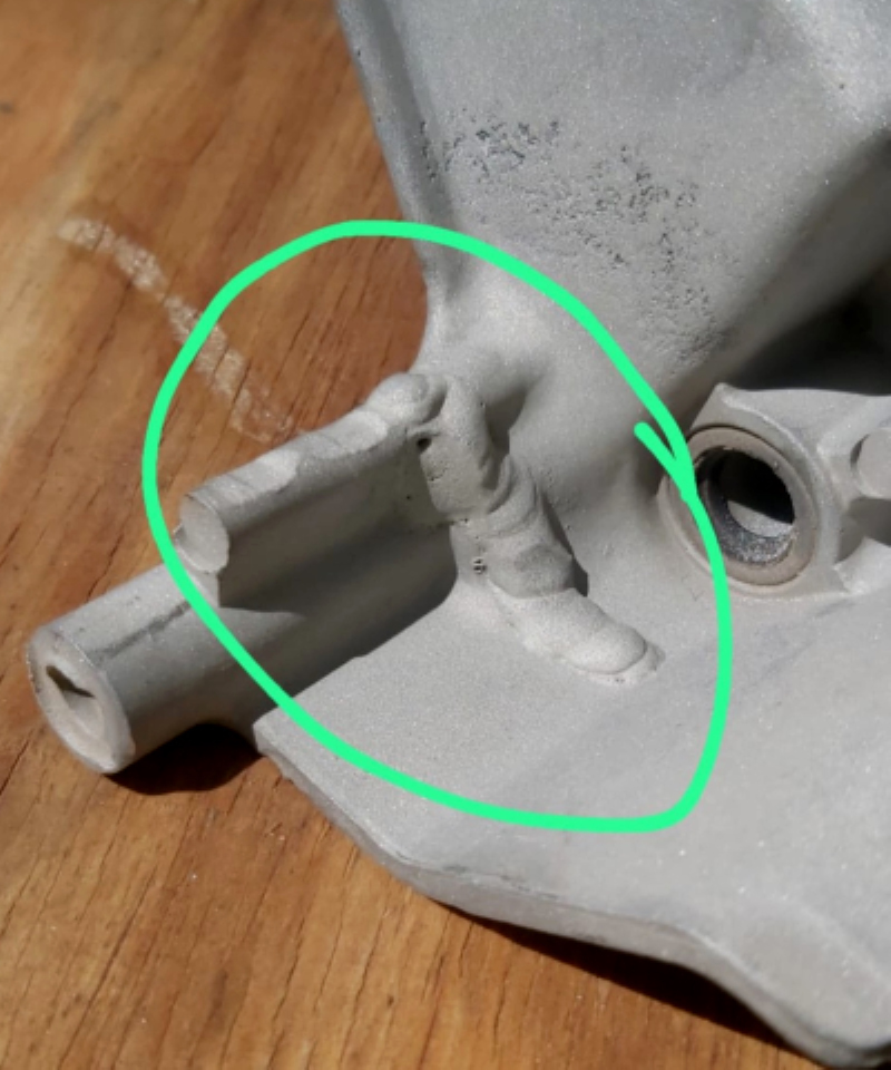

The sprocket cover had a bad crack (probably from a chain break) so that was tig welded.
The crack extended into one of the bolt holes, and it was impossible to weld the crack without slightly closing the bolt hole.
I fabricated a "spot facing tool" to kind of ream out the hole and clean up the face.
I was pleased with the result.

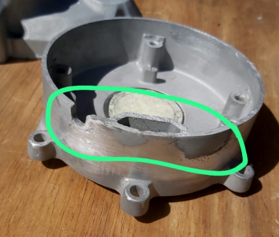

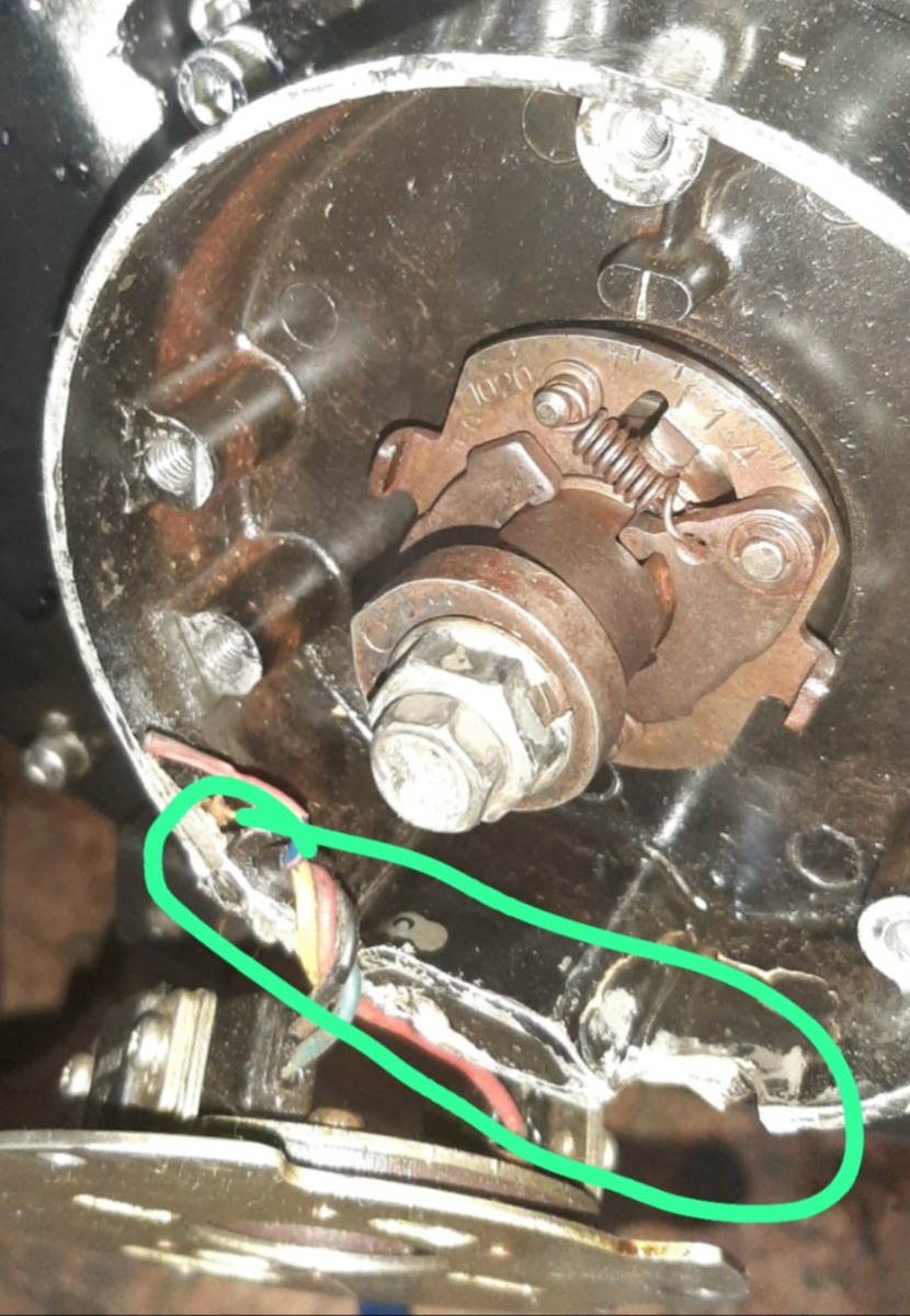

Also, the timing advancer housing had two big "chunks" out of it, so that needed to be repaired.
I repaired it with "Pratley Putty"
All the bits, prepped and ready for a light dusting of 2K primer...
Time to "get my black on" ....

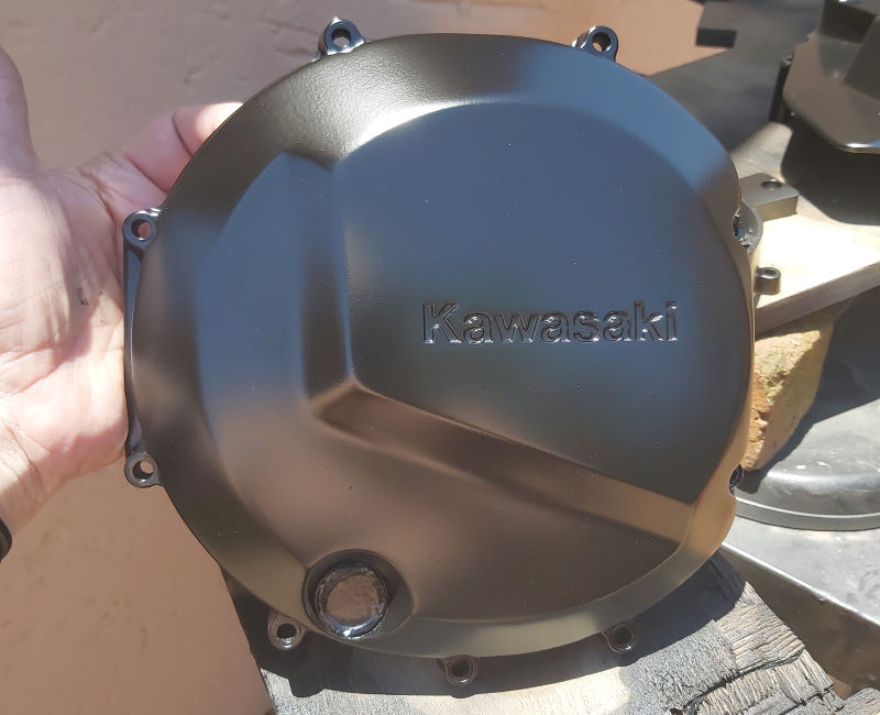

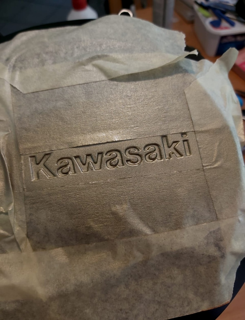

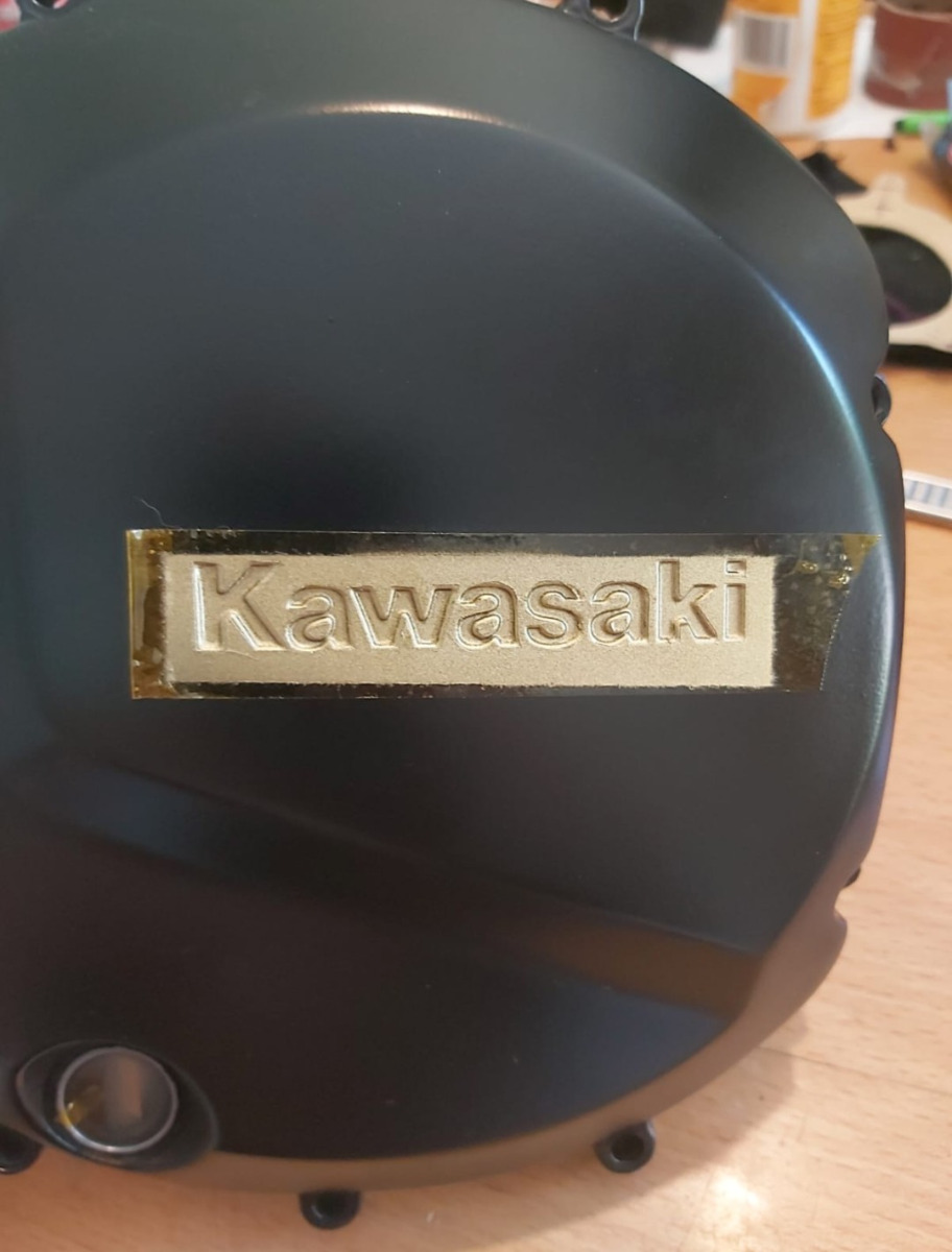

Here follows the sequence to get the gold into the sunken "KAWASAKI" lettering...
Mask off the area and spray gold, liberally.
Remove the mask... while holding your breath!
Then, with a clean paper towel, lightly soaked with thinners, quickly remove the excess gold...(This takes a bit of patience and a finger tip in the paper towel...)
The sprocket cover received the same treatment...
Here are the before / after pics...
Before:
AFTER:
Before:
AFTER:

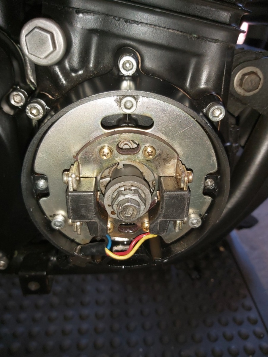

I also cleaned up the advancer, lubed it lightly.
It's looking good in there now.
While the clutch cover was off, I replaced the leaky shift lever shaft seal, using a large wood screw.
Simply screw it in about 6mm, then gently tug the seal out.
Slip the new one on and tap it lightly home with a tube socket over the shaft.
It was a 2 minute job!
