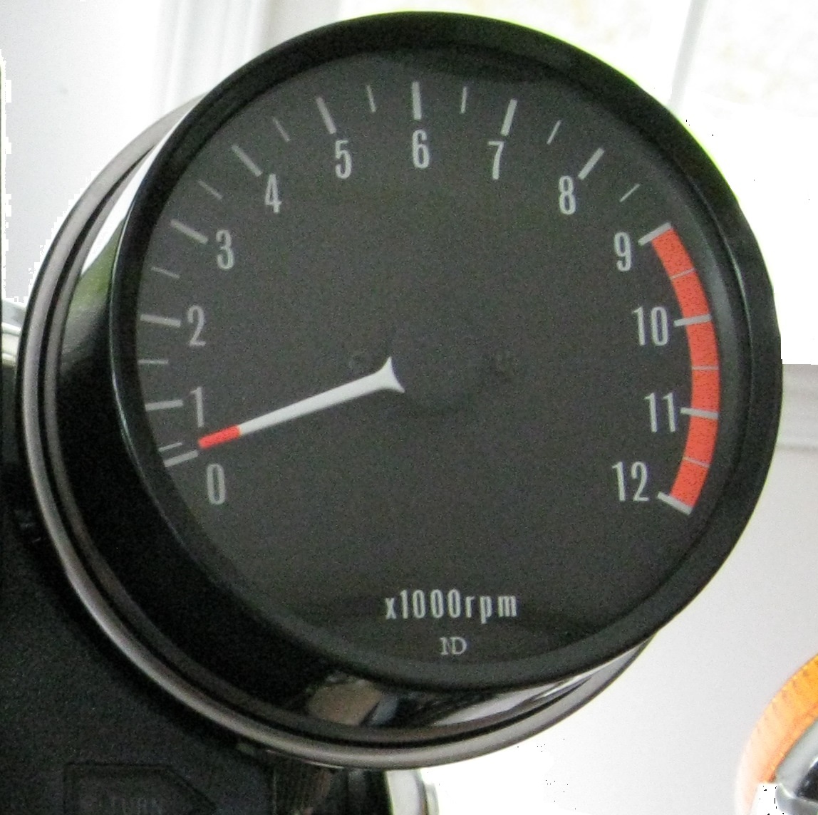

Below is a picture of my stock 1977 KZ650 tach. The outer edge of the dial is black. Later models had a blue ring around the outer edge. Ed

I believe the fit is the same. Ed

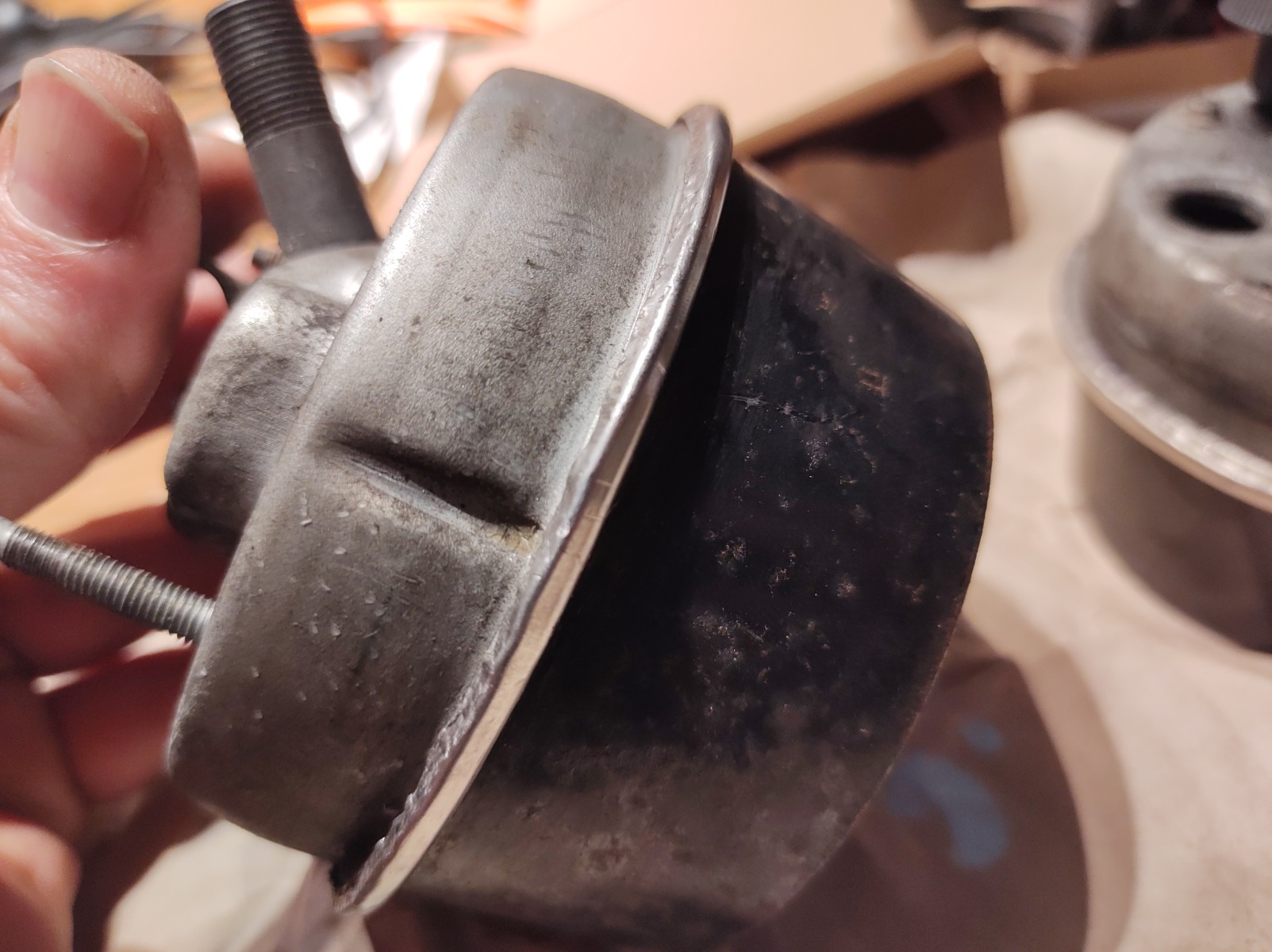

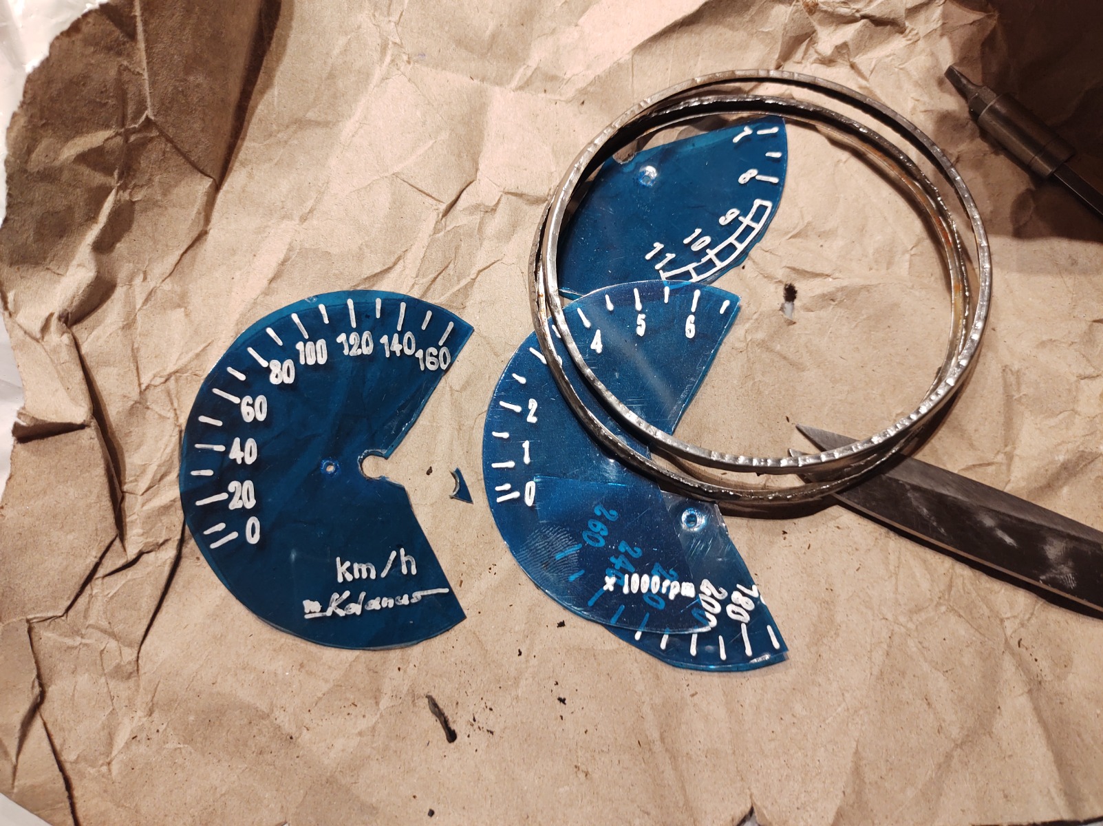

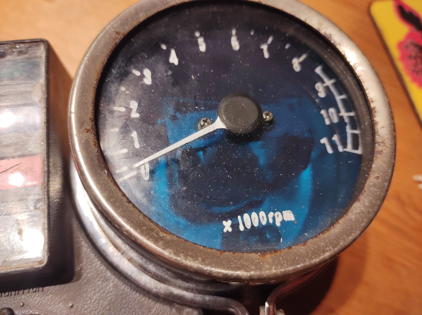

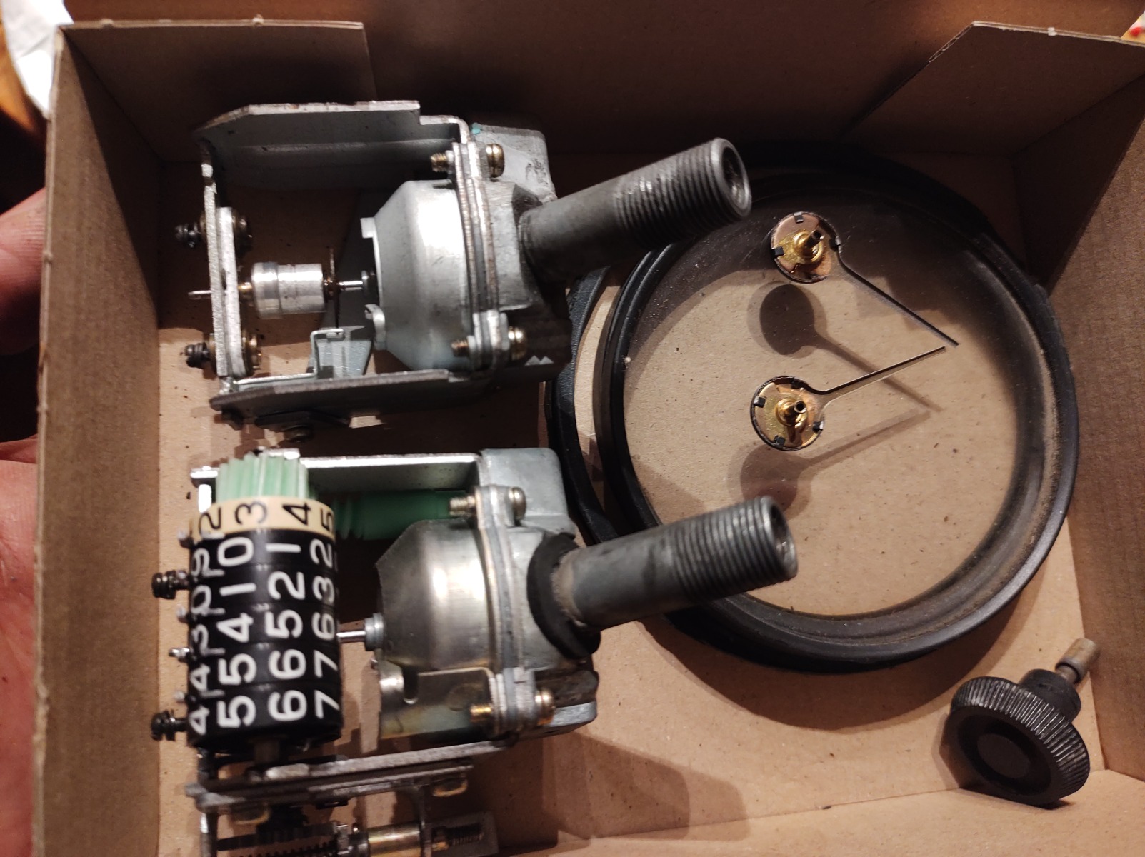

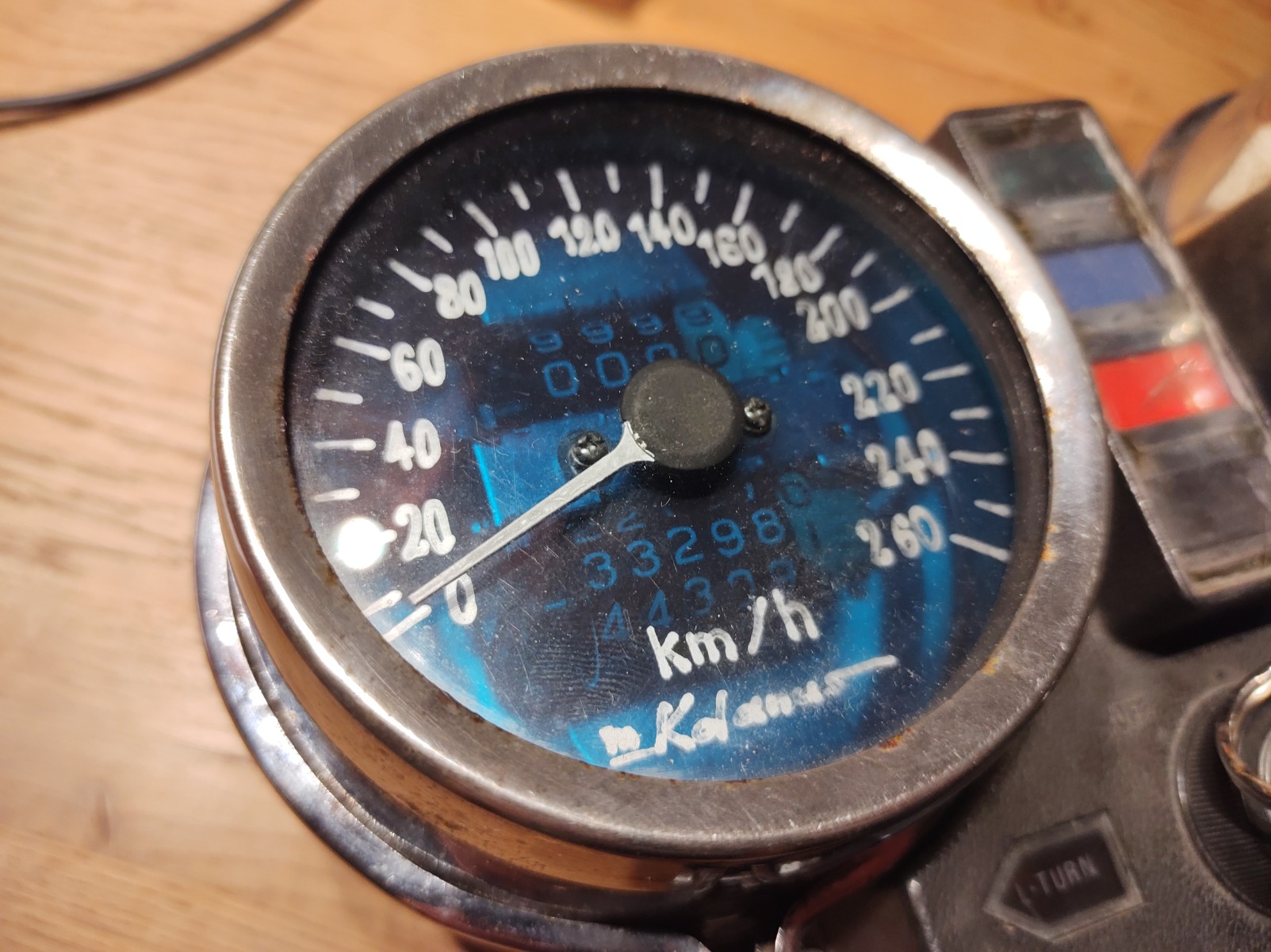

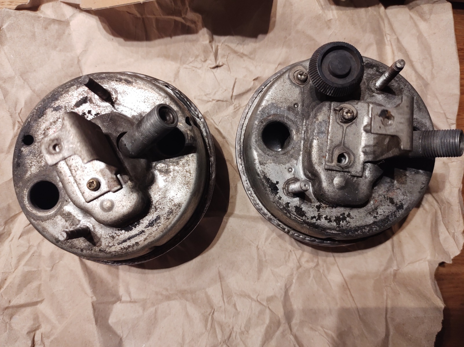

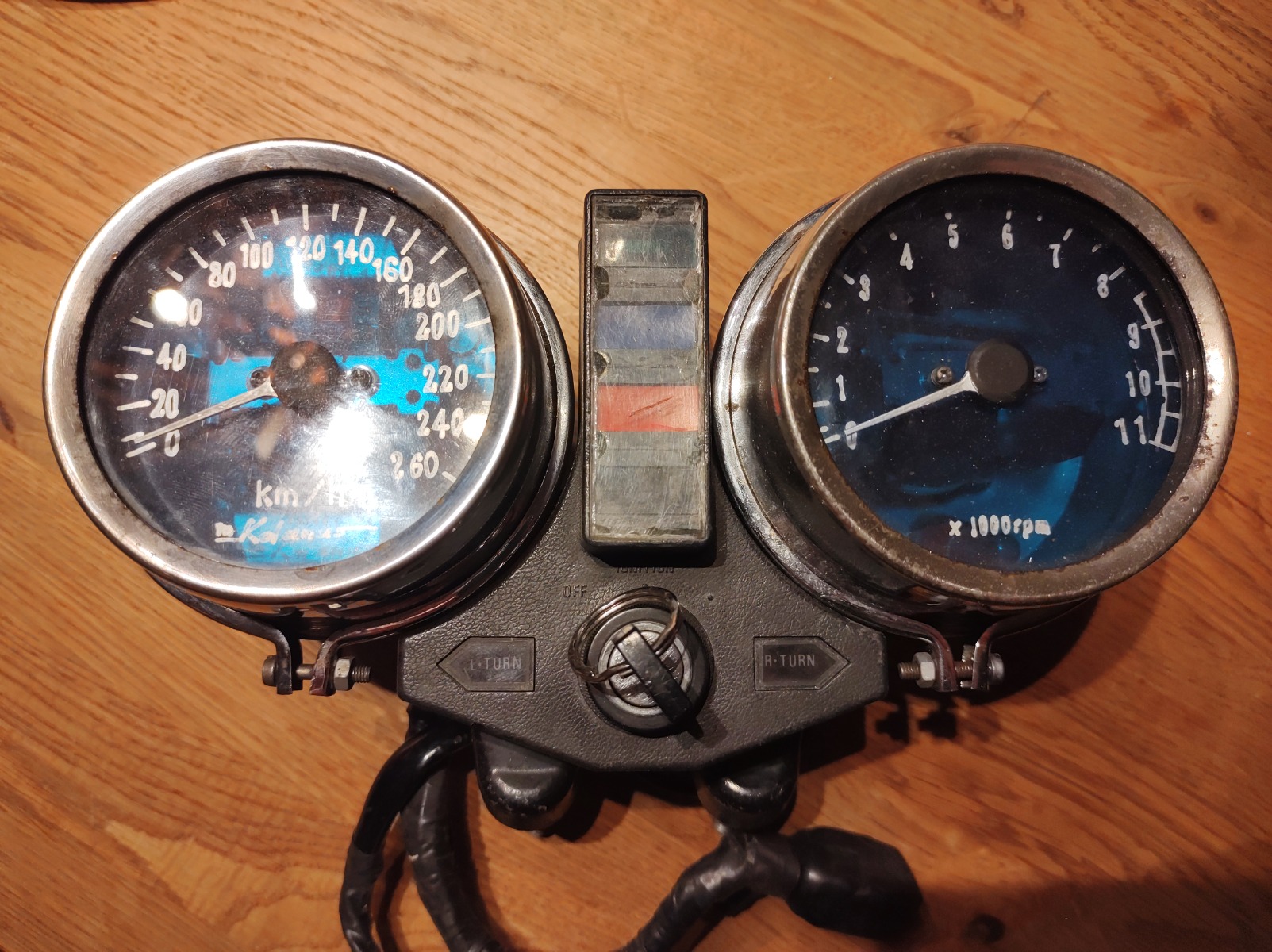

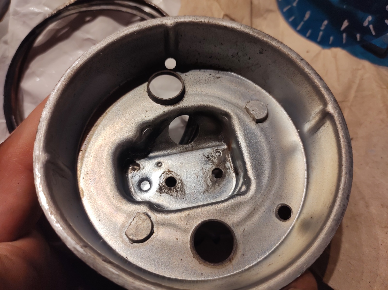

So these absolute gems arrived today
Yes, that is some transparent blue plastic that someone cut to fit the meters! An yes, the needles have been painted silver
The rings have taken a bit of a hammering but both backing plates and one front housing are perfect, the other housing has some minor dents in one spot that can be easily tidied up and then put at the bottom for good measure. Both needles were smooth but the speedo returned to zero quite heavily. Think that may need to be sent out to get the damper fluid replaced. Will need a bit of hair wax(?) to whiten up the 10ths wheel on the trip meter and odometer. Other than that they will make a good set of meters.Does anyone know if you can get a replacement for the rubber seal under the crimp rings?
