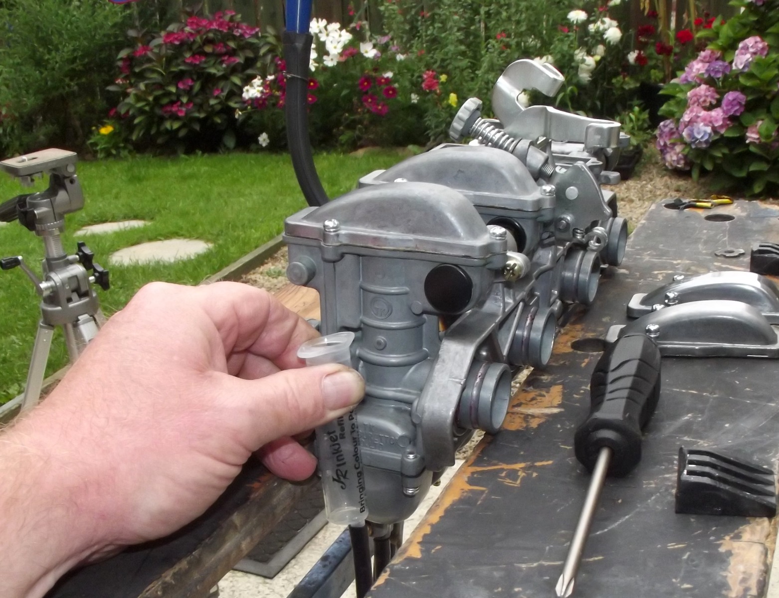

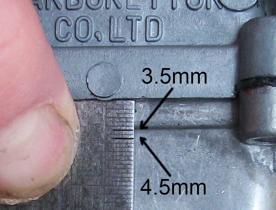

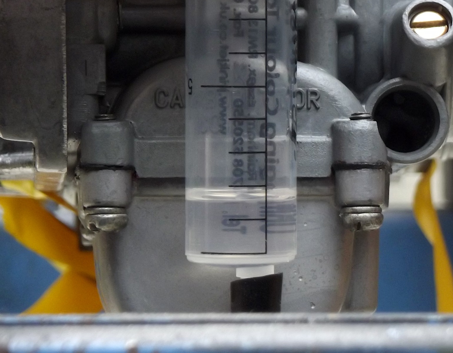

The first job will be stripping down the carbs (yet again) and getting them set up at least enough to get the bike to run. Fine tuning can happen later !
To measure float height, I finally went out and bought a proper tool.

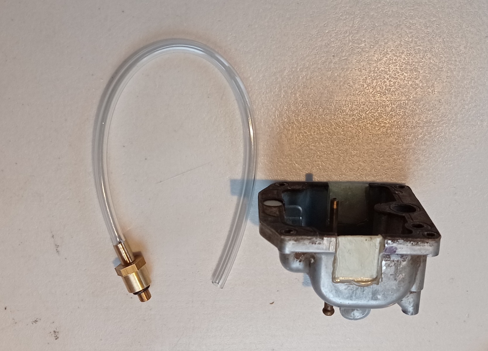

Next to it in the photo is a thing I made from a spare float bowl. The windows were originally clear, but have misted over due to the effect of the fuel - it still works, because you can see where the fuel comes to. It works well on the outer carbs, not so well on the inner ones.
Somewhere I've got a home-made version of the posh one, with a drilled brass screw, but it came apart after a few years in the toolbox. I might repair it at some point. It gets me closer to being able to measure all four float heights at the same time !

I use a piece of clear tubing (or rather 4) like you have that's been pencil pointed so to speak using a grinding wheel. The tube is threaded into the float bowl drain hole and tightened as tightly as possible. Works fine and is cheap.
