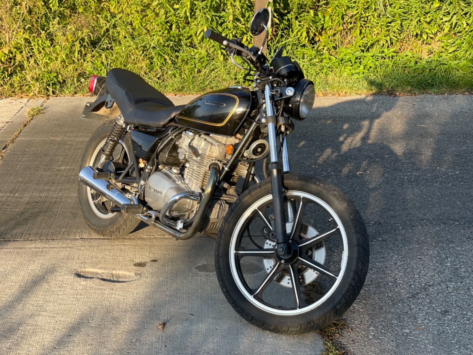

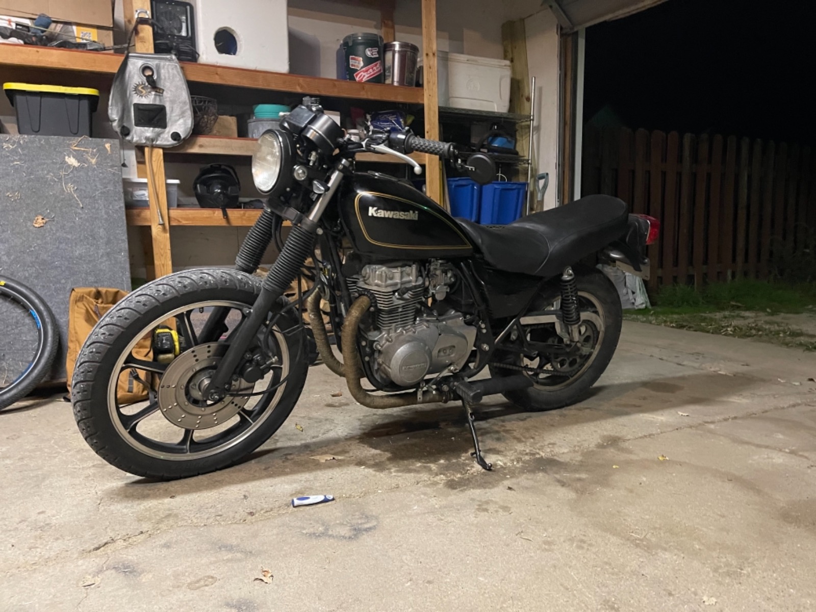

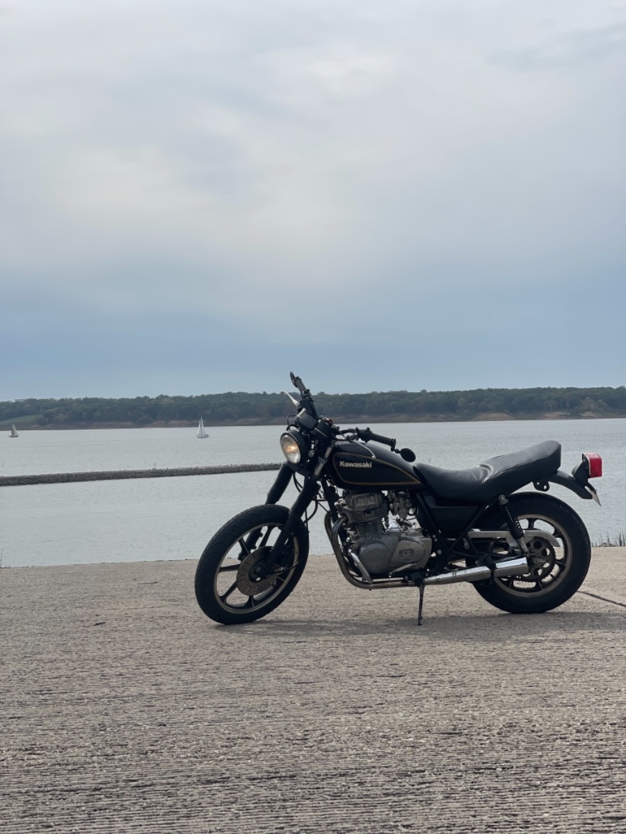

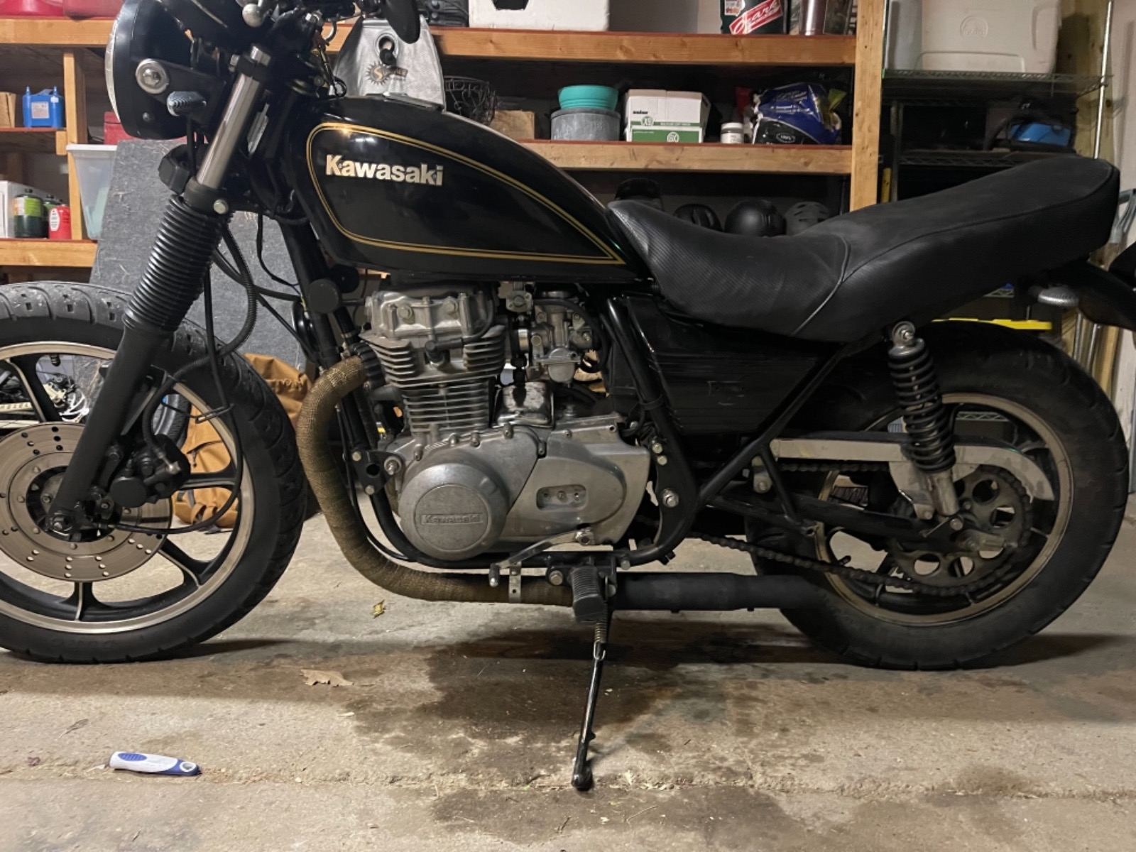

Recently picked up my first bike, it’s a 1980 kz440 with just over 12k on the clock, paid $900. Been doing a few bits to it to make it my own. It was missing the air filter and filter housing, as alot of these bikes are from what I’ve read. I bought the 3D printed model from eBay and it’s been working great. Changed the oil, new grips, ordered some badges and bars. Old bars were bent a little bit, wonder if the bikes been laid down? Anyway serviced the fork with 15w, still feels kinda soft may consider the a stiffer spring? Does anyone have an aftermarket spring in this fork they like? I’m 170ish but I like a firm ride myself and my girlfriend rides with me alot and a bit more support would be nice. There were no rear signals on the bike so I threw on some cheapos until I figure out a different seat. Fixed the horn. Threw on some bar end mirrors, fork boots, and latest project i just finished tonight as I post this, ordered some black mufflers (I hate chrome) to put on and figured I’d wrap the headers when i had it all apart. Couple photos of it when I got it and what it’s looking like now! Thanks for lookin/ any and all advice would be greatly appreciated

It's not a cafe racer, but it is a huge improvement over the stock 440 LTD.
When you have a chance, put a front fender on it: the OEM front fender contained a heavy-ish metal bracket that served as a fork brace. Those 33mm legs need a little support - the front end will be more stable with a brace.

As for making a cafe bike out of a LTD (swayback) you'll need to flatten out that seat. I used a fiberglass assembly on my cafe XS650. Check out some of the cafe builds on Do the Ton for some ideas on how to go about it. Regrettably the forum section of KZ400.com is a mess as there was a lot of good information there.
