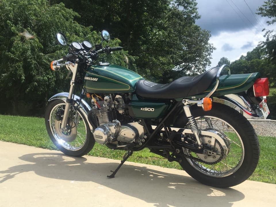

02 Oct 2021 07:37At Mid-Ohio this year, Kaz bought a very nicely restored '76 KZ900 from the swap meet vendor next to us for something $9,850 USD. That tells us that they're likely bringing $13,000 ~ $15,000 in Japan.Kidkawie post=856018Thats how you want to buy them, not butchered up. But, am I the only one that thinks he overpaid?
If the intent is to restore & flip, one might be able to recoup hardware & supplies cost & break even. Maybe. If the intent is to do a cleanup/resurrection just to have a safe & reliable daily rider that retains patina & originality,. then the purchase price doesn't seem unreasonable, especially considering that KZ900's likely have nowhere to go but up in perceived value.
