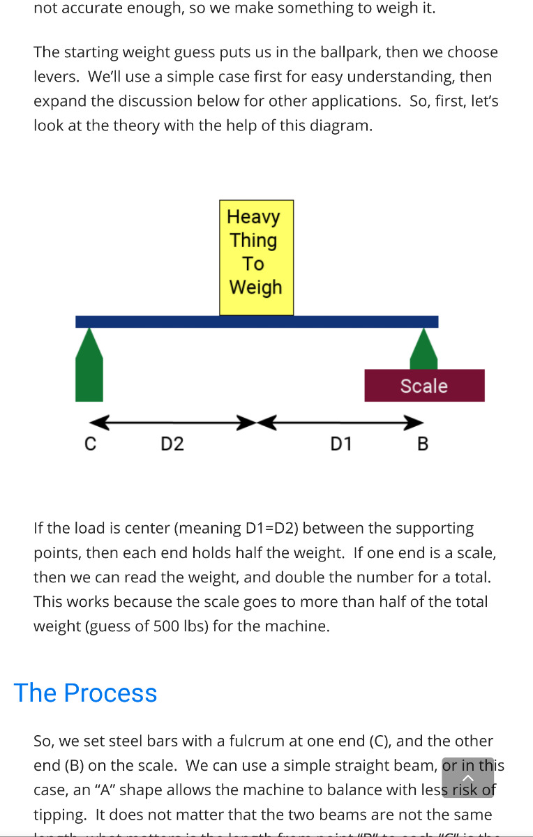

Re: Tire Load
13 Sep 2021 18:01 - 13 Sep 2021 18:07
You surely can weigh you and your bike with a bathroom scale.
I weighed my Chevy 1/2 ton with a $20 Wal-Mart 300lbs max digital bathroom scale.
You have to use a lever.
