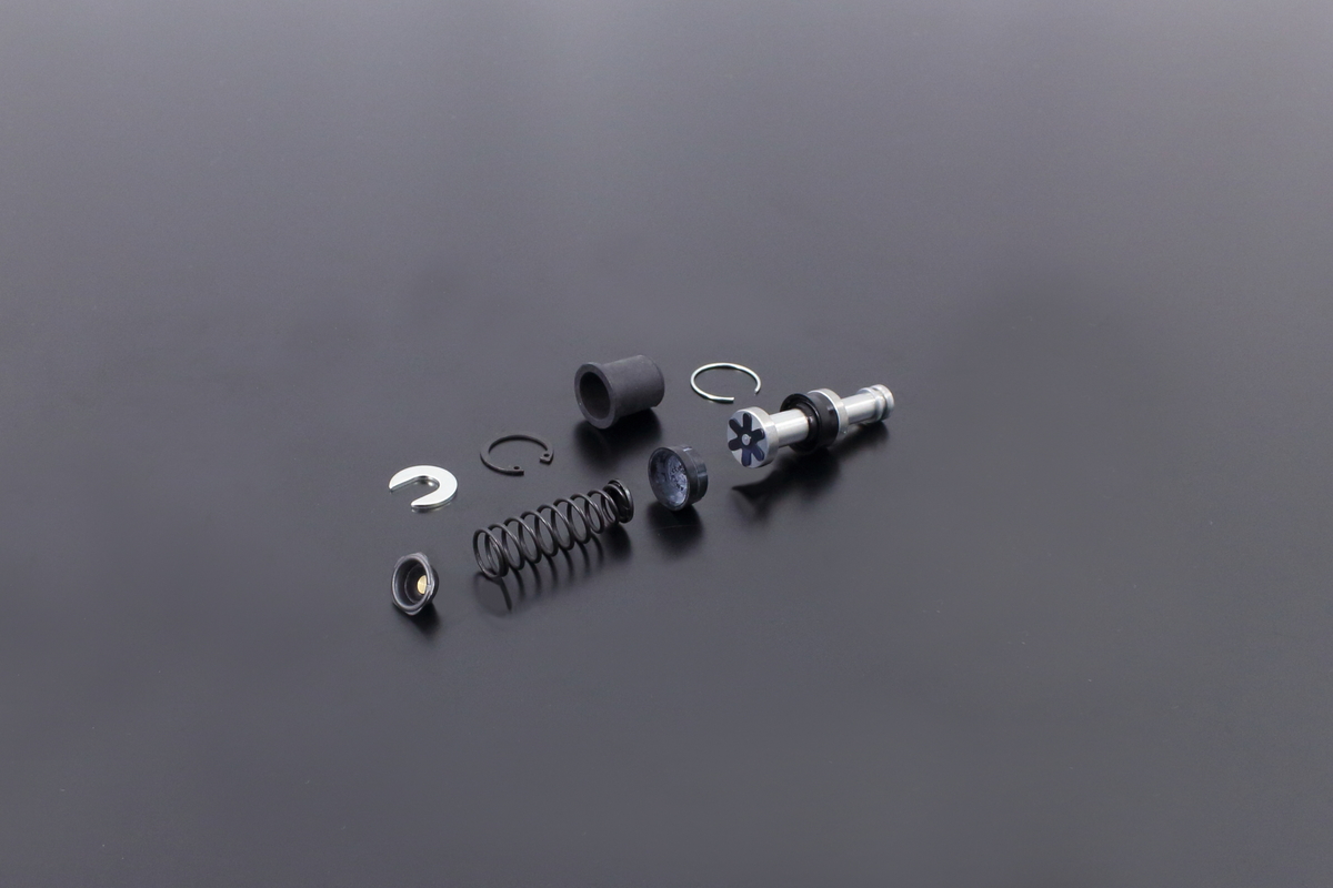

Working on my master cylinder and I’d like to verify the assembly order and orientation. Does this look correct?
the manual and parts manual are a little vague.
thank you
thank you
- Thanks: 2260

- MauiZ1
- Posts: 235
- Thanks: 25
Re: 1973 Z1 Maui
22 Oct 2021 07:52
Thank you, I was wondering if I was seeing the manuals wrong. The illustrations aren't very good.
The FSM skips over a lot of details.
