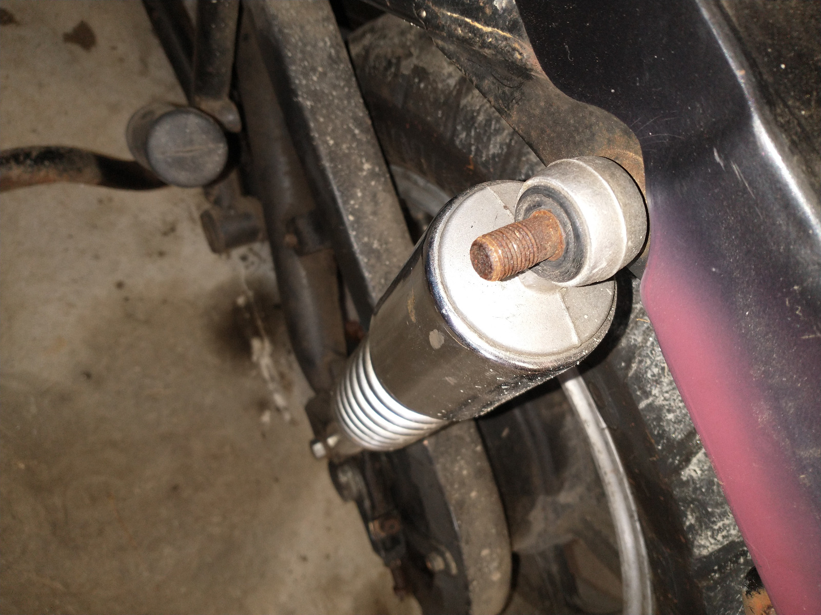

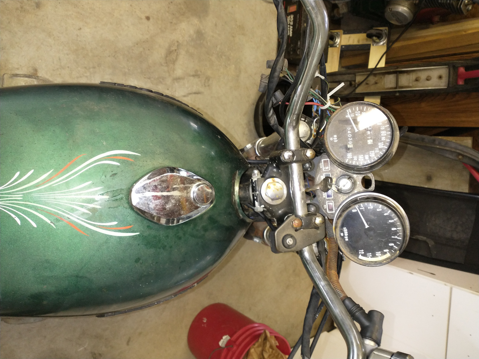

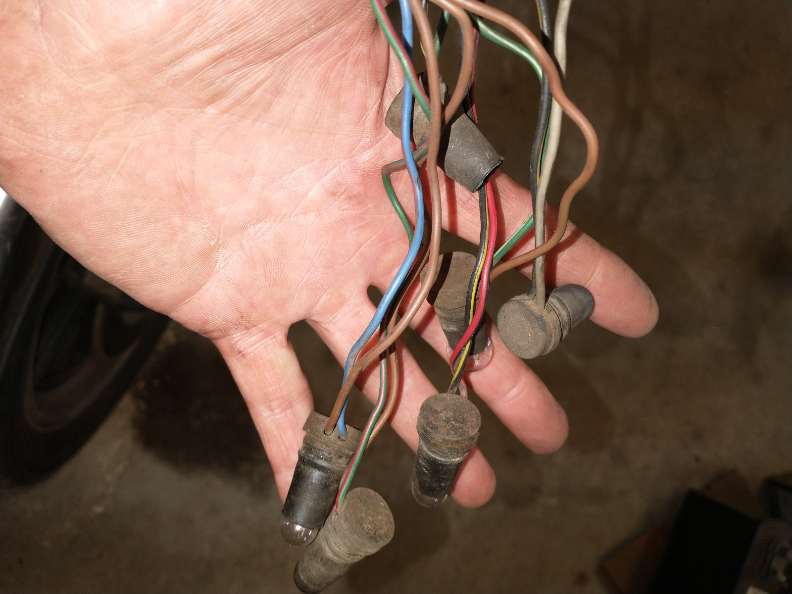

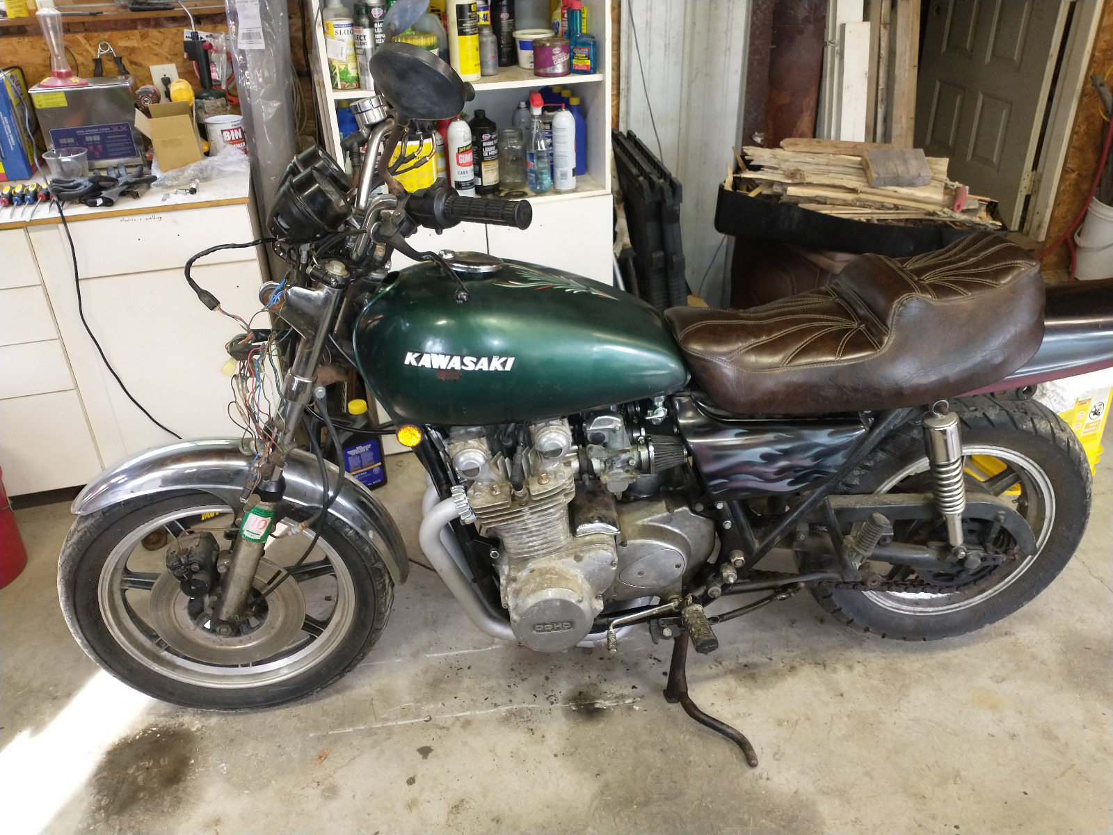

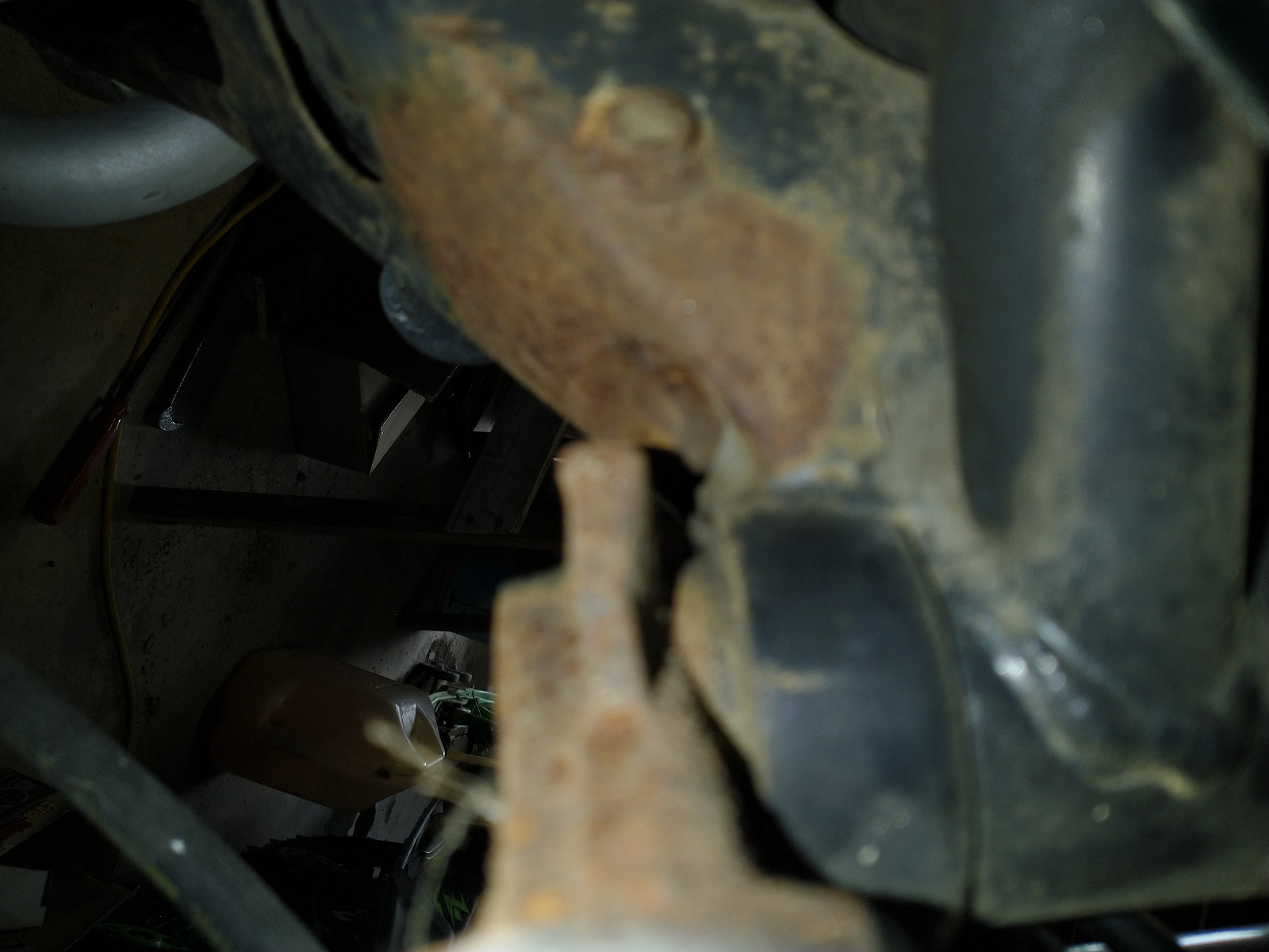

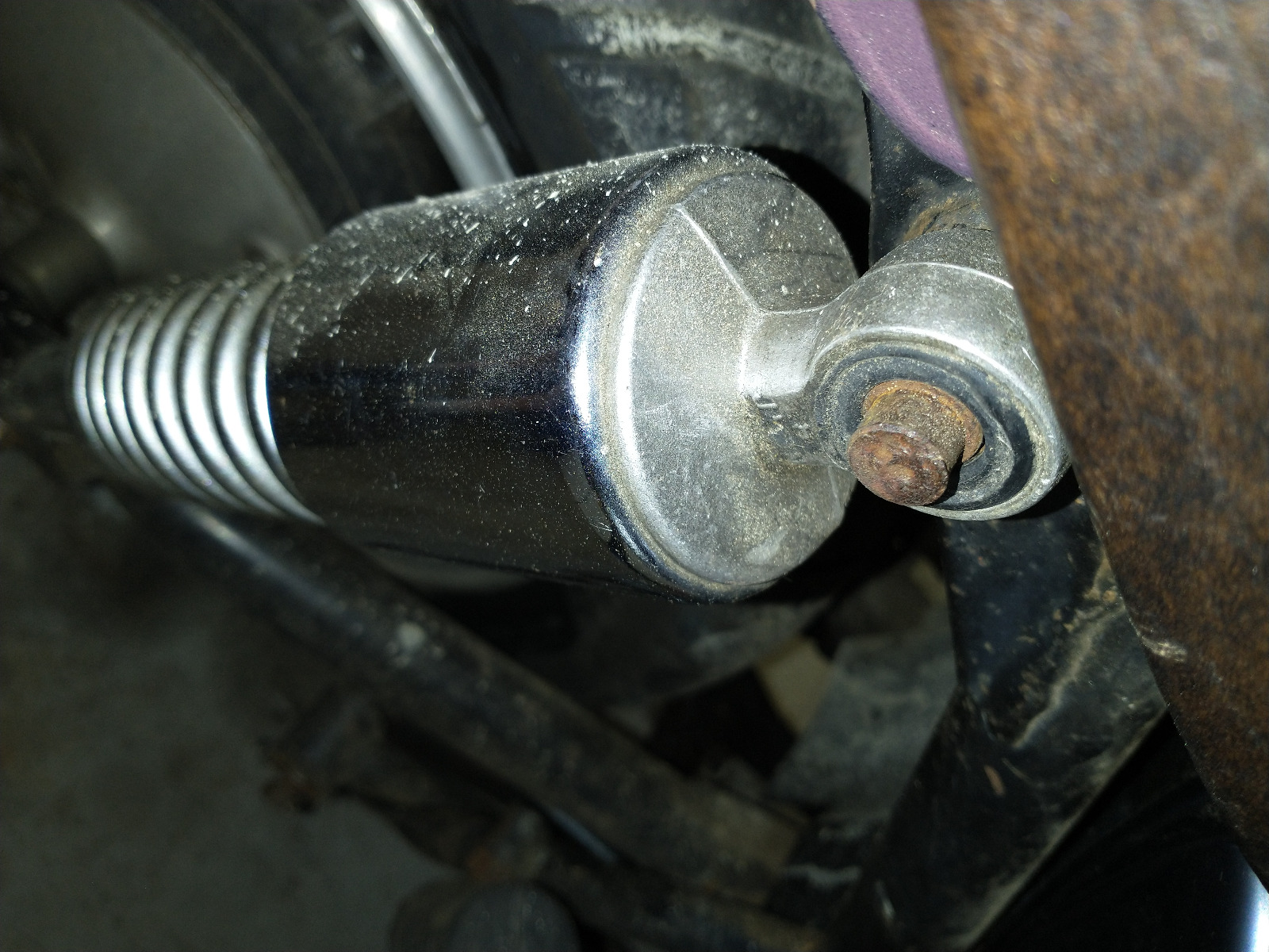

I've had this for a while, won't bore you with details, bike has many issues; bent steering stop, broken rear shock stud,messed up wiring, wrong steering stem head and gauge pods, gutless kerker...It will be a driver (hopefully) not a restoration, but any input will be appreciated

Worse ones have been brought back to life. Ask any questions you have, there are some amazingly knowledgeable and talented folks around here.

Sorry, meant to post project updates too. Finally got the right stem and head set so I could install correct dash and idiot lights, new tires, mac baffle for my $100 beat e-bay kerker, which sounds amazing. Motor is a 78 kz1000 b2 and carbs which have the 3rd carb vacuum port which I plugged after the first ride. carbs only have pilot air screws on bottom back of the float bowls, looks like the idle air screws are blocked off. The bike runs well enough to drive,but pops once in a while, sounds a little off, btw haven't synced carbs but bought the vacuum gauges to do it. today i will fab a center stand stop so it doesn't hit my chain and work on a horn.

You have fuel adjust pilot screws. They might still have plastic caps on them. Emissions standards made Kawasakis cap them to limit end user adjustment so the bike would pass test. They can be removed, every set I have the caps are removed so I really don’t know how to but assume grip them with a set of needle nose and pull straight down.
Johnny’s vintage in Ohio sell a center stand bracket cheap if you’d like to look into it. www.johnnysvintagemotorcycle.com/product...enter-stand-stopper/
Popping is usually a symptom of air sneaking in, might need new carb holder boots.
