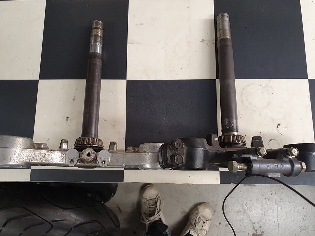

I was a bit surprised when I found out that the steering stem was not the same on the ZX1100A2 and the ZR1100.
So ok, just need to press out the stem from the lover yokes.
Right! On the ZX1100A the lover yoke is fixated with a spring dowel pin, tried all the tricks in my book trying to pull it out, but ended up resorting to drill the pin out. Spring steel is bloody hard and a mess to drill.
Thought I got the spring dowel out, but when I was trying to pressing it would not “pop-out”. So I resorted to uber violence and it finally gave in.
Unfortunately all that pressing had mushroomed the stem and it had to go up in the lathe to be touched up so the top yoke would fit.
Then pressing then ZX stem into the ZR lover yoke and we were on the roll again.
With that the new fork is fitted and the steering lock will actually work this time, but I don’t think I will fit the dowel pin.

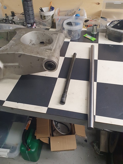

So now it’s time to try to fit the ZZR1100C swing arm.
The Gpz1100A2 frame is 260mm over the pivot, the swing arm is 252mm over the pivot and the swing bolt is 18mm in diameter. The missing 8mm is taken up the indented spacer and the swing bolt.
The ZZR1100C swing arm is 256mm over the pivot, 262mm over the pivot tube inc the spacer and the swing bolt is 20mm in diameter so some shaving of the swing arm is necessary.
I took 2mm of each side of the swing arm using a good old file, much like Allen Millyard and then refitted the seals.
Now the spacer on the right side also had to sacrifice 2mm to flush with the swing arm seal.
Even the pivot tube that now is protruding a little bit too much on the left side also has to take a beating in the lathe. I was I bit reluctant to try to shortening it in our lathe as the pivot tube was too big for the head stock and the pivot tubes are usually hard as hell and a bitch to turn in the lathe. But I had to give it a try even though it protruded in a scary way. Low and behold it was not bad and it didn’t judder even though I was cutting with inserts made of chineseium.
Then the swing arm can now be wiggled in to the frame and I could hang it up on the original swing bolt.
Looking at it, I guess I can just as well make a new swing bolt from a centerless axle instead of making a sleeve to make up the missing 2mm on the swing bolt.
With the Swing arm in place, I tried out the ZR-7 rear wheel. It’s not a perfect fit. It might be because I fitted a hanging brake caliper holder, as I am planning to use a brake caliper from a ZXR400/750. So spacer will need to be fabricated but first I need to center up the wheel in the frame and make sure that the chain will line up.
But before that can be figured out, the new swing bolt has to be fitted to make sure that the swing arm is fixated.
Except for that, the GSX-R600 K1 front brake caliper also showed up in the mail, that’s a given as I know that they works on the Zephyr 1100 forks. I just need to source two brake discs and turn out the top-hat spacers on the lathe in order to handle the M10-M8 caliper bolts and disc spacing situation.
Next up is the suspension linkage and figure out what shock and dog bones to use. I have got these from a GSX-R 600 wonder if they will work?

Started with whipping out the left side spacer for the front wheel on our trusty old Blomqvist lathe.
Works as intended and the wheel aligned beautifully even though I can’t for my life remember what bike I took it from, speedo accuracy will be interesting.
Next up I pulled out the 20mm centerless axle that I had ordered, here with the original 18mm swing bolt for reference.
It fitted the pivot sleeve like a charm, maybe just a little bit to good, guess I will have to shave of a few 1/100 mm if I am to zinc plate it.
But when I tried to put it through the headstock of the lathe that is supposed to be 20mm I run in to trouble. It’s not 20mm, more like 19,85 so my plan to turn one of the ends down and thread it to M16x1,5 went out the window. Guess I have to pay Erik a visit and use his lathe as it has a wider headstock, bummer.
Fitted the swing arm back on and Suzuki Stefan dug up an old Gixxer shock from is endless stash of Suzuki parts.
Guess I have to turn my attention to the Gixxer dog bones I found last weekend and try to figure out how long they should be in order to get a correct ride height.
Hope that Larriken can help me out here and chime in the measurement he is working with on his build.
/Anders

So with the trusty old Blomquist to small for the job I headed up to Erik to take advantage of his Taiwanese made lathe. Don’t you ever back talk Chinese products, this lathe is a piece of art.Metric scales, minimal back latch and a throat that can take a swing axle.
Erik who is a trained machinist will not let me even get close to his mistress, so I just had to stand by and watch.
In no time Erik turned down the axle and cut a M16x1.5 thread, forced me to cut the axle with a hacksaw and then finished up the cut surfaces.
Now it looks mighty fine, even though we would have liked a harder axle to work with, but it will do the job.
And this is how it will go together.
Then test fitted the axle on the bike without the swing arm and it was a nice fit. But when I tried to fit the swing arm and put the axle in it would not work. Now with a 3mm thicker axle it nudges the swing arm some mm forward until it hits the frame, just enough so the axle will not go through the frame.
//Anders
//Anders

So I thought it would be a great idea to take both the front and rear wheel from a ZR-7 as I know that the ZR-7 front wheel fit like a charm in the Zephyr 1100 front fork. That way I would also get a 5’ rear wheel compared to the 4.5’ ZXR400 rear wheel I used on the Green Kwack.
Little did I know, more than that I have an fetish for suspended rear brake calipers with the torque arm anchored to the frame.
Ok, so if you want a suspended rear caliper there is no mix and match. The spacer that holds the caliper on to the rear wheel axle has to poke in to the rear wheel. Otherwise it looks like this:
I thought that the caliper could live together with the ZR-7, but that meant that the oil seals would rub against each other.
So now I have yet one more hose real made in Japan and a second ZXR400 rear wheel and that solved everything, of course I will have to remake the spacers, but that what our old Blomqvist lathe is for.
This is what the rear set up looks like
and it fits like a charm.
On that note I ended the day by ordered all new bearings, needle bearings and seals for the wheels and swing arm, so I hope that the family will work up their appetite for oat meal.
//A
