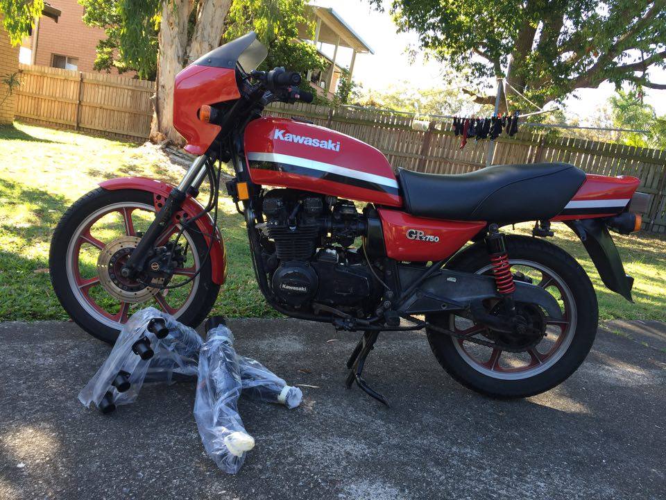

So, a couple of years back I bought a GPZ750 R1, it was a "20 foot bike", looked great in pictures but up close it needed some work, the good was that it came with spare gaskets and a brand new Mac exhaust, which now resides on my sons Z650.
The front fairing was cracked from a spill, the fairing mounts bent, the tank had been repainted poorly , it needed pulling apart and completely going over, virtually every black part needed repainting.  Lots to do.

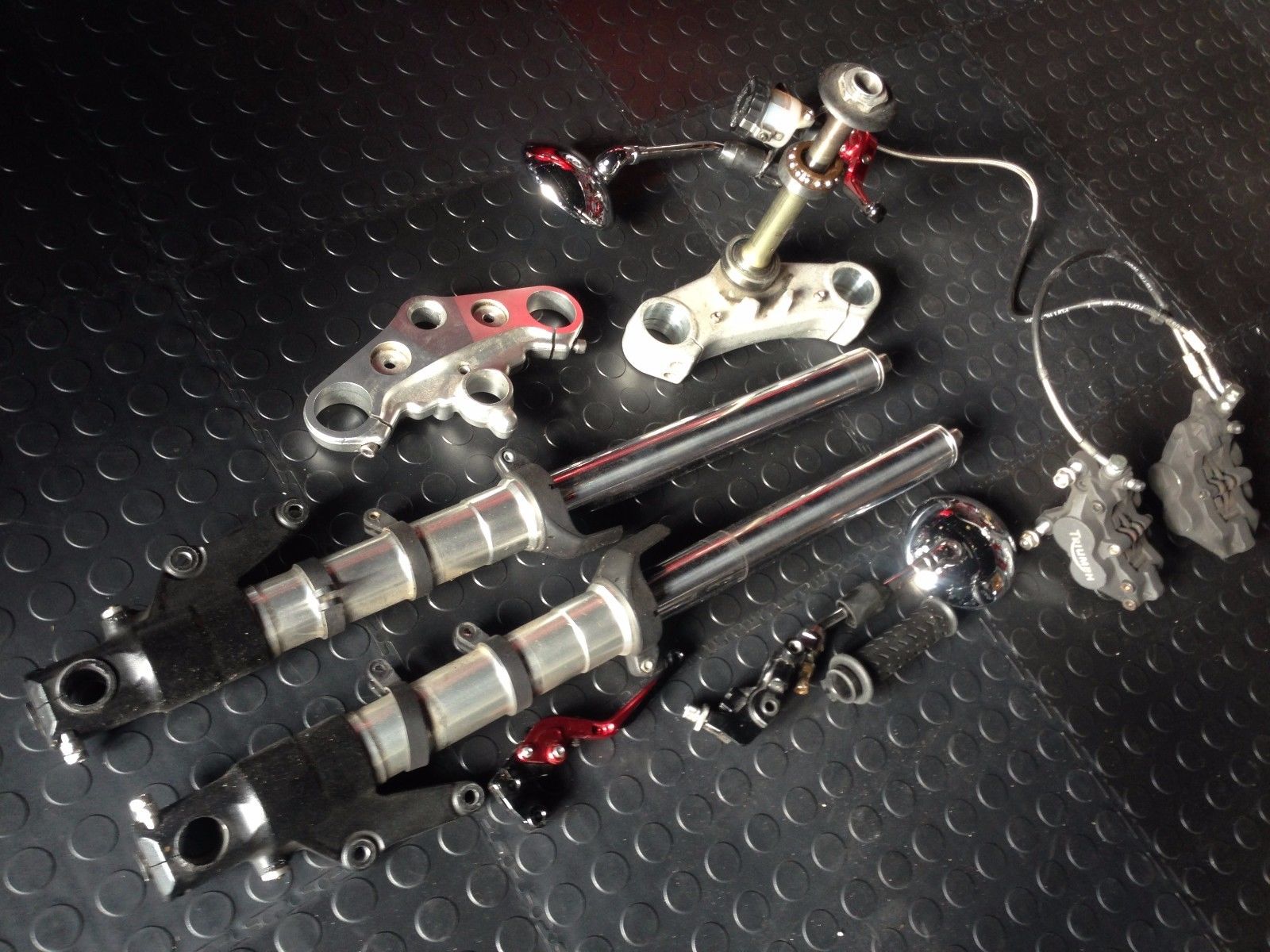

I found the Triumph front end complete, brakes, lines, levers, calipers and triples on Ebay US for 100USD, apparently the guy couldn't set it up correctly, had too much money and bought a complete Ohlins front end. I was lucky enough to be looking through Ebay late at night, as you do, and refreshed the page and the front end was at the top of my search. I messaged him to see if he'd ship to Australia and I bought it.   This is what turned up...
I'd hit the jackpot..!!
Now since this was going on the Kawasaki I would need to have fork extensions made, the forks were 700mm long, I needed 800mm.  After talking to a few people I was going to have new 100mm extensions made, after having them hard chromes it was going to be quite expensive, so I hesitated.  I was browsing ebay {there's a pattern starting to form here}, and came across a Chinese business selling new fork tubes, I went through his list and found the Triumph fork tubes, again these would be too short, so on a whim I messaged the seller to see if it were at all possible to have a longer set made up, I woke up in the morning to a reply saying YES, for an extra 20 dollars, so for around 200 dollars I had a brand new set of 100mm longer fork tubes in hand. {sorry for the lack of pics but I will get some}. The quality was excellent, I had a friend that knows his stuff, he's a mechanical engineer and he was amazed at the quality.

Now, Once I'd received the new fork legs and fitted new fork and tube bushes, I pulled apart the forks, it took about 5 seconds to work out why he couldn't get the suspension to work, The forks had brand new Race Tech springs in them, the thing is, race tech springs are quite a bit shorter than the stock spring but he's tried using them with the stock spring spacer, so there was no way to preload the spring, in fact, it was just floating around inside the fork...!!!   Some people have more money than sense.... Oh well, his loss, my gain. Now it was time to source some bearings to see if I could make the Z1300 18 inch wheel work, I happened to pick one of about a 2 year run where Triumph used a 25mm hollow front axle so finding bearings was a bit of a search. I'm not big on All Balls Chinese bearings so I was chasing Japanese ones, I couldn't get 14mm wide bearings so I bought 12mm wide and have ordered a few spring steel 1mm shims in the correct sizes, problem solved. My friend has an old 1950's lathe that cam in handy for making up the spacers to centre the wheel. Seeings though the front end arrived brakes and all, did I mention braided lines as well, even the levers are fully adjustable.....!!   Now for discs.....

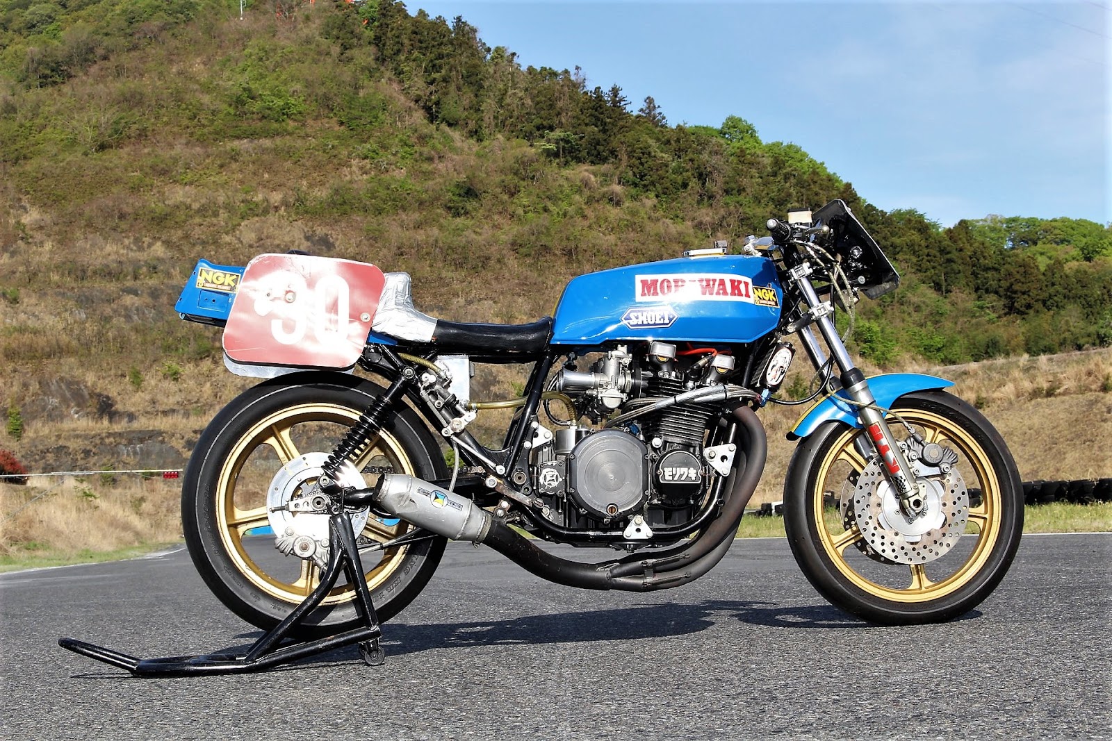

So, here we are, I better put up a picture of the bike I'm building the tribute to. Gardner raced a late 1970's Z1R MKII but it had the bigger tank, the Z1000 MKII tail and modified seat, this is the bike..
