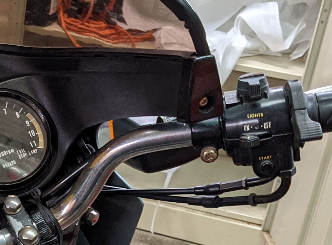

The trick with switching to a different master to get rid of the cable is that there is very little clearance between the handlebar and the fairing. Maybe I could get away with one of those fancy radial master cylinders with remote reservoir, since it would stick straight out, but a regular old KZ master won't fit.

A cable accutated MC gives you not the right feedback feeling to the break pressure point. Too much strain on any parts and joint points in the entire system.
A longer MC lever need more pull way on the cable and end up with more strain in the entire system.
A 2" wider steering bar gives you the option to install a real MC and you will get a better control/feedback to your front break. Just my 2 cents...

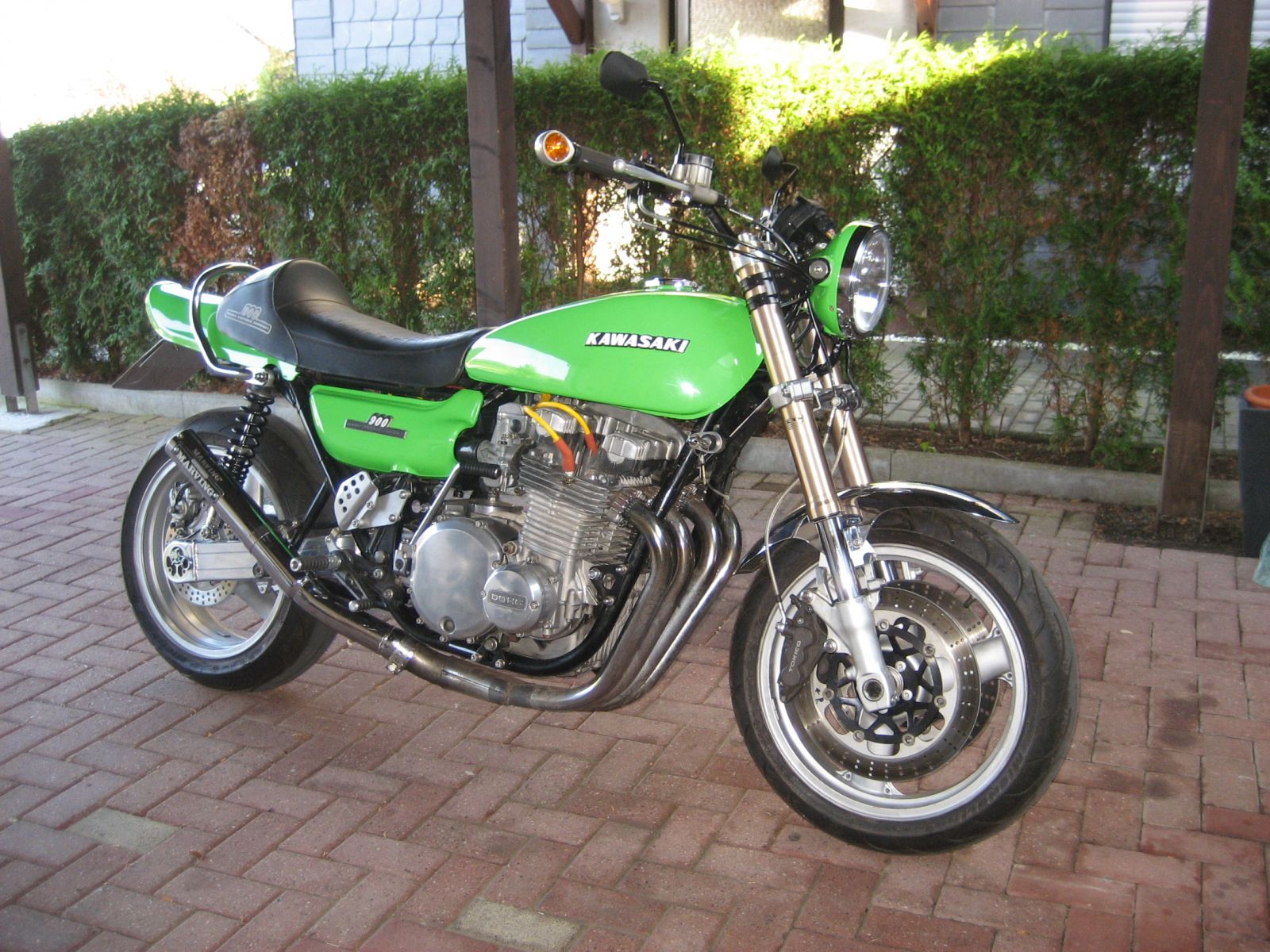

I do run a double six piston Tokico with a Z1 single disk (1/2?) MC with no problems. The front break bites like hell with a perfect feedback.
