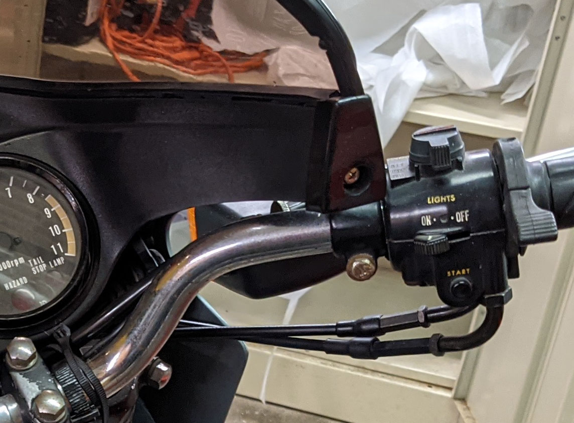

I don't have experience with Z1R brakes but I can say that those round puck pad calipers are pretty lame. Wooden is a good description, and the pads often squeak too. Some later year calipers would be a good choice for a daily driver bike. I'd also consider ditching the cable operated master. You can always slam on the originals for shows or if you go to sell the bike some day.

The trick with switching to a different master to get rid of the cable is that there is very little clearance between the handlebar and the fairing. Maybe I could get away with one of those fancy radial master cylinders with remote reservoir, since it would stick straight out, but a regular old KZ master won't fit.

But wait! I have been thinking about an entirely different way to skin this cat. I've been thinking about making a lever for the master cylinder, where the cable mounting point is moved out to increase the leverage. It may be unreasonably expensive to have one machined. Also, the cable might not appreciate coming out of the housing at an angle. And other possible issues. But I figured I'd look into it. This could allow me to try different ratios quickly.

A cable accutated MC gives you not the right feedback feeling to the break pressure point. Too much strain on any parts and joint points in the entire system.
A longer MC lever need more pull way on the cable and end up with more strain in the entire system.
A 2" wider steering bar gives you the option to install a real MC and you will get a better control/feedback to your front break. Just my 2 cents...

I do run a double six piston Tokico with a Z1 single disk (1/2?) MC with no problems. The front break bites like hell with a perfect feedback.
