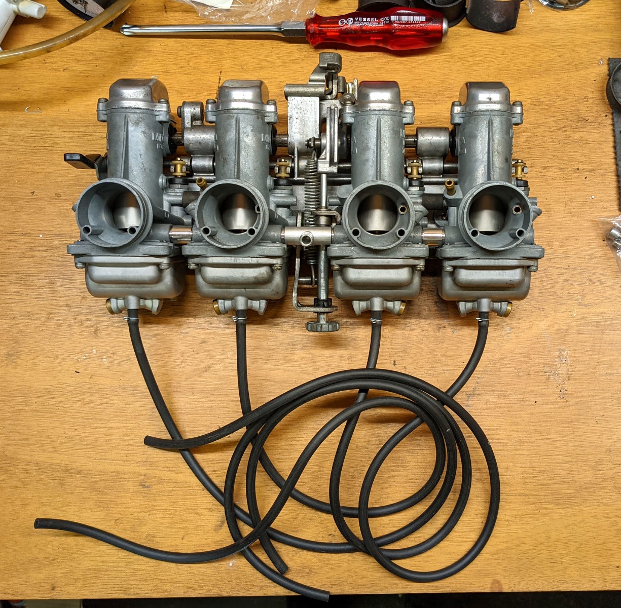

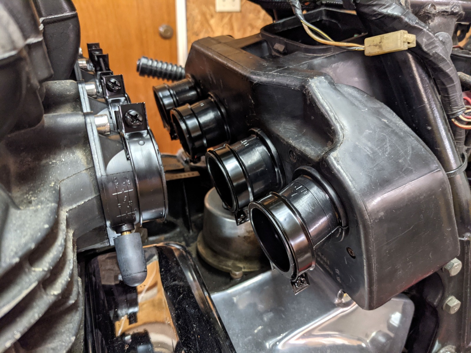

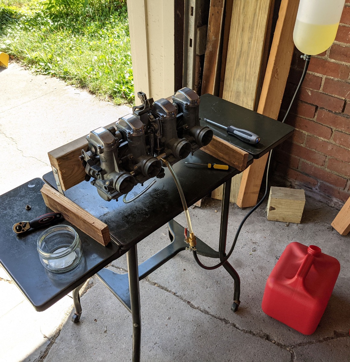

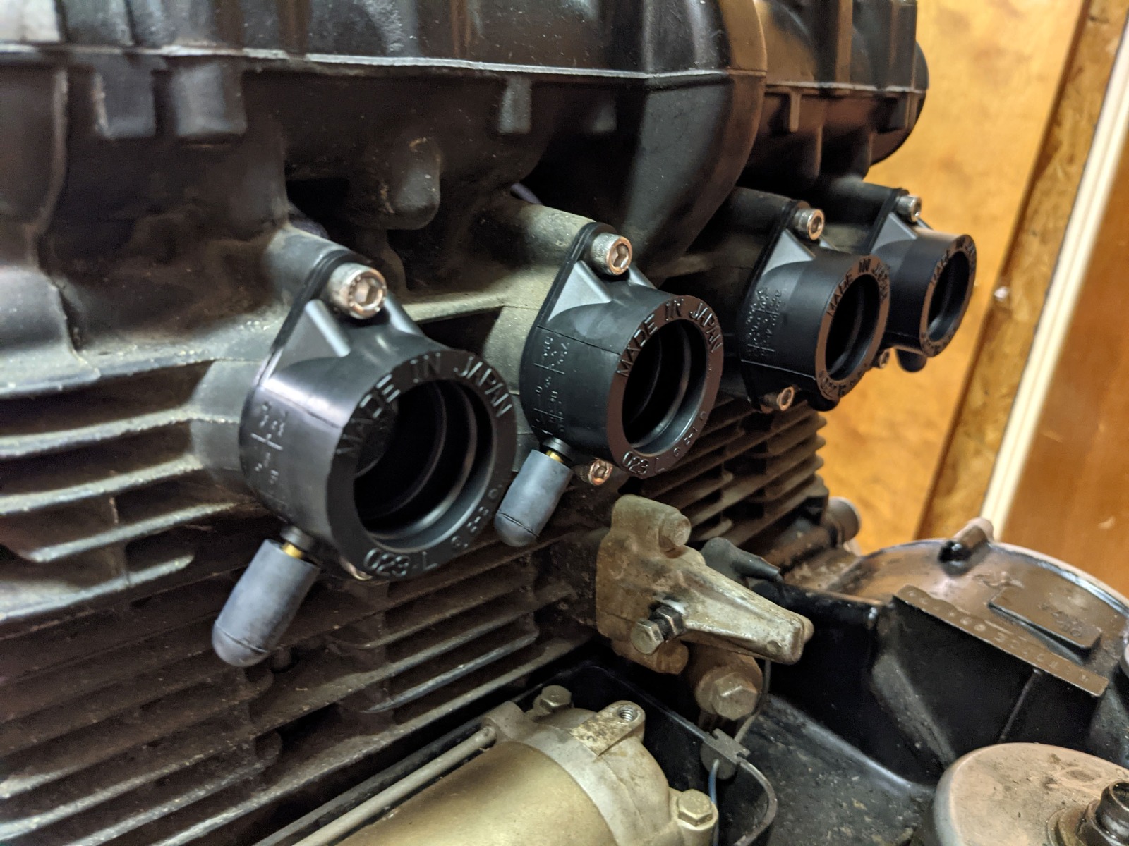

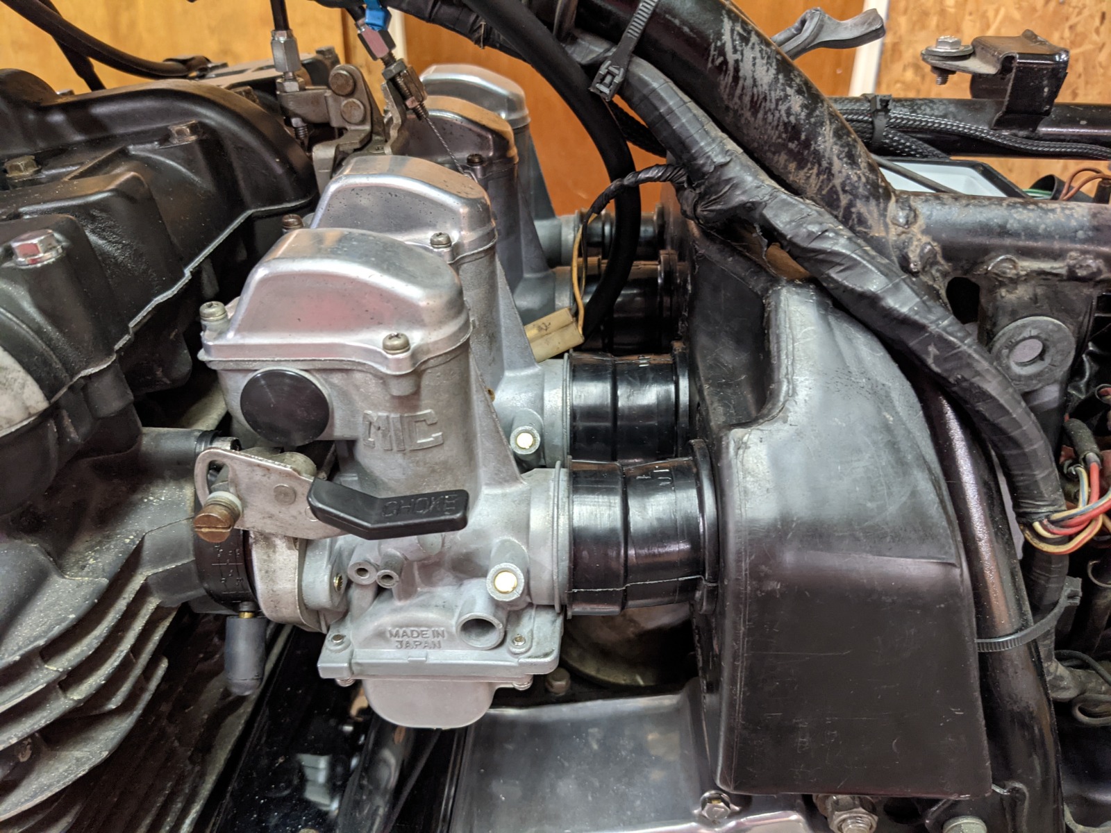

Back to the bike. The last big task was getting the carbs on. As I posted earlier, I had completely rebuilt the carbs but I had not set the float levels. I made a simple stand and found a metal typing table that I didn’t think would mind getting gas all over it. In the end it didn’t take as long as I thought and didn’t make as much of a mess as I thought. I think they are pretty close to where they need to be.
I also added drain hoses and spring clamps that are close to the OEM style. I never had drain hoses on these before. I got the hose from amazon, and the clips from JetsRUs.com
www.amazon.com/gp/product/B01LVUEGID
www.jetsrus.com/individual_parts/JRU-9007.html (this should be K&L 33-3923)

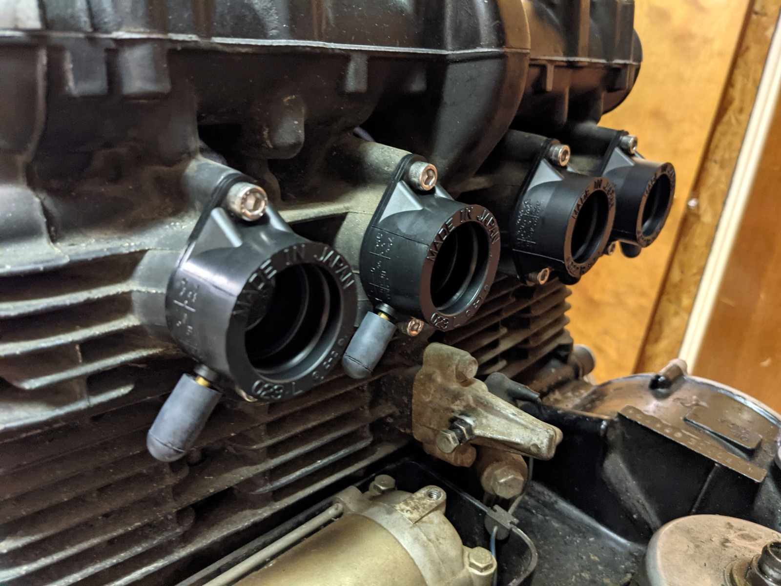

Next up was the new OE carb mounting boots and airbox boots from Partzilla. I also got new clamps for both. The clamps are made by PMC, and both fit fine. I also replaced the mounting screws while I was at it. I mostly stick to OE fasteners, but I have this idea that I’ll replate the original screws and reinstall them later. Maybe?
www.z1enterprises.com/airbox-boot-clamp-92037-061.html
www.z1enterprises.com/carb-holder-clamps-z1-kz900-1000.html
www.z1enterprises.com/carb-holder-allen-...of-8-6mm-x-18mm.html

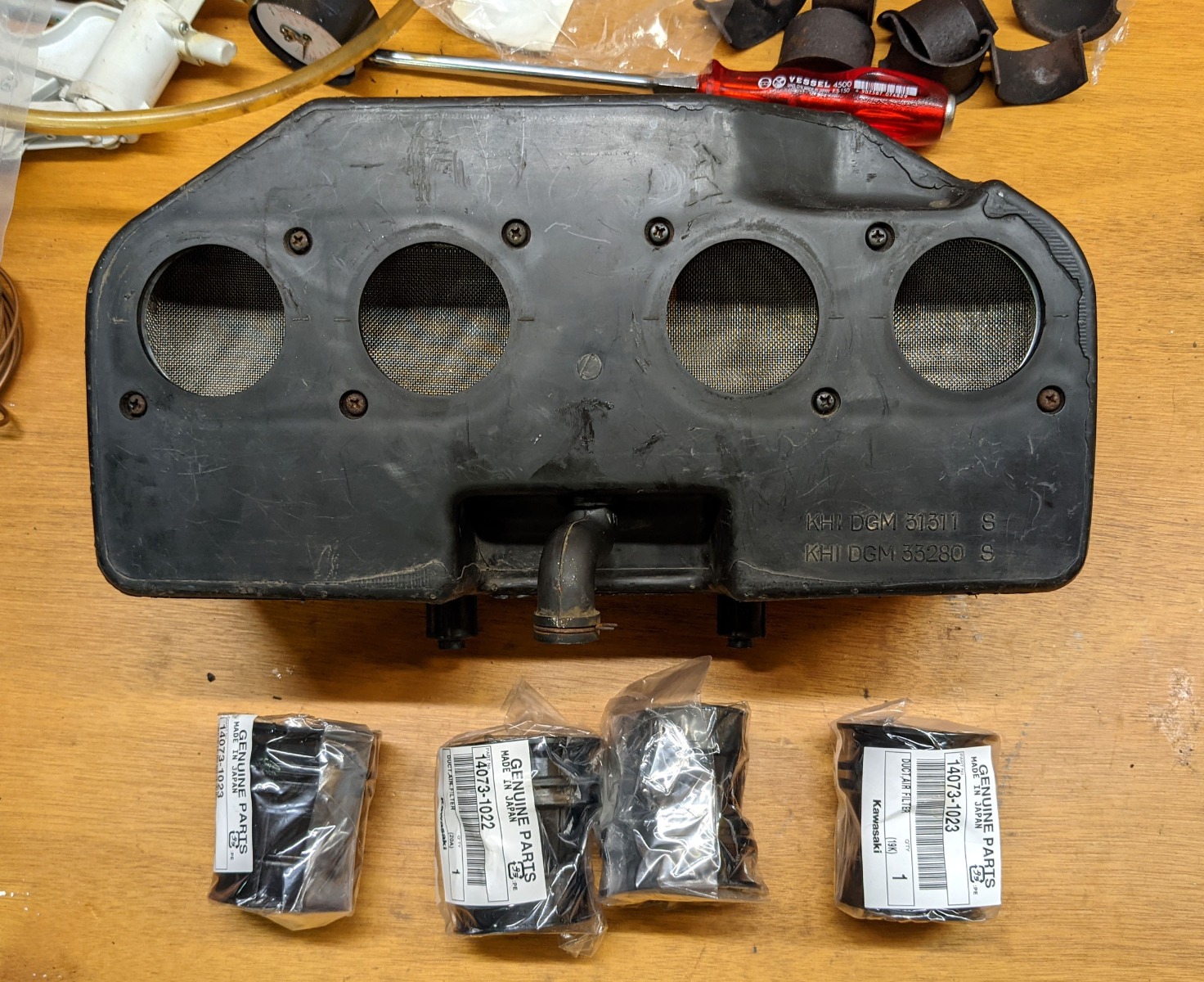

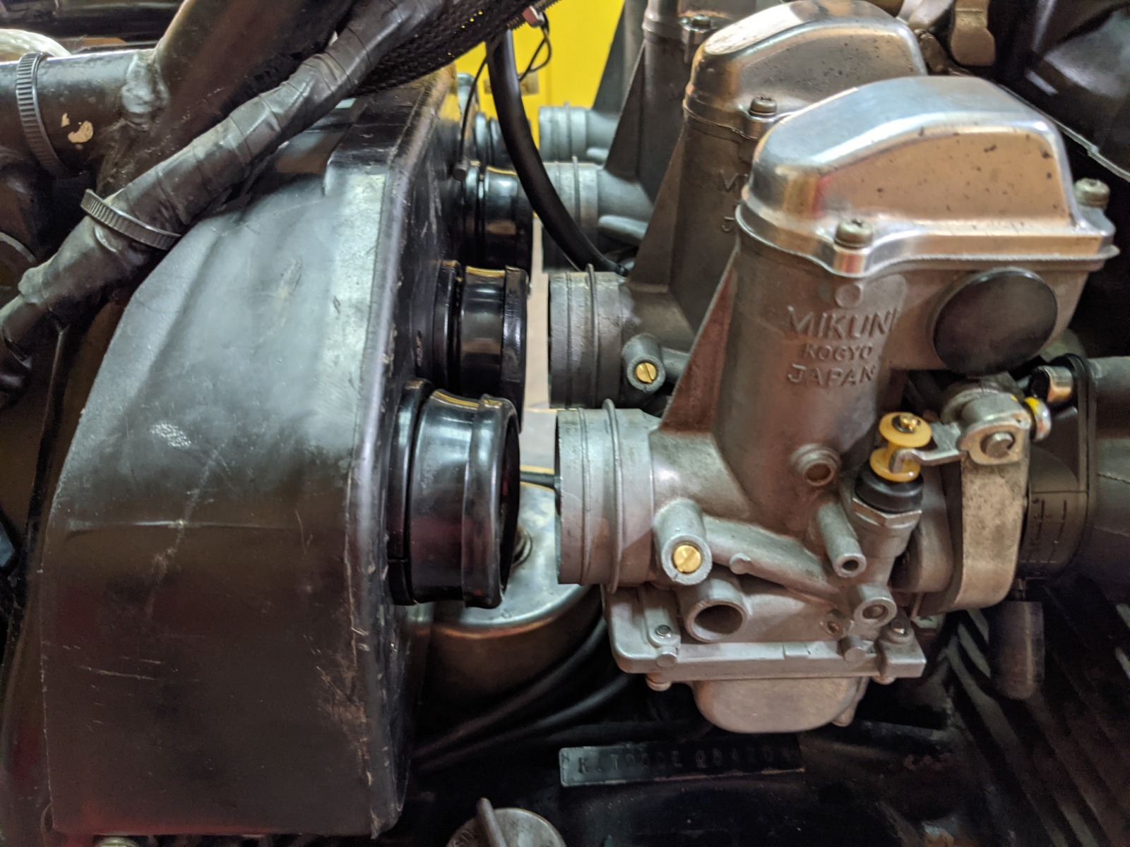

I never had an airbox on this bike. It came with pods. I was not looking forward to installing the carbs with the airbox in the way, but it actually wasn’t that bad. Easier than a KZ650 or ZRX1100. Once I folded the airbox boots back over themselves, there was plenty of room to install the carbs. The one thing that seems less than ideal about this method is that you have to install the airbox clamp rings after the carbs are in place. They don’t really look like they are intended to be opened and stretched that far. But they seemed to mostly go back into shape and went on fine. I’m not sure how many on/off cycles they will survive though.

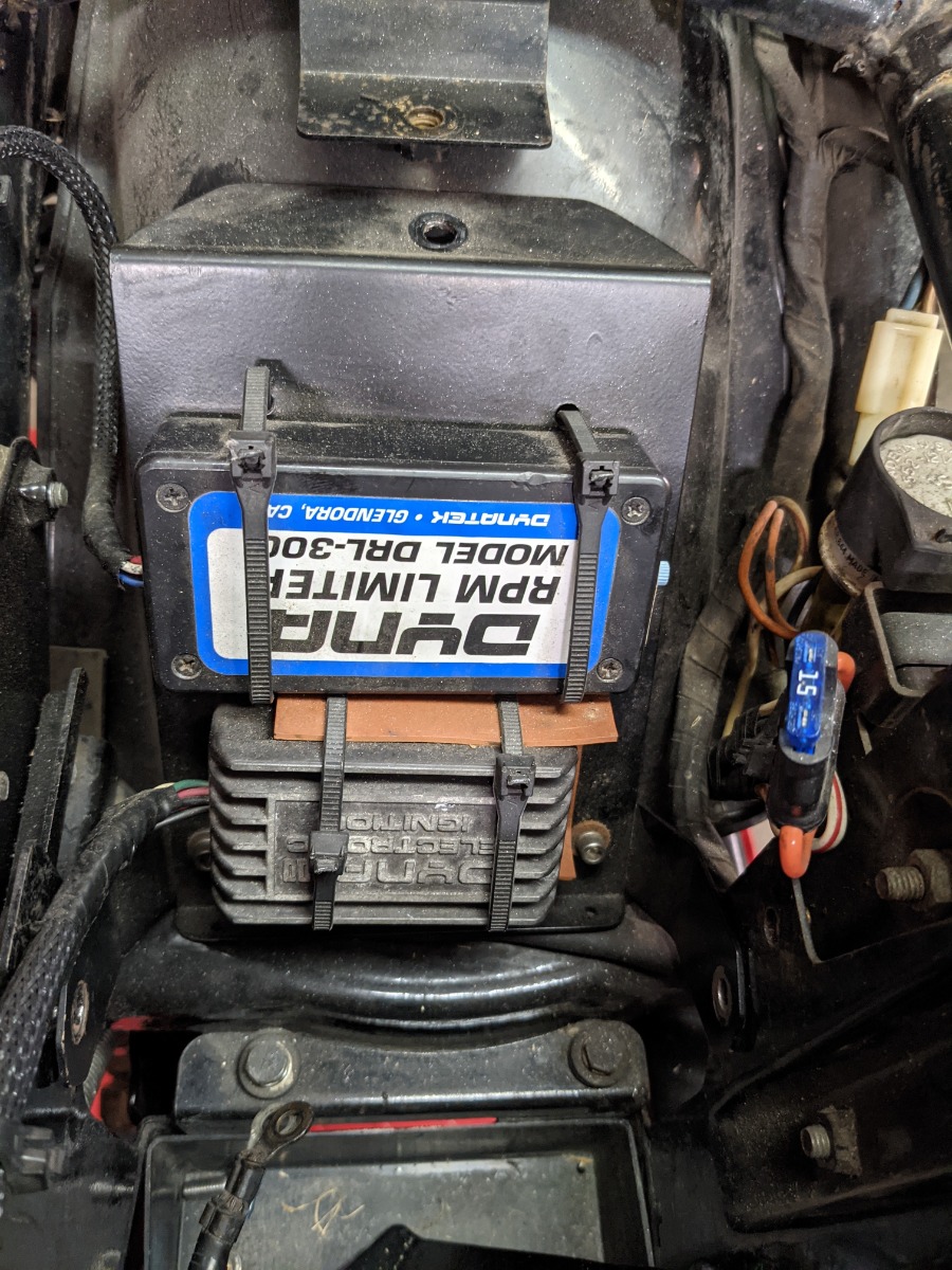

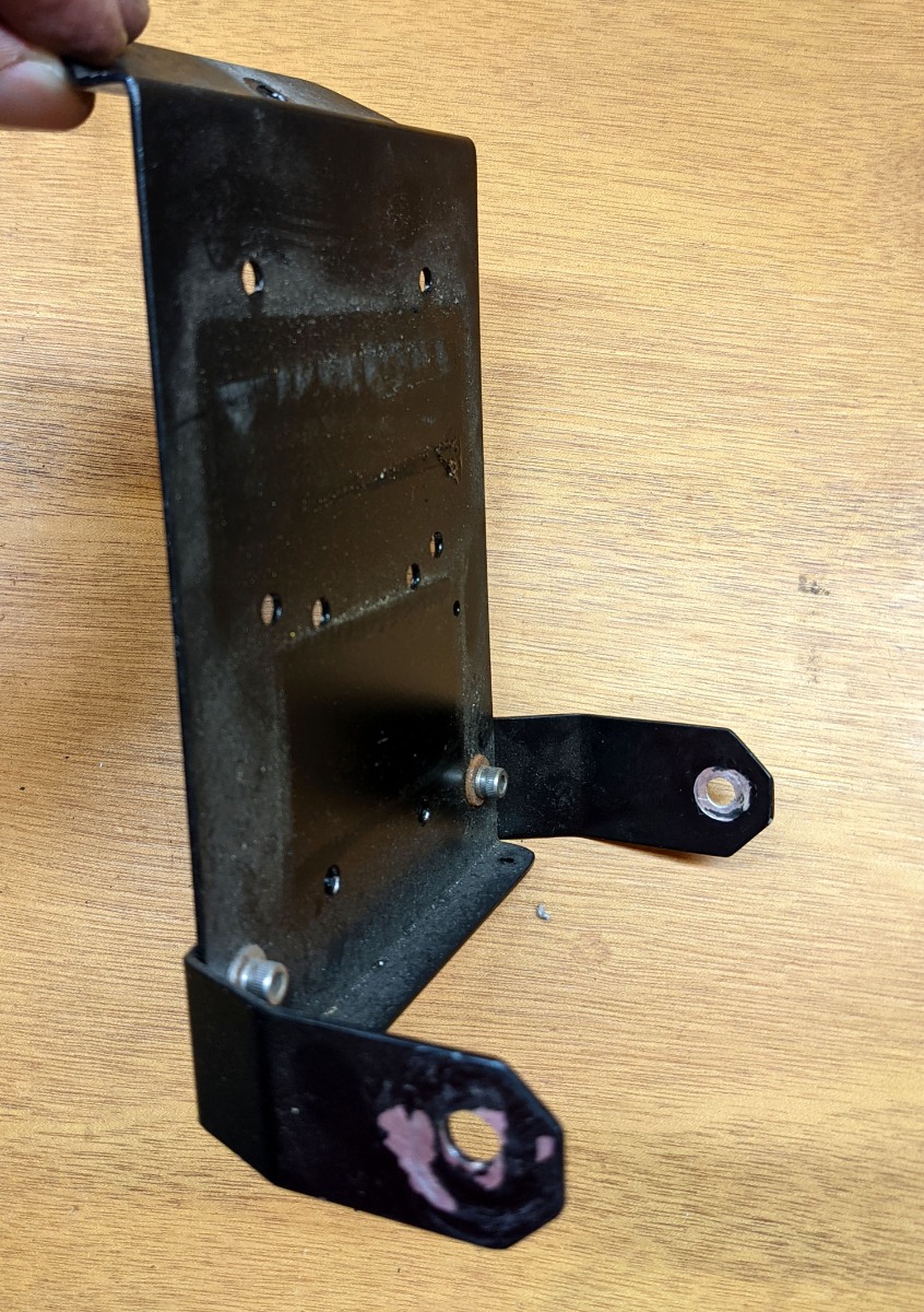

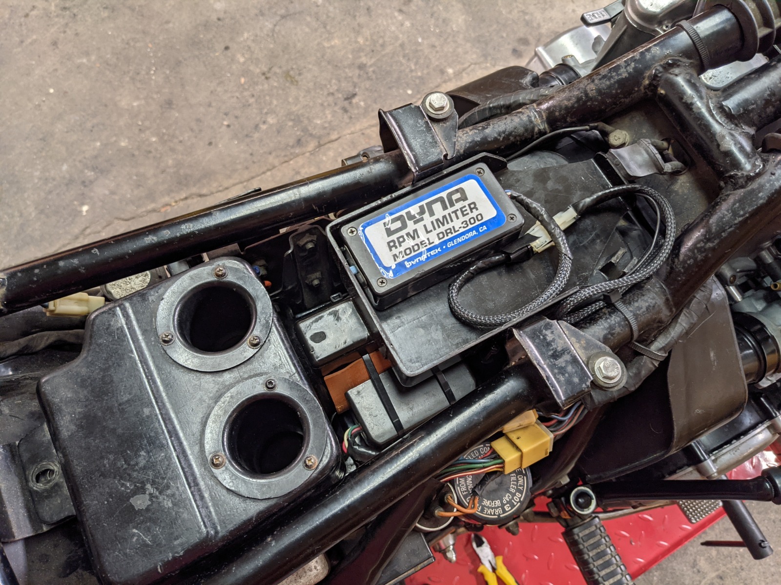

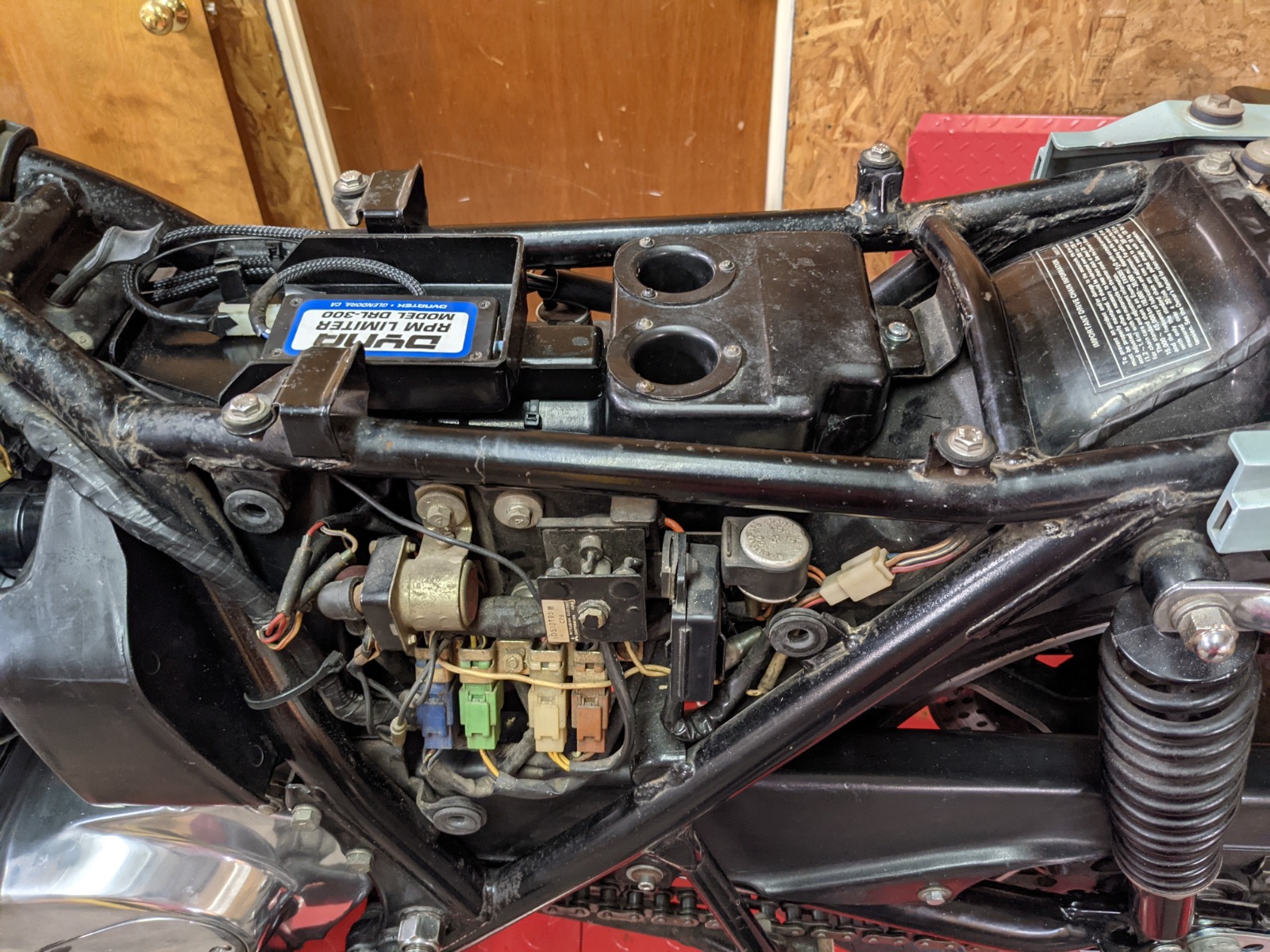

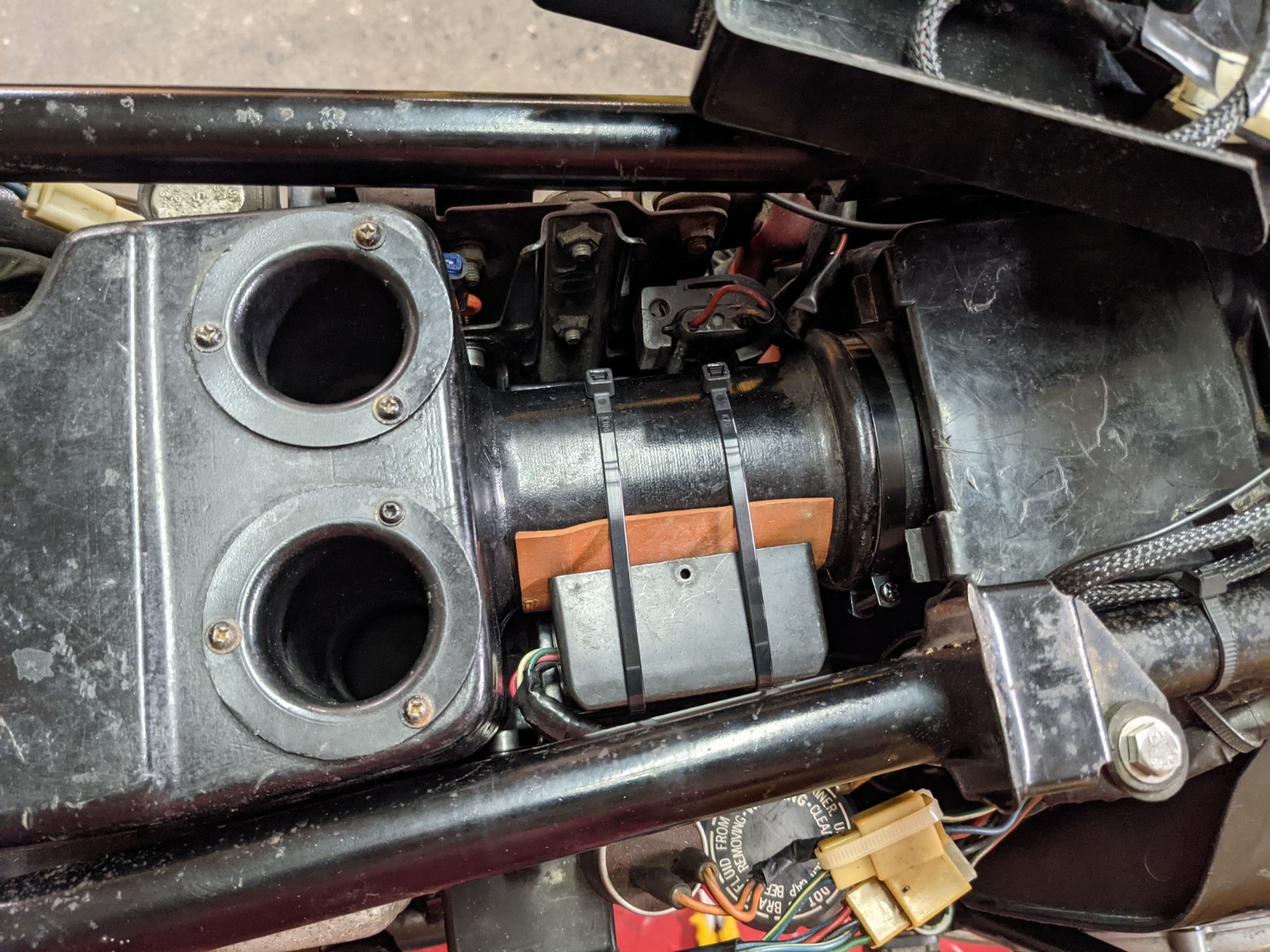

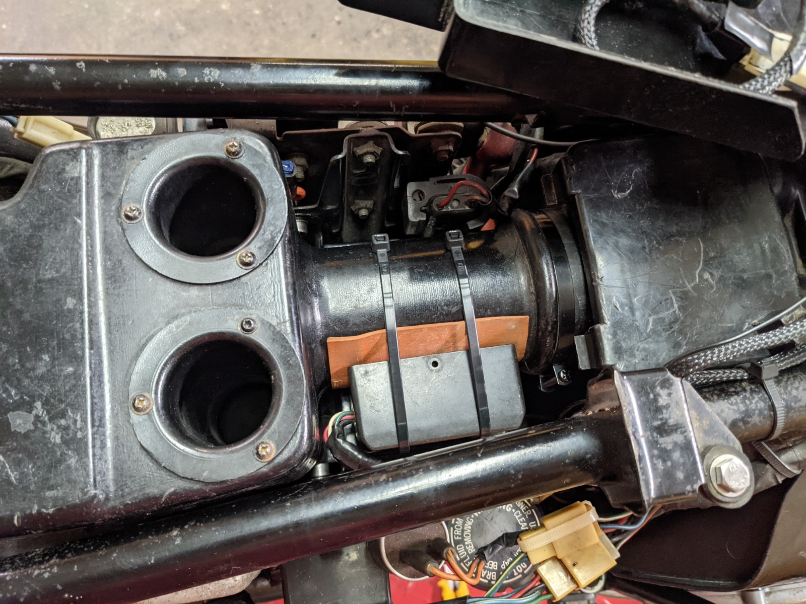

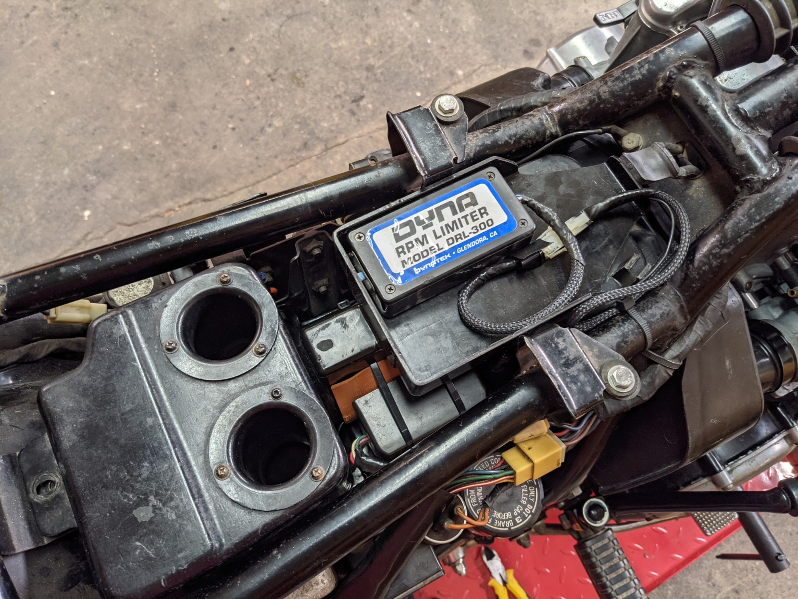

The other part of refitting the airbox was finding a new home for the Dyna III igniter and rev. limiter. When I put those on 10 years ago I made a plate that mounted where the intake silencer lives, using the silencer mount tab and the two screws for the battery retainer. I was pretty happy with this little plate, but it had to go.
My new solution is much lower effort. I zip tied the igniter to the silencer, and plopped the rev. limiter in the tool tray. Simple. Maybe effective? We’ll see.

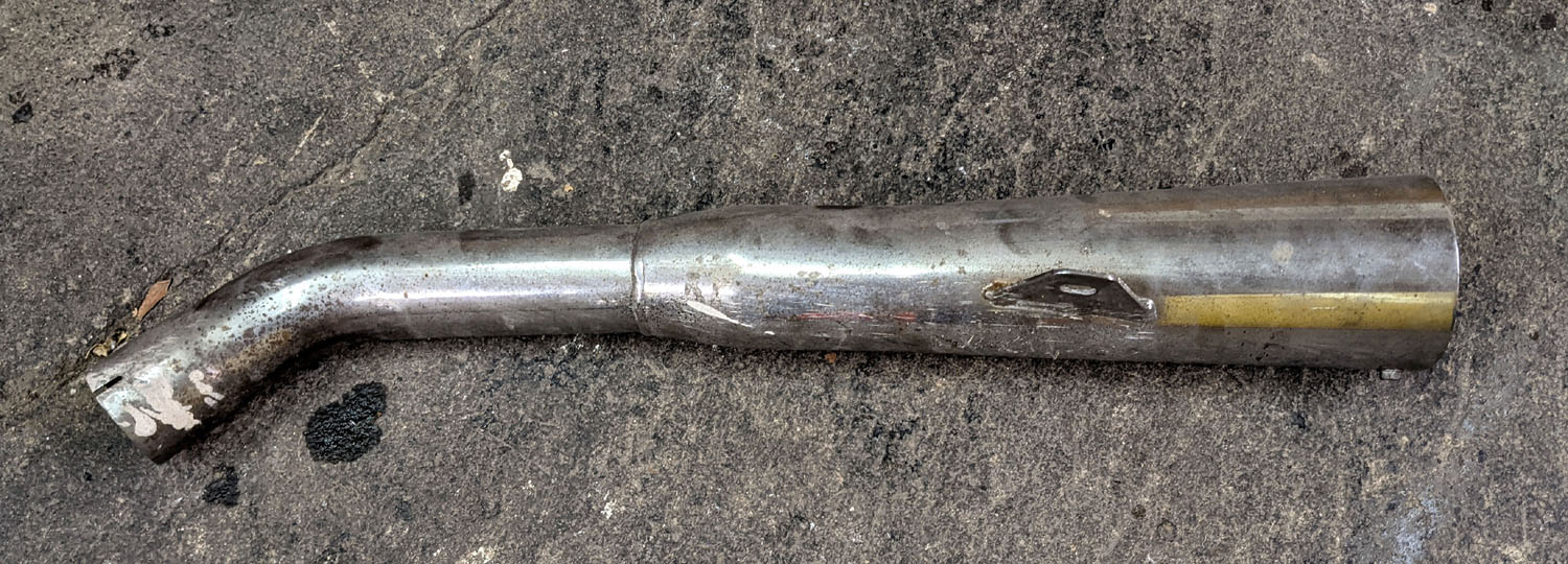

The last photo shows the new OE silencer mount screw and lock washer and plain washer I paid too much for.

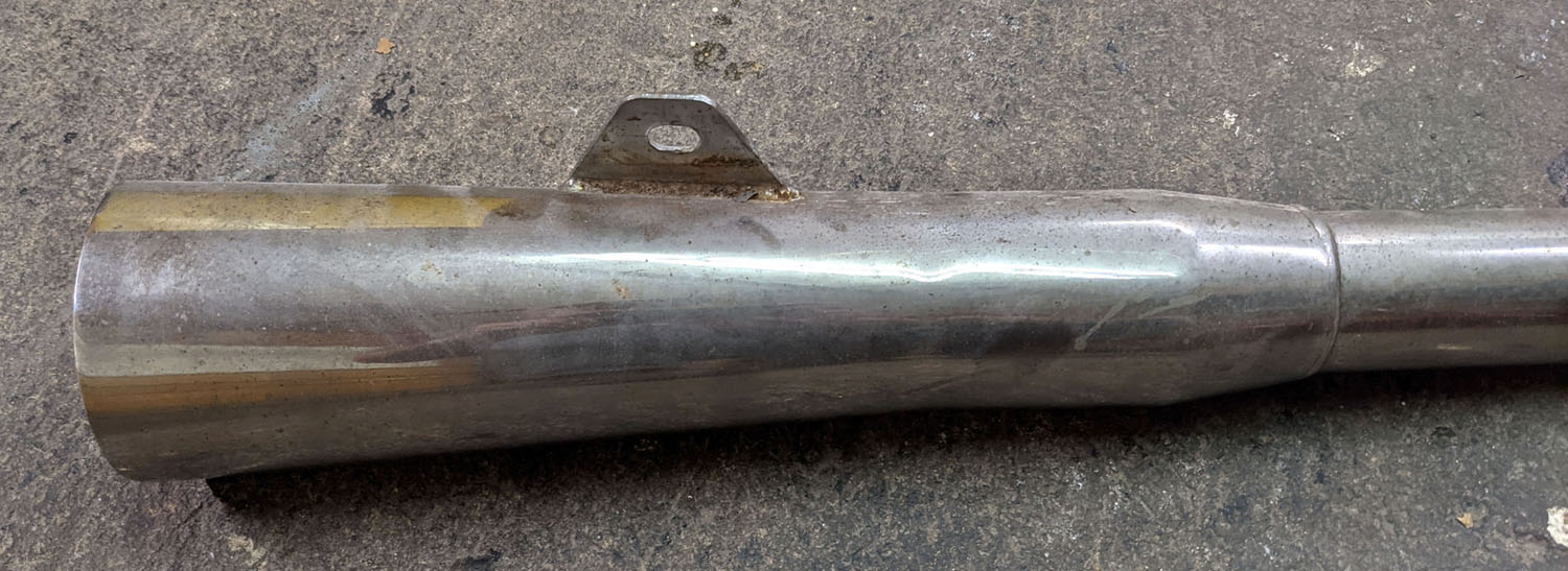

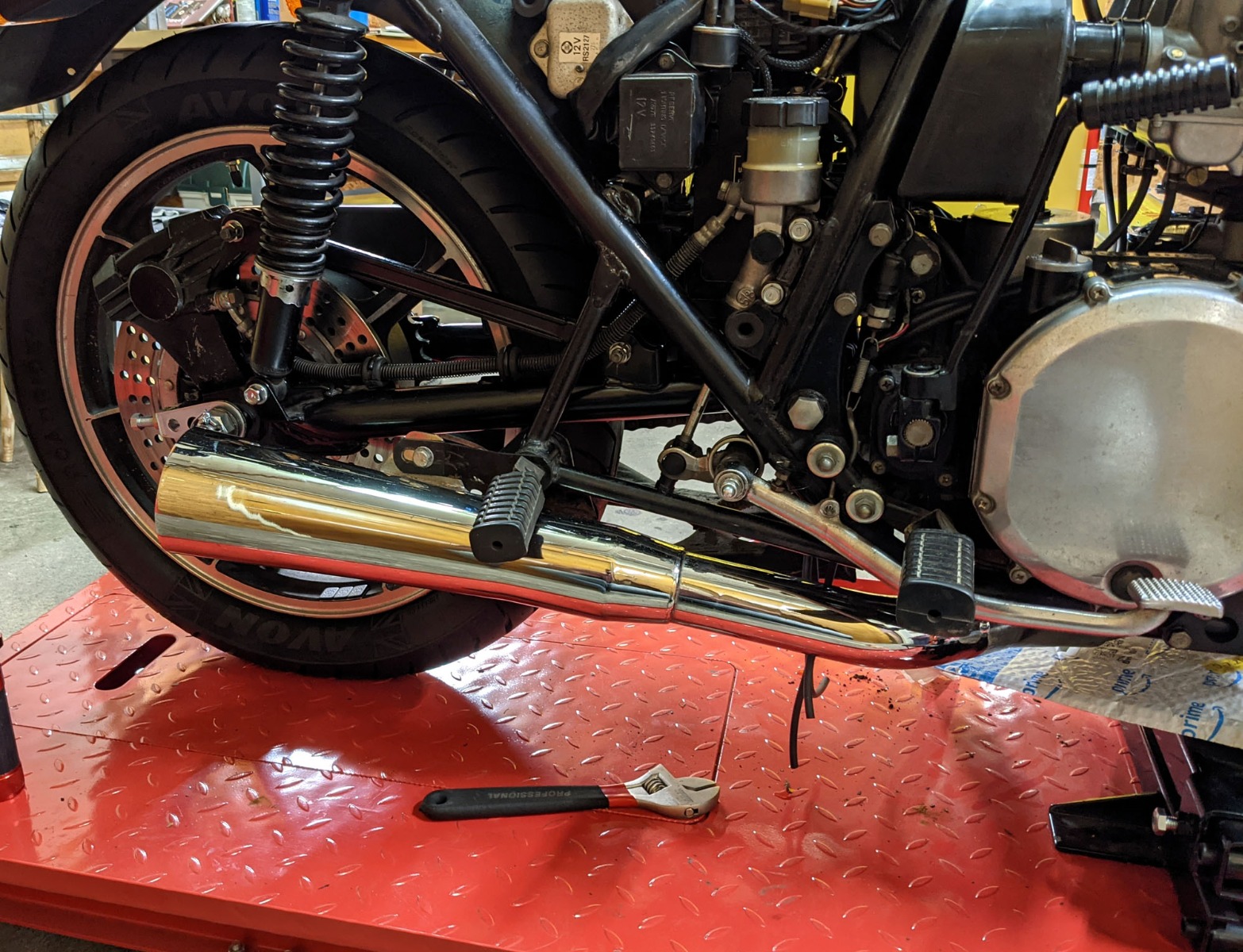

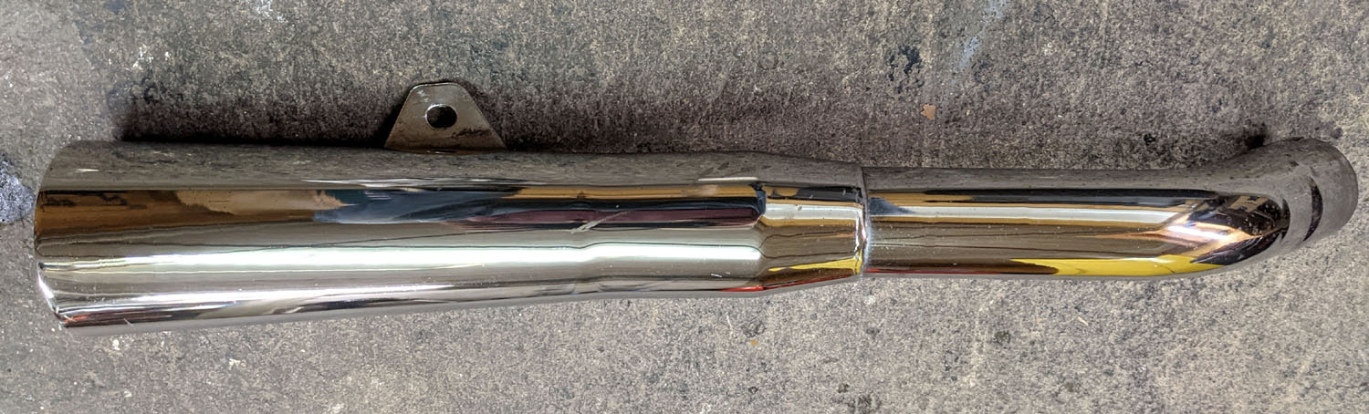

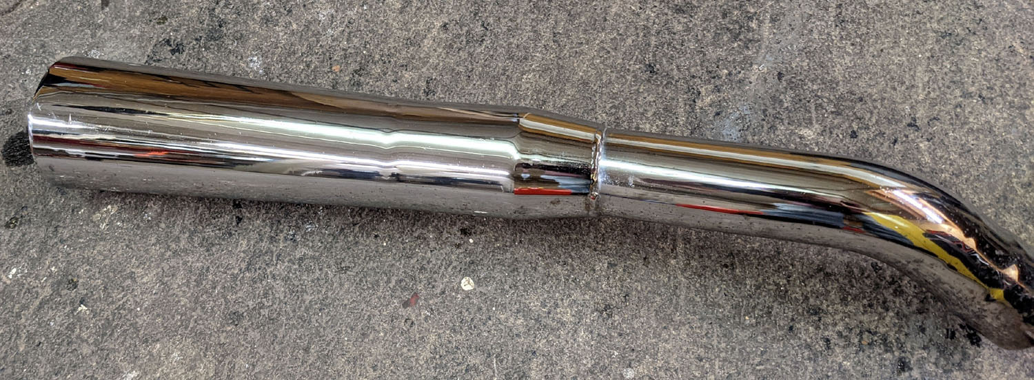

Finally all that was left was reinstalling the exhaust and the bodywork.
I’m not really a big fan of how chrome looks, I certainly wouldn't be inclined to add chrome to a motorcycle, but it turns out it is a good way to keep steel from rusting. I wasn’t expecting my megaphone to clean up much, but just a few minutes with some soap and Mothers polish and it looks shockingly presentable. I didn’t have the energy to do the header. That’s a lot more effort. Just don’t look too close.

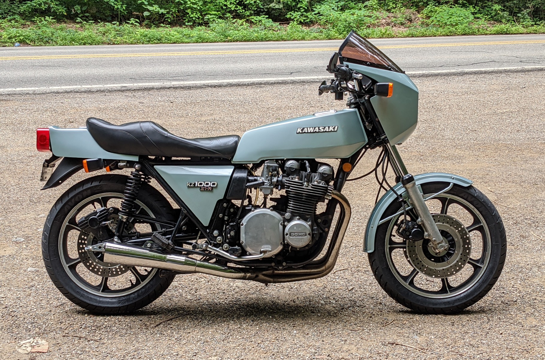

And finally that all leads to this. Just a bit shy of 2 years after it rolled onto the lift, it’s now finally off.
Here it is in the wild.
Going back to the stock jets and airbox was totally worth is. The carburetion is better than it’s ever been. It starts easily and I can take the choke off almost immediately. When it warms up it idles well and eagerly pulls away from a stop, whereas it used to stumble off idle. It still goes like stink, and I have confirmed that the rev. limiter is still working. The only issue I’ve seen is down low if I whack the throttle open all the way the bike will stumble. But I think that’s probably just the way it is with slide valve carbs and no accelerator pump. I still need to do a vacuum sync and twiddle the idle air screws, but it’s great as is.
