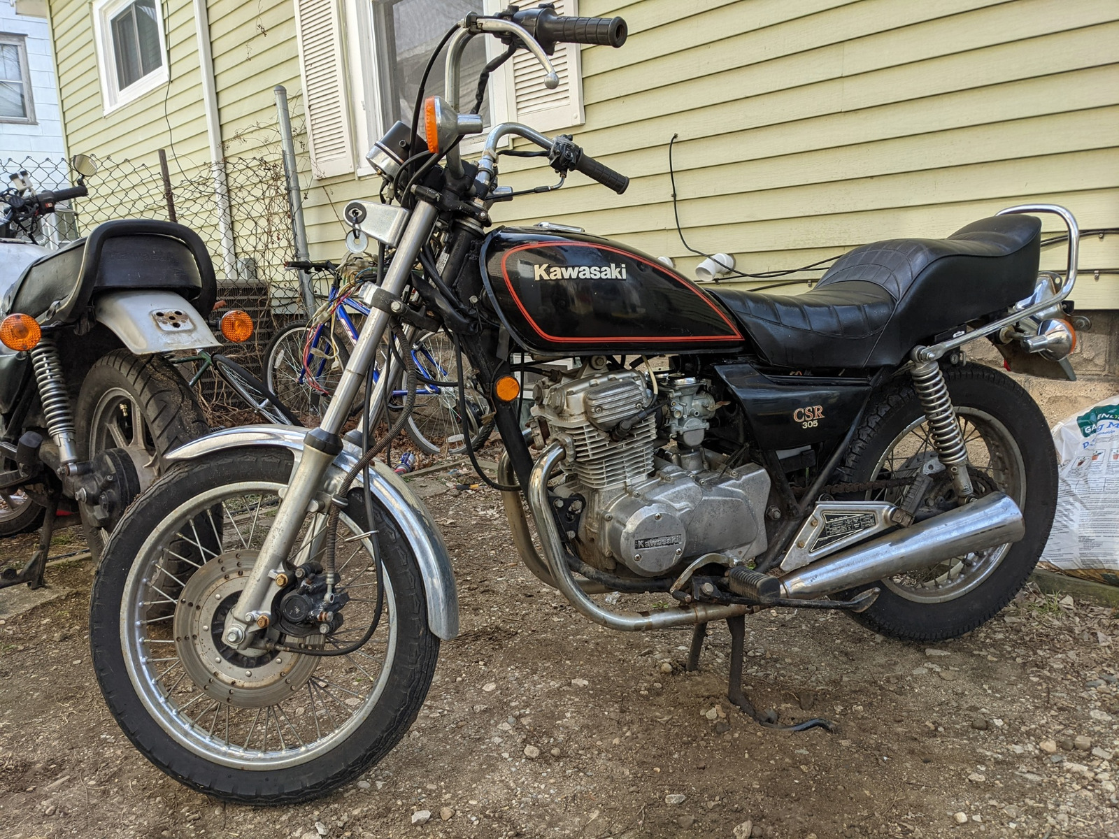

30 Mar 2021 11:57Picked her up last night at 7 and had her running by noon today! Previous owner generously provided me with a box of everything I needed, including two sets of CV32 carbs. All in all, very decent shape considering the price I paid, and feels strong. I have a few questions that you all might be able to help me with:
-Needs tires; 100/90-18 and 120/90-16, both tube-type. Where should I buy tubes from? I'm doing some looking but I don't quite understand the overall deal.
-Carb boots; OEM are about $90 for a pair, is there a less expensive alternative? I am aware that OEM is best. I'm looking to see if holders for 30 or 34 mm carbs will work.
-Airbox boots; I have a pair but they're rock-solid. None available that I can find, so I think I'll need to fabricate some. Any tips?
-Oil filter; I'll order an OEM filter if there's no in-store alternative. I use a K&N 401 for my 750 but any brand is okay with me.
I think that's all for now, mostly just little things. I'm pretty happy with what I've got, it's in much better shape than my 750 was when I brought it home.

I have The same bike. But mine has a head light.
I love the bike. I use it as my everyday runabout. It's the smoothest parallel twin I have ever ridden, even at 70mph.

31 Mar 2021 20:04You noticed that, huh? Someone in the past seems to have tried to clear silicone a ~5" headlight into the stock 7" bucket, so it's on the list to replace. Very strange.I have The same bike. But mine has a head light.

Not that you can't use a 7" headlight, but the stock 305 unit is smaller. It's the same as a KZ400, but I forget exactly what size it is.
I guess to install a 7" you wouldn't use the diamond spacers. guessing.
Tires. some guys (most?) don't like the 404s. I've never ridden on them but did check 'em out at CycleGear several years ago to see what kind of bead they had. I'm currently riding on Bridgestone BT45s.
FYI. CandlePower had the 400 headlight info, but the site is now closed. Before the Fukushima disaster, candlepower sold a headlight for the 400/440 but the factory is in the nuclear exclusion zone so they are NLA (I think candlepower had a 400 H4 upgrade >> lens unit & bulb).

01 Apr 2021 13:28The plot thickens. From what people want for used OE I might just pick up a Hella 500 or something...hmm.martin_ wrote: Not that you can't use a 7" headlight, but the stock 305 unit is smaller.
RE: tires - I suppose we'll see what I think of them.

My wife's 82 305 CSR had a blown low beam when we got it. I replaced the whole assembly with this;
Emgo Black 7 in. Headlight - 66-64313
From Dennis Kirk. New unit is a bit narrower at the mounting points, so I added a few nylon washers. Appearance is much like the original. Size is just right. Steel bucket instead of original plastic. Uses same thread 10mm bolts as original.
