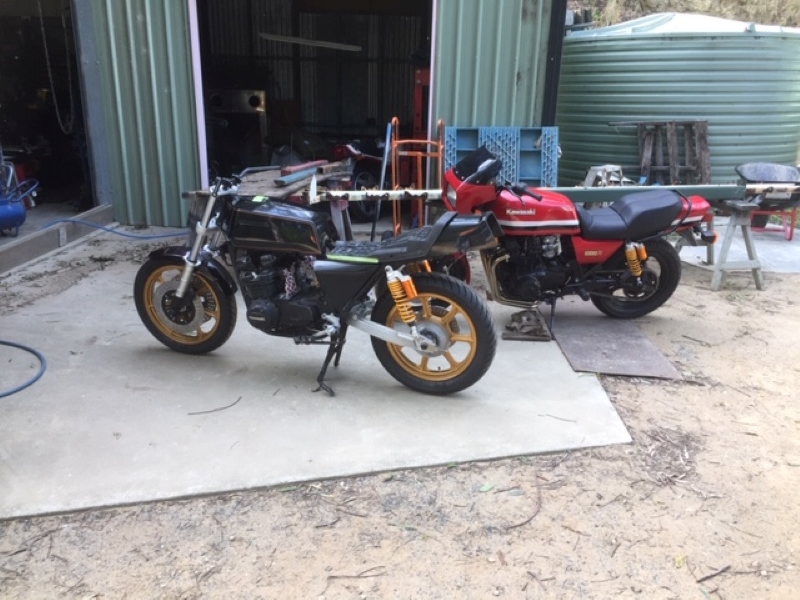

Yes he is talented, he's self taught, as he apprenticed as at a paintshop, not a machine shop. The front wheel would be easy to anodise its centre, as it the centre could be unbolted from the rims, For the rear, I had the rims welded to the centre 'spokes' when I struggled to get it to hold air, so couldn't just have its spokes anodised.
BTW here's a pic of what my mate got up to in his home workshop, during our long lockdown last year..

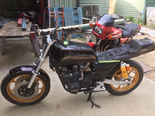

Got the seat back, this time upholstered the correct way around.. Also finished painting the front headlight brackets and polished and fitted the foot controls. So rolled it outside for the first time. The back end looks a little high, so will wind down the shock spring a bit.
I will have the pegs hard anodised at some point, not sure if the levers and hangers will be left polished or anodised black too. Next task is to fit the carbs and exhaust, then work out how to mount the BMW R90S replica fairing. Once that's done, will have to tackle the wiring, and send the bodywork off for paint. But first need to decide what the paint colour/scheme will be..
