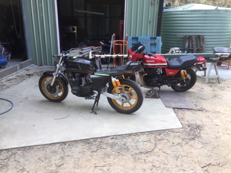

Got the seat back, this time upholstered the correct way around.. Also finished painting the front headlight brackets and polished and fitted the foot controls. So rolled it outside for the first time. The back end looks a little high, so will wind down the shock spring a bit.
I will have the pegs hard anodised at some point, not sure if the levers and hangers will be left polished or anodised black too. Next task is to fit the carbs and exhaust, then work out how to mount the BMW R90S replica fairing. Once that's done, will have to tackle the wiring, and send the bodywork off for paint. But first need to decide what the paint colour/scheme will be..

With a few more small parts delivered today, I could fit the Mikuni RS34 carbs.. which went on no problem, though I will make a small support bracket to help take their weight, as with no air box, they are only supported by the inlet rubbers. Next I fitted the exhaust cylinder head studs, again no problem, followed by the 4 down pipes and 4-1 collector, which also went on the bike with no problems.. However, once fitted, it was soon clear I had yet another problem, a big problem.. The exhaust was made to fit a GPz1100B1, same as the engine in my bike. But the rear wheel and swing arm are obviously wider than that of an early 80's B1. However, I didn't expect the difference to be so apparent, as the collector pipe into the silencer is far too close to the swing arm. There's no way the silencer can be fitted. Also the foot controls are in the way too.. though I want to raise them up anyway, so the kickstand clears the gearchange lever.
And things were going so well... sigh..
