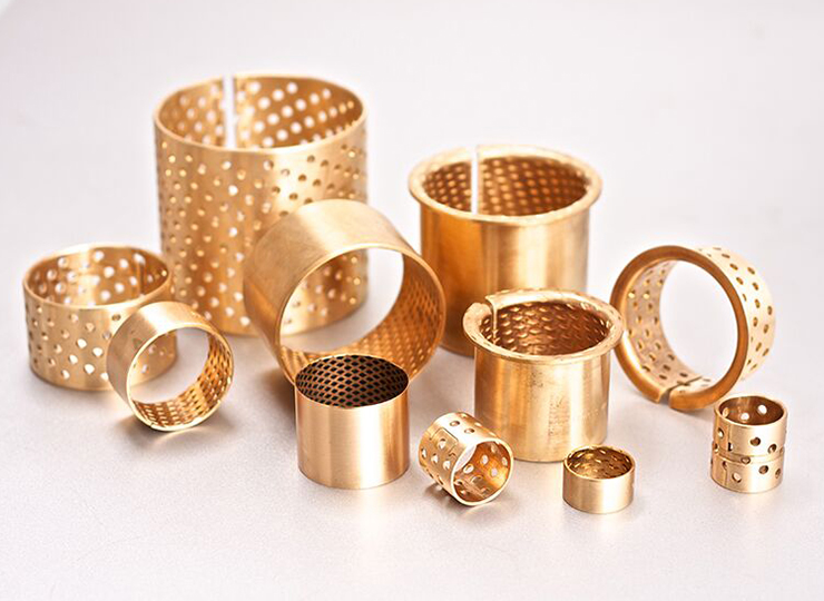

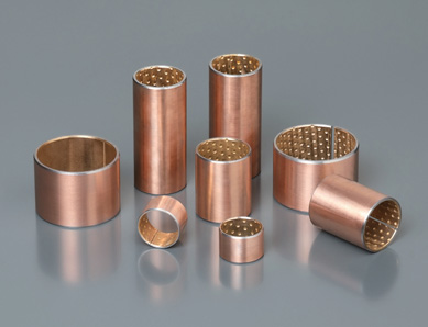

08 Mar 2021 16:29I agree 100%; this was my first option. However, I ignore where I could find some locally and I wanted to process quickly. So, I got some pieces of copper tubing that I'm currently working on. I'll let you know the results when finished.Scirocco wrote: I would do set some bronce selves....
Thanks again for the comments guys!

Copper will be too soft for bushes, oilite bronze is the best...

A pressed in bronze bushing would work best but if the hole is big enough you could try some shim stock.
can you shove a feeler gauge in beside the shaft?
