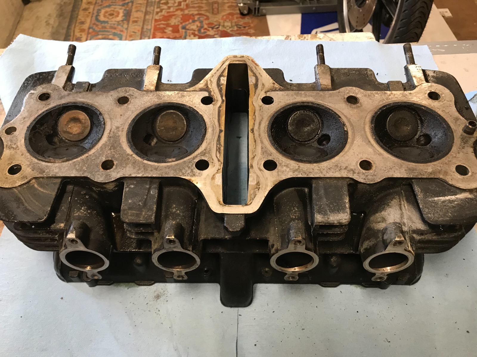

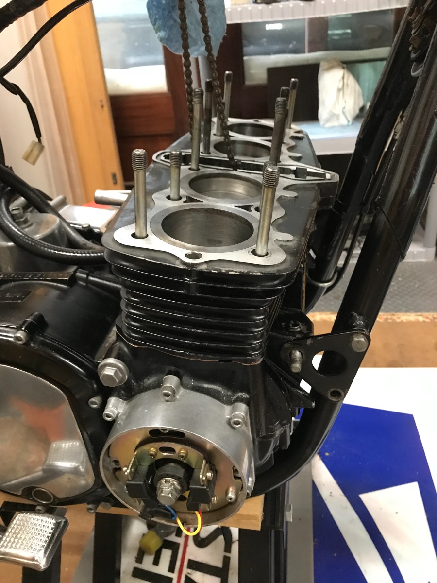

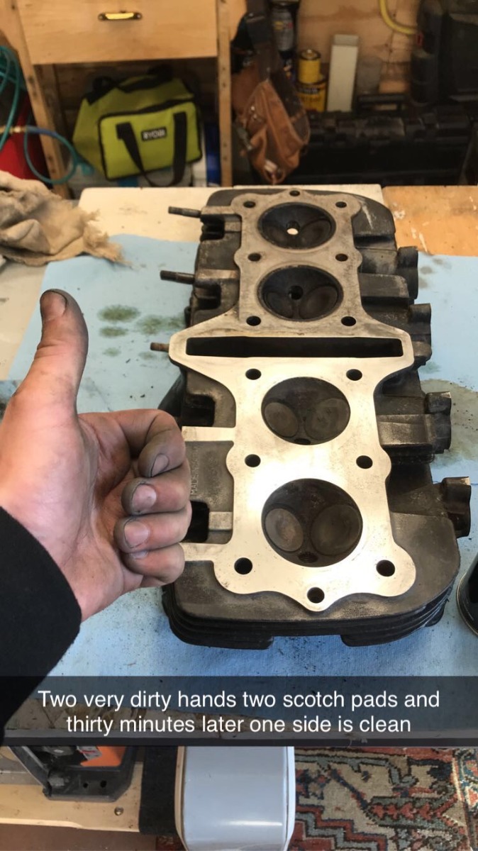

I apologize for letting this thread die a little, it certainly has been an interesting past couple of months, waiting on parts for Japan, starting a new job and all that but summers here and I'm back to working on the bike regularly. A lotta stuff has been done that I haven't posted about so I am going to do separate posts for each of the "stages" of assembly.
I don't have any picture of the bike between when I put the pistons on with their new rings and stuff but I did check the ring gap and all of the piston and cylinder specs and they were in the functional range. Thank god I stuffed some rags underneath the pistons cause I dropped a piston ring circlip and it saved me from losing it in the crankcase. I honed the cylinder walls and cleaned the gasket surface really well on both the cylinder block and head with some scotch brite and it looked great. I used a polycarbonate brush on the end of a cordless drill to clean the combustion chambers and valves. It all turned out ok and I was pretty happy with it. It took a buddy and I quite a while to wrestle the block onto the pistons but we managed and that was where we stopped for the day.
Below is a before and during photo for the head and an after photo for the block installation.
It looked so damn pretty with those shiny pistons back in their bores.
