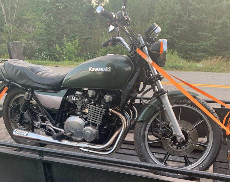

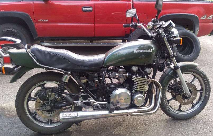

I'm about to buy this bike but some issues looks strange.
Tank,side covers, ducktail and most of the bike seems to be genuine J but:

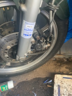

Front fork is unpainted but should be black.
Front fender is not the right unit.

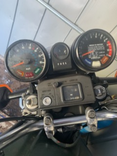

Lower half of instruments should be black but they're chromed.
Mirrors should be round but they're rectangular.
Brake pedal engineering to work with the exhaust seem a bit weird.
Worst thing: 7th digit on the paper says "K" (as for a LTD) and black color. The bike below has been painted but I believe 1981 J was either red or silver.

If the vin says it's a K model Ltd, then I would assume that's what it is.

Right but if it's really a LTD, a lot of work has been made to make it look like a J as looks like fuel tank, side covers, ducktail, seat, grabrail, rear wheel, etc. would have been replaced.martin_csr wrote: If the vin says it's a K model Ltd, then I would assume that's what it is.
The seller just bought it as has been said it is a "J". He's supposed to look at the VIN directly on the frame to see what it is (VIN I saw was from the registration papers).

Forty years have passed. The VIN is what the bike was when built. It is totally realistic to think someone along the way swapped whatever parts they wanted to restyle the bike. (Hmm... sounds strangely familiar for some reason.
