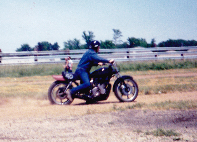

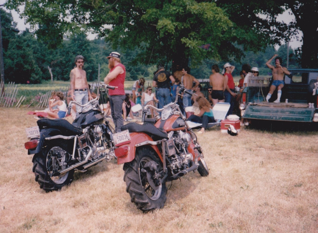

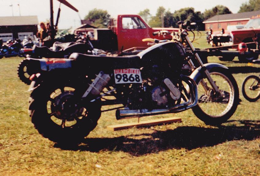

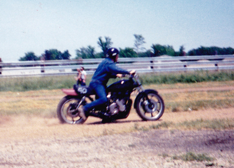

24 Jan 2021 22:17 - 24 Jan 2021 22:24Hi Shank, seen your message, sending an email We used to Dirt Drag & sled pull also.Shankkole wrote: I have seen a couple similar versions in the midwest area doing "TRIKE PULLS".I used to rodeo and been to every county fair and seen some crazy shit that I would never do and we rode bulls and broncs. Cool for sure, but made for soft ground and to go in a straight line for couple hundred ft.REAL FAST! looks like a quality builder did the work, as other have said.
This was a 1075 with Andrews 3 X cams with smooth bores. Was fun of course, when everyone was drinking too! Had to sign off when you entered, At your own risk!
