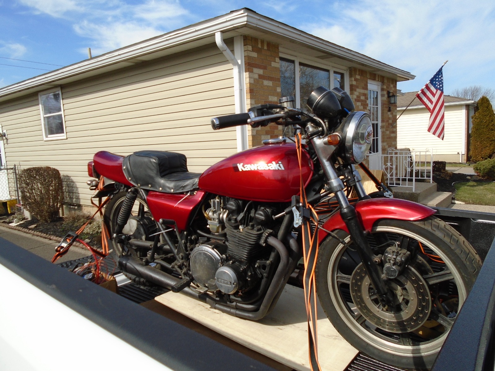

So this is a 78kz punched out to 1197 Super gas motor that I have rebuilt and putting it on the street got it running sounds wild... but I just realized it has no neutral it does have a pearson trans .was it a common setup not to have neutral so not to slip into neutral under hard exaltation. I do have a 2nd engine could I swap the gear sequence selector and recover neutral...?,
