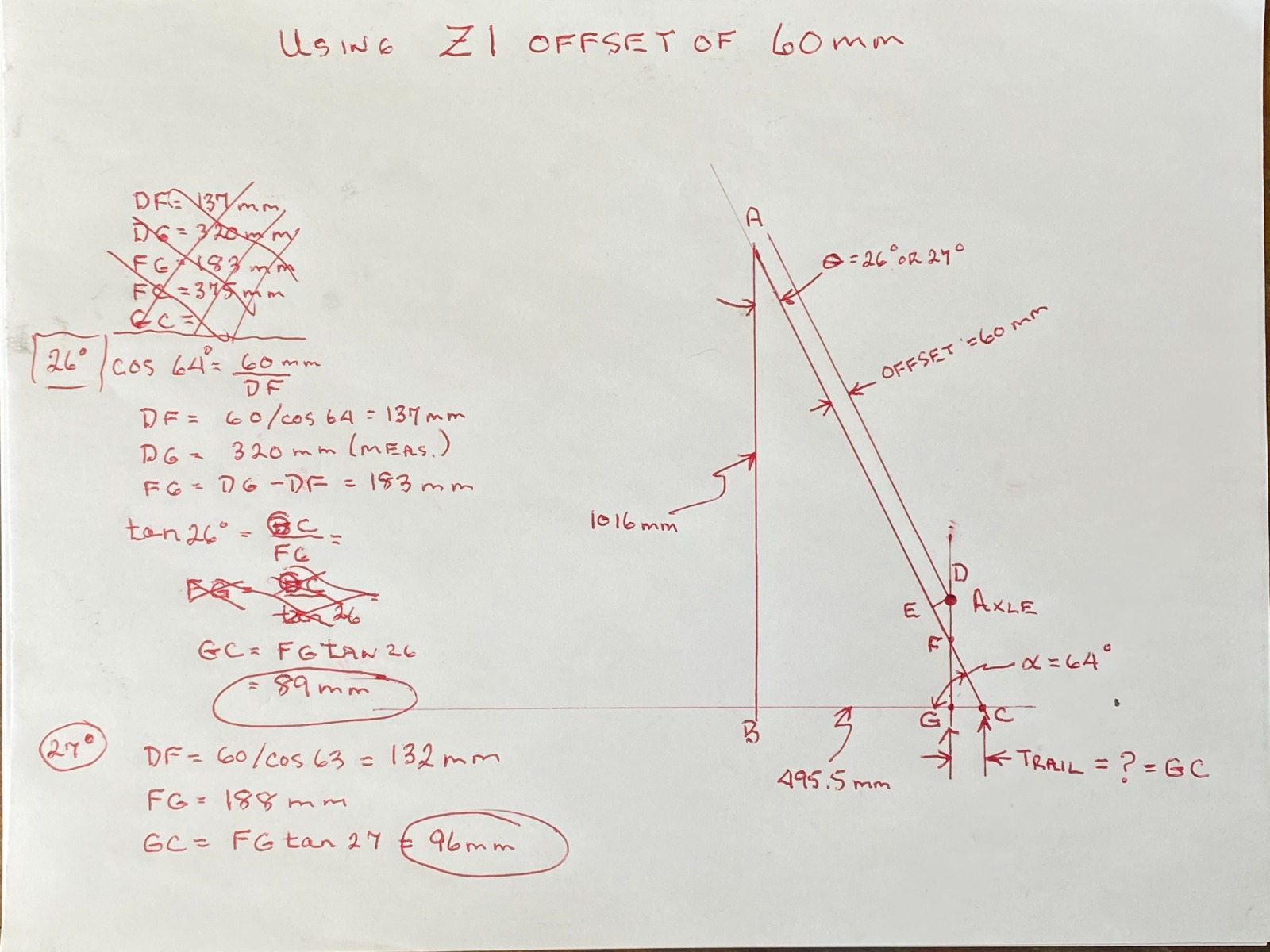

OK, so I sat down with a straight edge and a pen, trying to refresh my brain on grade 10 geometry along with manual training graphics to figure out the trail on this project. First attempt was to verify the trail on a Z1, with 26 degree rake, a 60 mm offset and 90 mm of trail. The diagram below shows "A" as the top of the headstock, BC as the ground and "D" as the front axle. "GC" is the trail, which was considered the unknown in the first case. I had to measure the height off the ground for the top of the headstock and the center of the front axle, which were approximate lengths only because I was holding the bike in the vertical while trying to take the measurements.
It's a bit tricky to get from the knowns to the unknowns, and the calcs are on the left side of the page. My answer was 89 mm, which compares favourably with the actual 90 mm. Of course the actual number depends on more precise measurements as well as tire size, inflation, etc. The tire in this case was a 19" Dunlop F11, which closely resembles the original Dunlop F6 from back in the day. The rear wheel is stock with a stock K87 tire.
For a 27 degree rake the trail calculates out to 96 mm. Again, the assumptions above would apply. So as long as I use the same size front and rear wheels, and the forks are the same as a Z1 I should be OK. I'll have to do the calcs again with 1 inch shorter forks to be sure the trail isn't less than 90 mm.

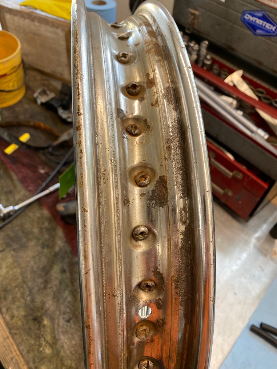

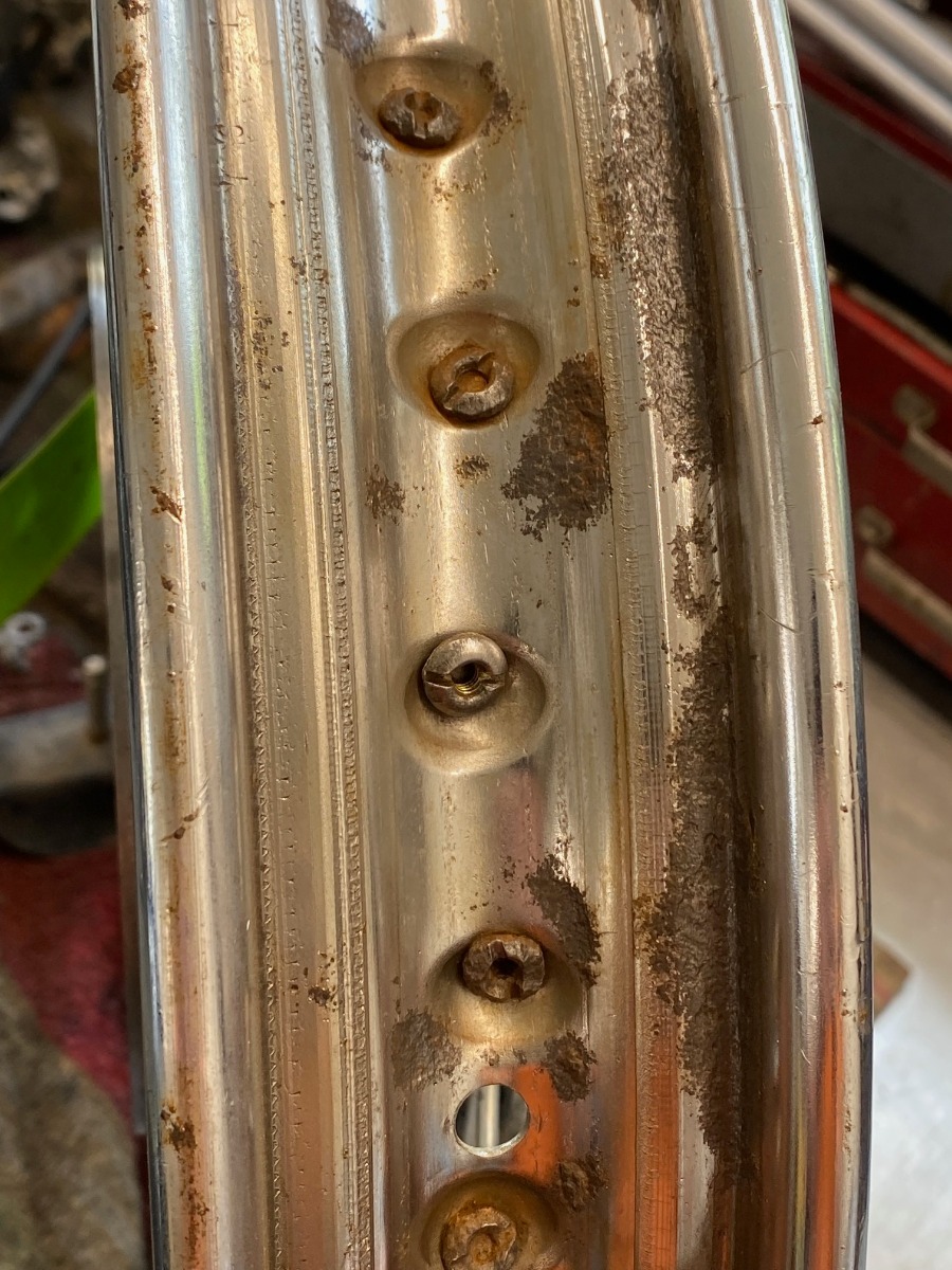

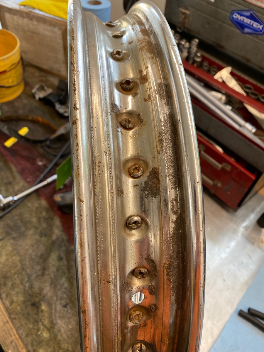

Wheels are back from the Kawi dealer, where I had them dismount the tires. These are original rims but painted black, so I have some work ahead of me to clean everything up. Right now I'm pulling the spokes and cleaning them one by one. The rim chrome looks alright but there is rust inside along the tire bead surfaces. Only surface stuff, but still rust that must be cleaned up. I'm thinking of dunking them in metal rescue to fix the rust but interested to know if anyone has tried anything else?
Cases are also back after pressing the bearings in, so I can start to rebuild the engine. Still looking for someone to weld the tail onto the frame.

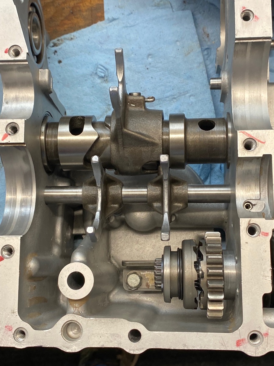

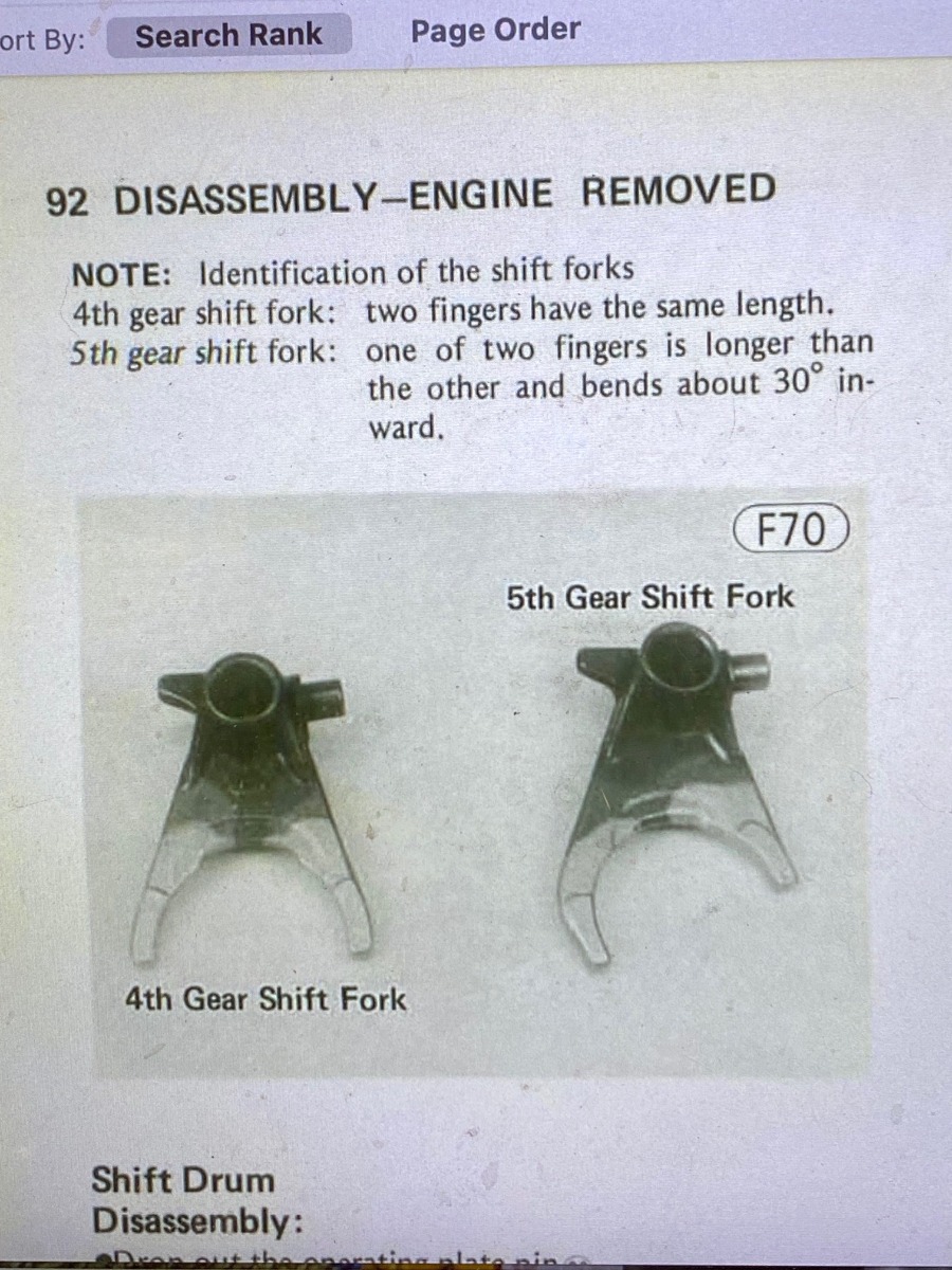

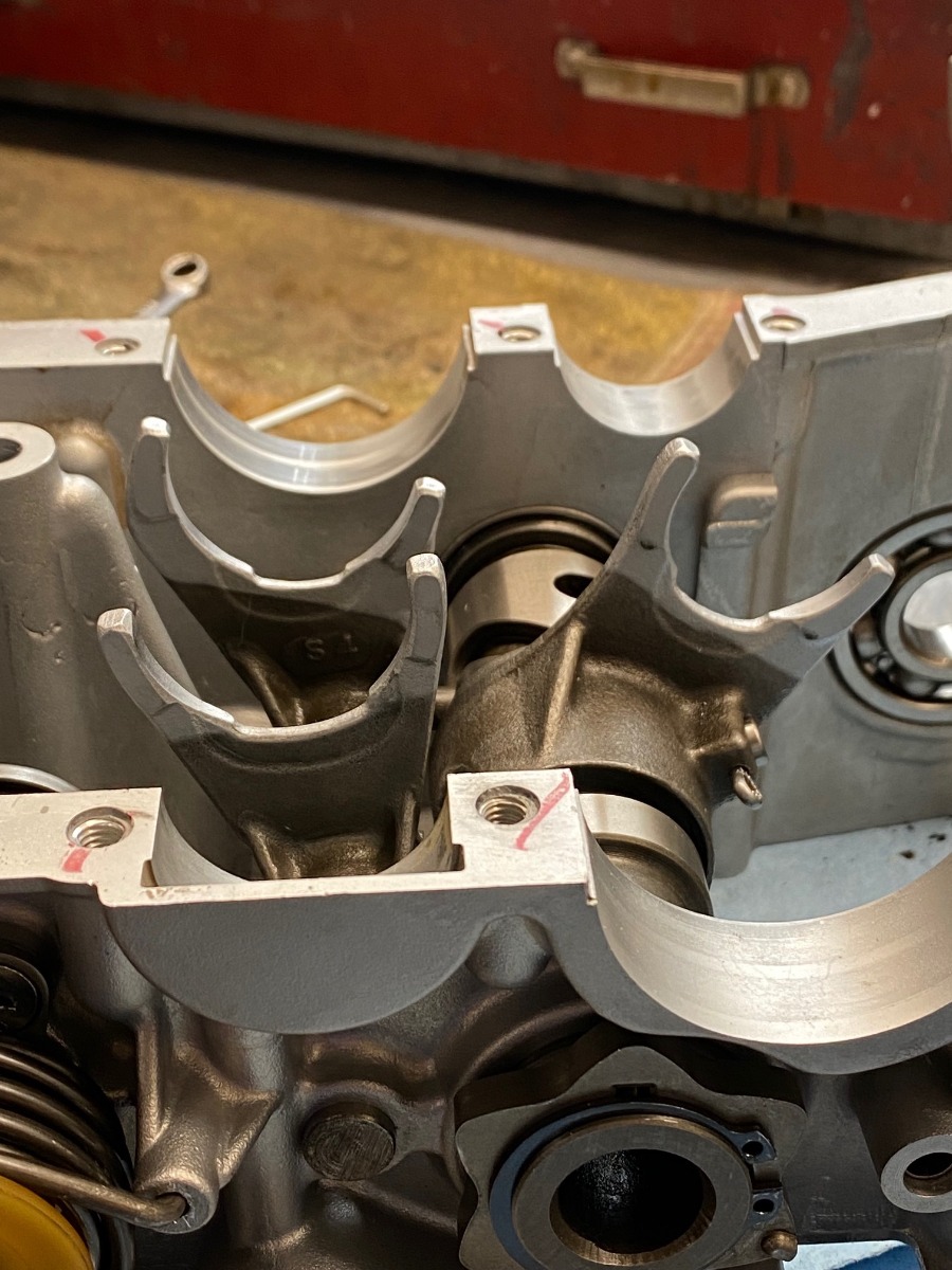

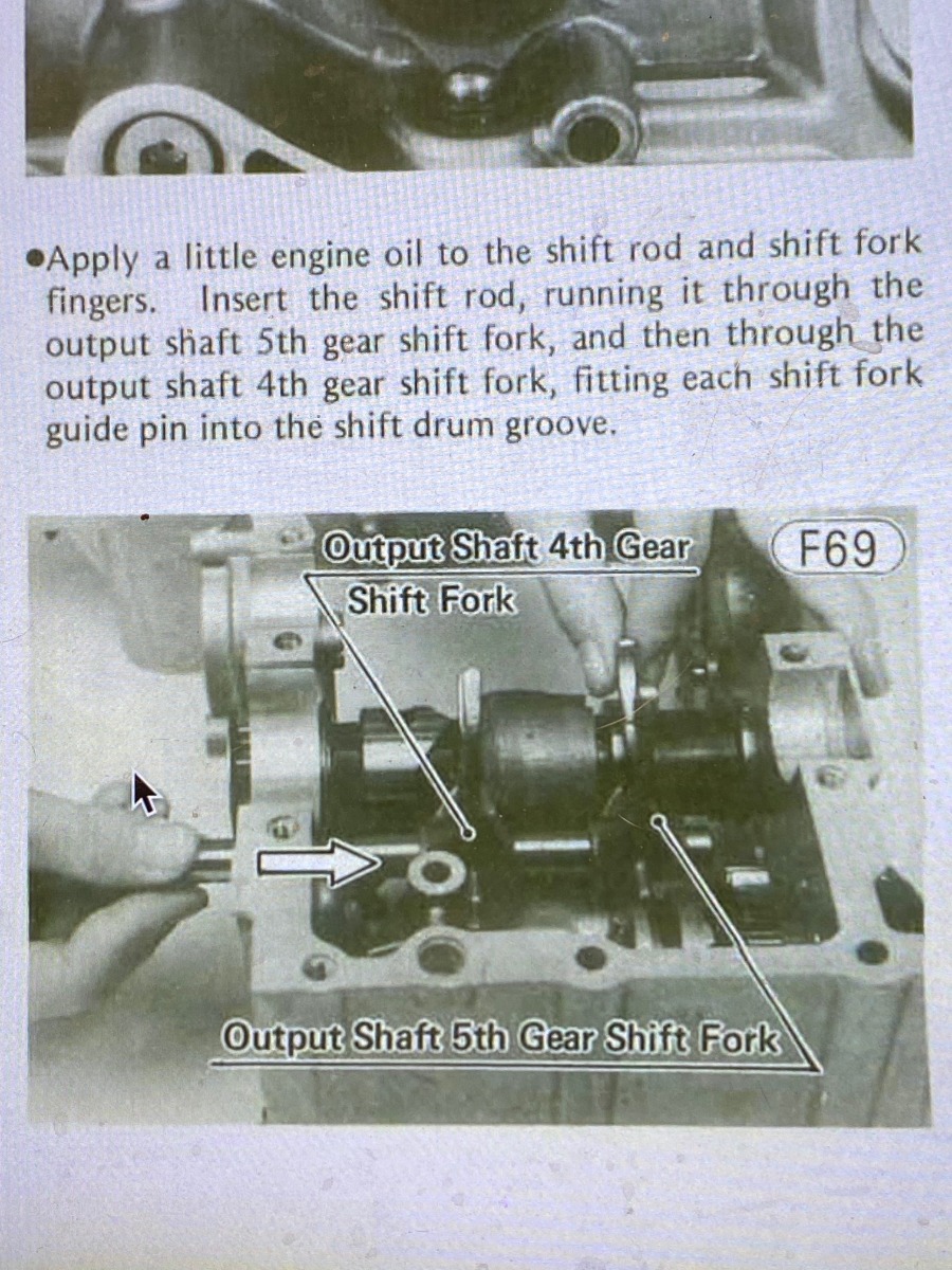

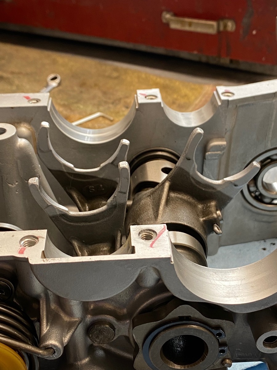

Today I started to rebuild the engine and ran into my first problem. Unlike a Z1, the shift forks on the small shaft are not the same. I took photos of the dismantling but they are from the top of the engine and I can't tell which fork is which. The manual isn't clear either. Here is what the manual shows to describe the forks....
It describes the forks well enough, but then for assembly it says this...
Notice in the written instructions it says to insert the shaft through the FIFTH gear fork first, and then through the FOURTH gear fork. But look at the photo where they show the opposite! I'm left wondering which way is correct, and it matters because the two forks are different. Does anyone know the correct way? I installed according to the written instructions as shown below. The final photo shows them in position as per the written instructions.
