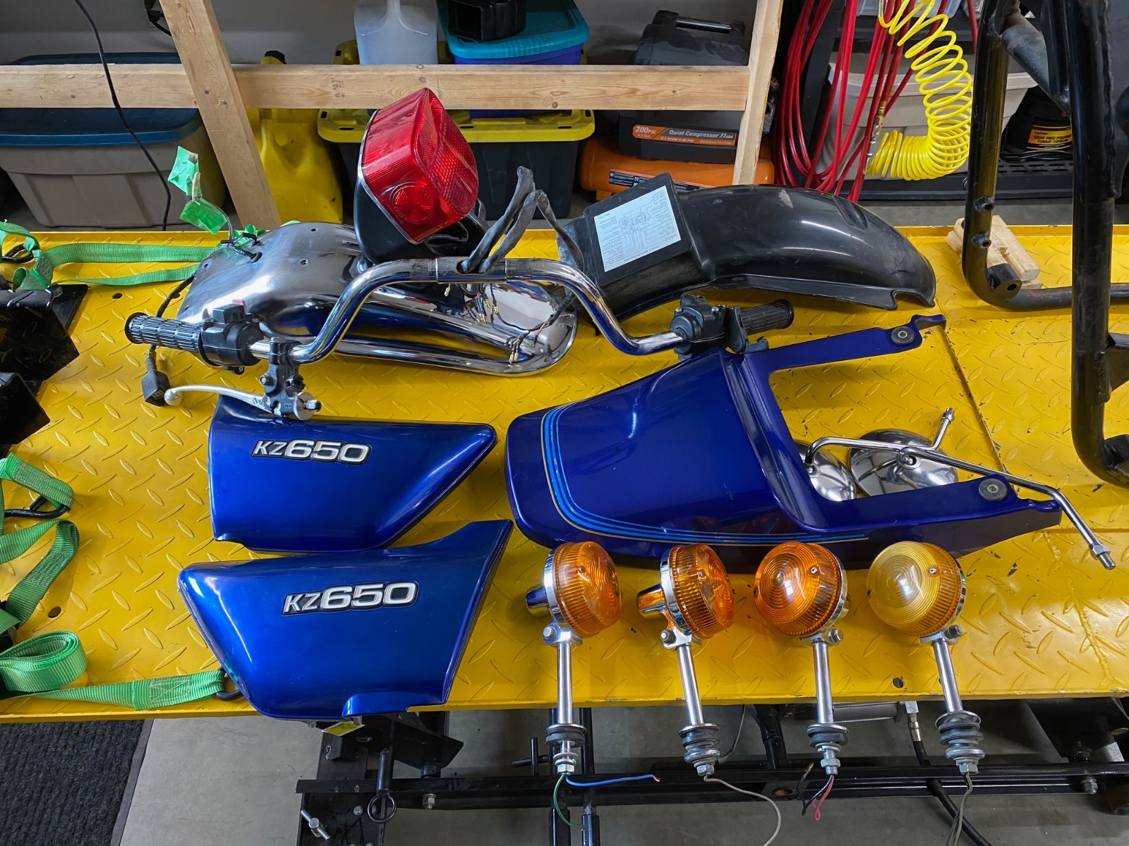

Yesterday I drove to Kelowna, in the Okanagan Valley to see a '78 KZ650 that an owner was stripping down to build a bobber. He said he bought it from an estate where the owner had died suddenly. From what I saw the bike had been carefully tended for many years and I felt badly that a perfectly good bike was being stripped to make a bobber. My only consolation is that I picked up as many pieces as I could get, and got a promise of first dibs on anything else the owner didn't want. The photo below shows what I picked up...sidecovers and tail piece, rear fender (inner and outer) and tail light, signals, mirrors and the bars complete with controls. I looked around the guy's yard and he has a lot of projects on the go, so I'm not sure he will ever finish this one. If not, I have dibs on the swingarm, shocks, pipes (original, in excellent condition) brake assembly and any other parts that I may need.
The paint on the sidecovers and tail piece is original and in very good shape. Now I need to find a blue tank to match.
Currently waiting for a triple tree to arrive via ebay. Then a trip to my sand/vapour blaster to get the frame etc ready for paint.

Re: 1978 KZ650 Bike Build
10 Mar 2021 12:49
Does he have rear grab handles? I need pair!
10 Mar 2021 13:52
Nice score. What a shame, but like a successful organ transplant some of the generous donor will live on... hopefully that will give you some comfort and allow you to erase the egregious hack job you were forced to witness.
- Thanks: 2260
10 Mar 2021 14:30
It makes my heart bleeding seeing so nice parts rip off a nice and perfectly stock bike :ohmy: :ohmy: :ohmy:
- Posts: 3133
- Thanks: 1235
10 Mar 2021 16:43 - 10 Mar 2021 16:45
Yes, I have a dull ache in the pit of my stomach when I think about how I would feel if someone did that to one of my bikes. The original owner must have loved riding. The bike had over 45k kilometers on the speedo. The gauges were in first class condition other than the usual faded tach redline. Wish I had gotten the tank, but it was gone when I arrived. I definitely want the exhaust, and I know the new owner won't use it on his project. He had a half dozen other project bikes in various states of disrepair.
