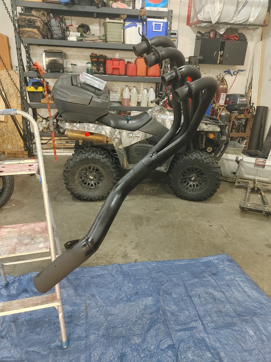

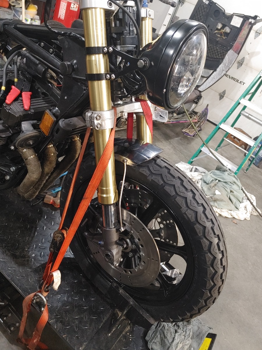

Picked up a 4-1 exhaust yesterday. No idea what kind or what it came off of but the headers fit nicely. Had to chop off the exhaust to fix some dents, removed baffles, ordered a new one, re welded the exhaust after I took pictures. Down side is it blocks my oil filter. So oil changes will be a bit more labour intensive.

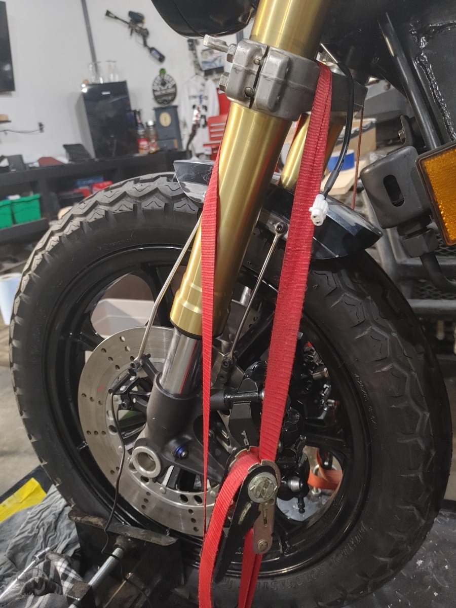

Also have my kz1300 18" front wheel buttoned up. Found my gsxr forks leaking so ordered new 0.90kg progressive springs and fork seals

Exhaust is on with a new mount welded. Just waiting on baffle and exhaust wrap.

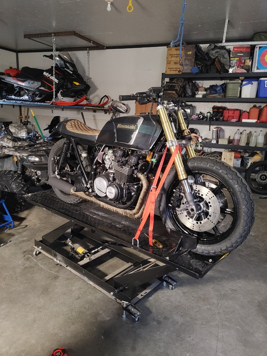

Wrapped the exhaust and finally bought myself a lift. No more bending over

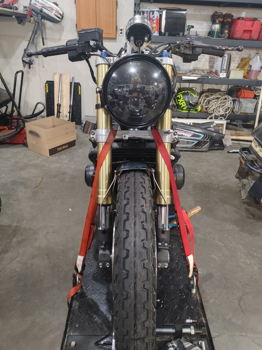

01 Apr 2021 21:21 - 01 Apr 2021 21:24
#845977

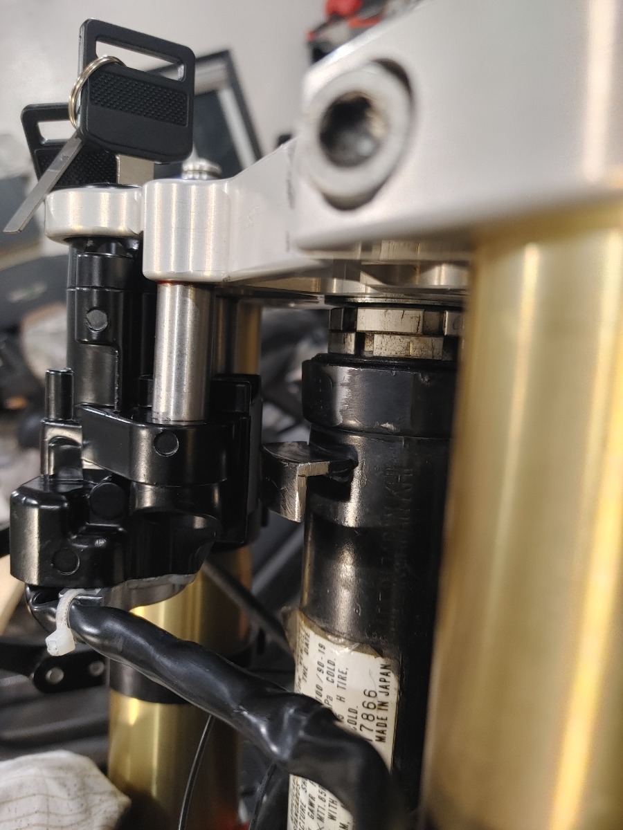

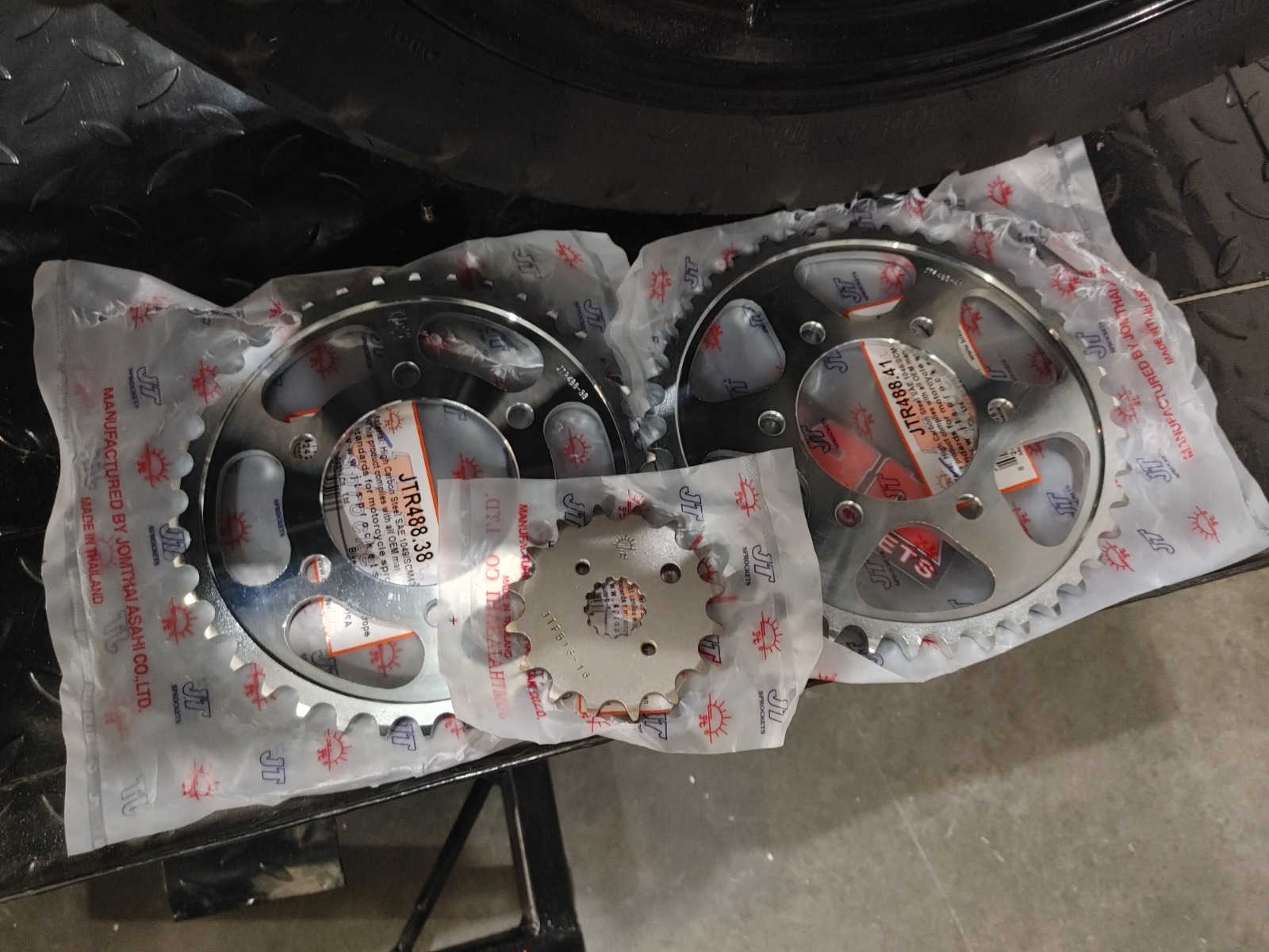

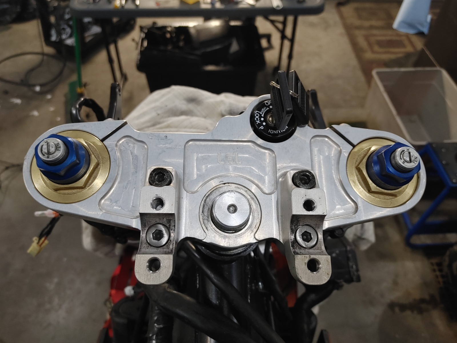

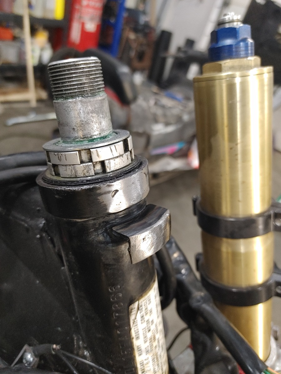

Still been busy working on the bike. Wired in a gsxr 1000 ignition. Fabricated a new steering lock tab on the original is stem and got my mig configured for stainless welding and did the front fender. Steel needs some paint and polishing but turned out good. Also removed rear brake fluid reservoir. Converted it to a clear hose. And got my 530 conversion sprockets in. Waiting for a license plate mount, 530 RK chain, and new braided brake lines.

Re: KZ750L4 - the bike that sat for 34 years.
02 Apr 2021 01:02
#845980
You have forgot the dust cover on top of the head stem bearing. The washer should on top of the yoke.
02 Apr 2021 05:29
#845983
You're right thanks sir. Dust seal is there but I didn't realize there was also a stem cap to go over as well. Appreciate it

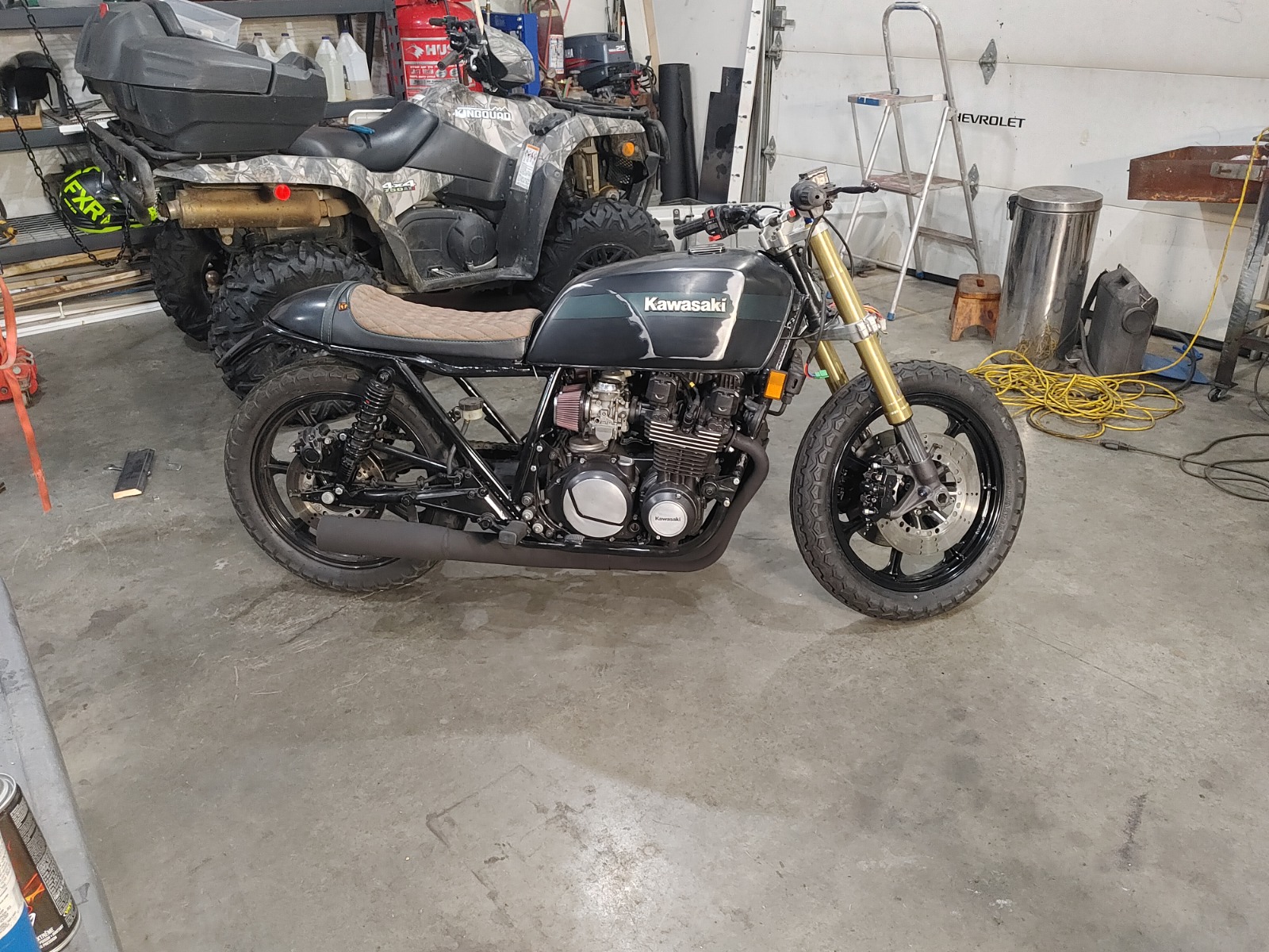

24 May 2021 19:00
#848973

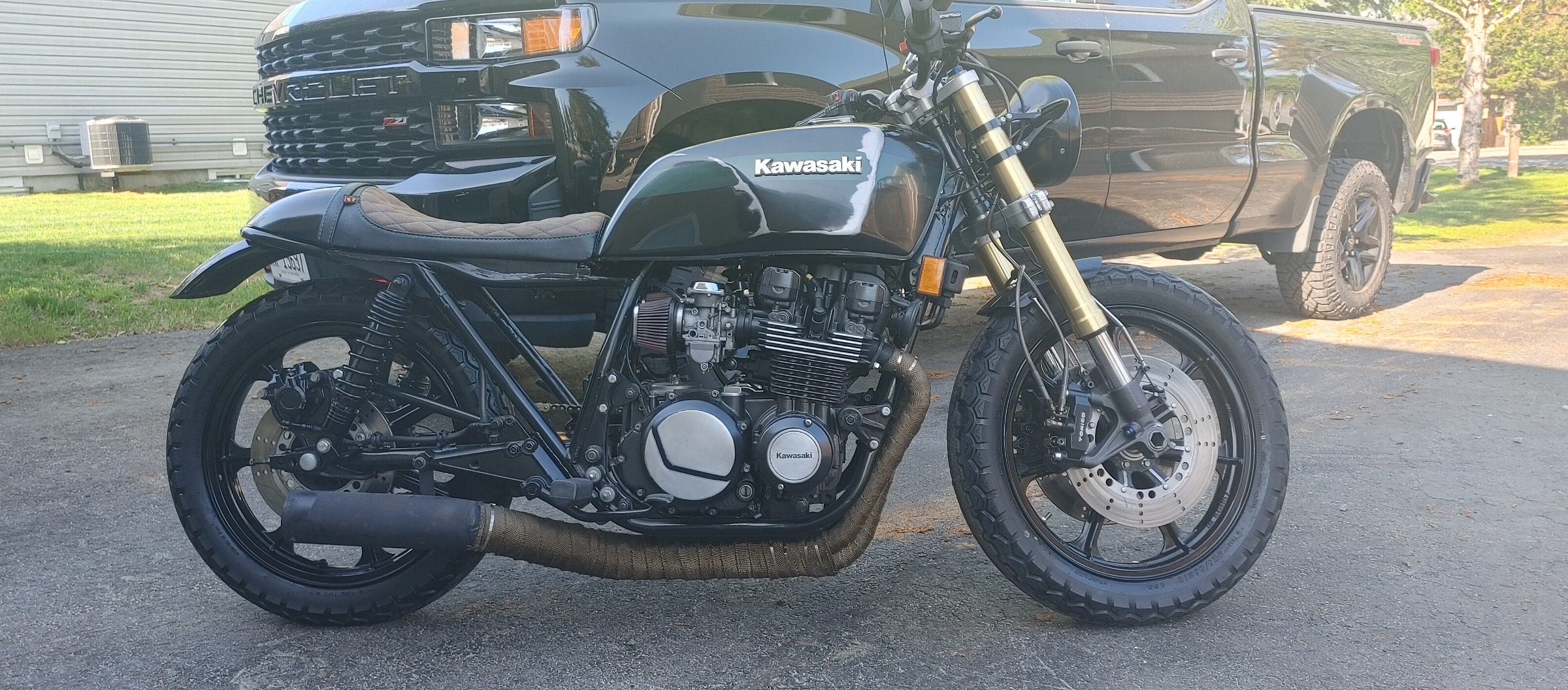

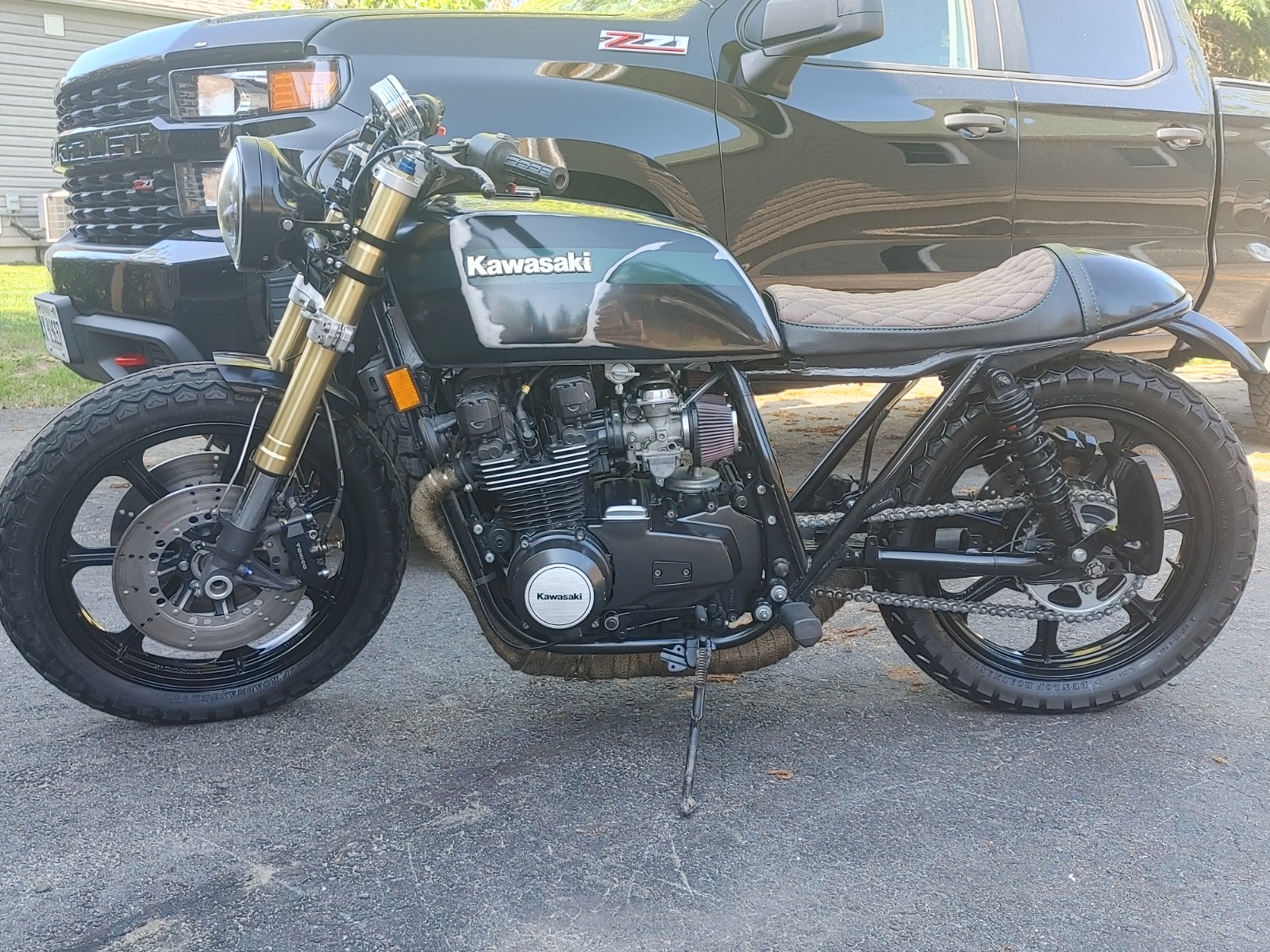

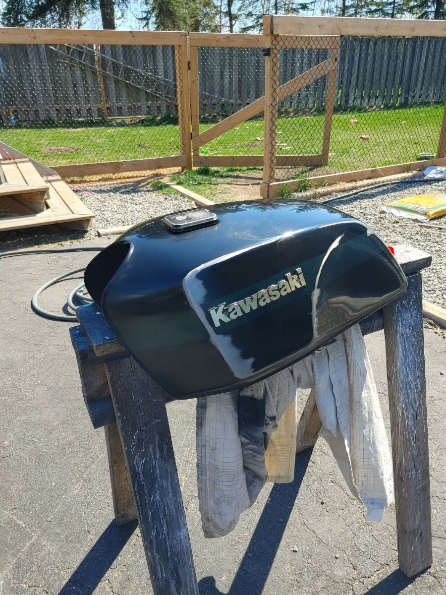

Well the bike is finished and runs perfect. I had a small issue with some tank rust keeping my petcock open and at the same time my petcock started leaking. Changed petcock and did a muriatic treatment on the tank and all is good. Ended up putting a new coat of clear on the tank. Changed it from matte to clear and I find it looks a lot better. Here's some pictures.
26 May 2021 05:14
#849006
Nicely done.
