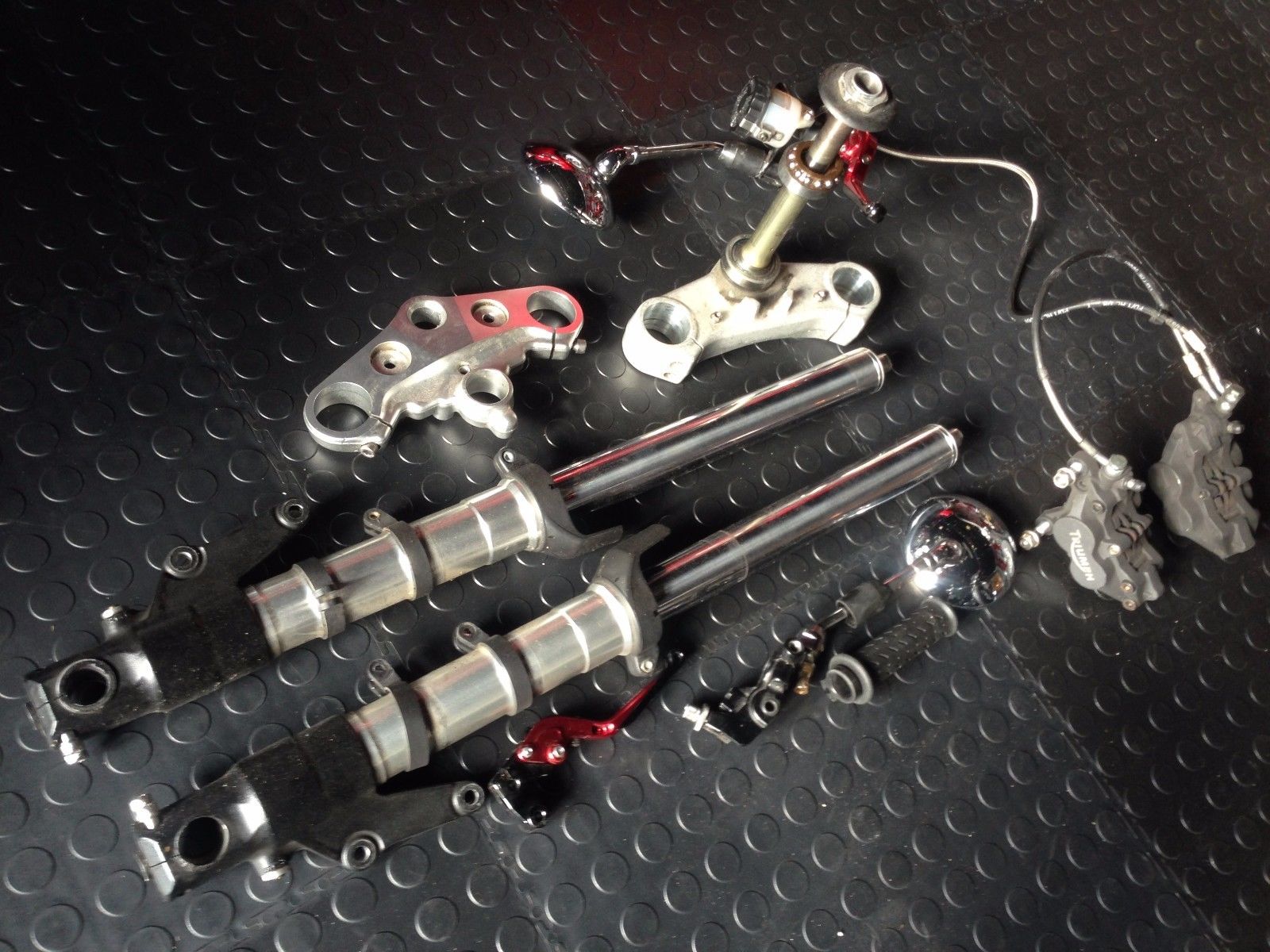

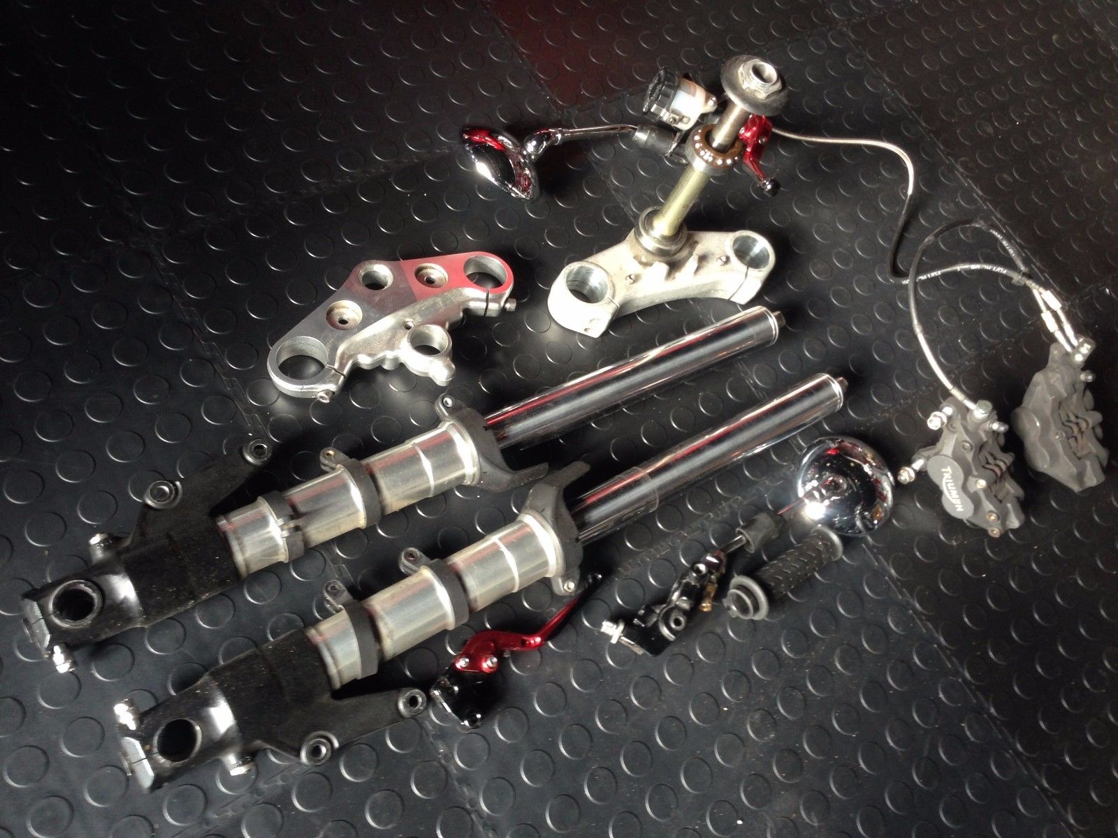

Its good when it works out like that, I had no idea they were the same spacing until i put the front wheel in the forks, just lucky. The Z1300 had a 210mm fork spacing, apparently the GSXR has too, the Triumph forks I used are also 210mm spacing, they are also right side up forks, I didn't want to use USD's. I was lucky to get all this for 100usd

Wow that's a great deal. I'm about 650 CDN into the gsxr forks. I see you can put risers on your clamp as well. What are you going for bars?

The triumph top clamp has risers as standard, I'm lowering the risers to about 40mm and using low rise superbike bars... I also had some new fork tubes made 100mm longer to get the correct ride height, had to lengthen the damper rod and make new spacers for the springs {came with racetech springs} , I have around 530 AUD {Australian dollars} into the front at this point, including the Z1300 front wheel and the 180 AUD it cost to buy the 320mm disc rotor blanks, I still think its a cheap conversion, looks great too...

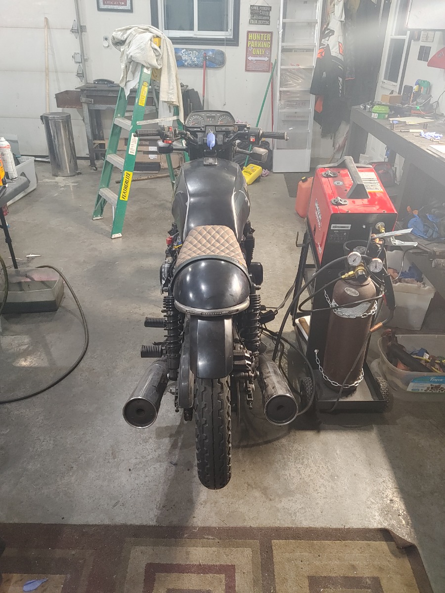

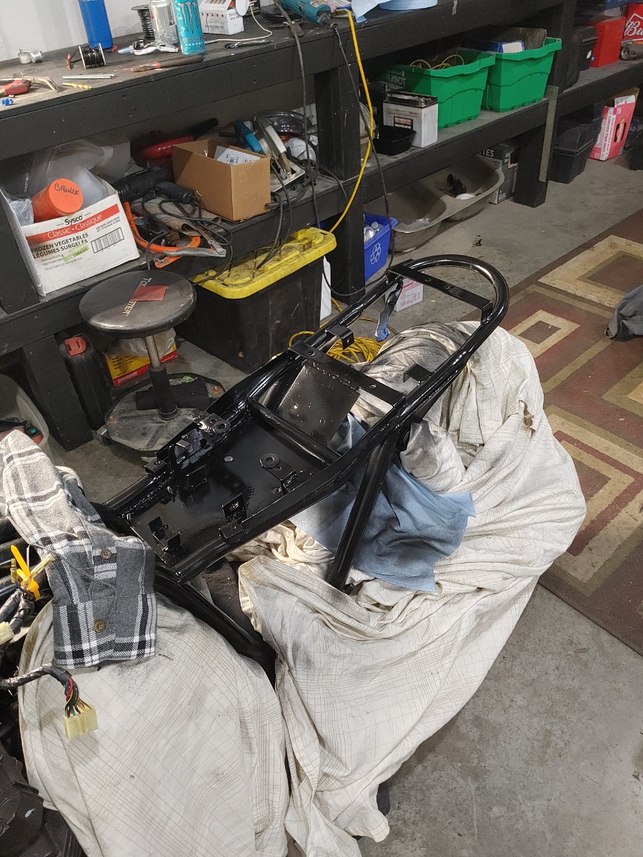

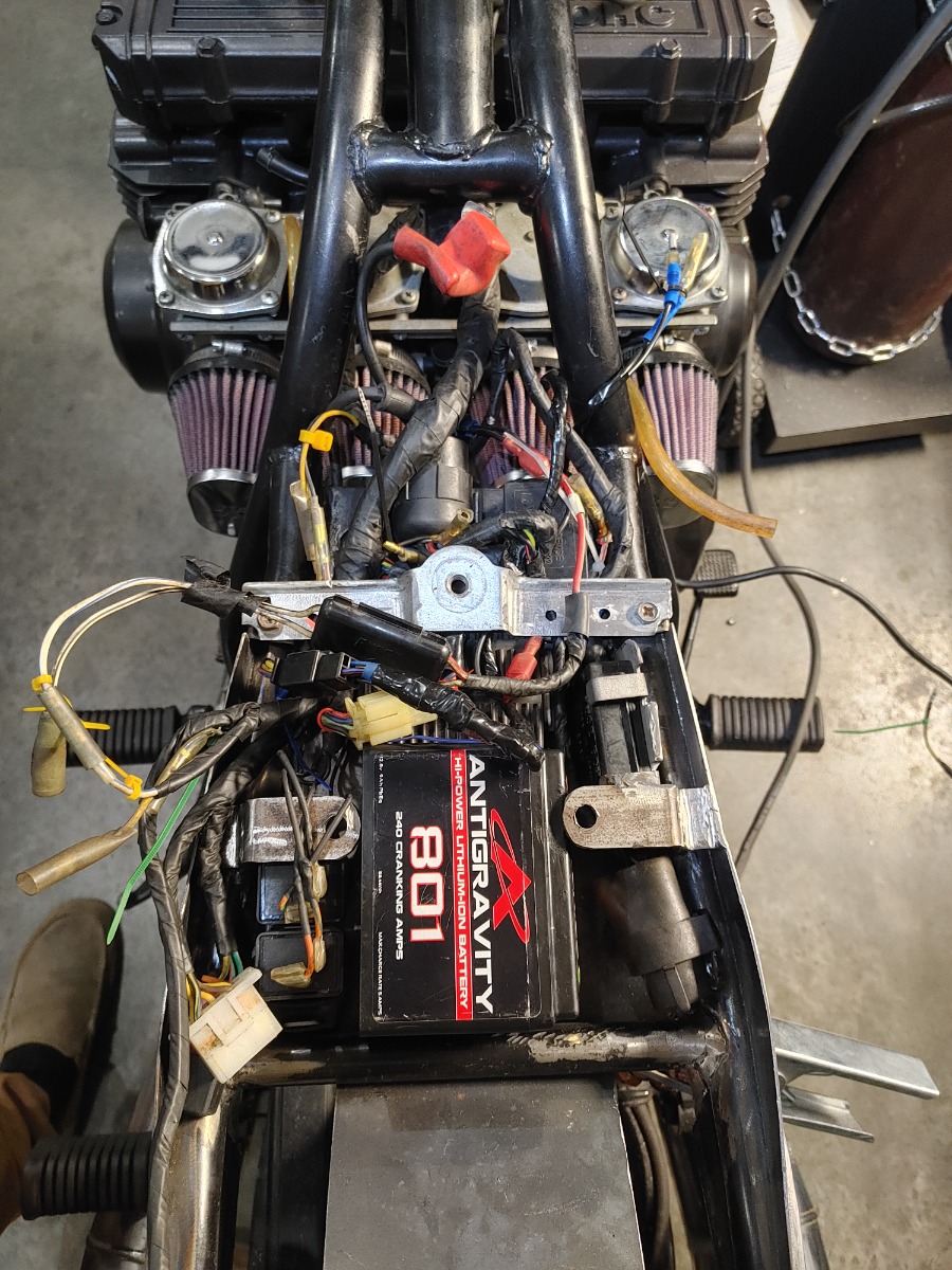

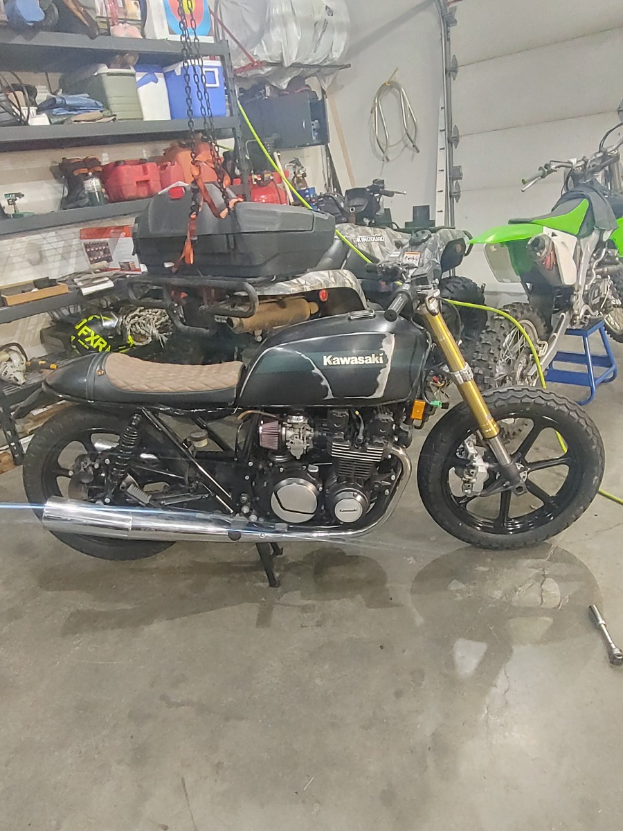

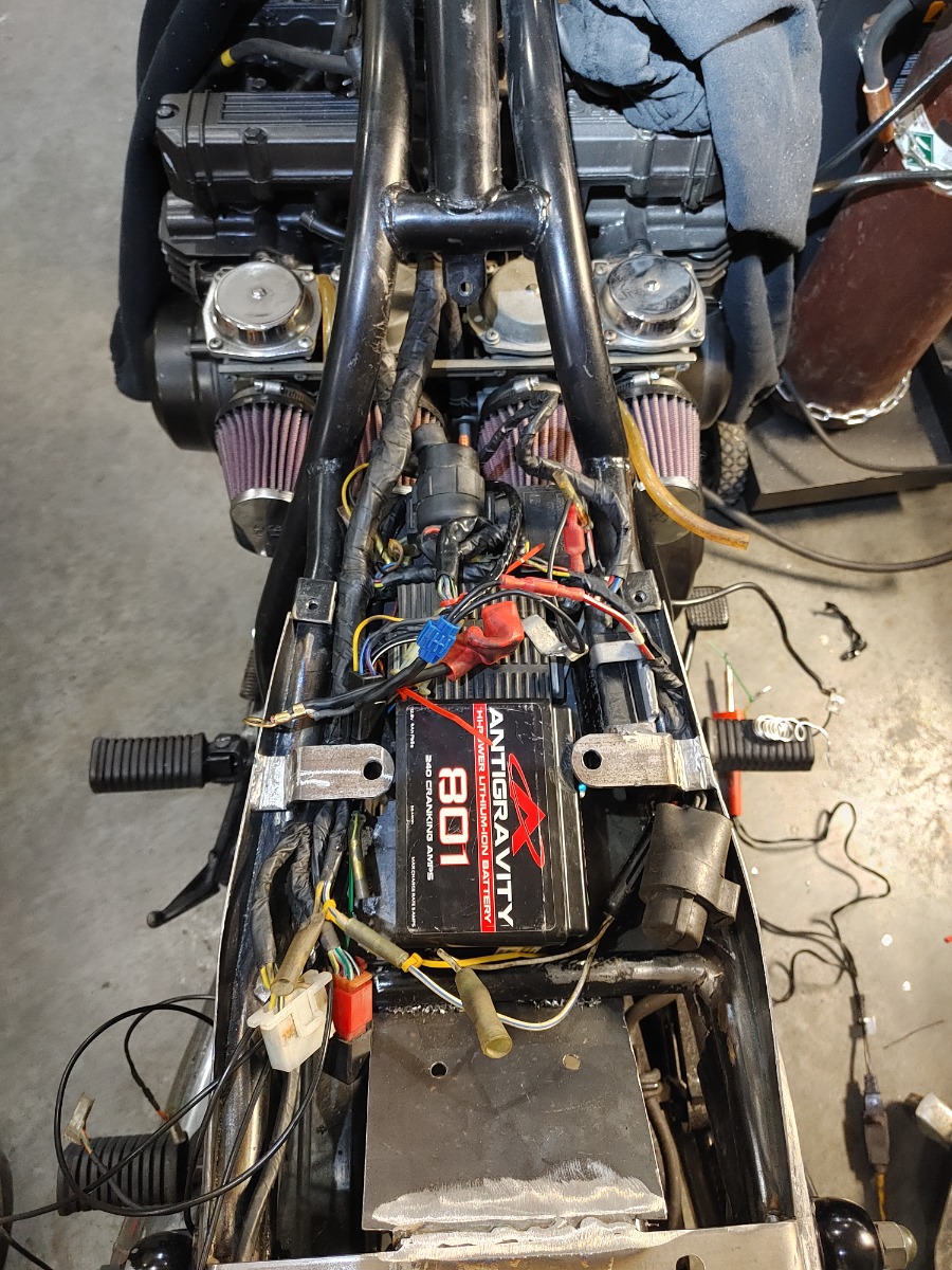

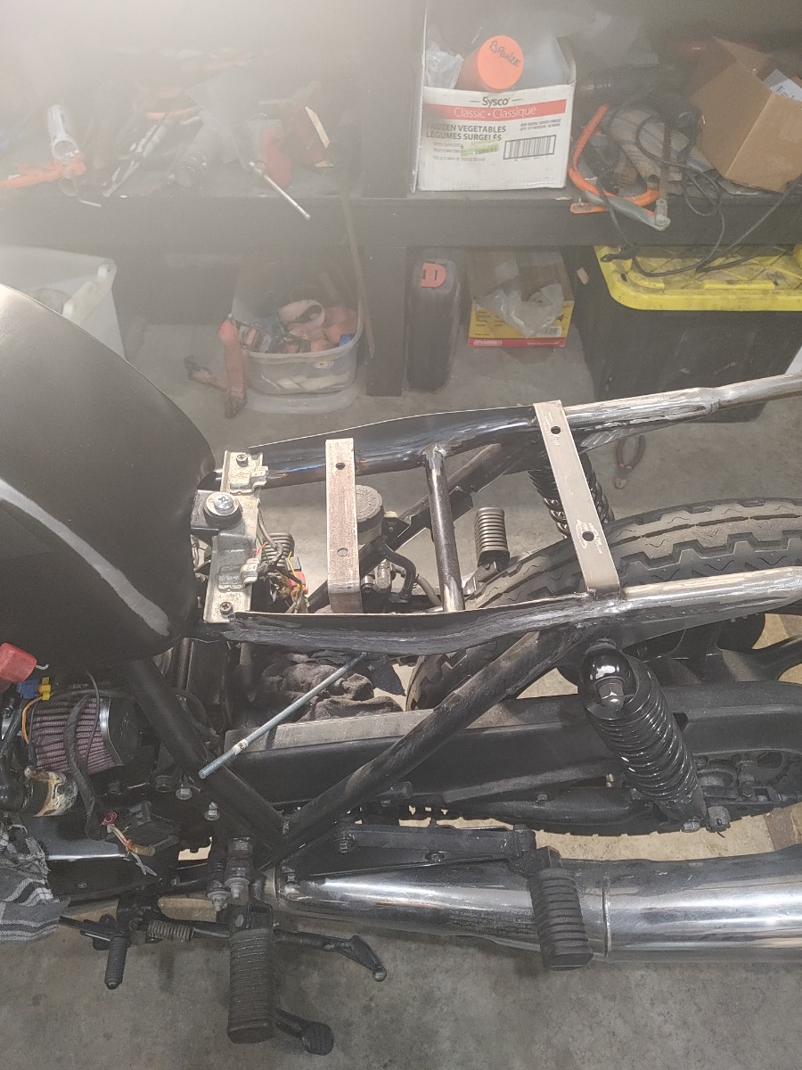

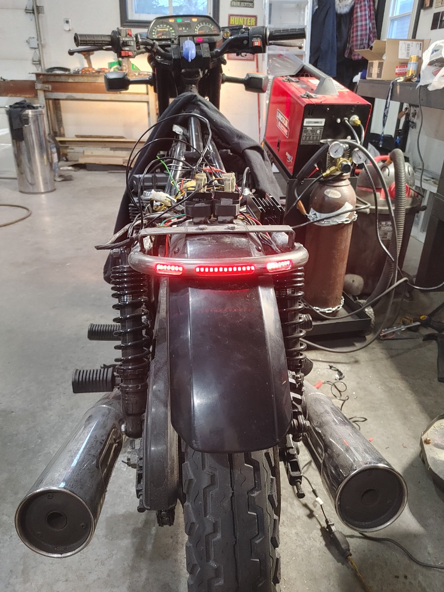

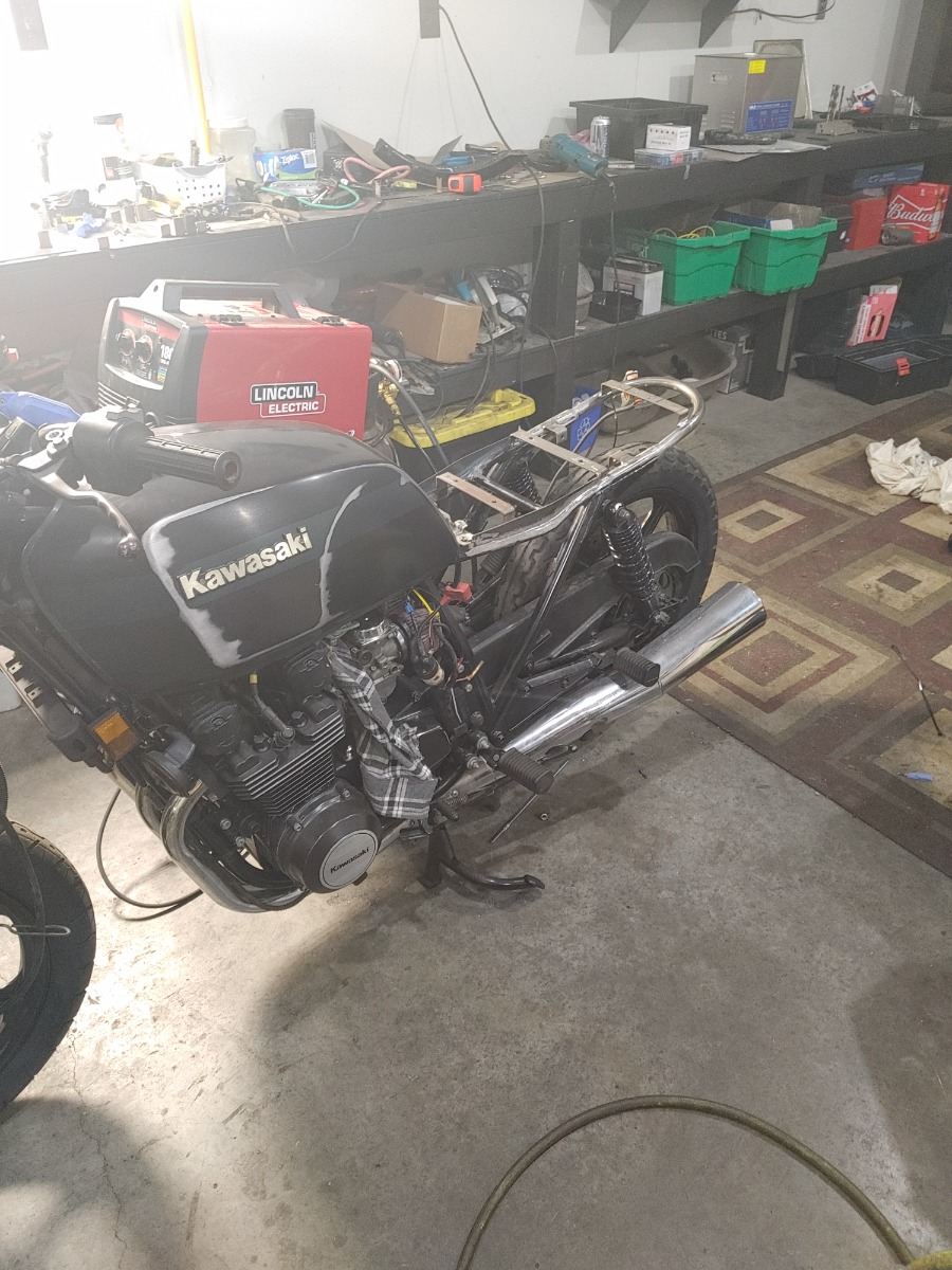

Ordered a custom seat from Tuffside seats in Las Vegas. Highly recommended. Chopped frame, added LEDs, mounted gsxr forks, powder coated matching 18x2.15 front rim, installed ricks regulator, 8 cell Anti Gravity battery,
