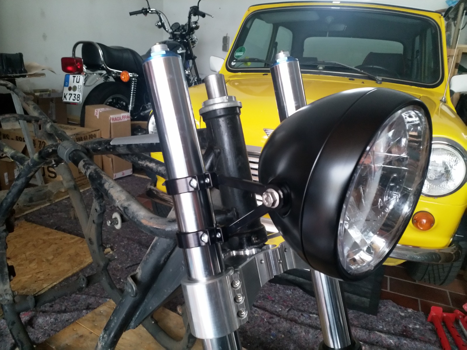

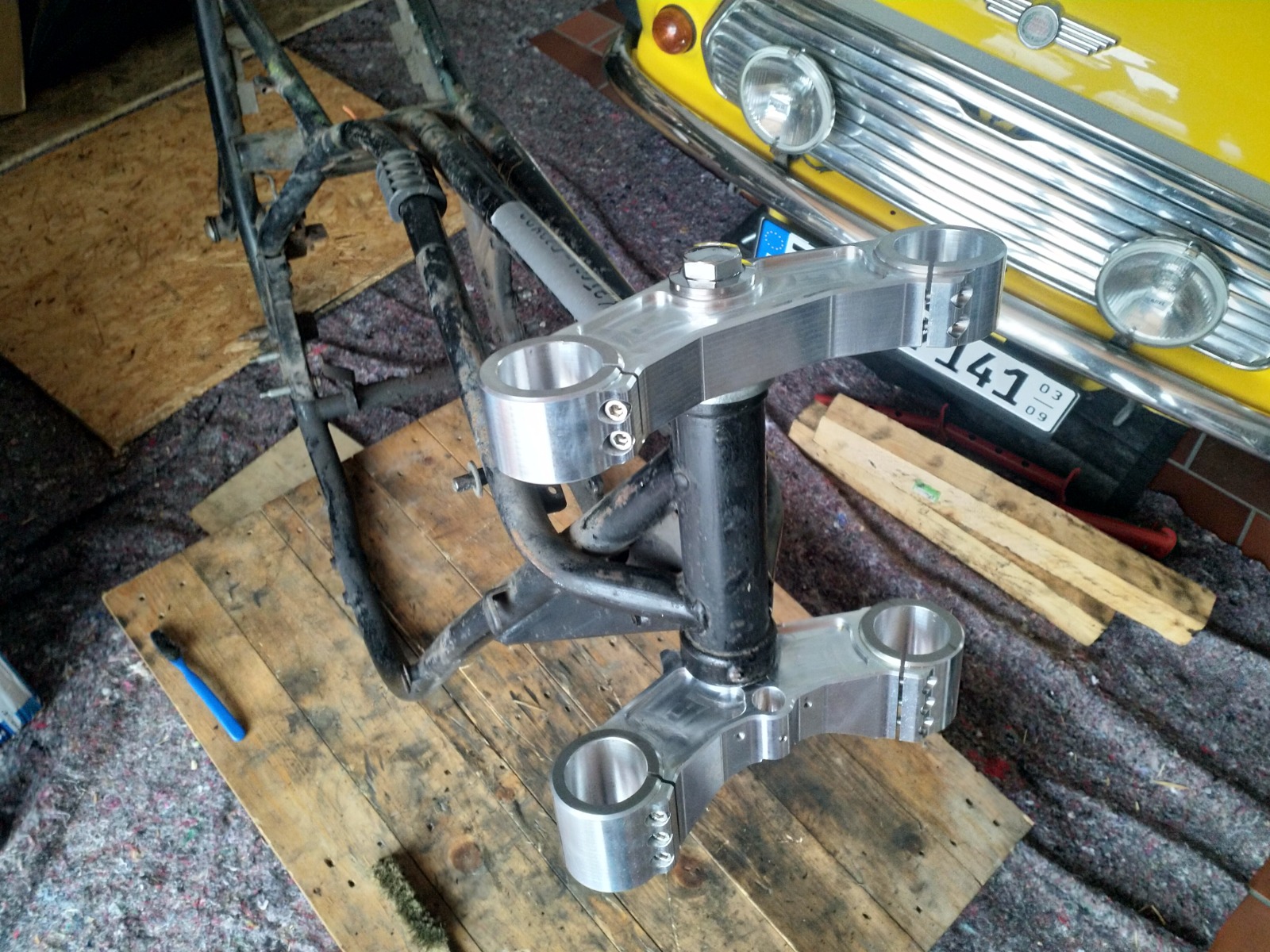

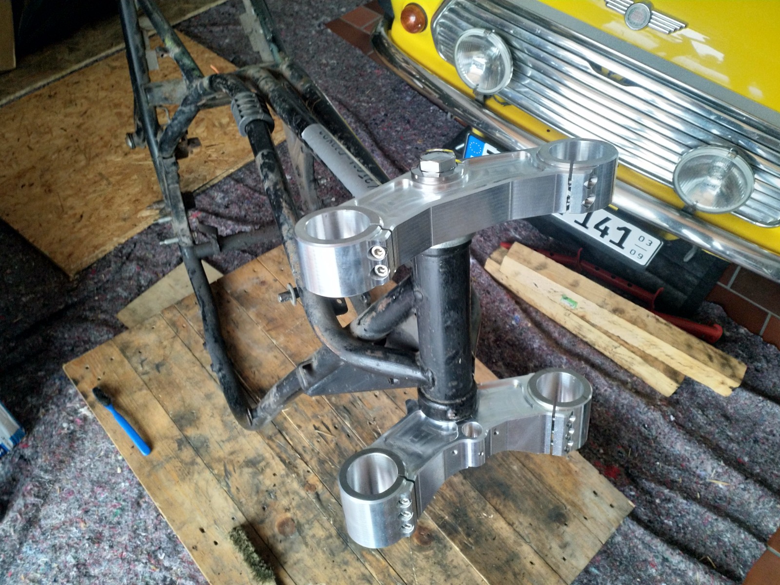

Finally started unpacking some of my shiny new parts today. Just trying to get the front end together to make sure everything fits. Will do the same at the back when the swingarm gets here. Then I will decide what work needs to be done on the frame and which parts will be polished and which will be painted.
Very limited space in the garage at the moment (as you can see in the photos). Between the 750, the Mini, the Zephyr and the KZ1000 parts and original frame it's hard to find somewhere to work.

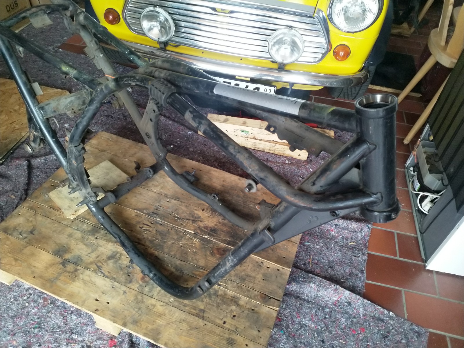

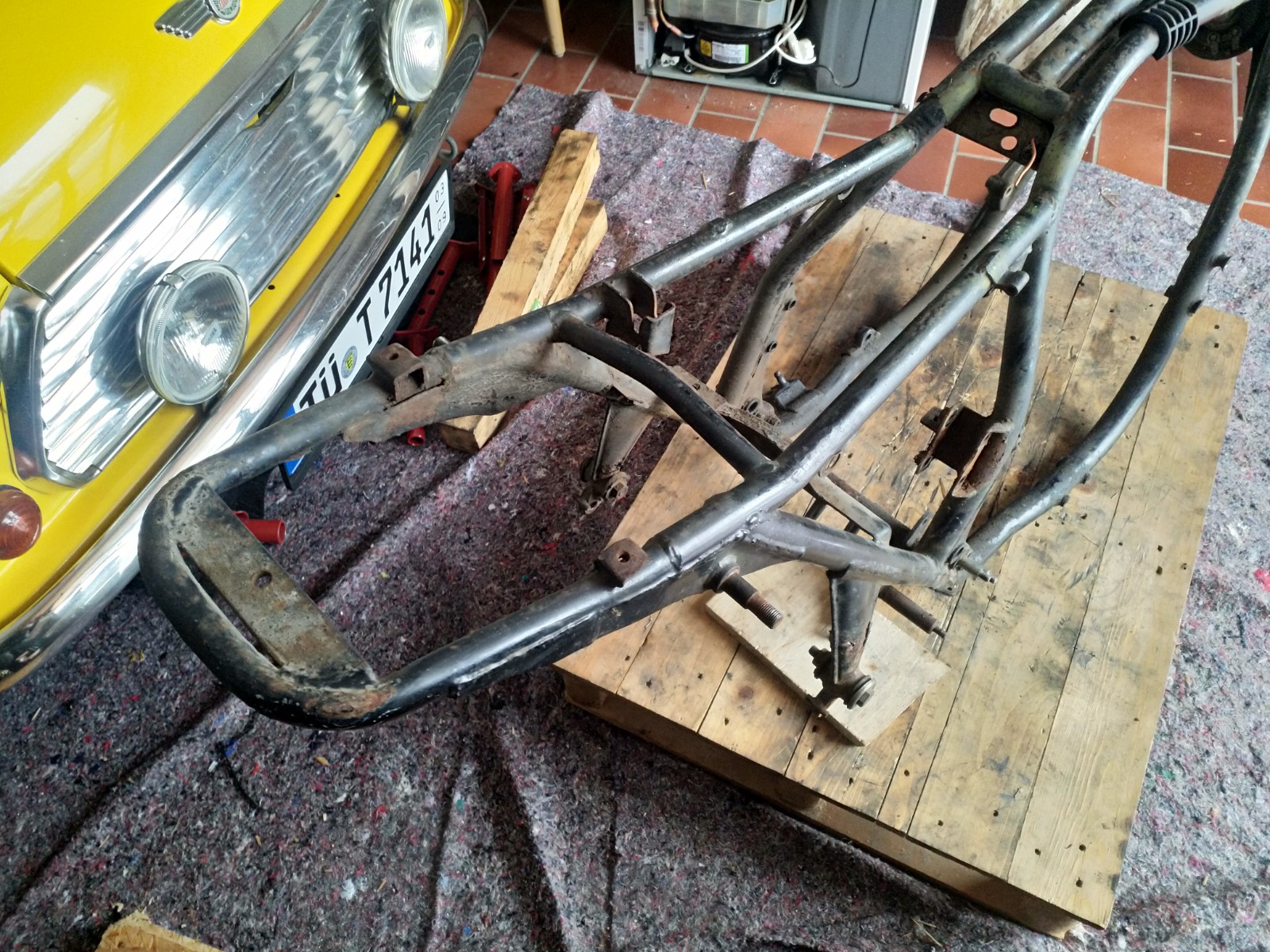

Here's the second frame I have. Back end has been butchered a bit (which is why I got it cheap). Doesn't look like it's been crashed though (steering stop and the plate behind it are still straight). Will get it checked out anyway - worth the cash to know everything is straight.

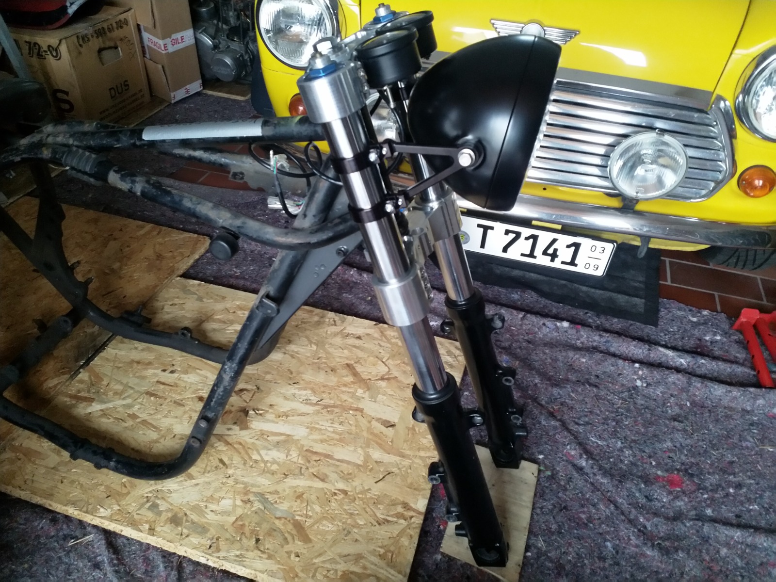

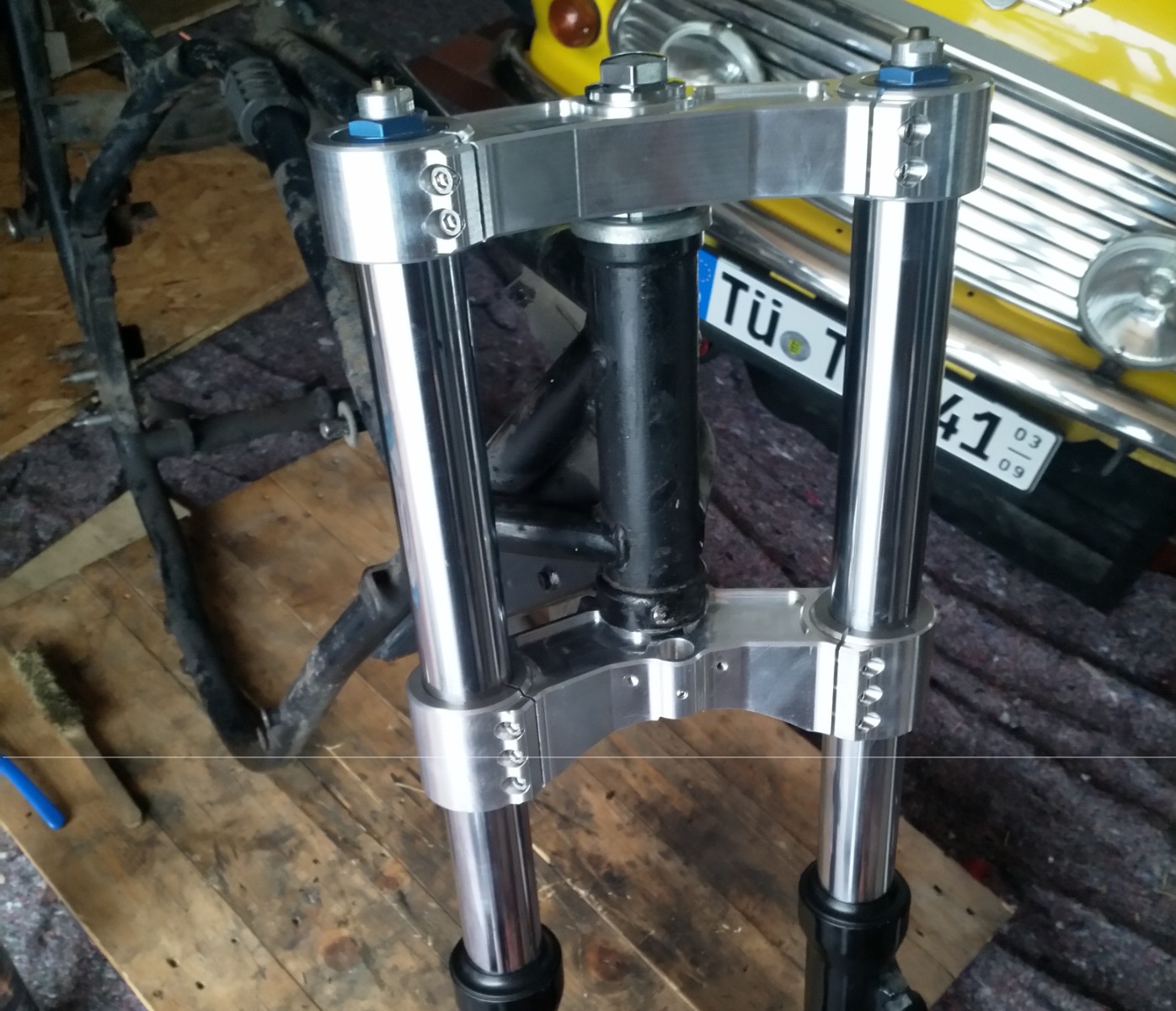

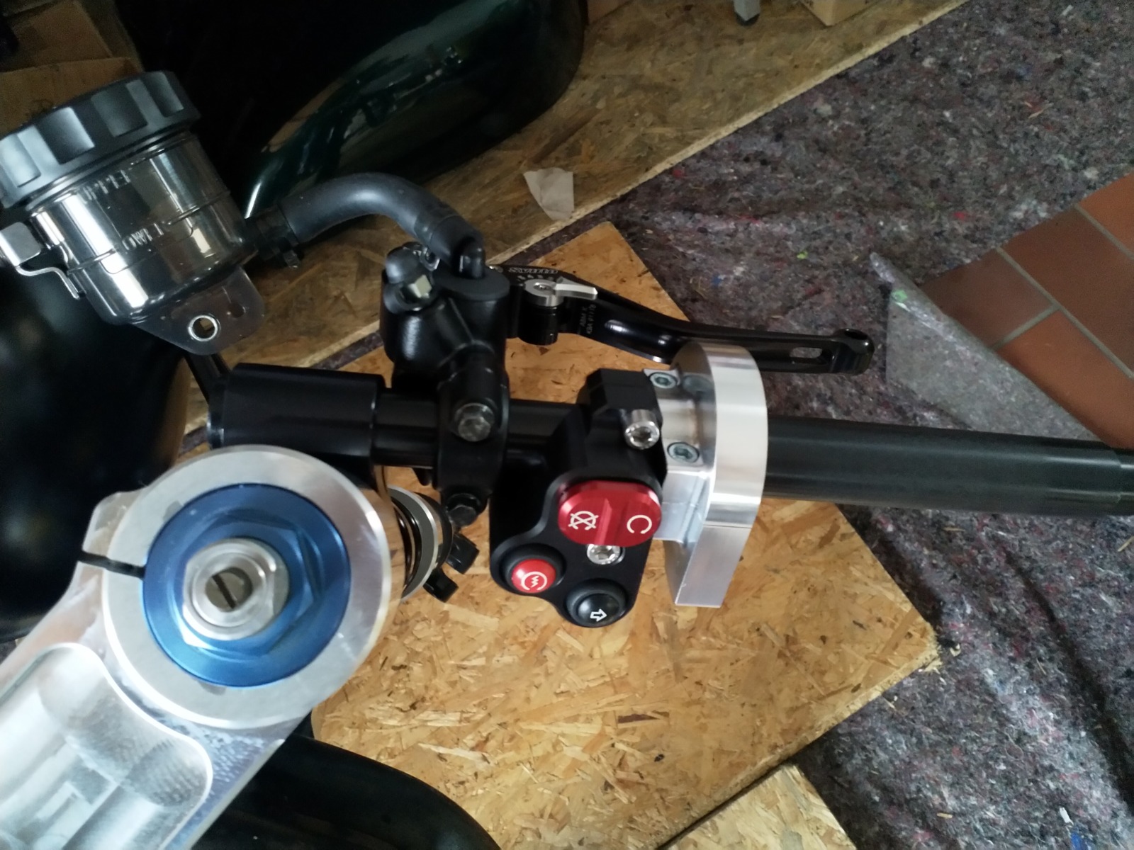

Assembled the triple clamp, forks, headlight and clip-ons :

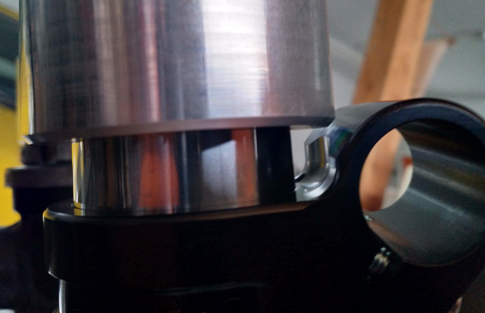

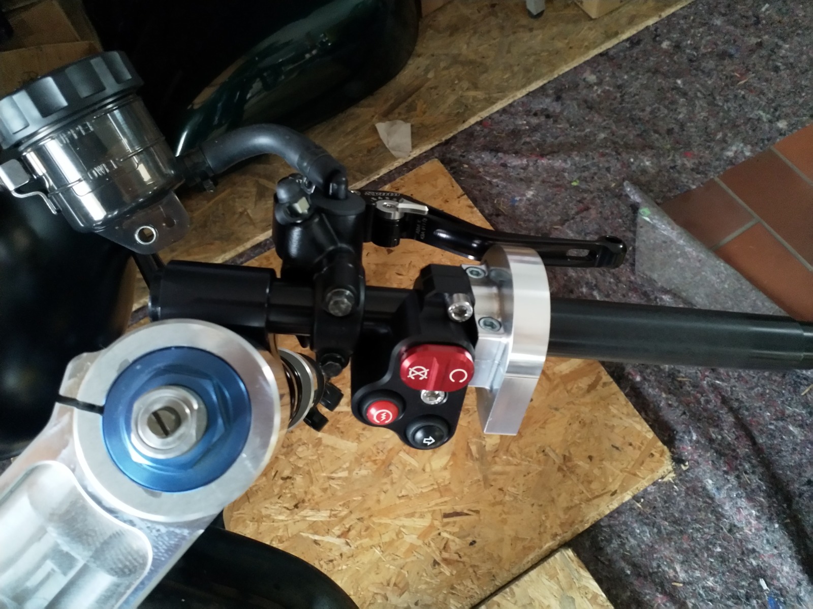

The brackets for the clip-ons hit the bottom of the top yoke. Have some different brackets on the way.

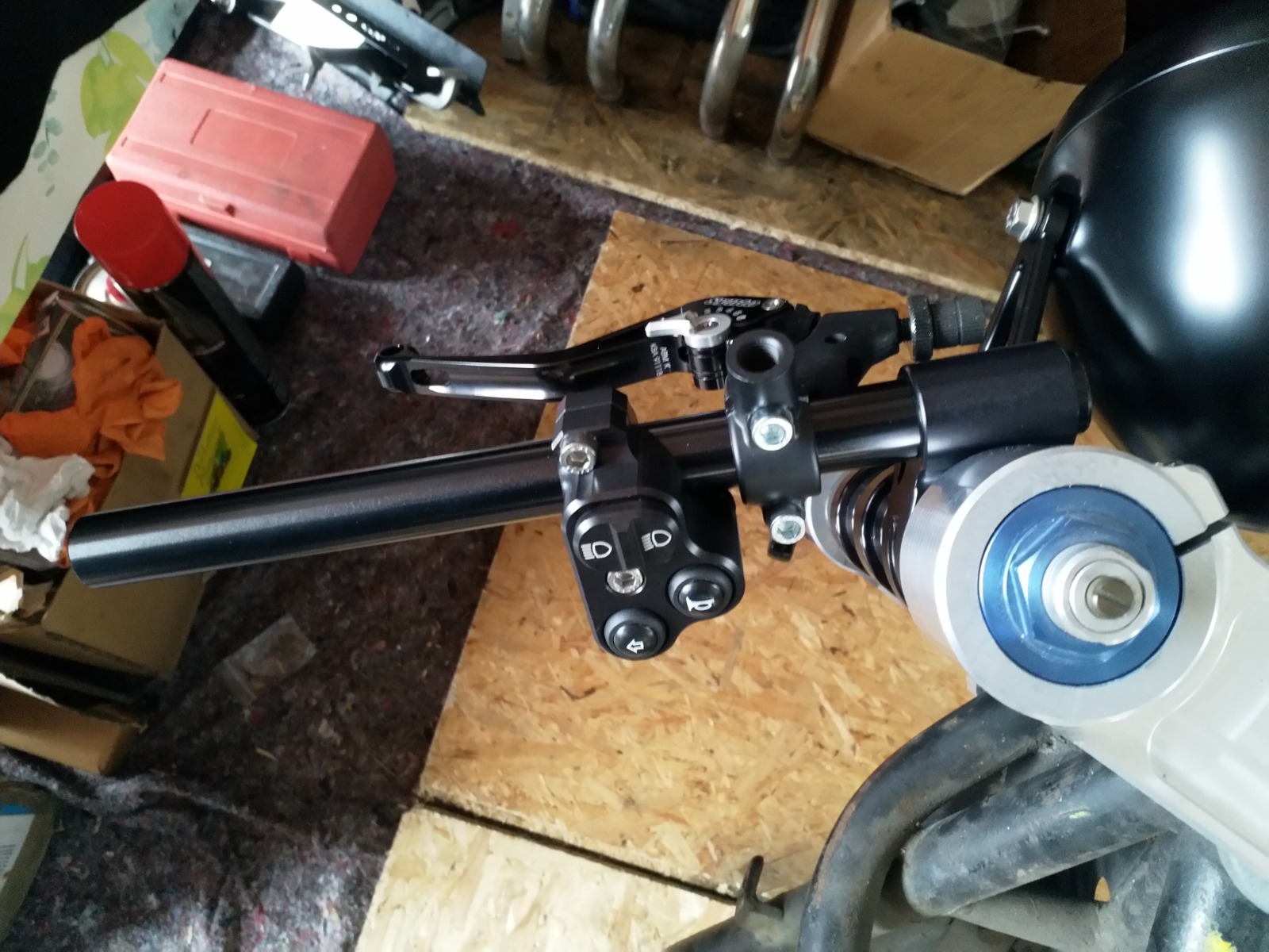

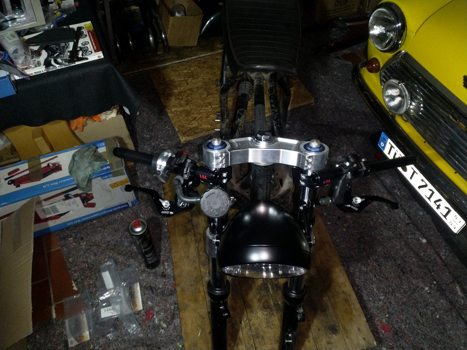

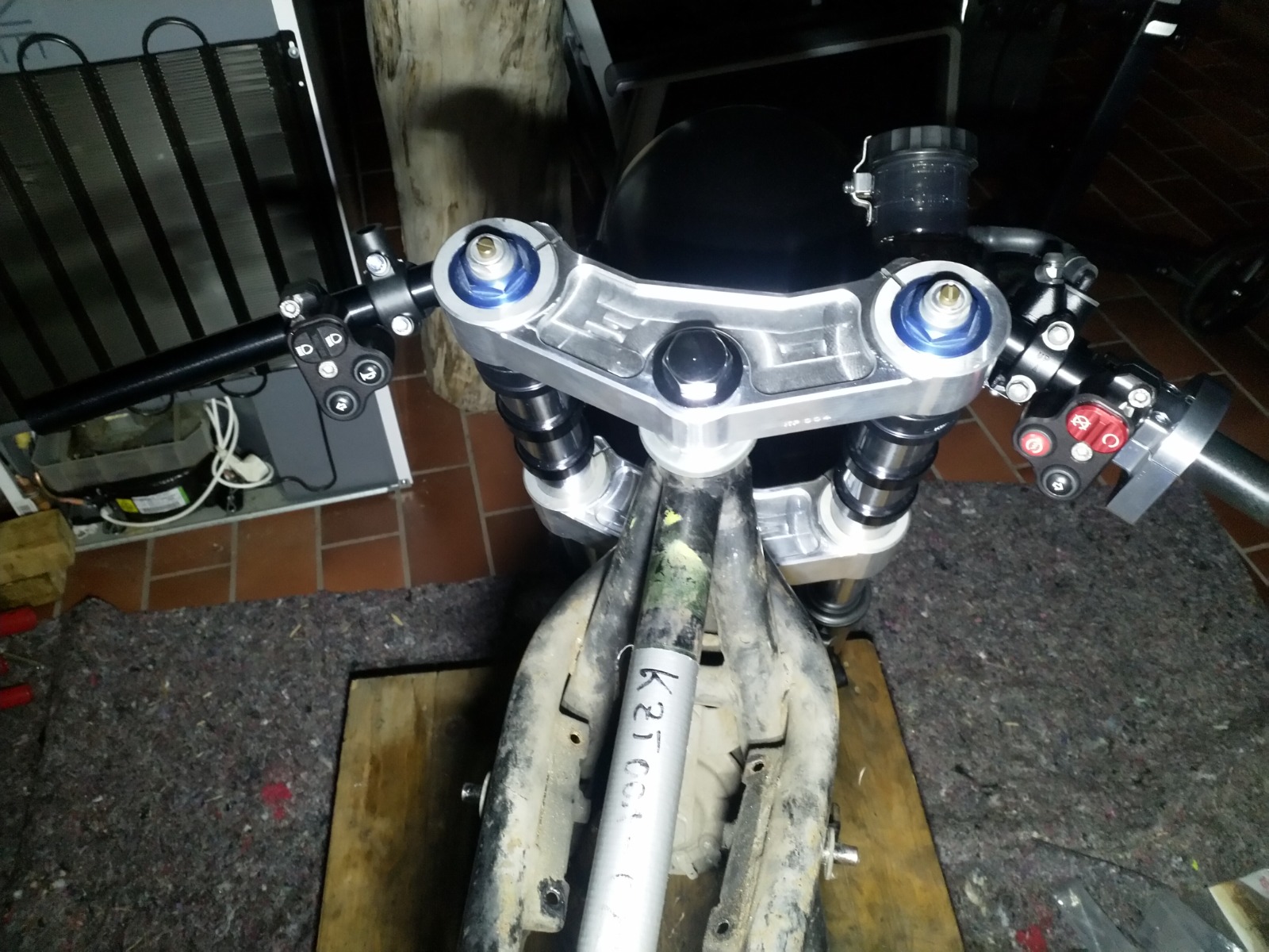

Got the levers, switch blocks and throttle on. Might be a bit tight with the cables but I should be able to get it to work. Left 12mm at the end of the bars for the mirrors (will be using motogadget blaze indicators so I can't use mirrors that go into the end of the bars). May need that 12mm though, so might get some bar extensions for the mirrors.

Those triples are badd ass! :evil:

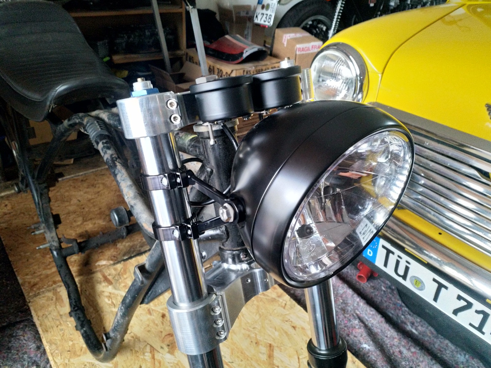

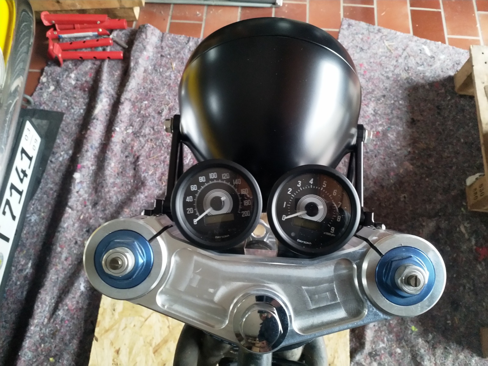

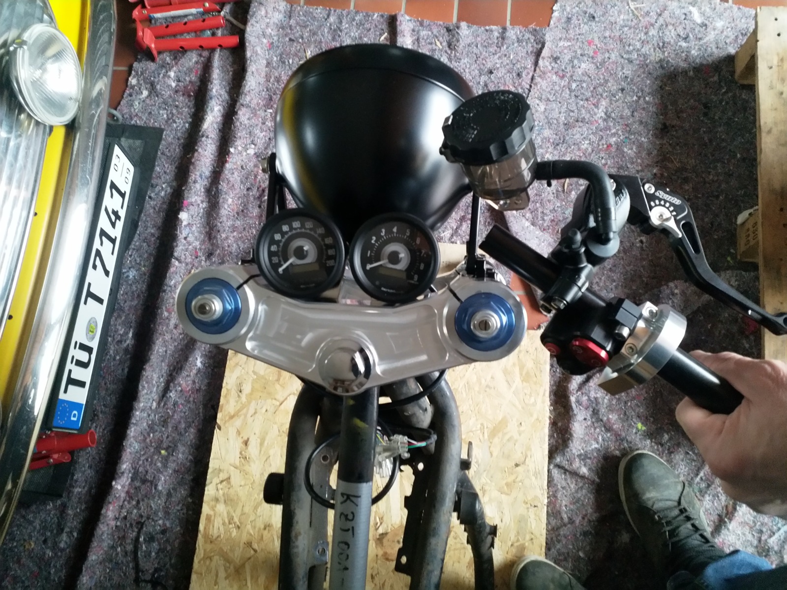

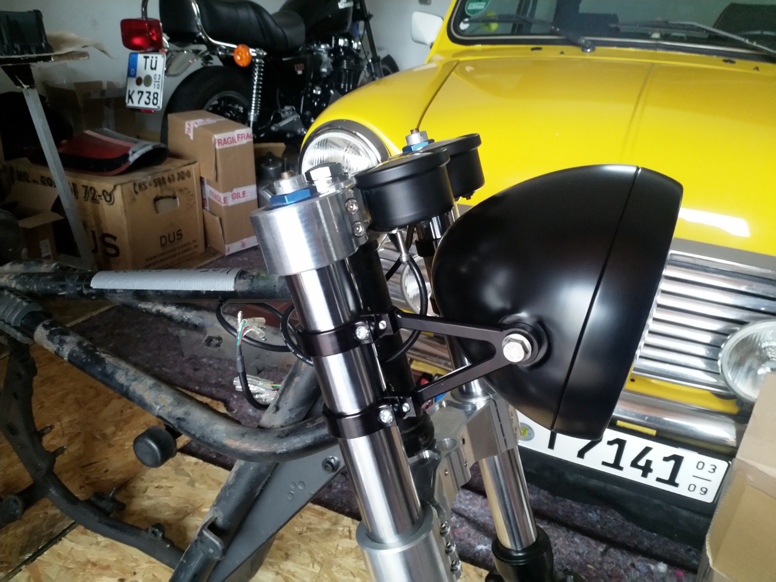

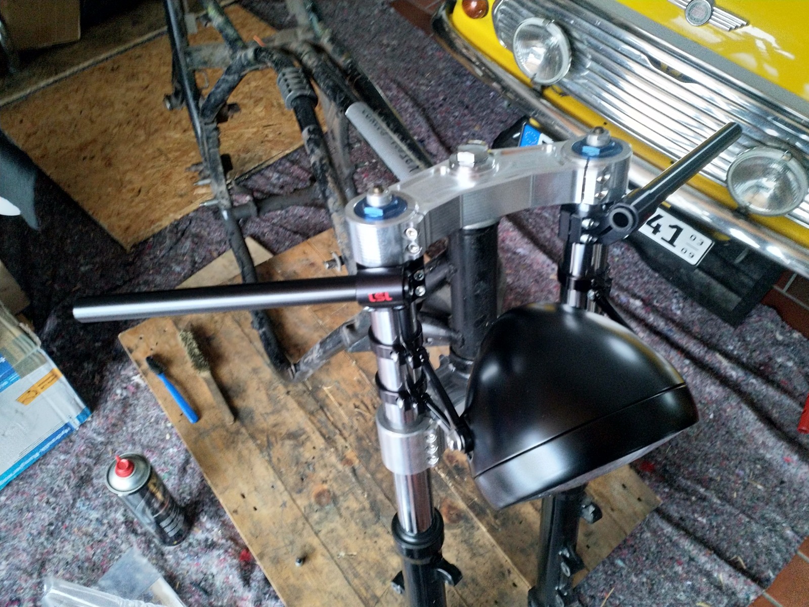

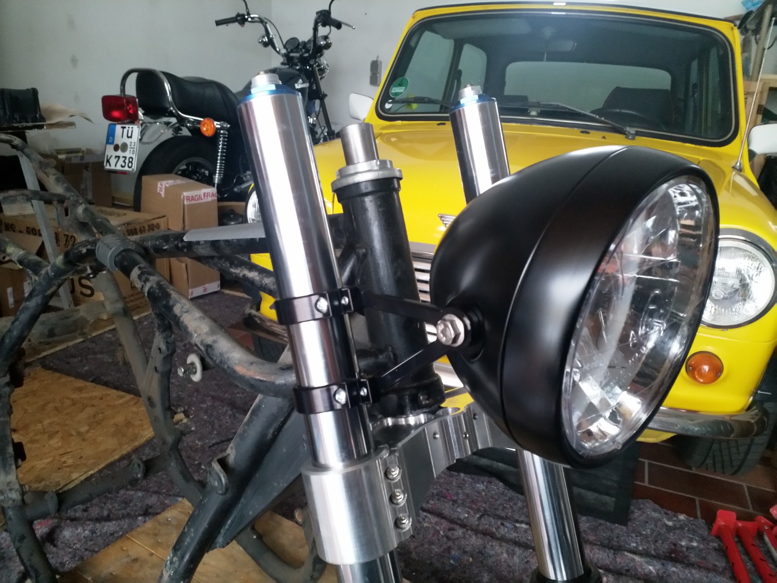

Got the clocks out today to see how they fit. Took the bars off so I can send the brackets back so there's a lot of empty space. Tried to hold one of the bars in place and take a photo but t was a bit awkward. Would appreciate any opinions - it's really a matter of taste but please chime in anyway
Not sure if I want the clocks in line with the top yoke (as in the picture) or tilted up slightly. Also not sure on the headlight, will have to see how it looks with the bars on but I think it might need to go back an inch or so.
Did some calculations and with the height and offset of the triples and the shorter forks the front end drops down 17.5mm. That's assuming rake stays at 26°. Will wait for the swingarm to get here then I can see how the back end looks. I'll be keeping the 18" wheels so losing 17.5mm at both ends should be fine.
The bars before I took them off:
The clocks - maybe need to get them a bit further out from the clamps? not sure. Just used the brackets that came with them. May mock up a couple of options next week

My take would be to have the face of them pointing directly at your face while in the rider position, to avoid any glare while riding. Having them parallel to the upper triple could allow reflection to prevent you from reading them.
