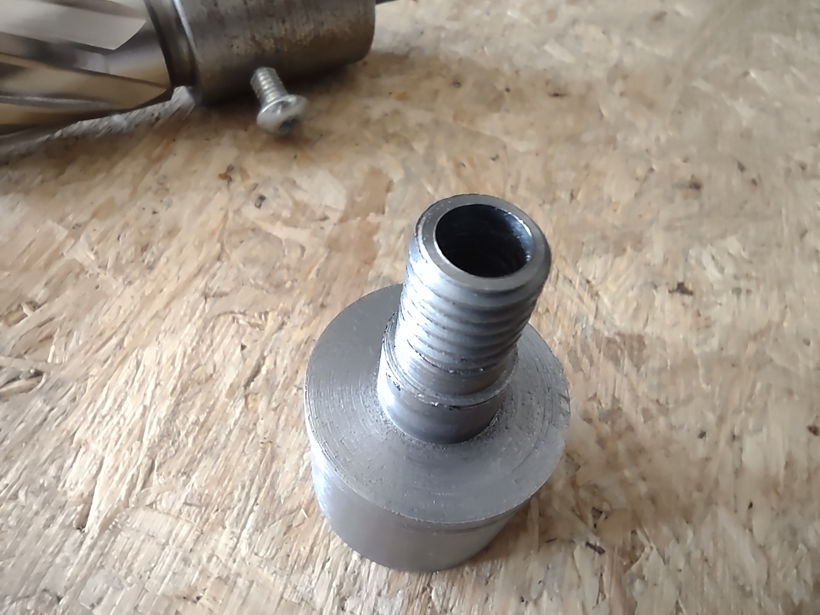

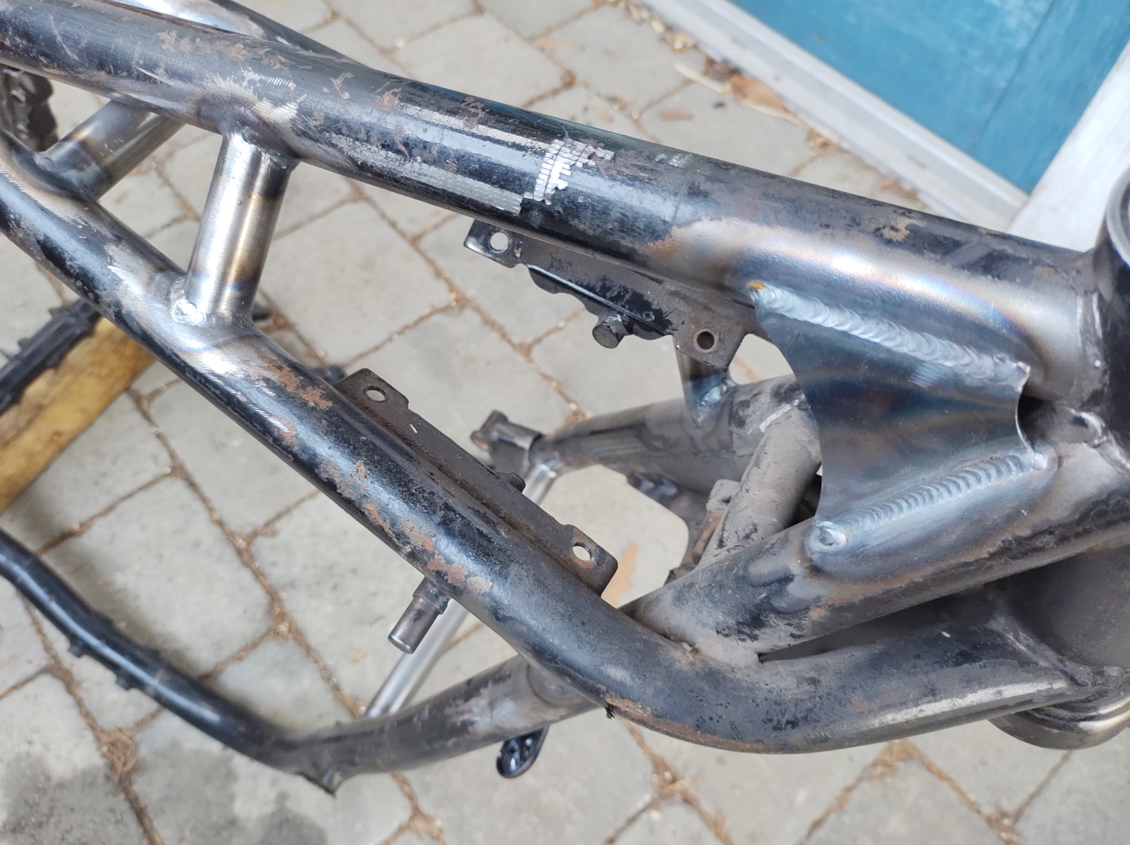

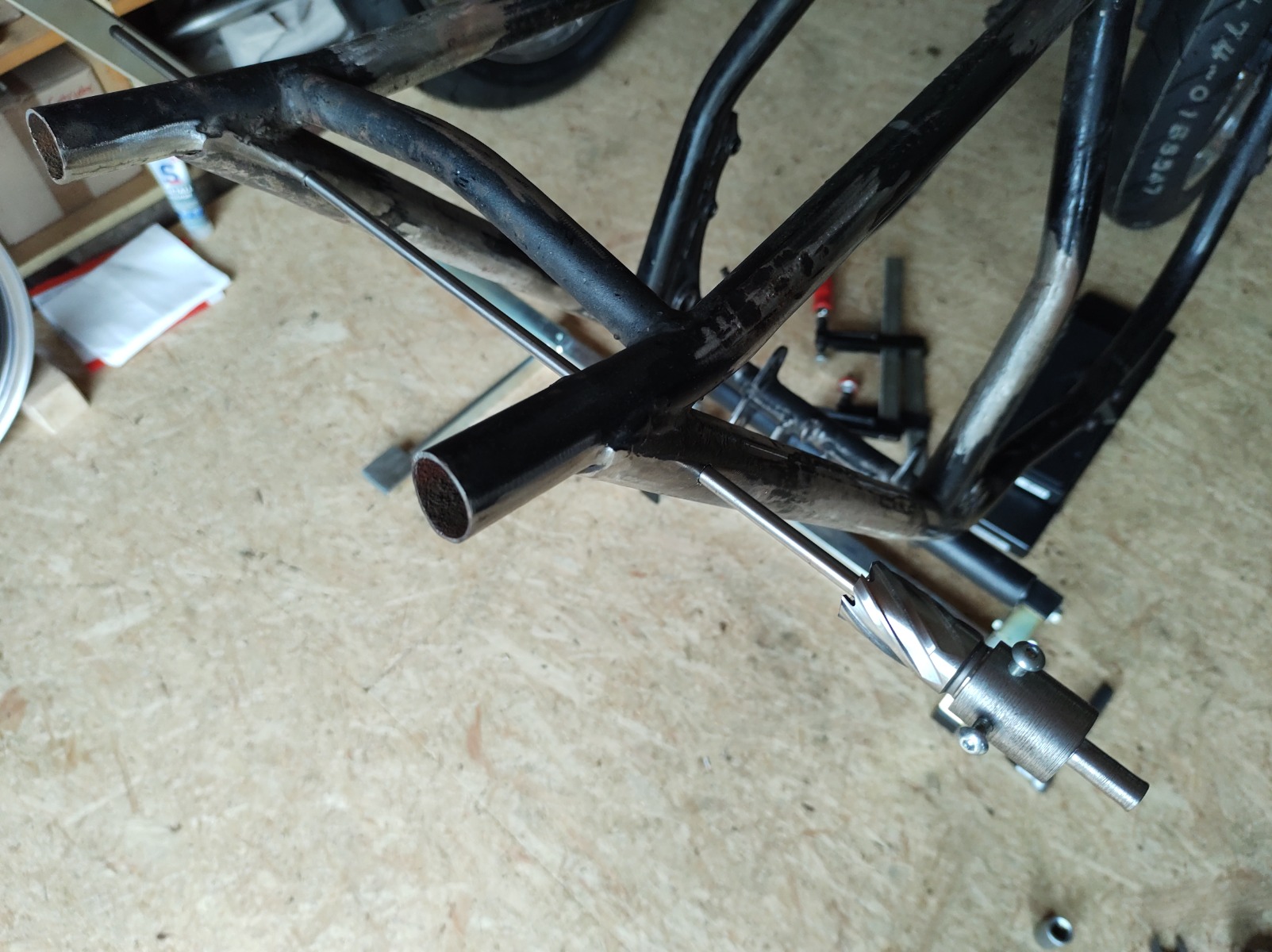

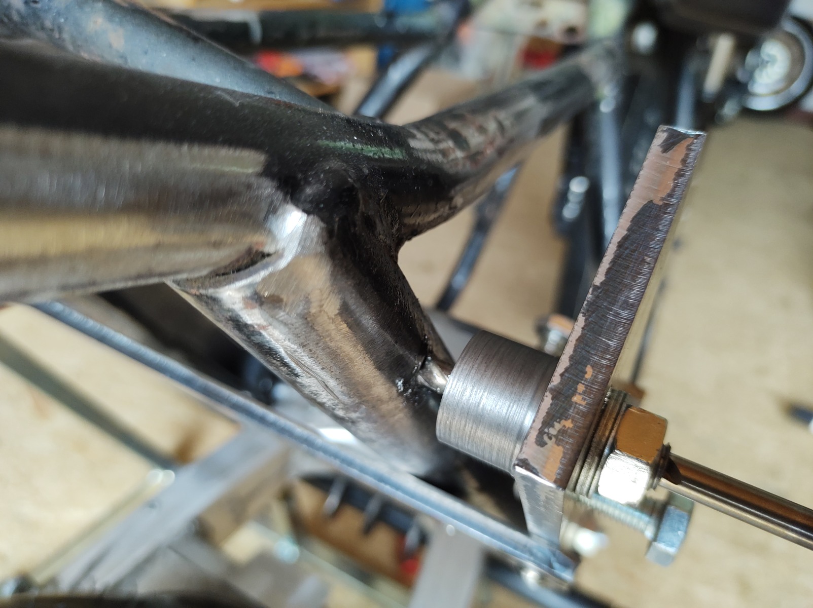

Bit more progress today. Got the holes for the rear shock mounts drilled. Will weld them up when I get back from a couple of weeks holiday
The drill guide and cutter adapter (the adapter was done on the neighbours lathe, the guide on my new one):
6.5mm pilot holes:
22mm holes for the outside of the mount. The inside holes had to be opened up to 10mm - ended up being a bit off, but a bit of work with the file and the mounts lined up square without having too big of a gap to fill on the 10mm side.

Nice work. You may be already aware of this but most swingarms are asymmetrical so if you welded the lower mounts symmetrically on the swingarm they will be offset from the frame centerline. Check the shock mount alignment top to bottom before welding them in.
- calum
- Posts: 1144
- Thanks: 415
Re: 1977 KZ1000 Restomod
17 Aug 2021 14:15Yeah, the lower left mount is about 5mm offset. I checked and if I weld the top mounts symmetrically the right hand shock will line up near to the inside of the mount and the left hand shock will line up near to the outside. I figure this is the way to go as it makes it easier to swap out the swingarm.Nice work. You may be already aware of this but most swingarms are asymmetrical so if you welded the lower mounts symmetrically on the swingarm they will be offset from the frame centerline. Check the shock mount alignment top to bottom before welding them in.

24 Sep 2021 12:10
Started tacking on the bracing and the loop, after aligning the loop I realised that the back end is slightly twisted. New plan is to get all the bracing forward of the shock mounts welded up and then get the frame straightened before I line up and weld the shock mounts. Am now waiting on word from the guys doing the MOT as to whether I can get the front welded up locally and just get them to do the shock mounts. If not I'll just be doing a couple of extra trips through the black forest.

12 Oct 2021 21:38 - 13 Oct 2021 02:22
Got the front of the frame welded up last week (edit: got it done by a local welder) and took it to the guy to get straightened. Hoping I can pick it up next week and get the shock mounts tacked on, then I can do another mock-up and figure out where the exhaust mounts need to go.

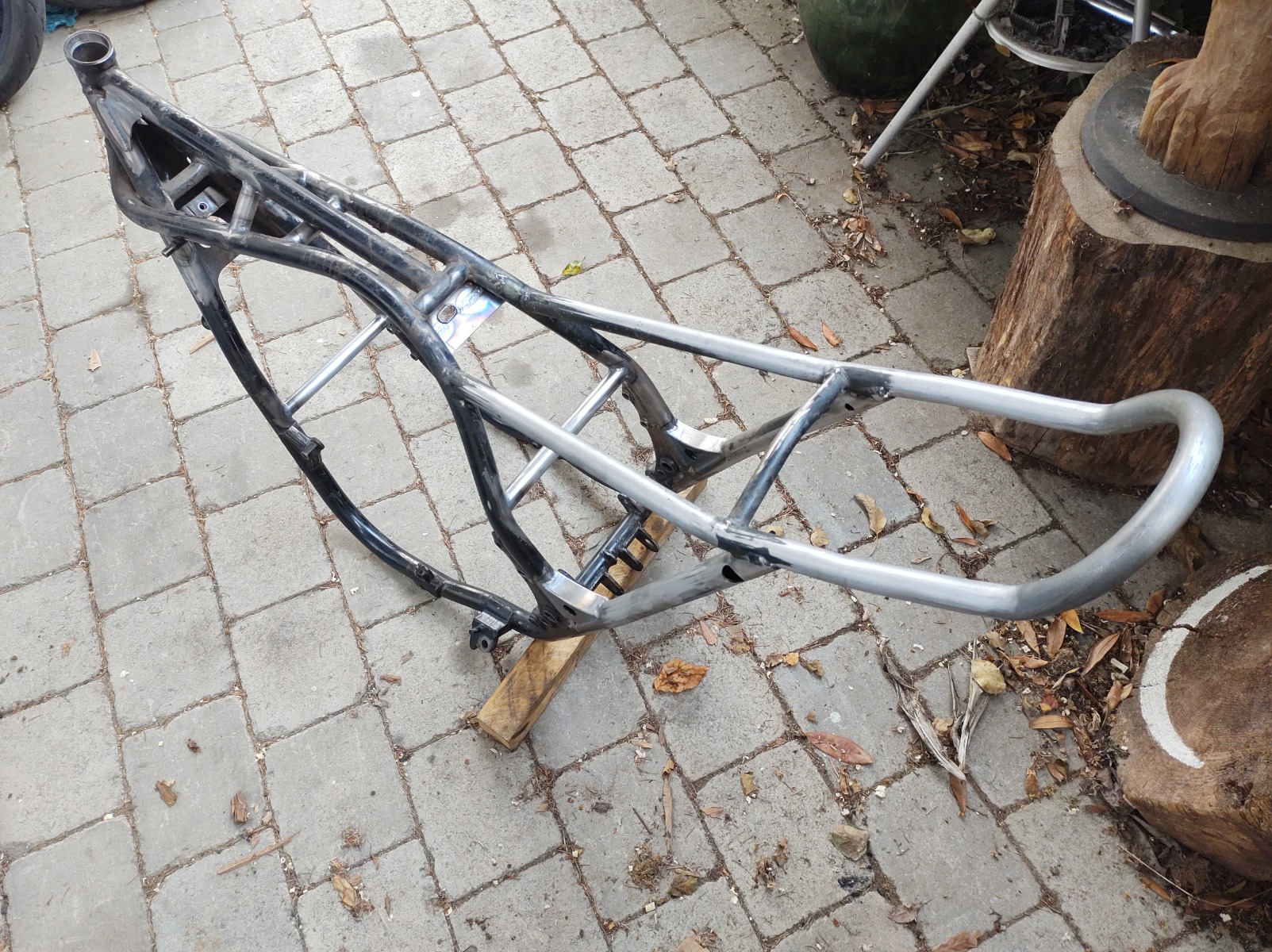

30 Oct 2021 14:16 - 30 Oct 2021 14:21
Got the frame back. Straightened up and the head bearing surfaces were redone. Threw some parts on today so I can see where the rest of the brackets need to go. Exhaust is mounted as low as it will go in the photos. Will probably lift it up a bit so it's parallel to the frame (you can just twist the muffler at the mounting point to change the angle).
