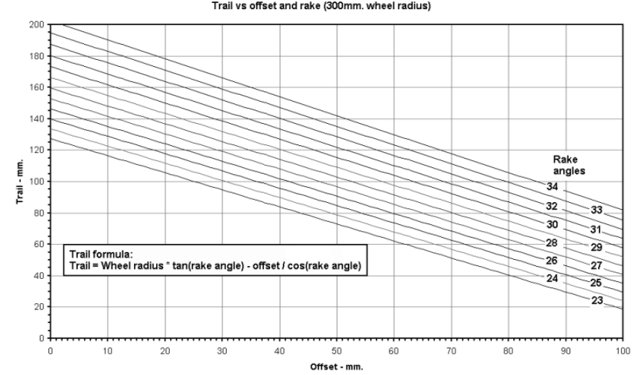

04 May 2021 10:13 - 04 May 2021 10:16You only need three values to calculate trail, and you are correct that the sum of the values is more important than any one value on its own. However, trail is the summation of the 3 other values you listed and is a good indicator of the general geometry which is why it is listed in manuals rather than tire diameter and offset. The main reason the rake and offset are changing when moving to a different wheel size is to get the trail number back to the magic number of around 100mm.The excerpt I posted is for Sanctuary's street bikes with 18 inch wheels, it says so in the excerpt, the pic was meant as a guide or reference, they would adjust that according to the track, I should have stated that. 97 mm is pretty good for trail using the measurements mentioned, if that's the case, I haven't run them through my calculator, I'd want exact measurements for that, or at least a full set of numbers. The old Honda fours only had 94mm of trail and weren't known to be "twitchy, the Triumph triple i got my forks off had even less, Rake, 22.9°, trail 91.44 mm (3.600 in). Its not only trail that bike nervous, its the combination of all four, rake , trail, wheel diameter and offset... The ZRX numbers are for 17 inch wheels, Calum is using 18's which require slightly more rake than a bike using 17's, around 1 degree. I absolutely agree with the fork length, Calum needs to factor in the differences, that shouldn't be too hard.

Since we are looking at bikes with low trail values look no further than the KZ1000A that had 26 degree rake and 90mm trail - not uncommon to hear of high speed instability.
All that being said its just semantics at this point, and we're basically in agreement here. We can bench race all day long. at the end of the day you gotta build it and get out there and test. This is why so many race bikes have adjustable geometry - rake, offset, rear axle height, swingarm length, and swingarm pivot, etc..

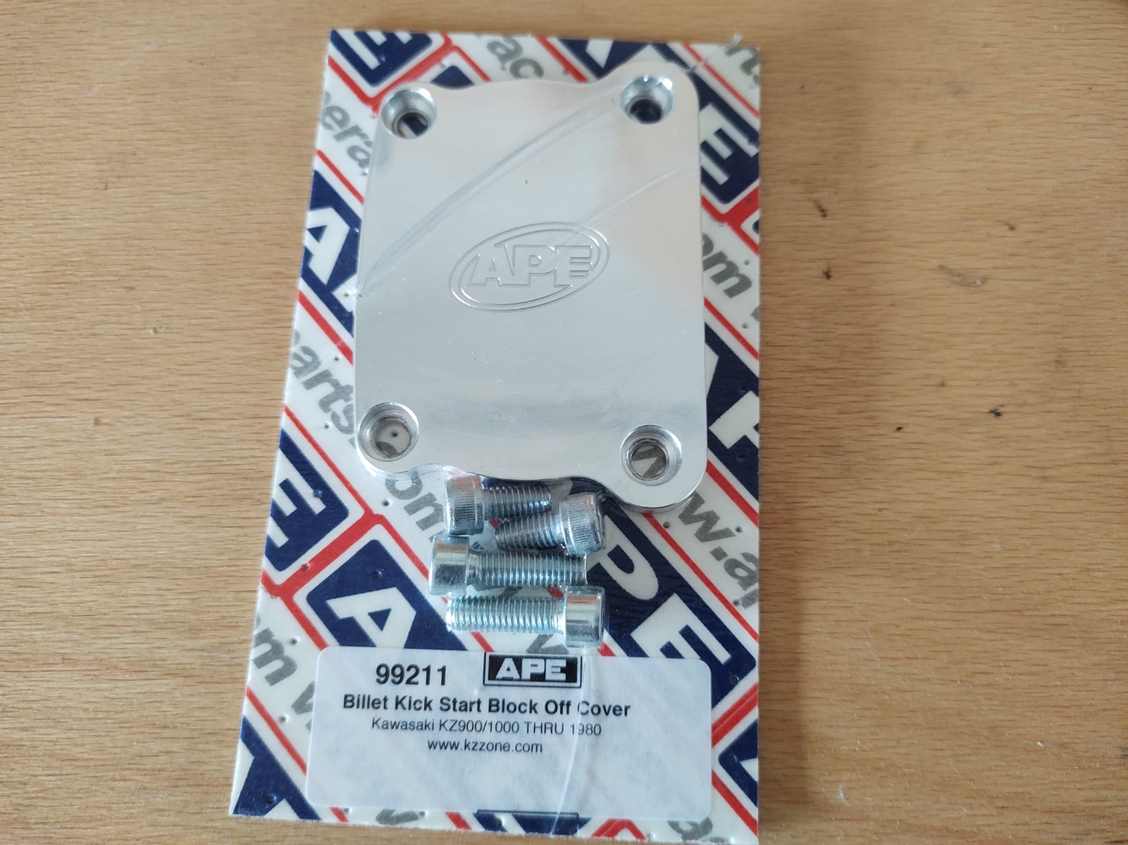

Slow progress over the last while. Between the Zephyr, finally getting away for a short holiday and getting back to normal working hours (plus a few extra), I haven't had much time at all.

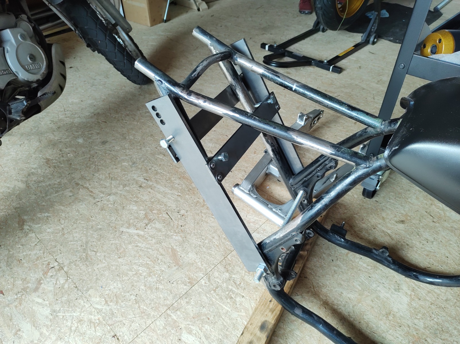

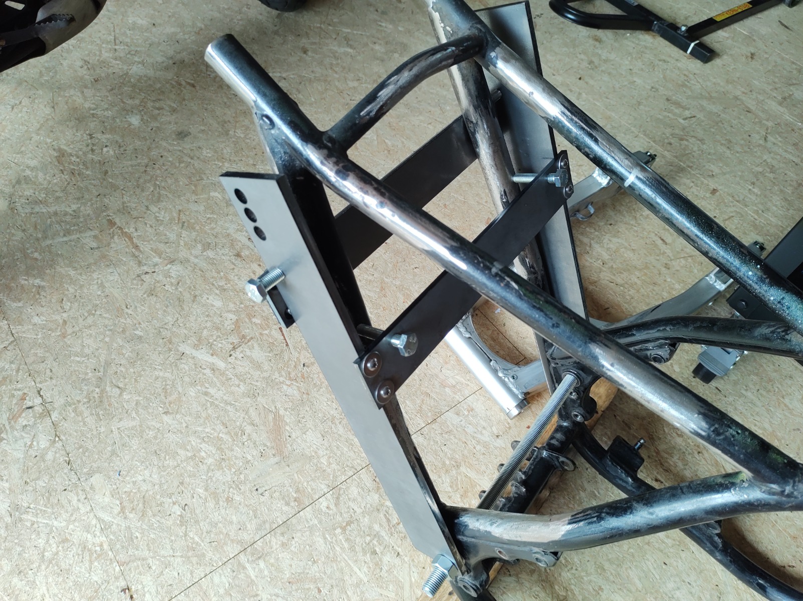

Got the jig for the shock mounts sorted. Waiting for the triples to get back so I can see which of the three holes to use for the shocks - probably be the middle one. Then I just need to spend some time on the lathe to make a drill guide and an adapter for the cutter.

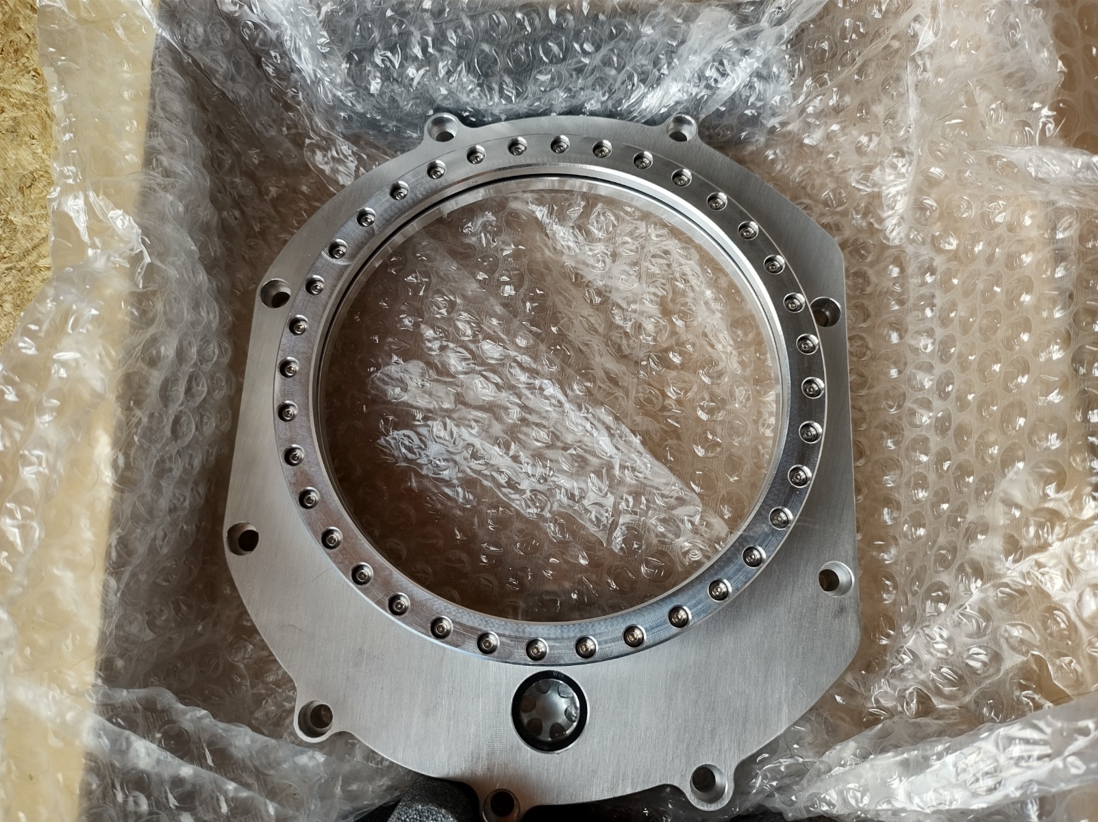

I have also been collecting some other parts. Not sure about the clutch cover - may be a touch too "boy racer"...

Nice, I'm about to make a shock mount jig of my own , very similar to yours....

That clutch cover is cool! Where'd you get it?
