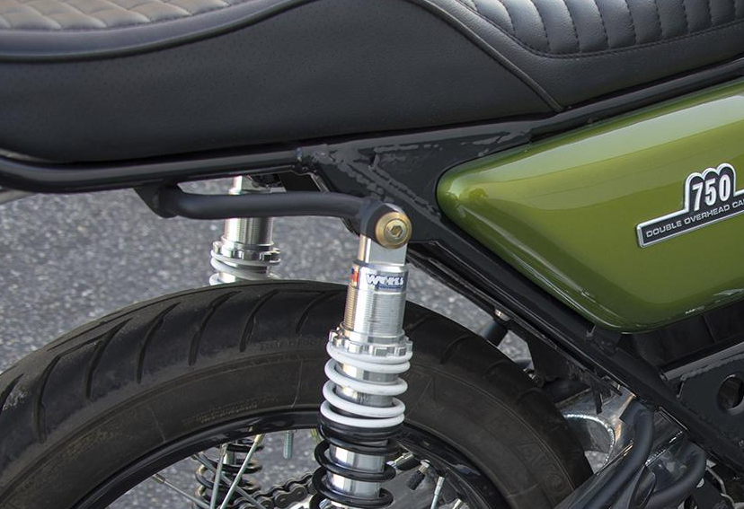

31 Mar 2021 16:39Maybe Accurate would have been a better description, did your "jig" incorporate the angled rear Frame down tubes across the frame? Your solution gives you the position but it still needs to be drilled dead straight across the frame... Does that make sense, Its hard to explain through typing....{maybe I'm getting to old !}You don't need a complicated jig to relocate the upper shock mounts but they are nice if you do this frequently. I made this crude jig to locate the upper shock mounts when i relocated them on my 750G. Triangulate the upper mount off the pivot and the lower shock mount. When I machined the mounts I had a 1/4" pilot hole pass all the way through so I could pass through some 1/4" rod side-to-side to make sure the mounts were on the same axis. Their location is just as exact as the stock mounts, if not more so.

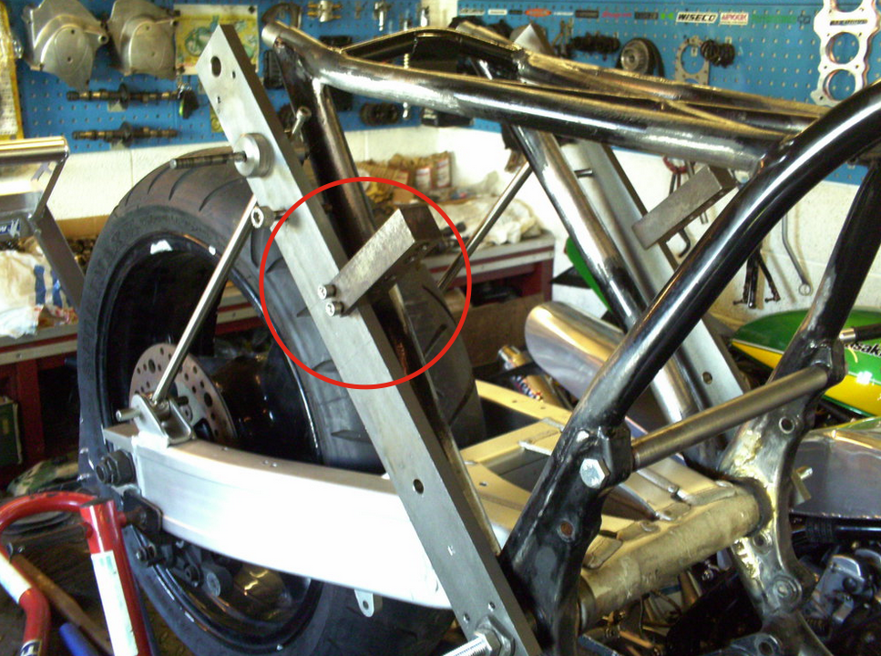

This is the jig i made for shock mount location.
Adjustable for stock or custom positions, different swingarms, width etc and has drill guide and location pin attachments .
Also good for checking the stock shock mount positions which are hardly ever exact.
The following user(s) said Thank You: 750 R1, calum

nice work there Zed. Looks like I made a hillbilly version of that. What is this part of the jig used for?

03 Apr 2021 17:12Those are just some universal movable mounting points ( steel blocks with several threaded holes that can be placed anywhere on the bar ) for setting the shock width, keeping the bars parallel with the aid of an adjustable cross brace or fixing the swingarm height with the addition of some brackets to a point on the frame etc..DoctoRot post=845914nice work there Zed. Looks like I made a hillbilly version of that. What is this part of the jig used for?
