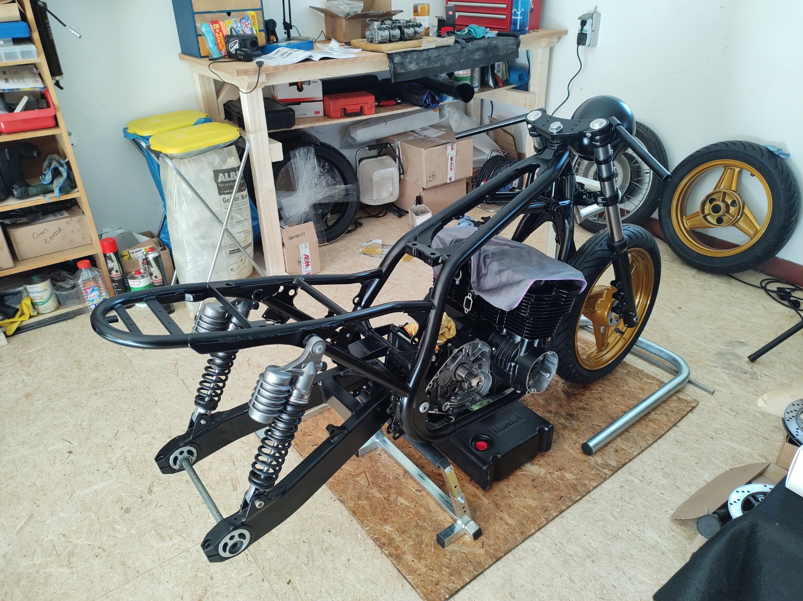

Took some measurments today.
The GSX-R swingarm has the same spacing from the pivot bolt to the lower shock mounts as the stock swingarm. The axle is 30mm further down and 55mm further back with respect to the bottom shock mount. The new shocks are 20mm longer.
I'll wait until the rims get here but the plan at the moment is to move the top shock mounts to the same location as the Z1000J. After that I'll see if I need to drop the top yoke down or not.
Put a few things together today so I can see how the riding position is when the footrests get here. Would be interested in opinions on whether I should go with scantily clad or fully naked:

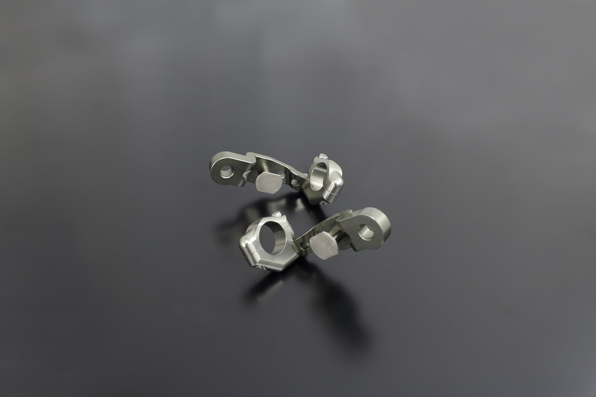

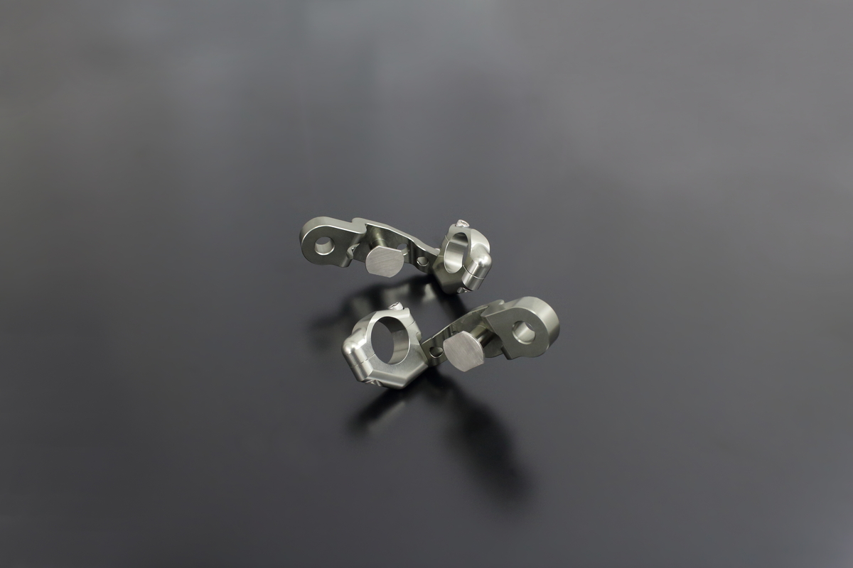

Re: 1977 KZ1000 Restomod
30 Mar 2021 15:34These shock brackets give you the top shock mounts location you need...I'll wait until the rims get here but the plan at the moment is to move the top shock mounts to the same location as the Z1000J. After that I'll see if I need to drop the top yoke down or not.

Thanks, but it looks like they would just adjust the angle of the shocks without actually reducing swingarm angle. I'll have another look when the wheels are on.
