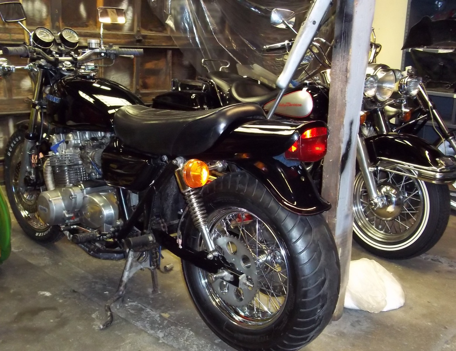

Smaller bike? I assume your using 530 chain?
Look around for a Harley Wheel & Hub, Simple 5 bolt for sprockets and rotors.
You seem to have the mechanical fortitude to do what you have so far with front end.
I did similar 8-9? yrs ago. I scored a complete with tire for $100. I had HD sprockets and 10" flat discs.
Some Guy bought it so quick when he seen it. I did not even finish the back fender and tail.
The HD's use .750" axles.
I did a ZZX 600 once? Welded on for struts Easy conversion for the swing arm. This was mock up in my city house / warehouse before I sold it.
Find a machinist friend with a Lathe and old Bridgeport mill.
