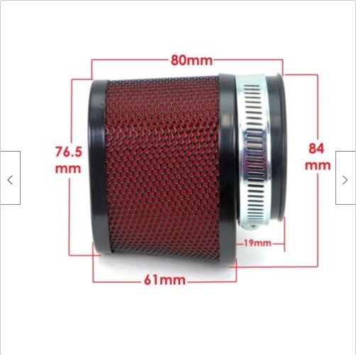

Thanks for the info!!! I assume that I have the later style? Lucky me I have to return them anyway, as they sent the wrong ones. I originally purchased a set of larger, more ovular filters, so it might solve that issue (pic attatched). If not, do you think it would work to carefully cut a chunk out of the rubber seal, and maybe a bit of foam (not enough to render the filter useless, of course), that obstructs the vacuum passage? Maybe I could even flip them over? The only reason I'm trying to stick with them for now is because I heard someone mention that foamies work MUCH better with cv carbs that pleated filters. Something about how the pleated filters cause intense vacuum fluctuations.

It looks like the oval filters have the same flange design as what you have. Cutting into the filter will likely negate the filter, that doesn't seem like a good solution. filter quality has as much to do with the boot design as the filter material. You want the smoothest transition from the boot to the intake as possible, no steps and, under no circumstances, any obstruction of the ports. Many K&N filters have a short venturi built into them which definitely gives them an edge in my book. The only foam filter I have heard good things about is Uni filter but I have never used them, Most people I know who like them are dirt bike riders because apparently they are very easy to clean and oil.
IMHO there are some places where you can cut corners on price. pod filters is not one of them. If you are trying to get this thing going on a budget i would get a stock paper filter and stick with the airbox. Also I would think twice about drilling out jets. I think you are setting yourself up for major carbueration headaches.

Thanks for the words of advice DoctoRot! You're making me nervous about this whole pod filter thing, but ebay wouldn't let me return them even though I received the wrong item (only exchange), so I think I'll give them a try. I have an idea on how I could modify the boots. But I bet I'll give up after a while and build a custom airbox... I just hate the look of the stock one. Also, in regards to drilling the jets, I have an entire spare set, or else I wouldn't try it. The goal isn't to use them permanently, but instead to get an estimate of what sizes I'll need before spending $5 a pop.

It'll be easier if you use the stock airbox at first just so you're not chasing pod issues when its actually something else.
Also, if you do use cheap pods, just cut out the flange with an xacto knife. typically this does not mean cutting into the filter material... maybe some of the glue, but they still work fine. i would also recommend the foam style pods and not the pleated see through "filters"

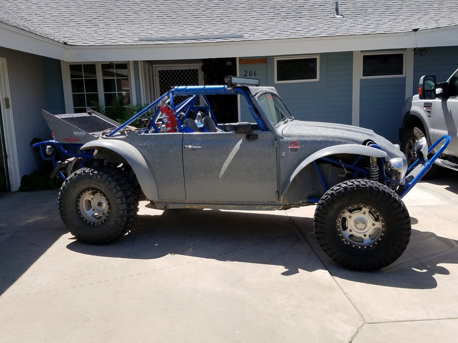

Simple... Use those teeny-tiny jewelers drill bits with a hand chuck. And be super careful. :laugh: They come in more sizes than there are jets! I've drilled some for a vw based dune buggy I have, and it turned out alright. I get that these are different waters, but we'll see how it goes! And why the heck not try it if I have a handful of spare (incorrect size) jets?
