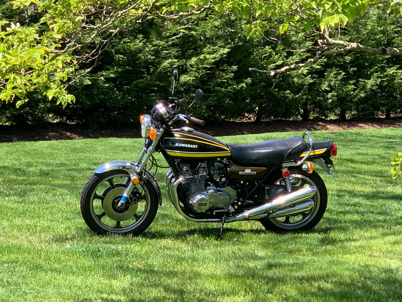

10 Jul 2020 17:01Before and after, just cleaned and assembled from various across the product line in those years, and a lot of info gathered from threads posted here, thanks, front end from different 750's, wanted dual brakes, rebuilt calipers and mc, replaced wiring harness, old was toast, pair of old Z1 bars , old were bent, and a pair of old Z1 mirrors, for now, had them, headlight is a Stanley 1970 model for h4 lamp h4 led works well, moved blinkers off bars, switched headlight and running lights, (used a repo Z1 unit easy to do), tank is from a 750, (needed a really short 44mm petcock), paint is spray cans, found a seat on ebay, rear wheel is from a 550, (thanks martin csr), carbs from a 78 rebuilt and working well, all epa stuff gone, new brakes and pads, chain and sprockets, new tires as the ones that came with the wheels were really old, Dunlop d404s, were reasonable, Delkevic pipe was most reasonable for that , just having some fun with this, and after looking at the other projects going on this is nothing, time for a can of patience( comes in 6 or 12 packs) it hot out, thanks

a follow up as I don't log in very often, not into social networking, original pipes, bs32's from an 82, all thanks to Marty in Buffalo, on of his kaw pasture fire sales, never took time to thank him, still gotta send a six pack to the other side of the state, and badges that just materialized!! runs real well, put about 1000 mile on it, no issues, would have more but when you have a 900 and a 650, what would you ride the most? 900 wins
