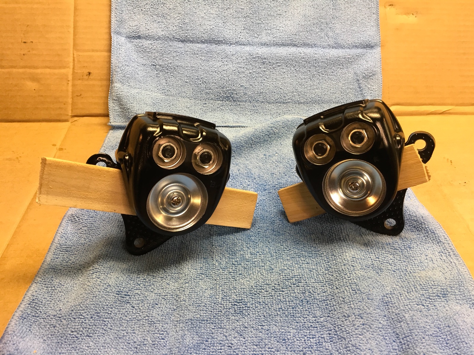

Calipers built. Maybe a little shinnyer then should be I cheated some and dressed them up for the photo shoot with a little lemon pledge. :laugh: :whistle:

They look nice! Are they powder coated?
- Thanks: 1851
Re: 1976 Kz 900 A4
31 Dec 2020 21:16
Thank you HRM. No they are VHT Caliper paint that has cured several months. Mounting brackets are Powder coated.
- Posts: 3111
- Thanks: 1227
Re: 1976 Kz 900 A4
01 Jan 2021 05:16
I had my Z1B ones powder coated, but a purist would frown. So far so good...no chips or flakes.

01 Jan 2021 08:56hardrockminer wrote: I had my Z1B ones powder coated, but a purist would frown. So far so good...no chips or flakes.
Your Z’s are different. But your ‘80 should have the same bracket that mounts the caliper and aslo retains pad A. Well I messed up when shipping to powder coat and the ID of the hole for the pad got coated. It reduced the clearance and the pad would not fit. I found out how tough that powder coating is trying to remove it. So I don’t think you going to get any chipping.

01 Jan 2021 09:15
Yes, the calipers are different but I didn't realize the mounts were different.
Same thing happened with mine....had to use a grinder to open the hole back out again..

01 Jan 2021 09:22hardrockminer wrote: Yes, the calipers are different but I didn't realize the mounts were different.
I stand corrected, thank you. I just looked through the Z manual, they do have a similar configuration with the bracket retaining pad A.

OUCH Matt! Powdercoat is tough!!!, nothing a 1/4" air grinder and some barrel sand rolls at 20,000 rpm's can't handle!
