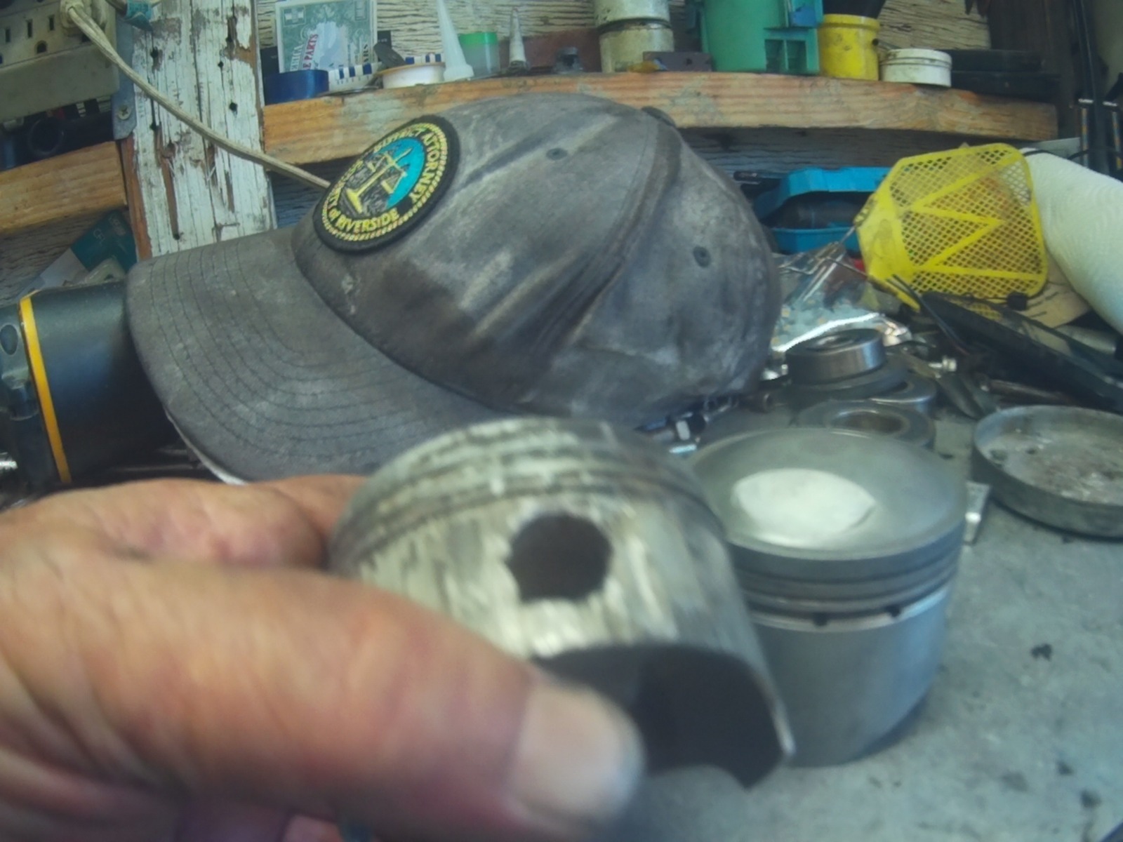

I put up pics of the pistons in my swing arm thread.

Thank you Steve, to help keep you post on topic I’ll post mine here. Pistons 1,2,3 look like this.
#4 is the alleged damaged piston

Thanks. As long as the circlip isn't effected I don't think it's a problem.
These are the pics I posted in mine.
I'll delete my last comment in my thread.

I'd use them.

Just clean 'em up a little bit and run 'em!

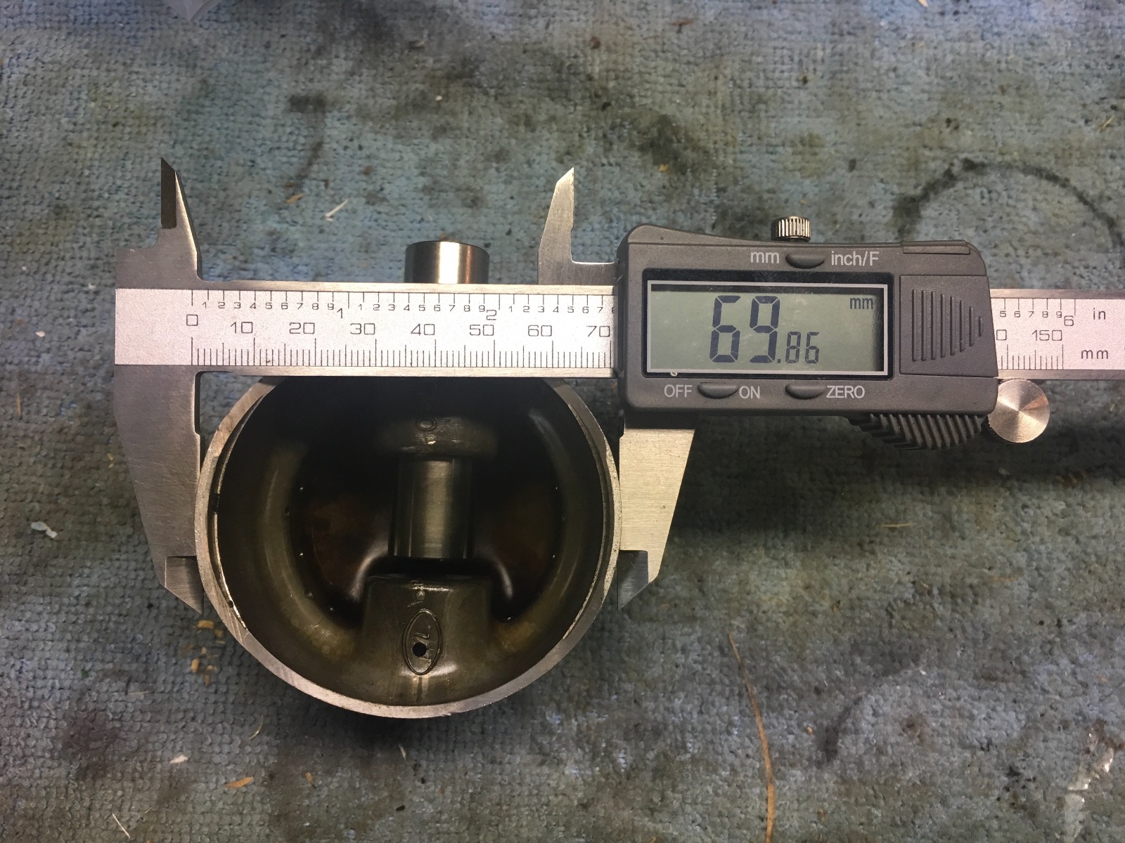

I just spoke with Wiseco. Tom, gave me specs for the piston. If I mic it out and determine its the piston we think it is (older P series)Tom says I could buy one new current piston 4020MO7000 and run it with the other 3 older P series. If anyone needs the measurements pm and I’ll reply.

The new ones are a lot lighter than the old style. I didn't do it for that reason.
Re: 1976 Kz 900 A4
02 Oct 2020 10:42
Didn’t consider weight. Thanks
