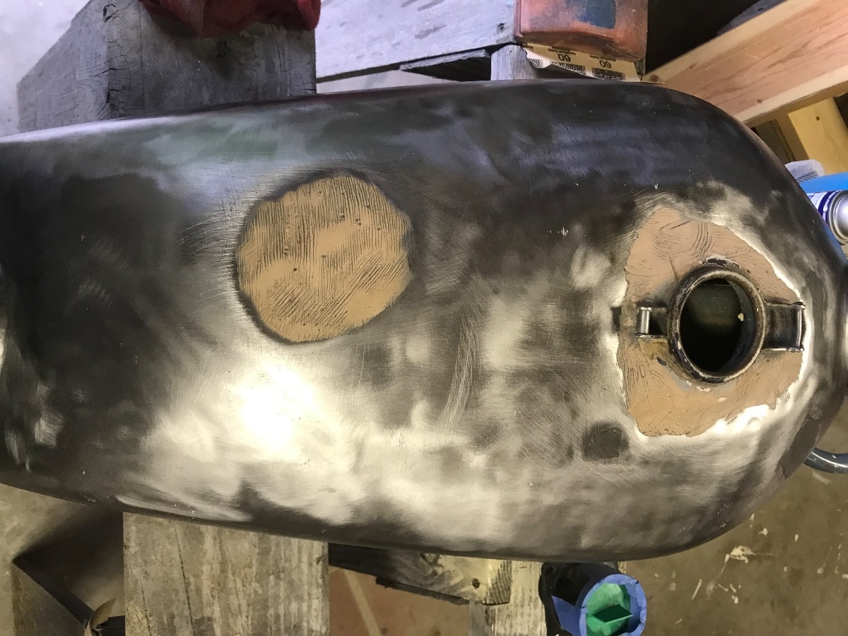

Used a wire wheel and took all the previous paint and rust off from the outside. Found a few bondo spots hidden from the previous owner.

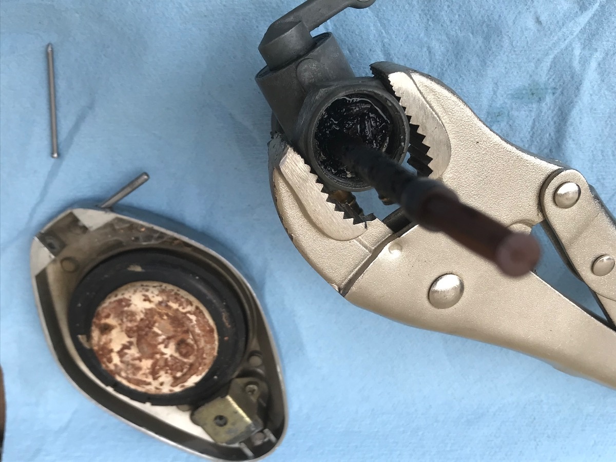

From the looks of the gas cap and petcock I have my work cut out. The petcock intake stem is corroded and cracked and I cannot get any air flow through it in any position. Might have to replace the whole unit.

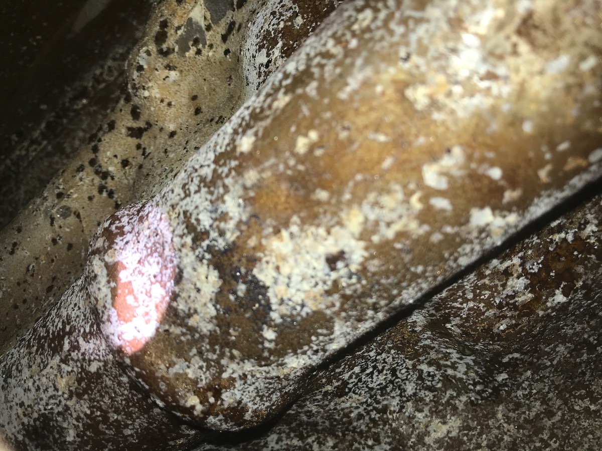

Will start tackling the inside of the tank soon. Aiming to remove the previous tank liner pieces, and get as much of the rust out as possible. Once cleaned up I plan to add Red Kote for future rust prevention.
