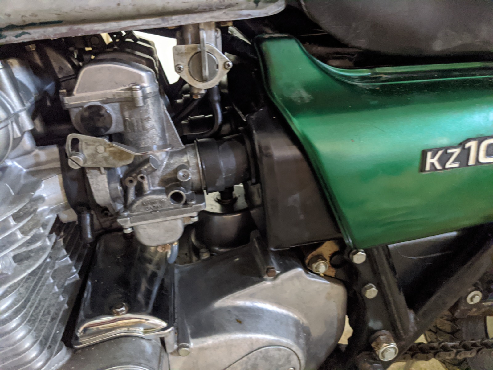

Unsexy update.
Got the fuel cap back on the fuel tank for now, now that I have a new gas cap gasket.
Also installed the airbox with the new hoses. Reinstalling a carburator with the stock airbox will make you rethink every life decision you've ever made. I left the clamps off for now. Dreading how many times I'm going to be removing and reinstalling that carb by the time I'm done.

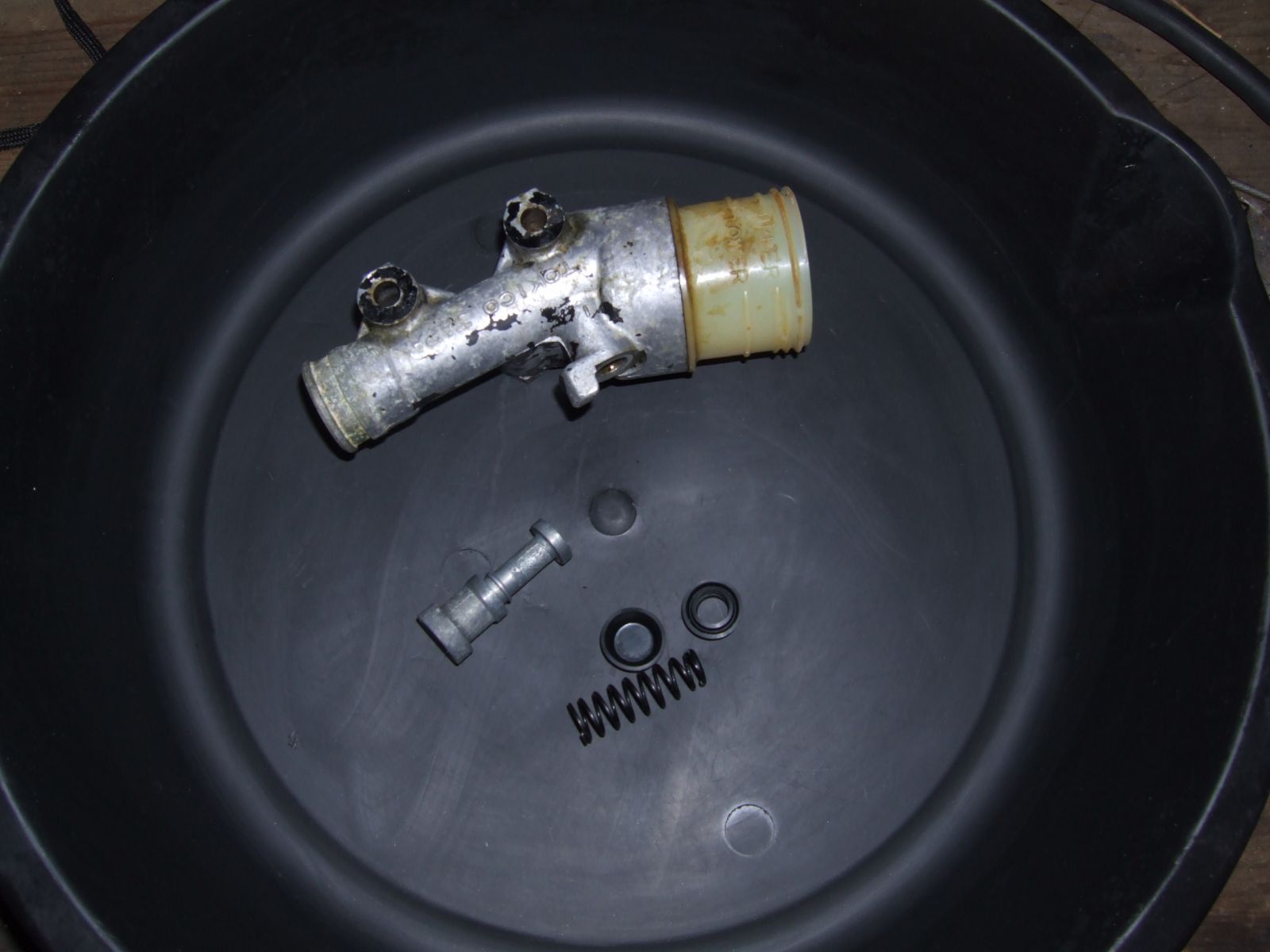

Also started tearing into the rear master cylinder as the rebuild kit also showed up. However, the old piston is seized inside the cylinder. Has anybody ever dealt with this problem before? For now, I've just set it upside down and loaded the piston with liquid wrench, hoping it will come out when I get back to the shop on Saturday.

Great progress. As for the MC, soaking it is you best option. Take the cap and brake line off and get your penetrating oil in every hole you can. Try heating cycles, only propane, not cutting torches. You can also strike the piston sharply, only trying to break the corrosion and not trying to push it deeper. Remember to remover the internal c-clip in the bottom before trying to remove the piston. I’ve rebuilt a few that were really stuck... patients is your friend. Once it does move it will come out. Just need the first move to break the corrosion bond.

Instead of using compressed air to remove the brake cylinder try using a grease nipple and a grease gun. Far less explosive.

I had tried heat cycles and striking the piston to loosen the corrosion without any luck. After coming home for dinner, posting my last update, and searching these forums, I ended up going back to the shop. I’m the kind of person who needs to do something or I’ll lay awake all night thinking about it.
I tried the compressed air trick without luck. BUT, I have a rebuild kit with a new piston, so I ended up getting the old one out with a threaded tap. YAY! The primary cup in my rebuild kit looks a little different than the one that was in there, so I opted to re-use the original.

A little tricked that I found on a search here was to roll the air ducts from the air box to the carbs over on themselves before installing the carb rack. This gives you much more room for wiggling the carb rack in place. Then use a hair dryer or heat gun to warm up the air ducts and unfold them while they are warm, one at a time and they almost naturally go right over the intake on the carb. It's another one of those "Why didn't I think of that ideas?" One more thing, warm the air ducts up a bit before trying to roll them over. It works much easier doing that first than doing it with cold ducts.

Well I'll be darned. I'm sure the wife is going to be upset when her hairdryer suddenly goes missing.

Pretty slick idea. Drilling and threading the piston and pulling it out.

Hopefully this isn’t coming to late but before you assemble the rear MC you need to run a 5/8 ball hone in the bore to break the glaze and give the seals a way to seat. I’ve had good luck with a 320 grit.
