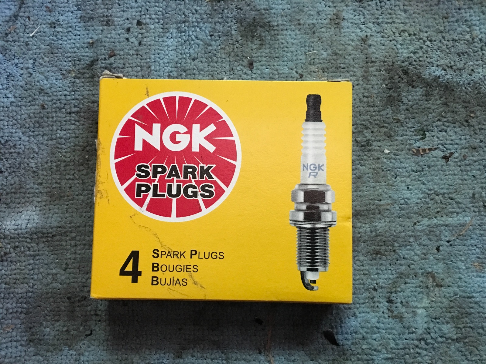

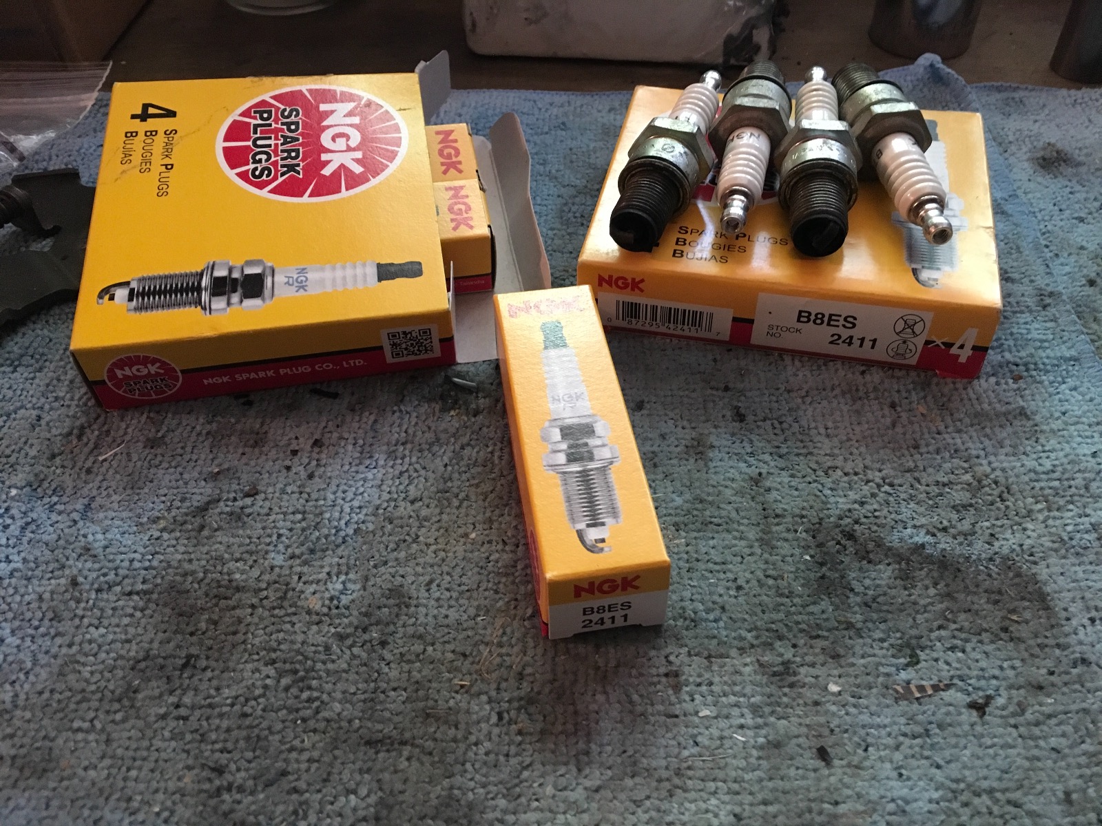

No eBay APP ID and/or Cert ID defined in Kunena configurationThank you for your generous offer Mikaw, but I managed to track some down online. Amazon wanted $55 +$24 shipping for 4! Found a 10 pack on eBay for $40 with free shipping. They’re coming straight from China so may take a while to get here. Hopefully they’re the real deal.

Be careful, a lot of bike and car spare parts made or sold in China are cheap and dangerous clones of the original brands!!!

Scirocco is right, those are fakes. NGK are not produced in china. Caveat Emptor.

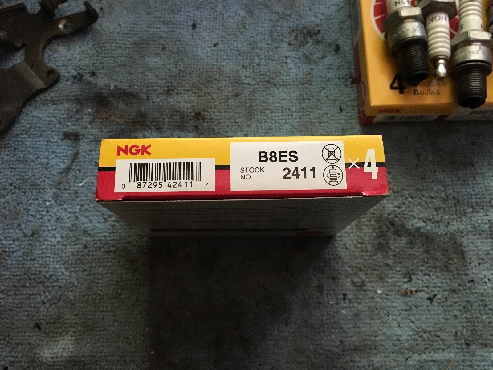

I’m not a NGK fraud detective but those you posted don’t seem to be correct... I’d say regardless of the item count which might change the package design, I’d have to believe the individual packaging would be consistent. I don’t find any Chinese writing on the individual boxes. And the plug rendering on the package is different

As to the question of counterfeit NGK's, NGK has a page dedicated to ID-ing counterfeits.
