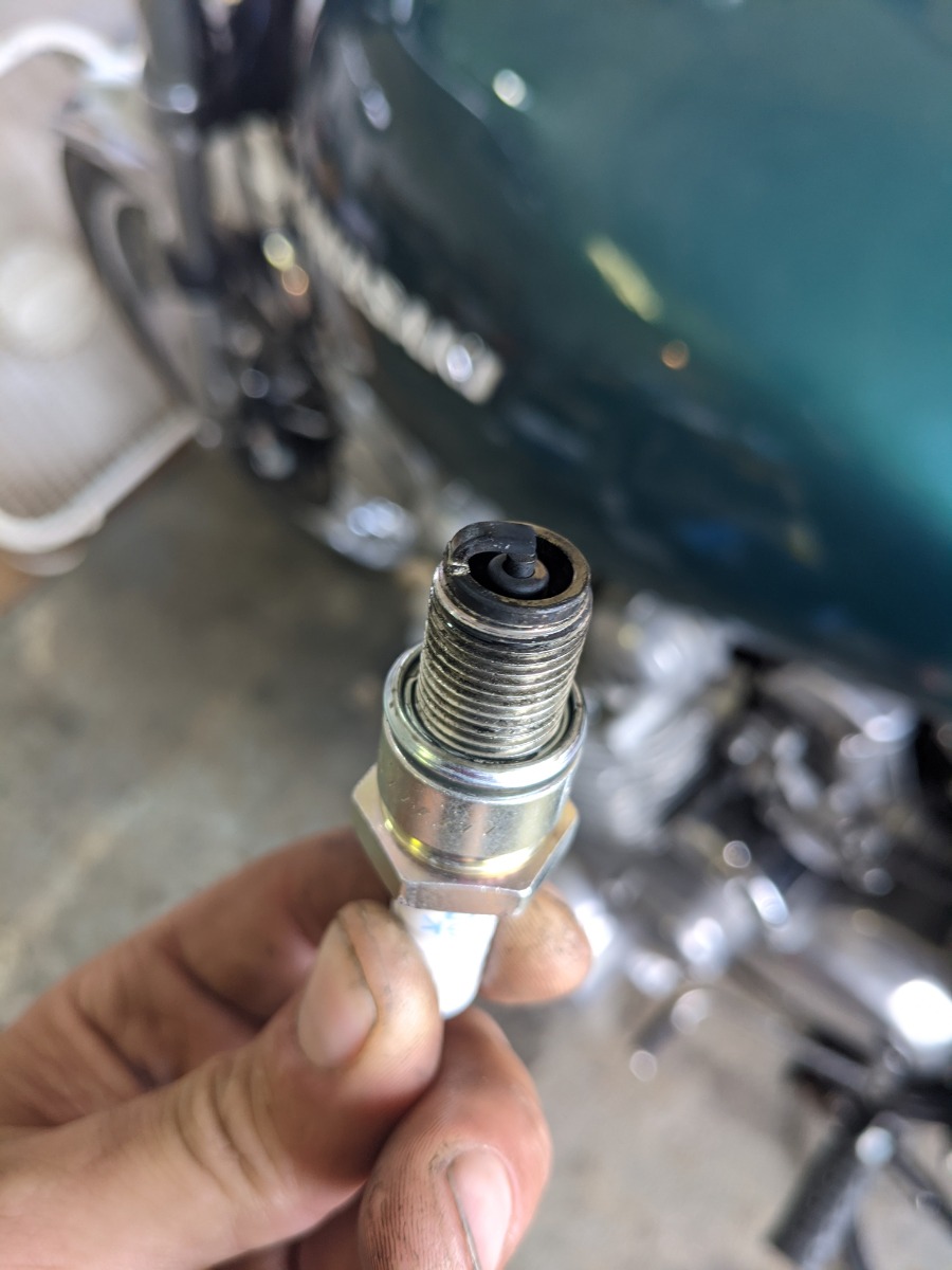

Checked the plugs.
#1 - rich
#2 - rich
#3 - WTF?
#4 - lean? Or correct?
No for a silly question that I still can't get my head around: pilot screw IN to lean it up and OUT to enrichen? Or visa-versa?
#1 - rich
#2 - rich
#3 - WTF?

If the pilot screw is behind the slide it is an air screw, in to richen the idle mixture, out to lean. If the screw is in front of the slide it is an fuel mixture screw, so out for rich and in for lean.

20 Aug 2020 20:17krazee1 wrote: If the pilot screw is behind the slide it is an air screw, in to richen the idle mixture, out to lean. If the screw is in front of the slide it is an fuel mixture screw, so out for rich and in for lean.
Nice work on your Barn find BTW!
Mike
Thank you.
To clarify, "behind" = "engine side", "front" = "intake side?"

Sorry, poor description, behind is airbox side, front is engine side.
