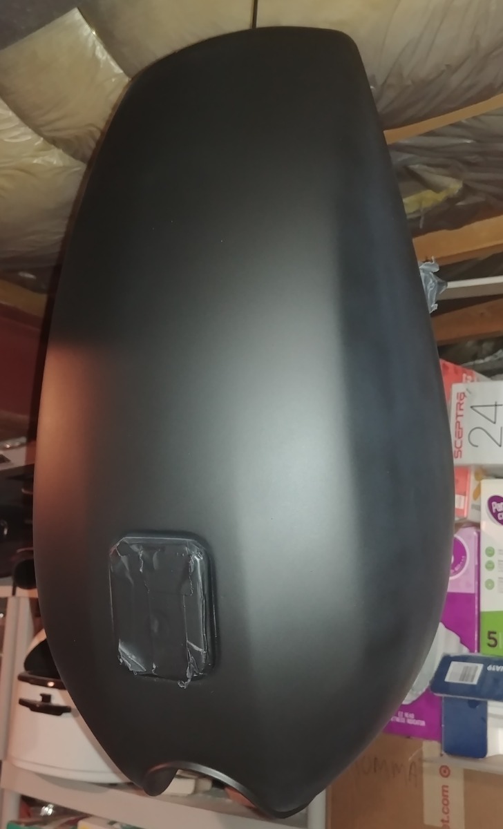

So I had a lot of trouble painting the tank. Scratches, runs, and fogging caused me to sand and paint the tank 4 times. But I think I finally for our right this time. I really how do because I'm dying to take her for a ride. I fortunately broke the plexiglass I was using to make the windshield for the fairing so I have to come up with another idea.

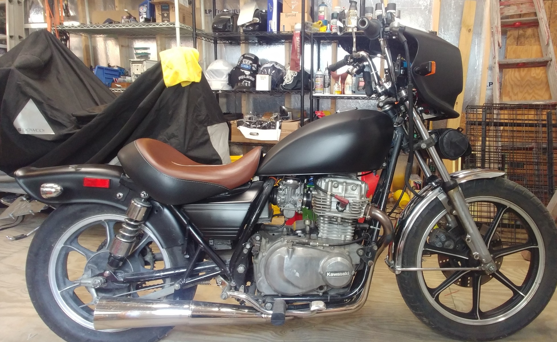

Almost done! All she needs is a freaking window/windshield for the fairing. The one I was making broke and I don't have anymore plexiglass. I might just take her out for a ride tomorrow.

Just came back from Rusty's first ride, and HOLY CRAP this little bike is fun! Now granted it was only down to the gas station and around the block twice but it was fun. She was idling just a little high, shifted very nicely, and braked great! I still have to do a little more work with the carbs and/or exhaust. Cracking the throttle she just bogged down and goes nowhere. Slowly rolling the throttle, she'll move pretty well. I don't have a tach hooked up so i don't know what rpms she was at. But I did have her up to 32 mph in 3rd gear.

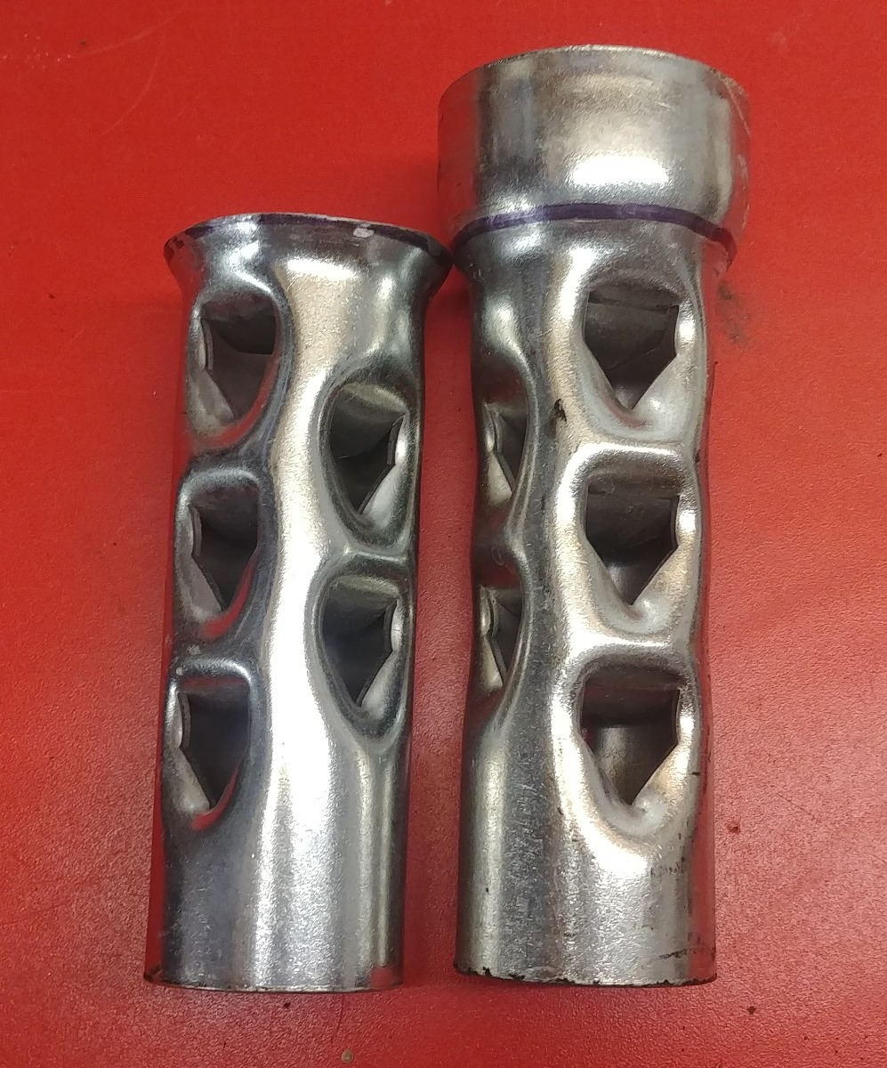

So, am i correct thinking I need to wrap the baffles in the exhaust? This is what I installed in the pipes. Also, she make a nice loud pop after she shut down.

I spent the last few months trying to figure out if I needed to rejet my carbs, replace them, or something else because she just didn't wanna get out of her own way. I cleaned out the carbs two more times, bought a carb sync tool, found out they were spot on, wrote down the jet sizes (88 secondary & 65 primary), hunted around eBay for a 4" baffle and FOUND ONE! And since it was getting cold, I kinda put everything on the back burner (and worked on my Road King replacing broken parts).
Fast forward to 3 May. The 4" exhaust baffle came in as well as the muffler packing material, so I wen to play in the garage. Removed the two little universal baffles and installed just the baffle w/o any extra packing material. The idle smoothed out a lot more than I expected so I felt like it didn't need any more. I had a chance to actually take her for a ride around the block yesterday and HOLY CRAP! it was light riding a new bike! She ran pretty good and I got up to 45 MPH! After this little ride I realized two things. 1-I really do not like the mid controls (need to find some forward controls or make some). 2- Not a huge fan of the mini/baby apes I installed. I'm gonna have to play around the other bars I have.
