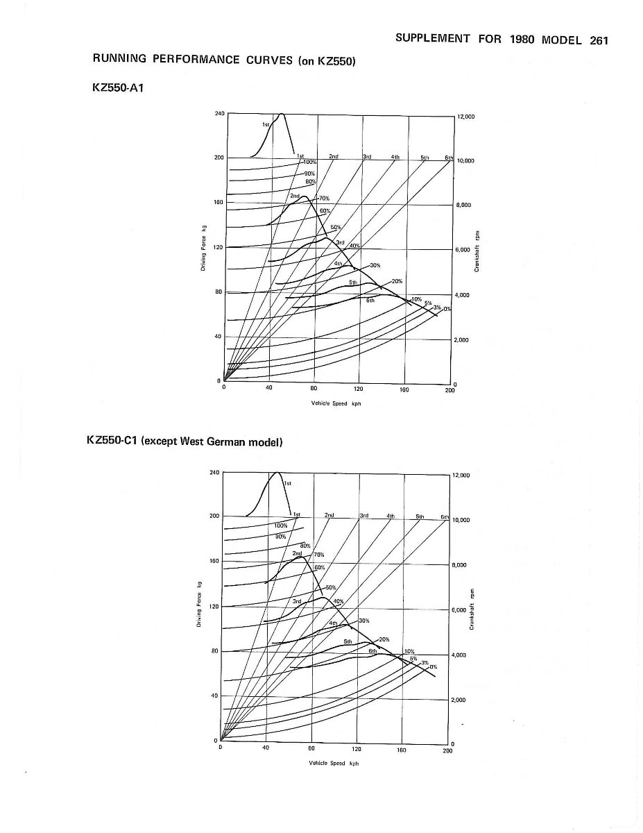

I know by experience that this definitely isn't my case - I reach 120 km/h on 6th gear with at least 10 000 rpm. So there is something really wrong with my bike.

According to the manual, the 1982 Kz550B3 uses 16T front and 40T rear. That is the same as the Kz550A model. The Gpz's had more power so to fully realize the top end, they changed the rear to 38T. The Kz550C Ltd had a smaller rear wheel so they increased the rear sprocket on that bike to 38T as well.
So you are really only off by one tooth, and that is on the rear, which should not make much noticeable difference. It changes the top speed at 9500 RPM from about 186 Kph to 181 Kph (for normal tire size).
